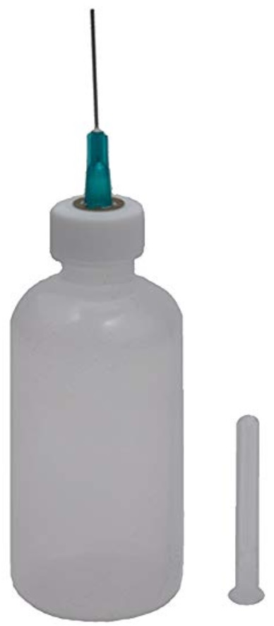

I keep soapy water in a 2oz needle bottle to test for leaks. The regulator gauge is prone to leak at it's seal.
