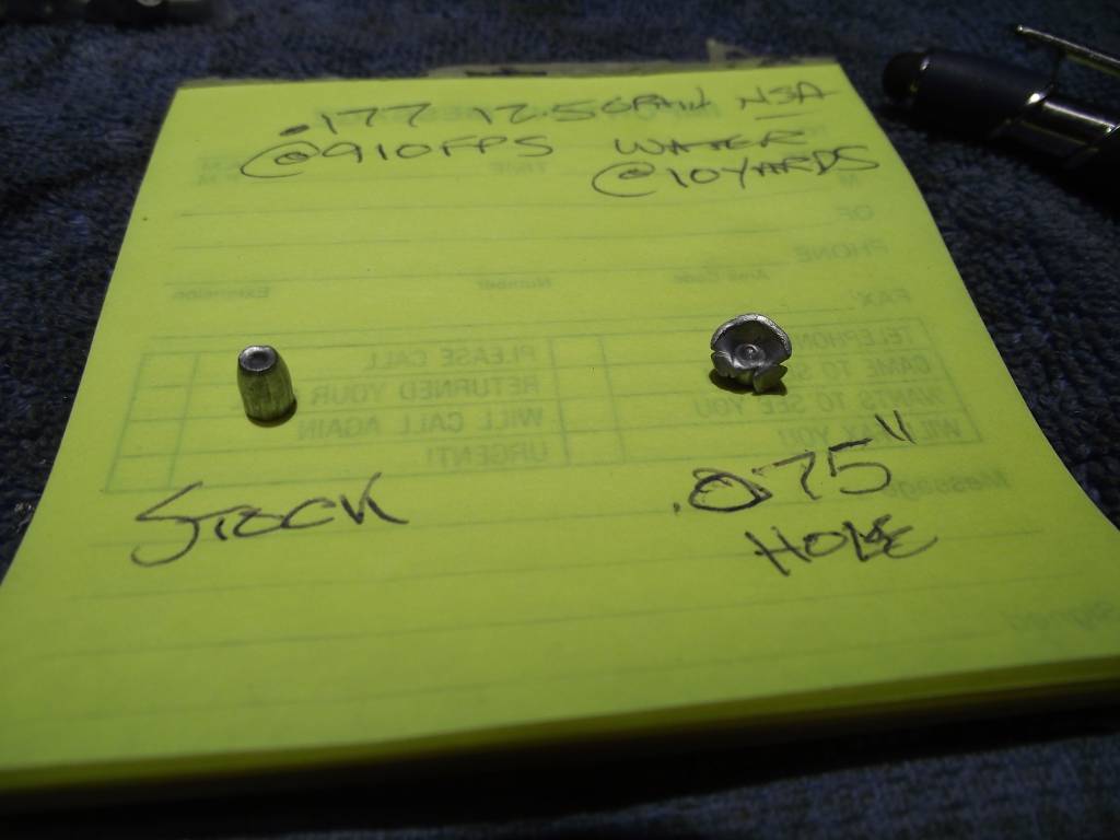

Ok ... big zip-loc bag with water being @ 6" thick with a folded up towel behind to catch it after the fact.
.177 slug at 12.5 grains @ 910 fps PASSED RIGHT ON THREW with ZERO expansion getting more damage via stopped by the fabric of the towel than the water.
Same result as with bottles in line. Advantage is a much improved BC over a pellet, but if looking for flesh damage in game ... JURY IS STILL OUT until we get some actual game recovery data.

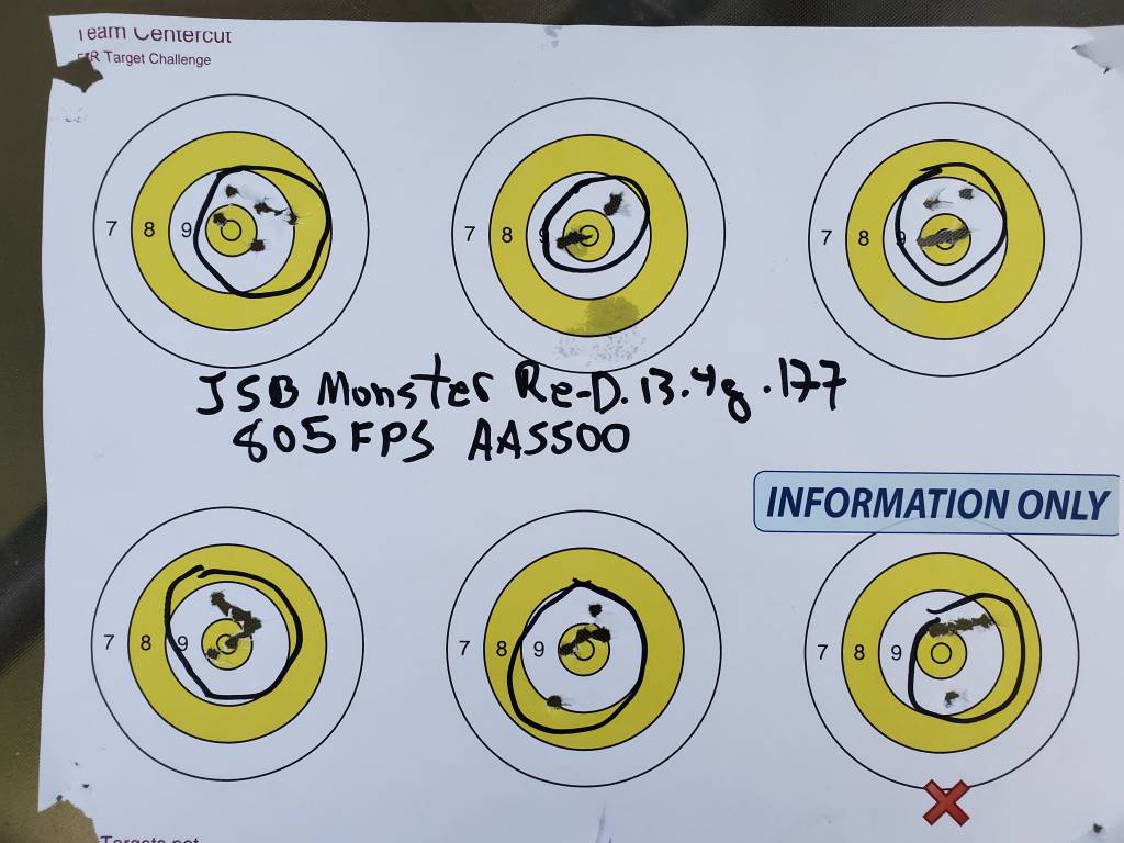

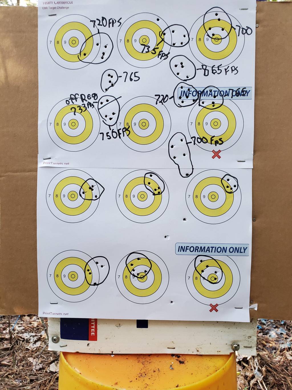

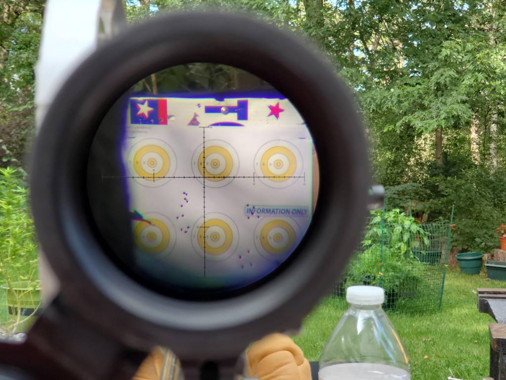

Here ya go. All testing done at 55yds using my AA S500, standard twist LW barrel with choke. The winds were light, 1-3mph. I did not hold for them. I did not check tail size, clean or lube the slugs.
After initial testing the 12.5g gave the best results. That's what you'll see used in the today's testing. However in the next test I'll sort for tail size. Also note these are a bit harder loading than the older version.
The top target seems self explanatory. The bottom target was shot at 810fps.
This was a quick control target shot afterwards with 13.4g redesigned monsters.
