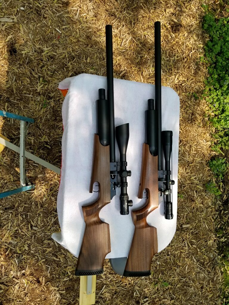

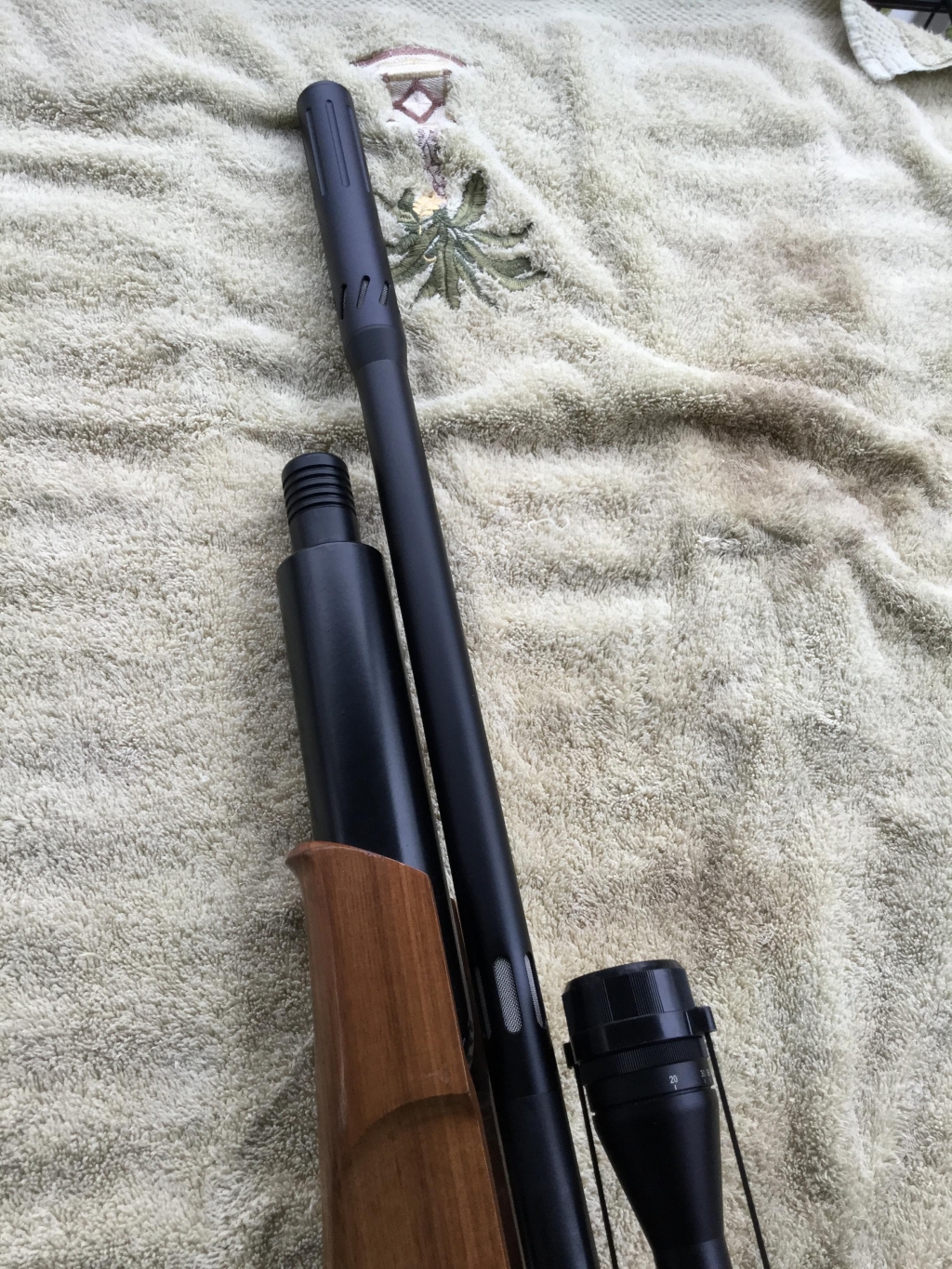

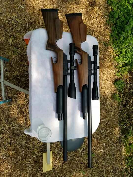

Those are some great looking Rapids - wow! Makes me wish I bought more then the 1 I have. I remember some of the members on the AirAdvice site had some good looking Rapid II I think. I don't think they were regulated (could be wrong here) but they would get some fantastic 100 yard groups. And I think it was Ernie that used to make most of the modded parts for them. He also did a shroud that had the indent for the bottle incorporated into it. Does he still do this type of work? Those bottles that are modded by AZ...have you run into any issues with them over time? I definitely like the looks of them with that air input on the far end.
*bzizz - How much did you have AZ cut off your barrel? Did it affect velocity much or did AZ make up for it by tuning it back into the reg? That Huggett full length shroud - how does that work with the MFR oem shroud on it too? I saw those Huggetts yesterday in my googling on a site located in Utah. Which model is your Huggett? How quiet does it make the over all sound? I'm sorry for asking all these questions at the same time....I haven't talked airguns with anyone in a long time :)

I know this question wasn’t meant for me but I might be able to answer some of the questions.
Ernie from the (sadly no longer) Airgunadvise, became really busy with jet skis, just recently , he had started back on airgun airguns, in a much reduced capacity. Yes he did do the tube with a dent, very clever the way he dit it too.
Some of the guns were regulated but the high power stuff was all free flow.
The AZ modified bottles have been available for a while but there are some safety concerns about them as the bottle was never designed to have a hole drilled in the base. There was a press release by the manufacturers of the bottle about the dangers of q/f modification.Because of the bad press, Many (if not all) of the shooting ranges here in the uk will ban you if you have one fitted to a bottle. I am sure that AZ has tested these fittings without any issues but personally I would not have one on any of my guns.
You can get other Q/F fitted to a theoben (normally on the reg/ fast flow) that don’t affect the integrity of the bottle but I have never found unscrewing the bottle to be much of a chore so never bothered (also one less place to leak)
The hugget shroud is a complete assembly and replaces all ot the original theoben parts, they look really nice but are expensive and only adequate at noise reduction, better than the original but not £175 better.
with barrel shortening, you generally loose about 15fps per inch. This can be made up but increased reg pressure but noise and air usage will be more. The is very little difference in noise level in a 19” barrel with a shroud stickIng 4” past the muzzle and a 3” shorter barrel with a 3” longer shroud.

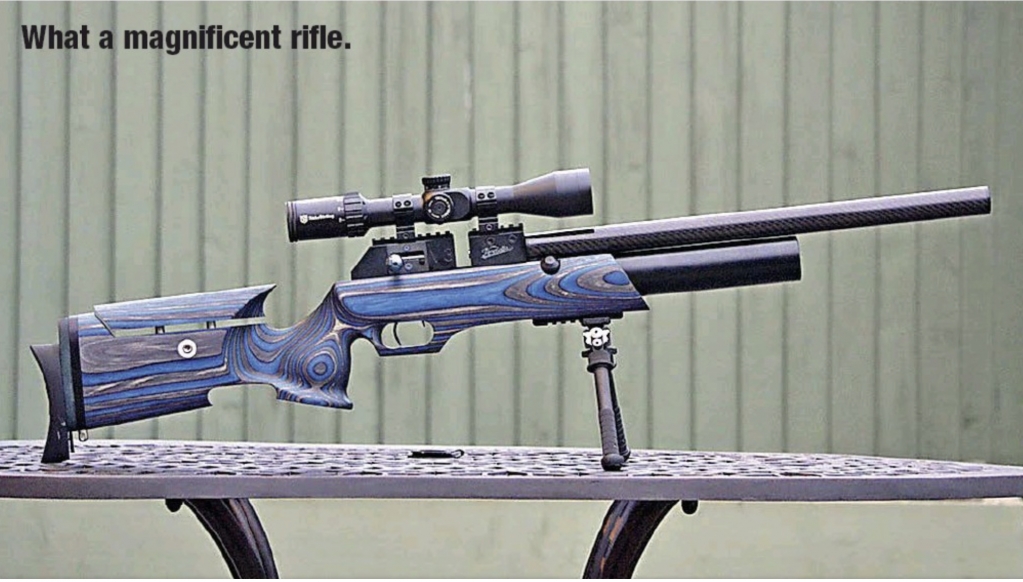

The carbon shroud fitted to this gun I made to raised £4000 for chartIy, is sooooo much quieter than any hugget I have ever tried, half the wieght too. If you look you can see a Q/F fitted just forward of the block.
