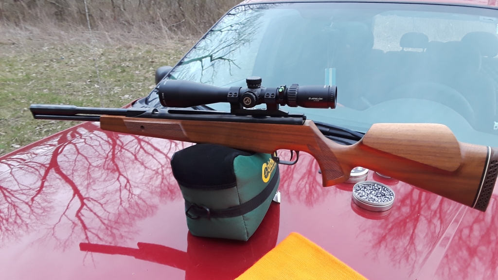

I bought 30mm rings from Martin and mounted an Athlon midas 2.5-15x50!
Its been holding up so far and life time warranty! Another thing is mine came shooting pretty hot at almost 16fpe and I lowered the power to around 14fpe ! Makes for a better shot cycle and not as harsh on scopes!

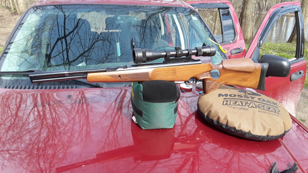

Another scope in 1" that really doesn't meet your needs is the Sightron 4-12×40 FT front AO. I love the reticle and its been holding up on my .177!
