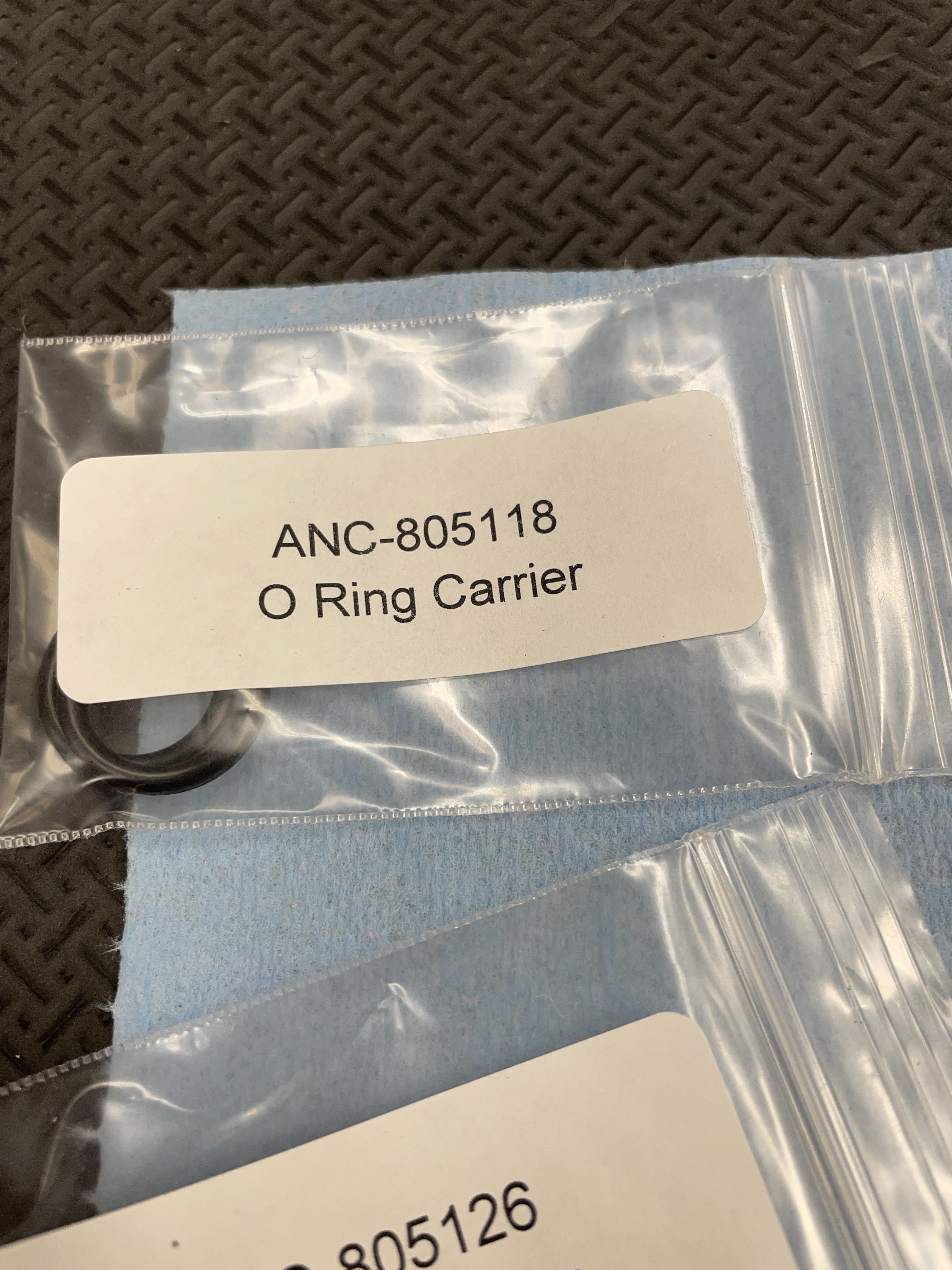

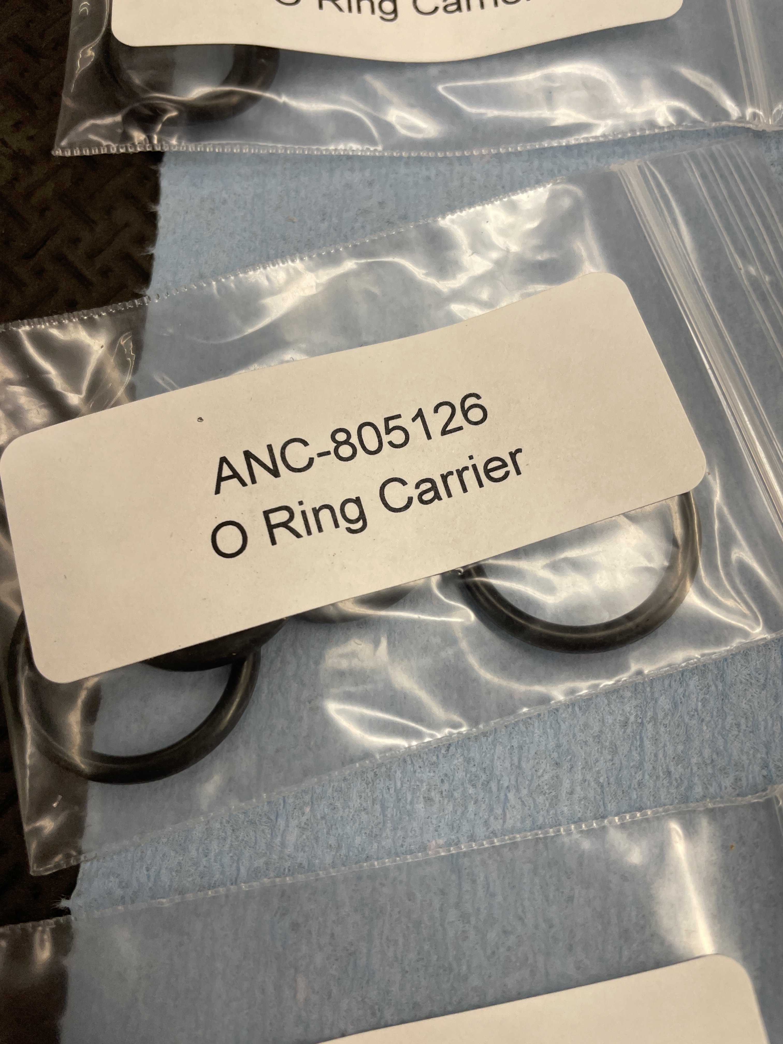

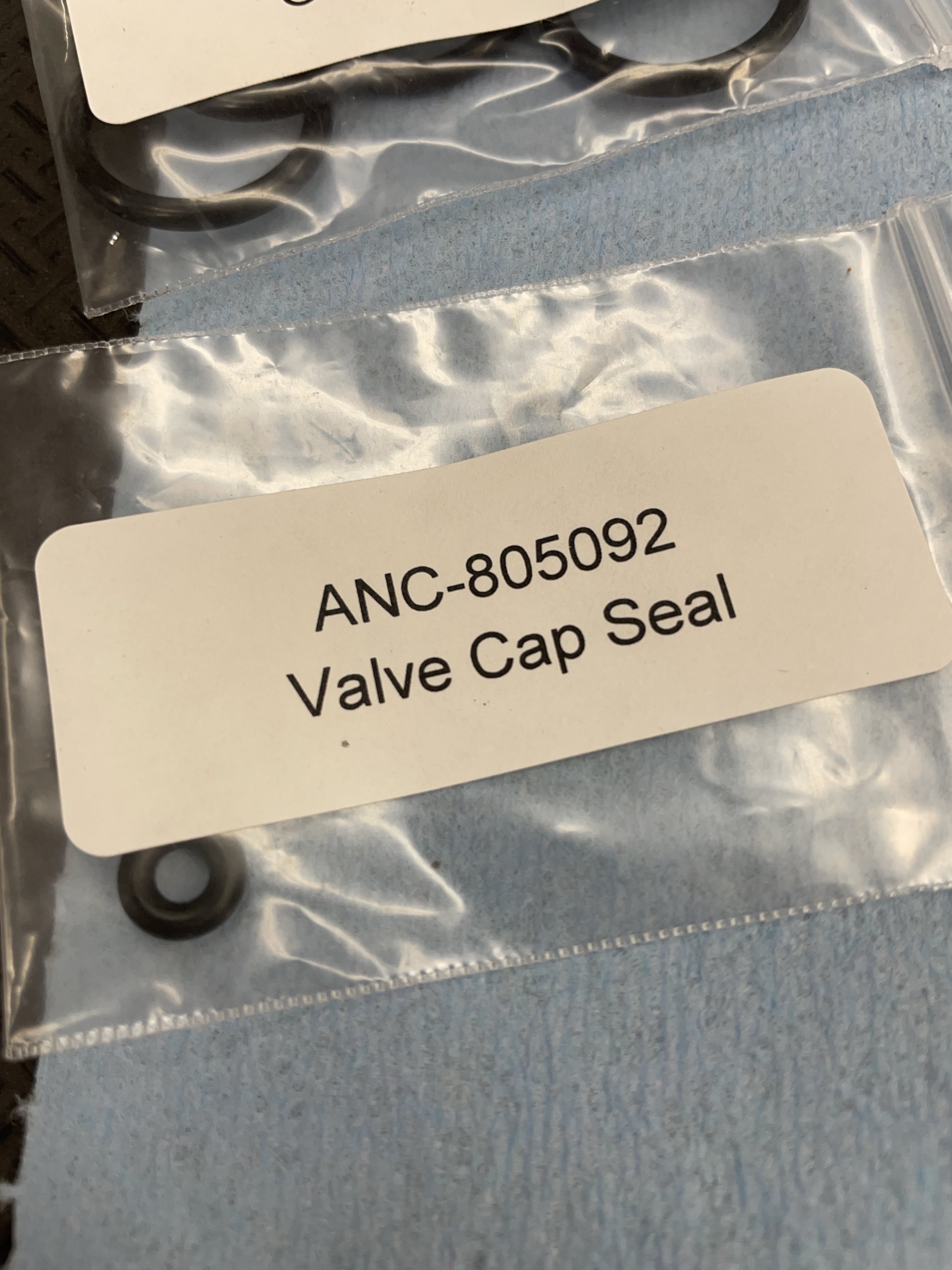

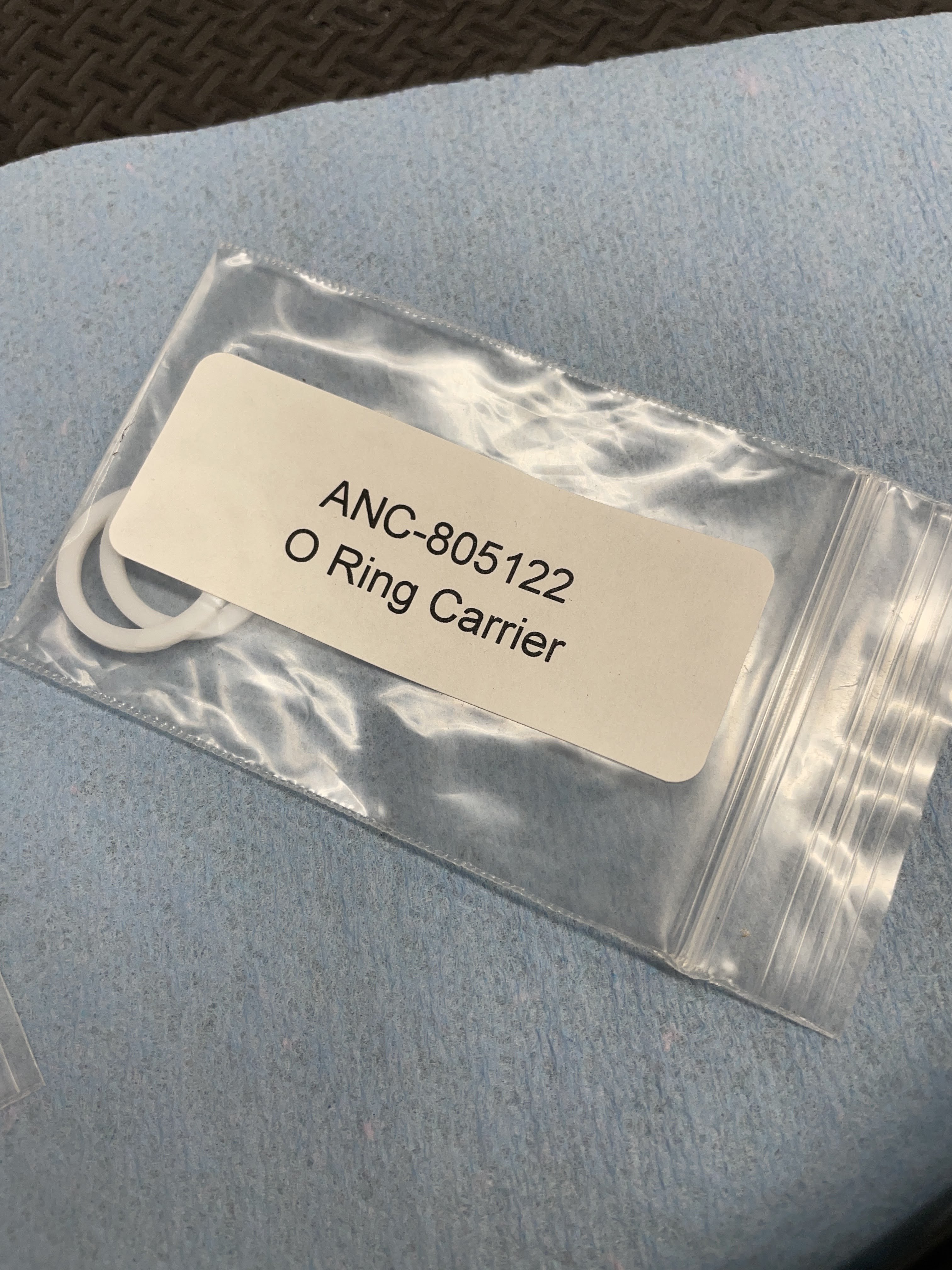

All new soft parts were installed.

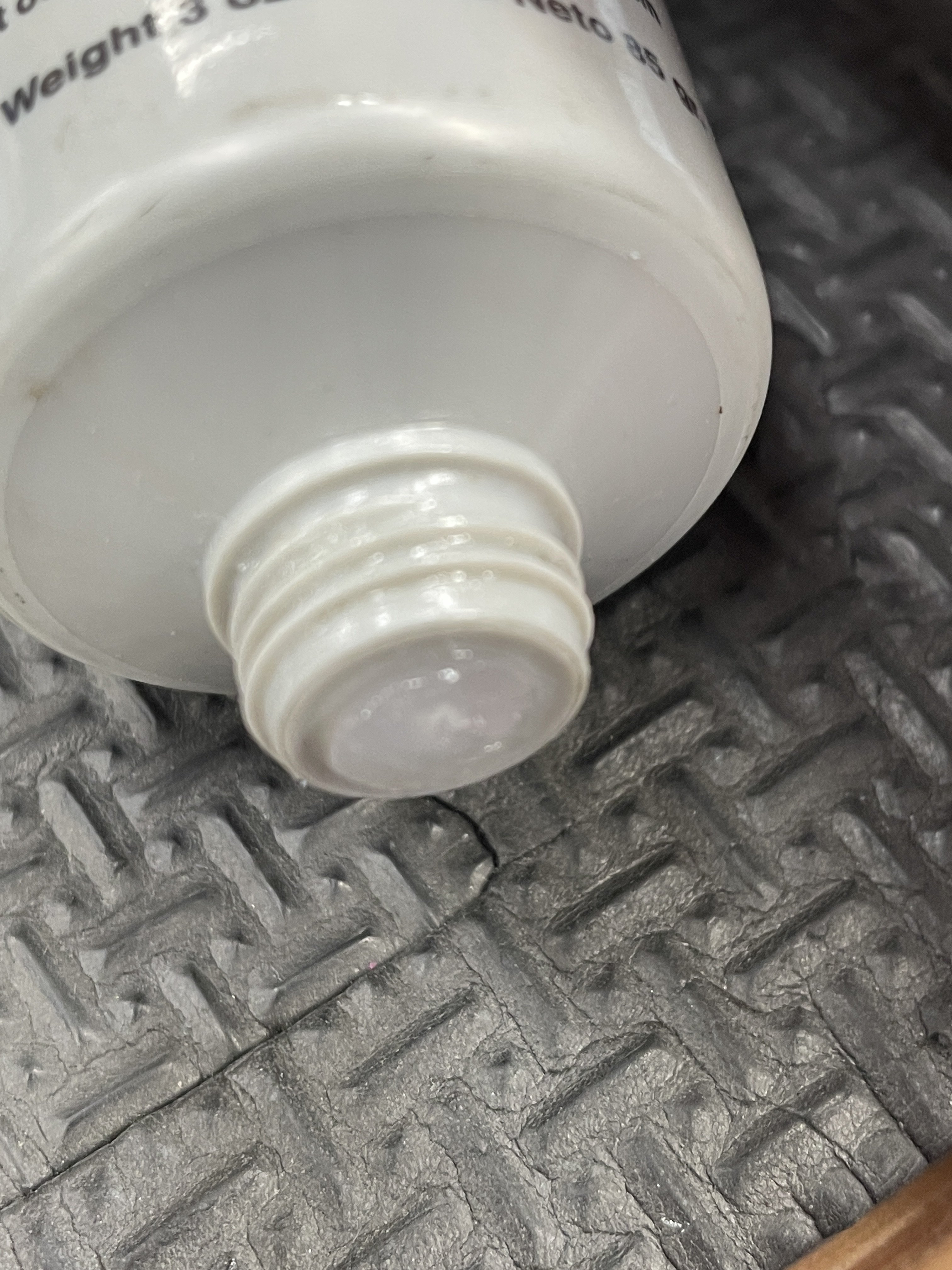

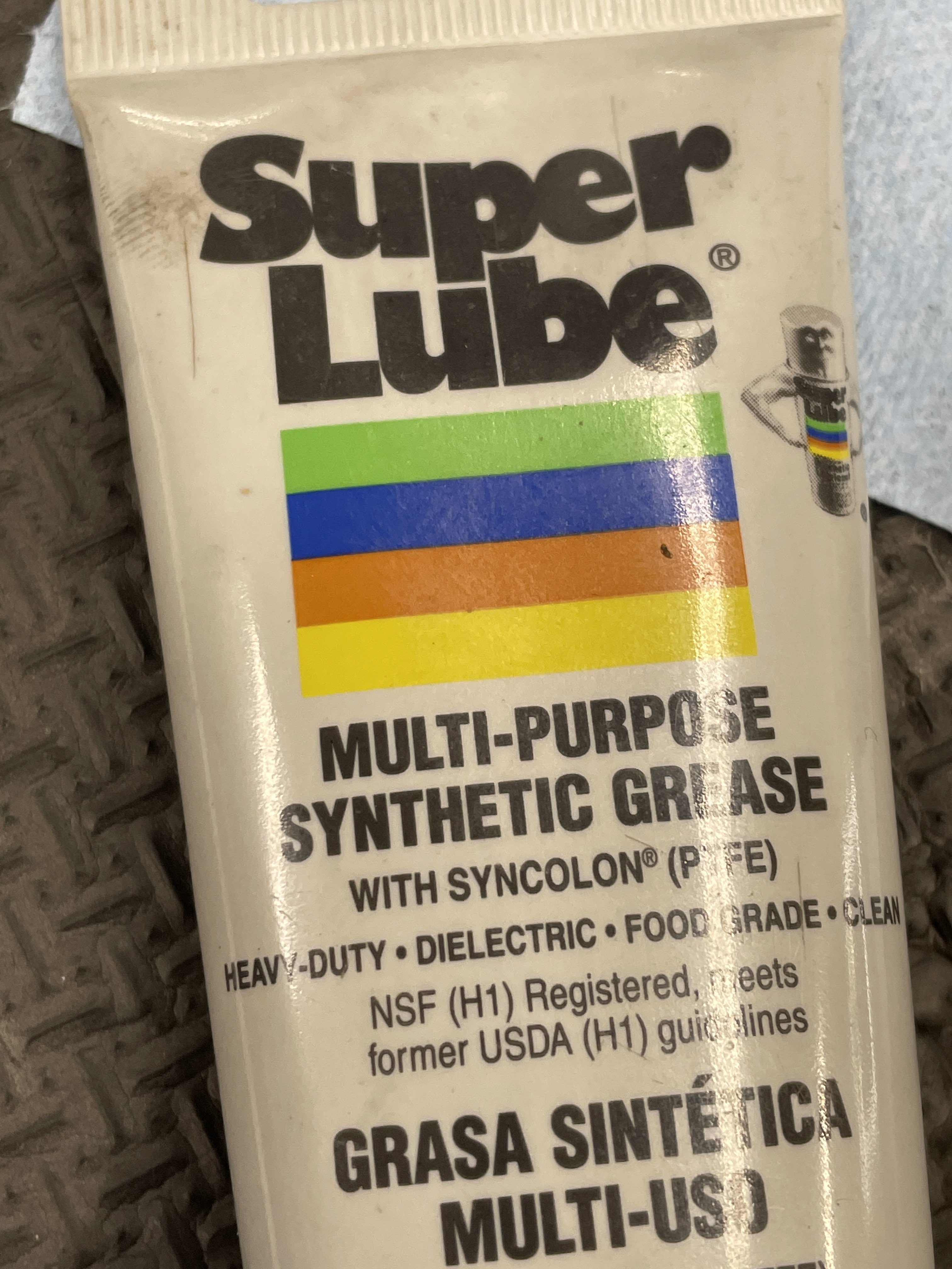

Superlube silicone synthetic greasewith PTFE for o-rings contacting metal.

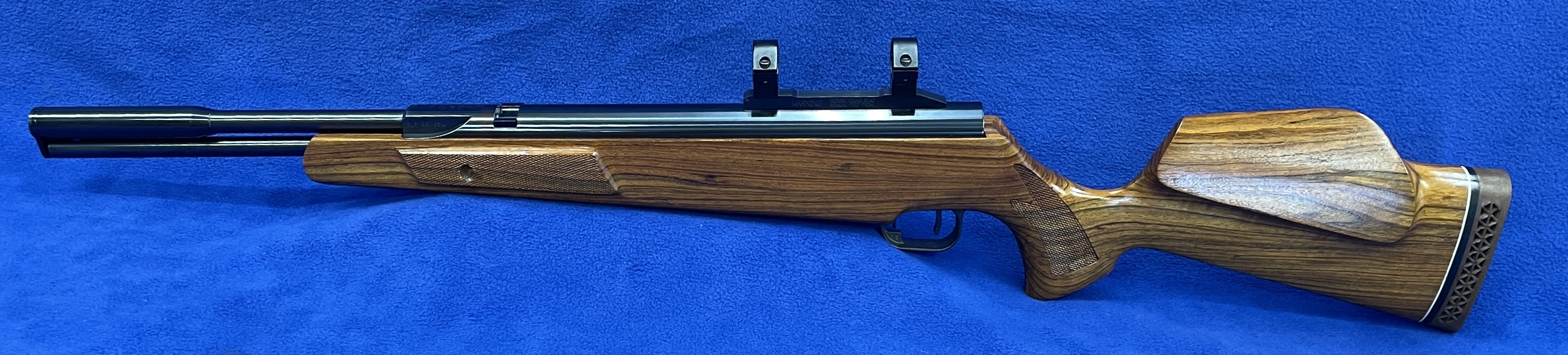

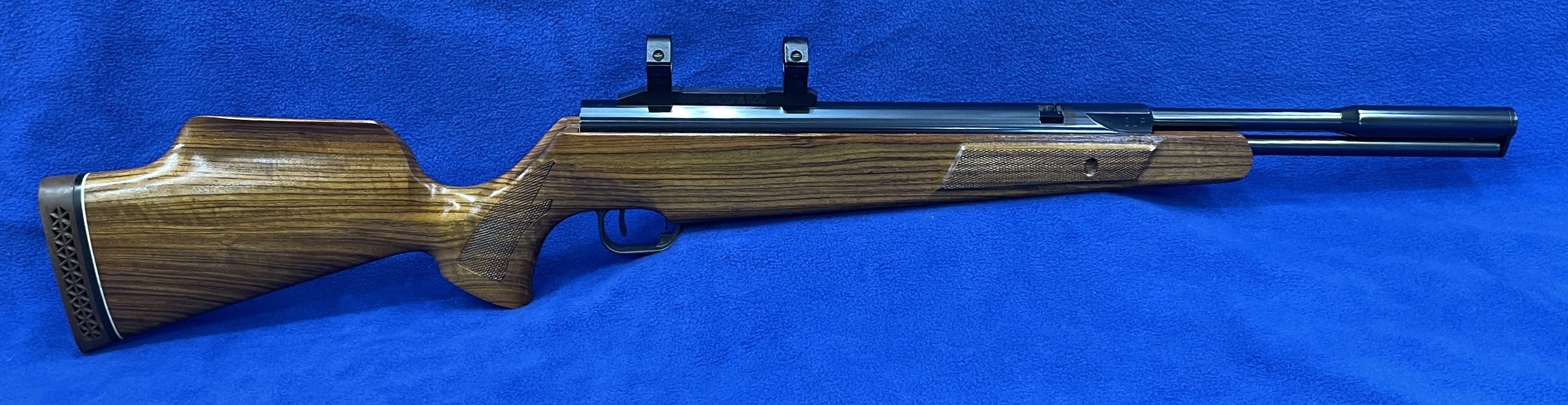

Job done!
Beautiful gun!
I don't know if it matters, but although Super Lube does make a silicone grease, what was pictured was a synthetic grease.
Well spotted, you are absolutely right. Thank you for the correction I edited the post to reflect the correct product.
I use the silicone for o-rings contacting plastic (not often in springers but occasionally in PCP's) and the synthetic where o-rings contact metal, which is the most common scenario. The important part of both formulas is the PTFE which is good for both the o-ring and the metal. Most importantly, for springers both Super Lube formulas include PTFE. Many other silicones do not, which makes them a poor choice for metal. Silicone can make a good carrier in the right scenario but PTFE and/or Molybdenum disulfide are the favored lubricants. The following usage cases are from an article on the subject.
