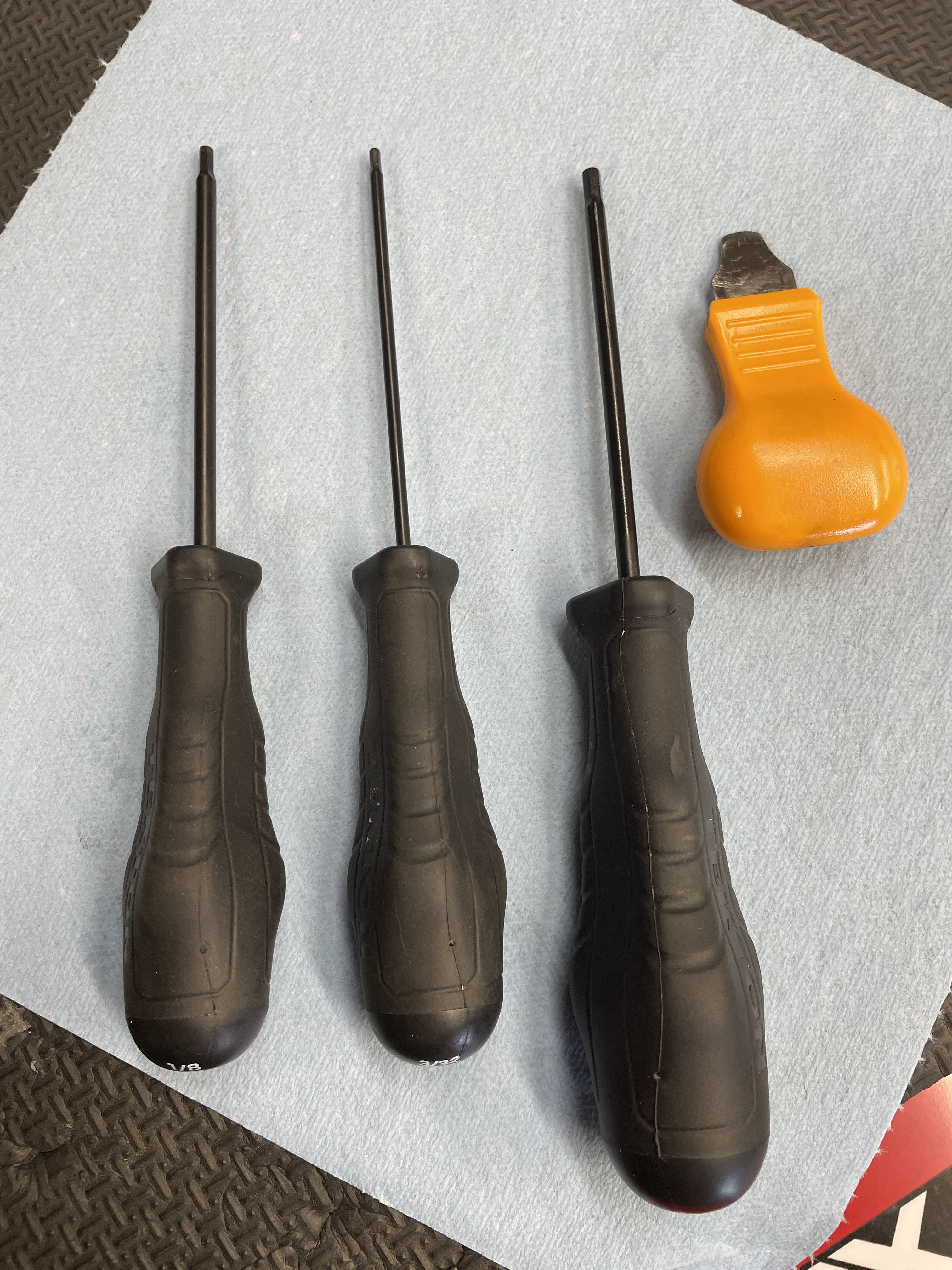

All non marring tools are used and the work is done on a soft rubber mat with no tools or foreign objects allowed on the work surface.

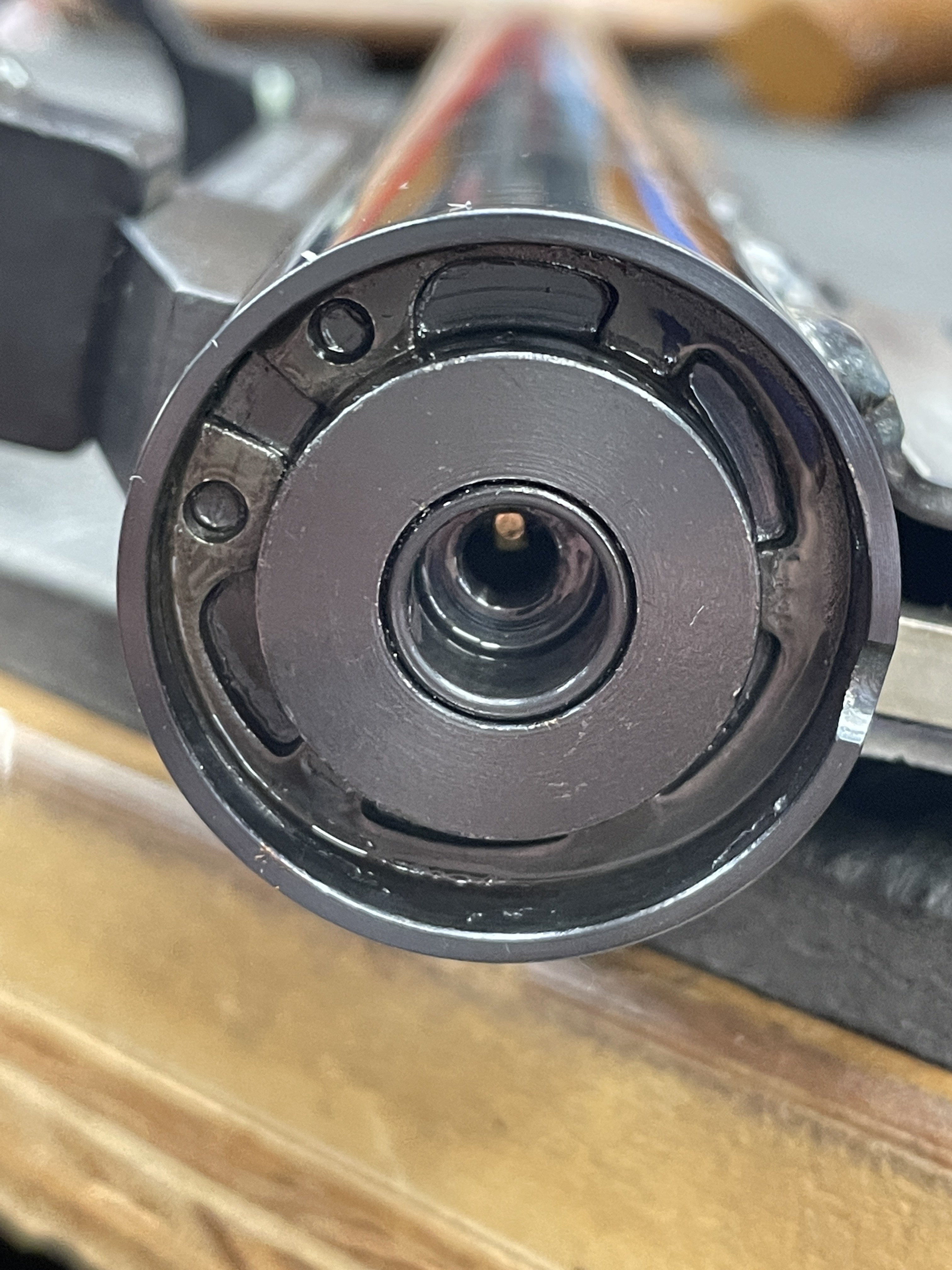

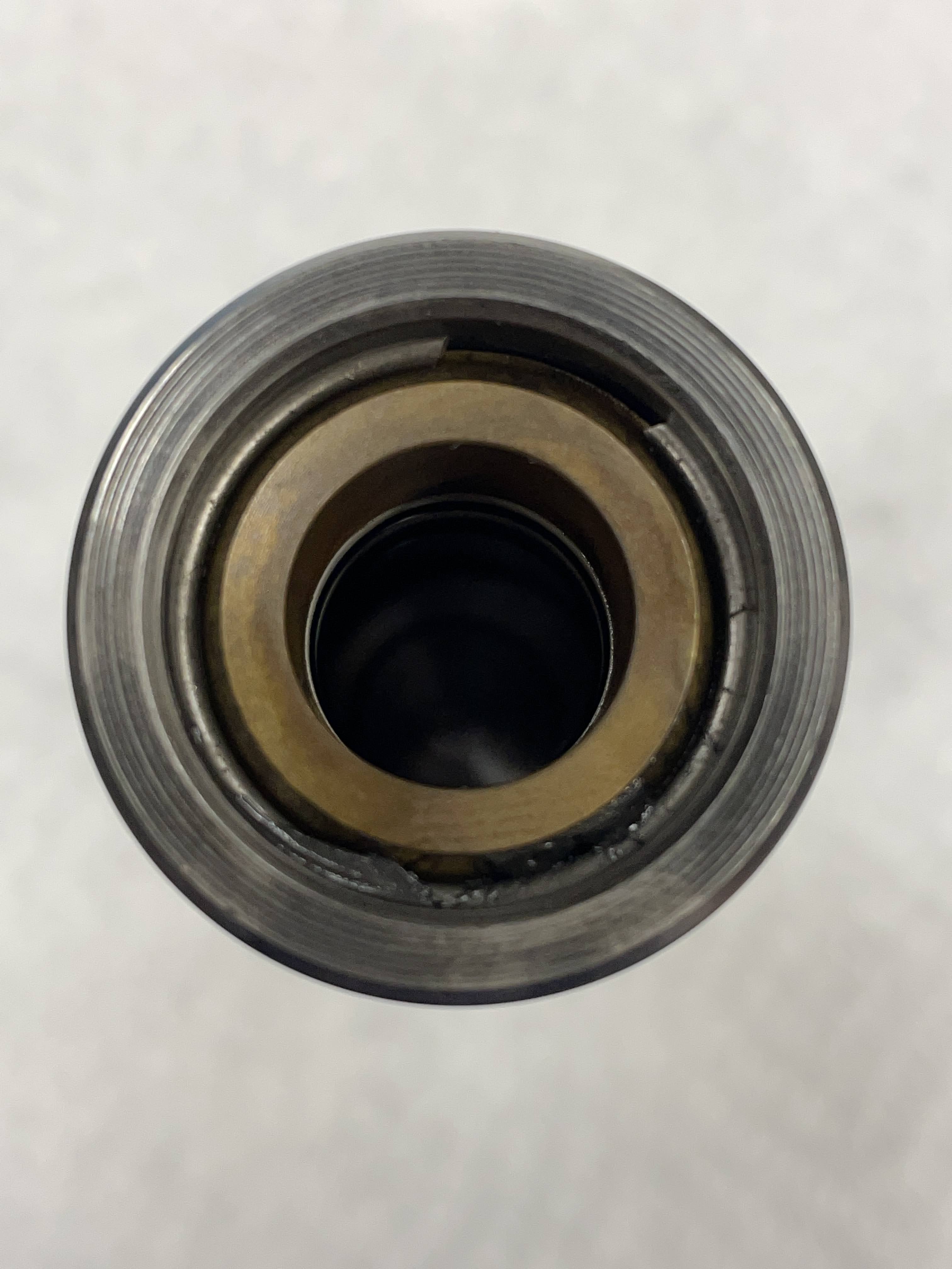

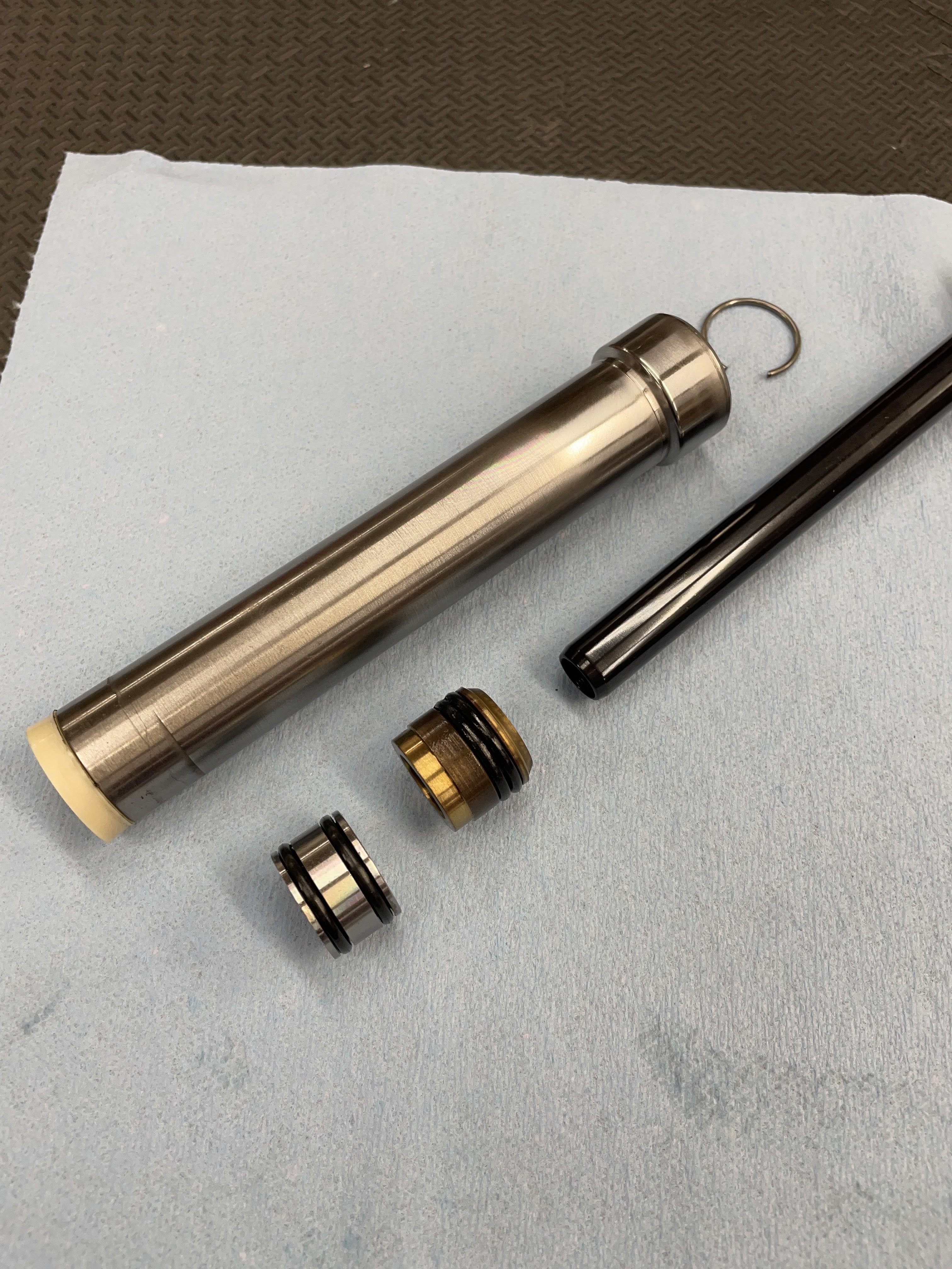

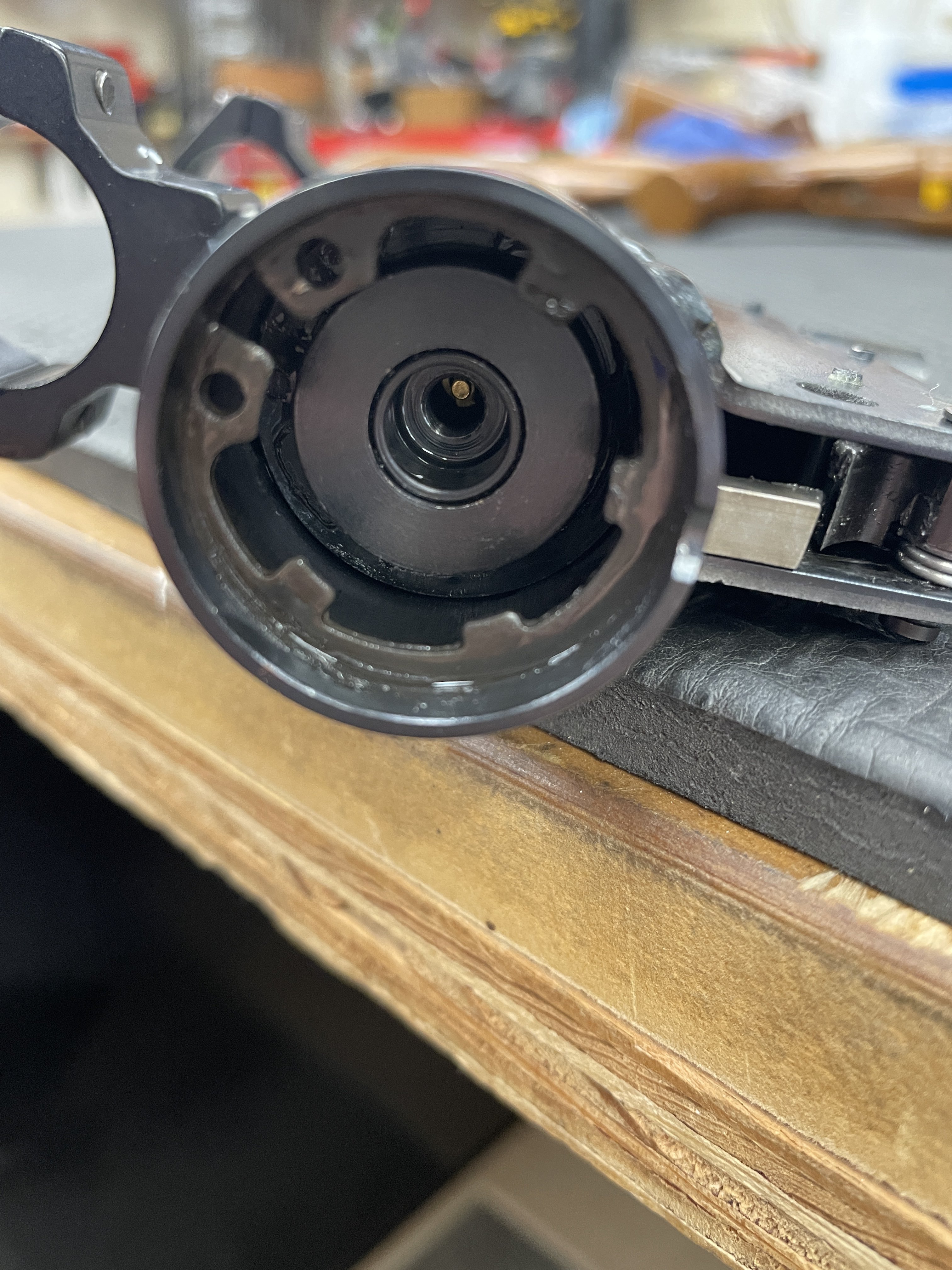

The rifle was degassed and disassembled.

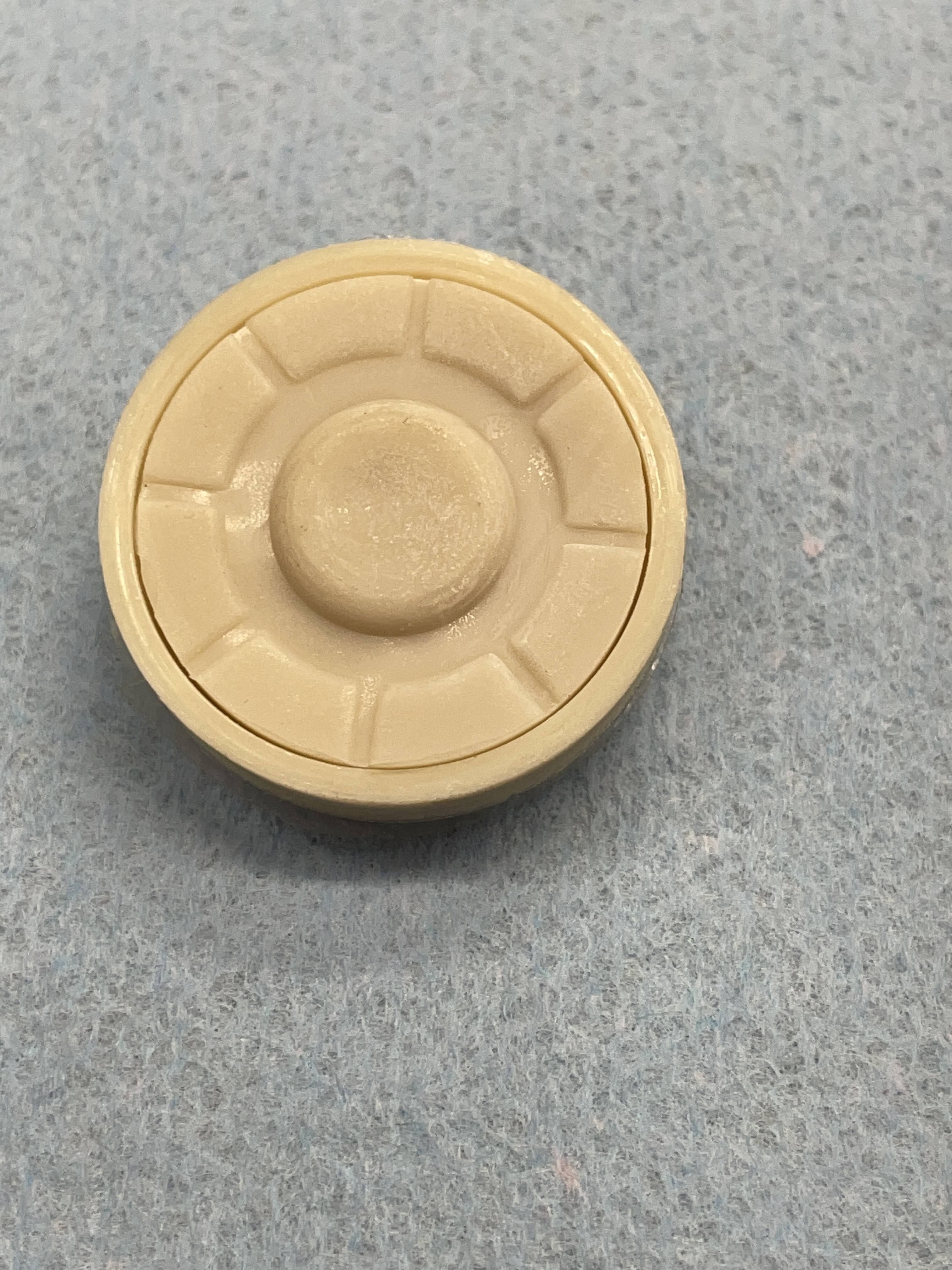

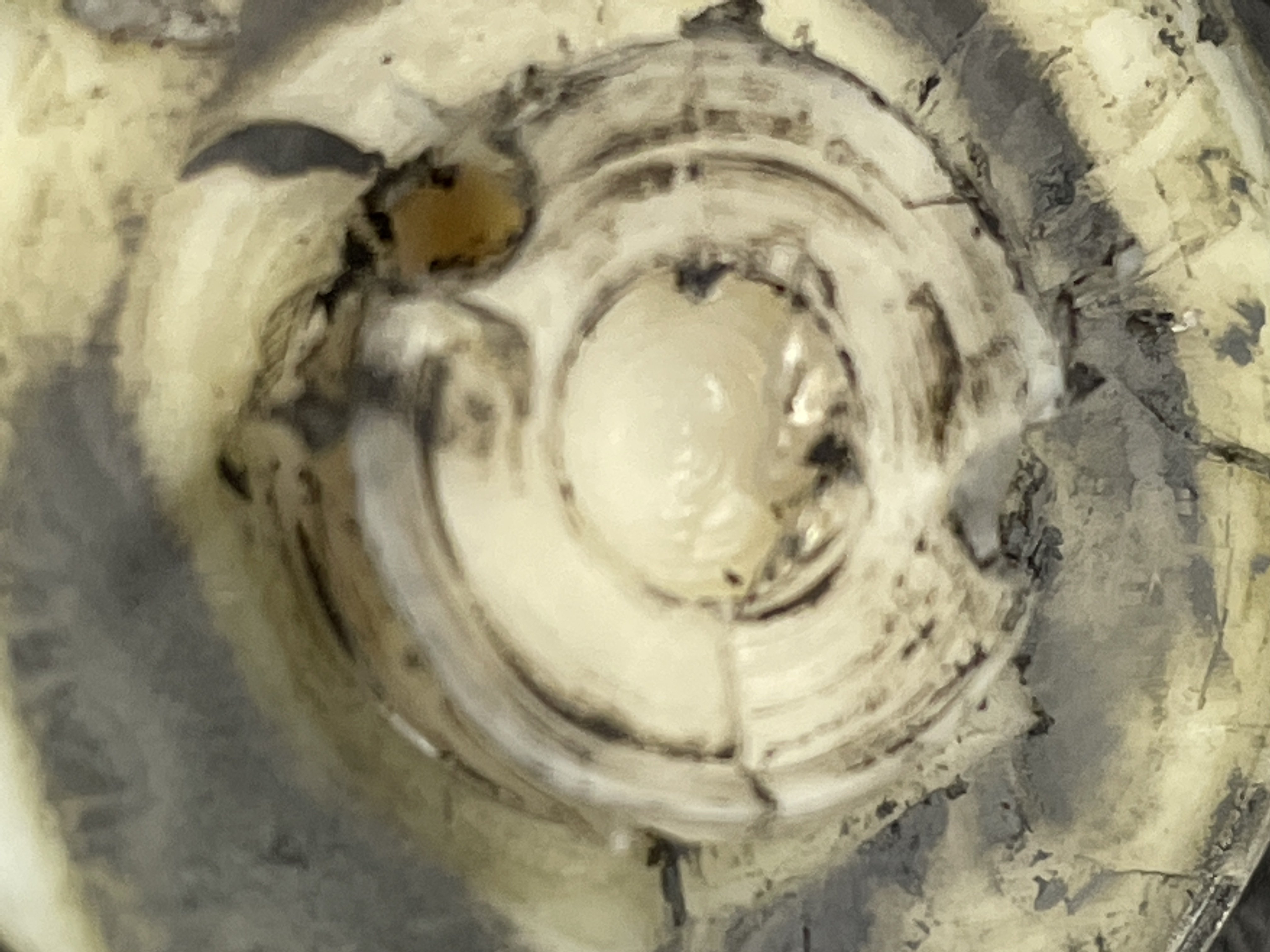

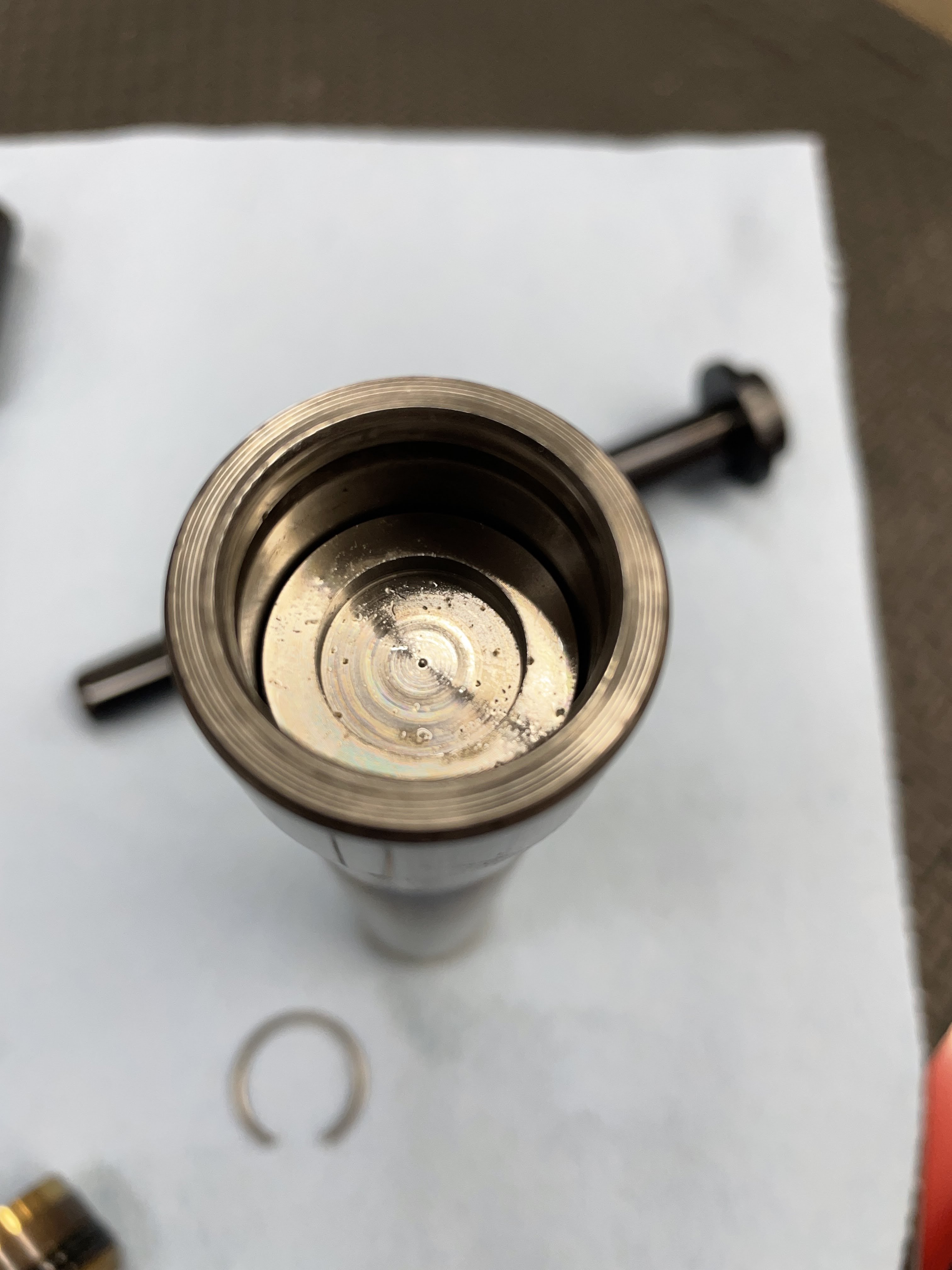

The original crown had deteriorated over time and was the consistency of a wax candle.

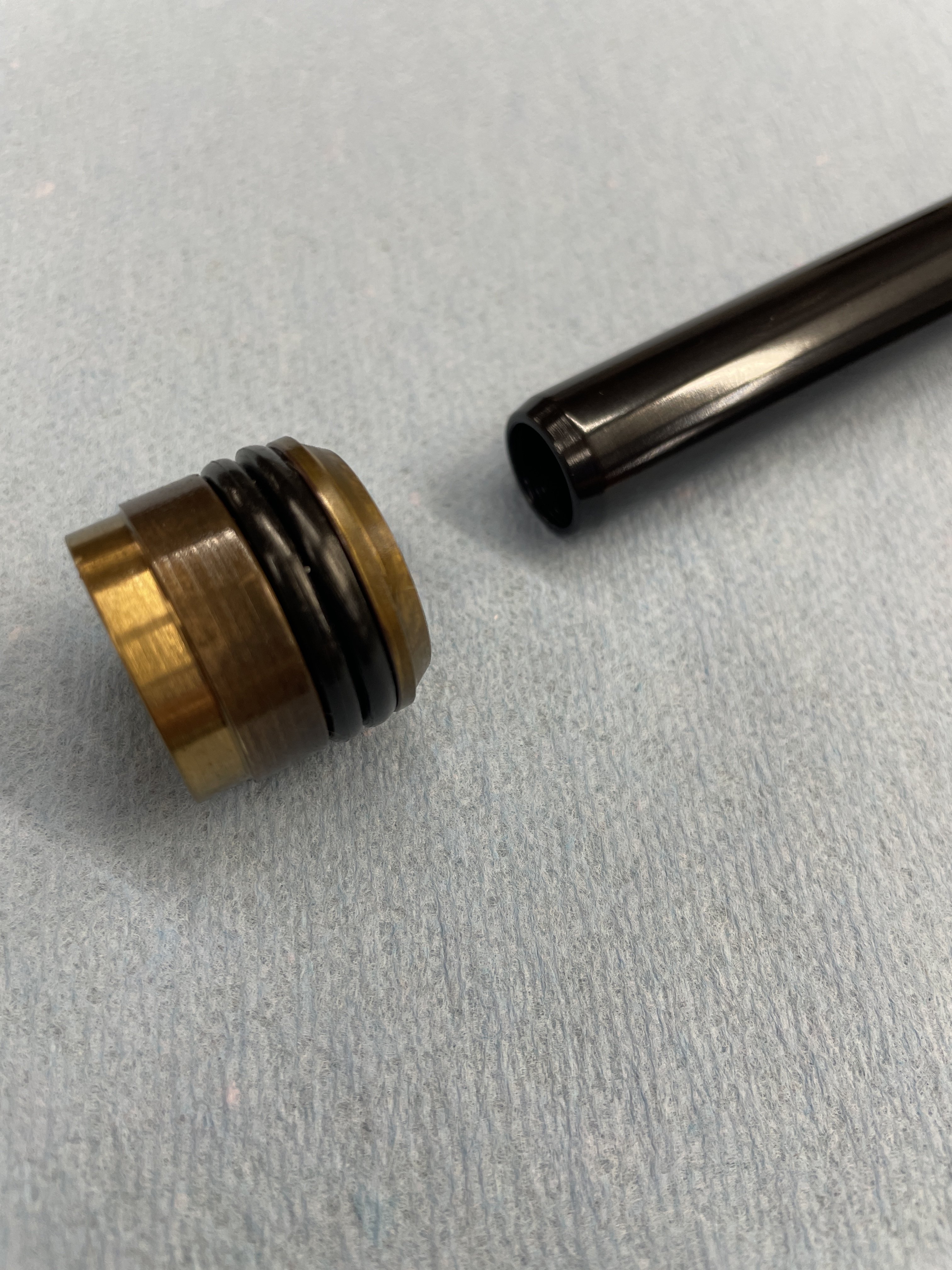

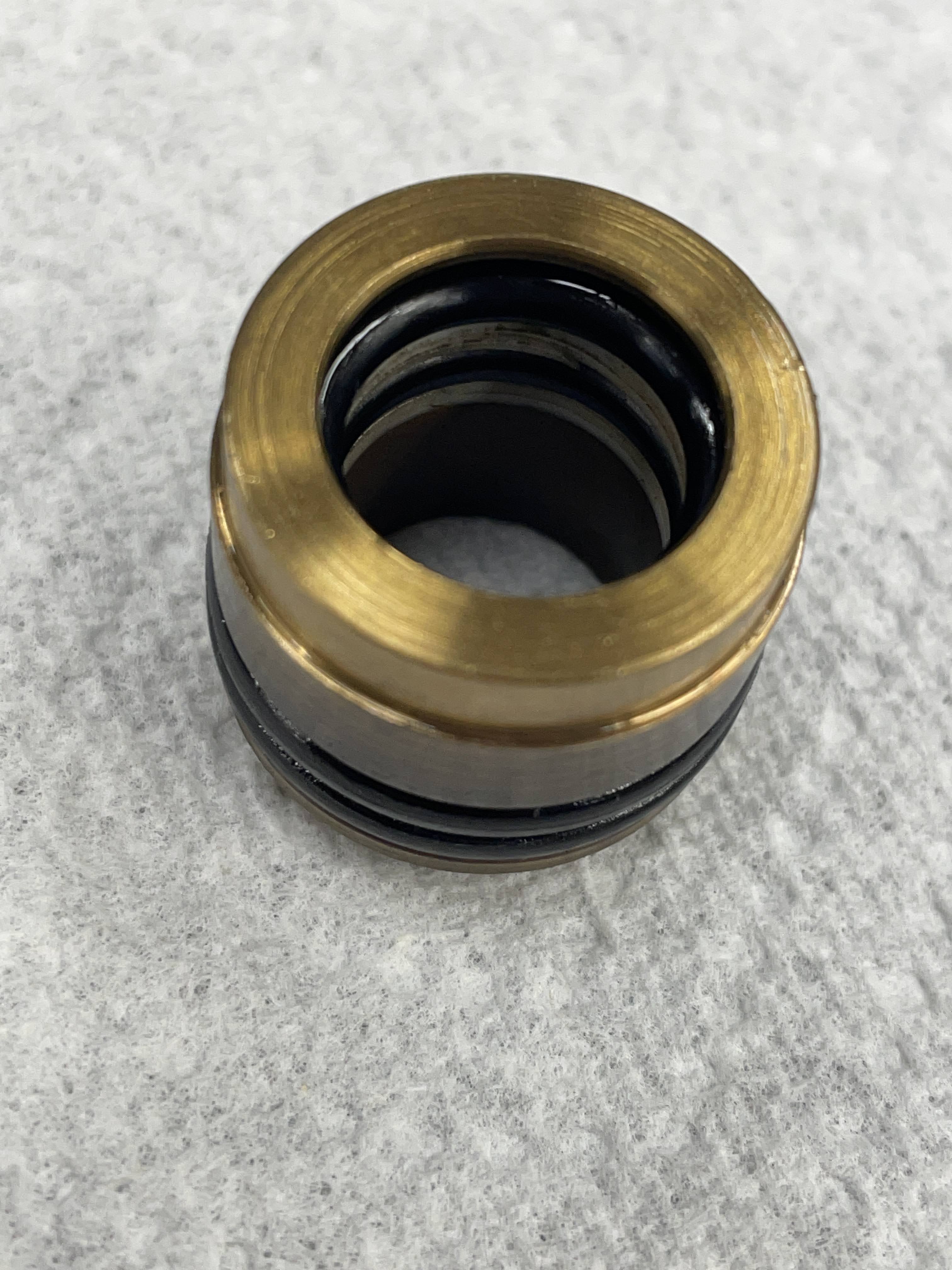

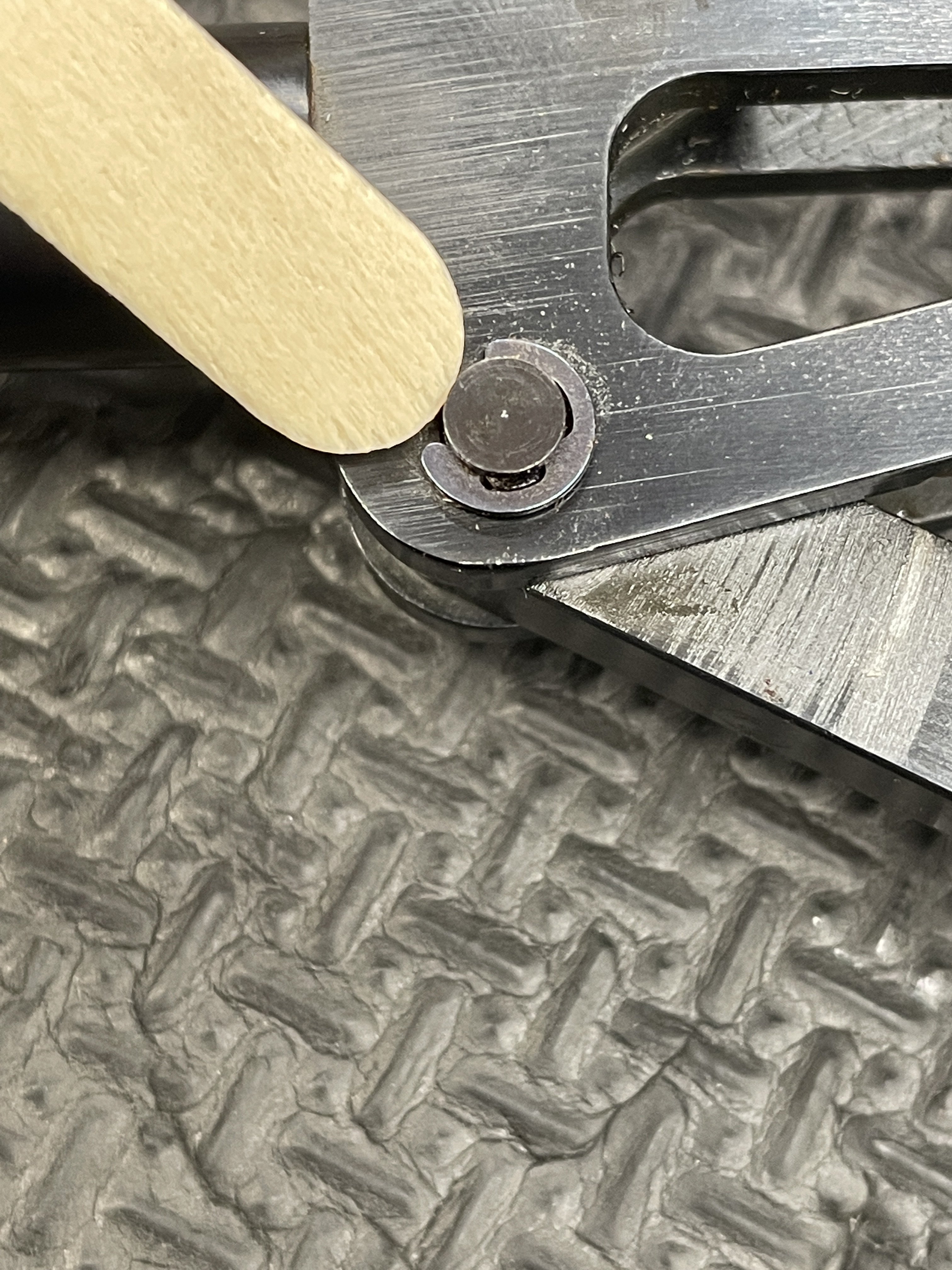

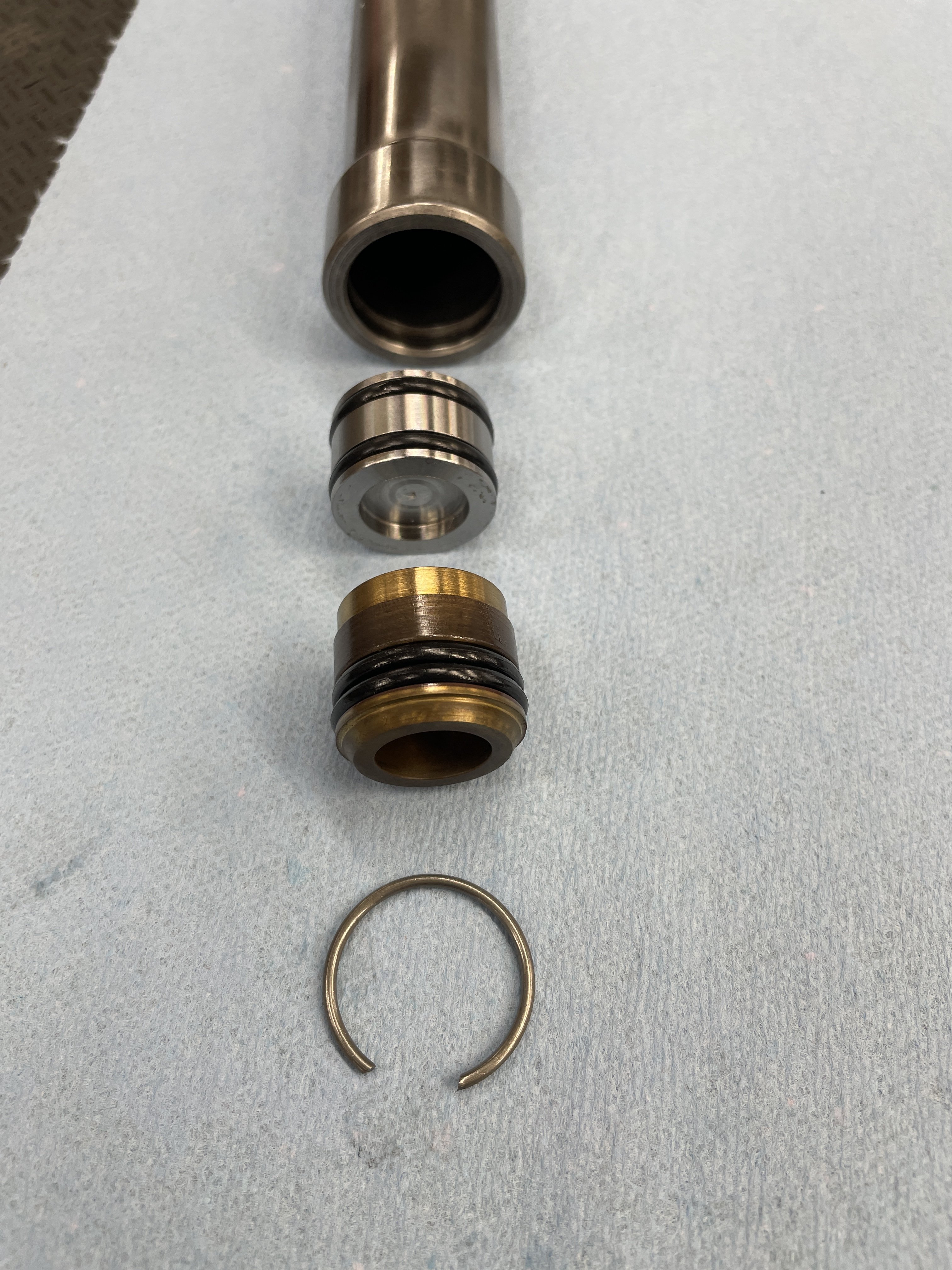

The ram was disassembled.

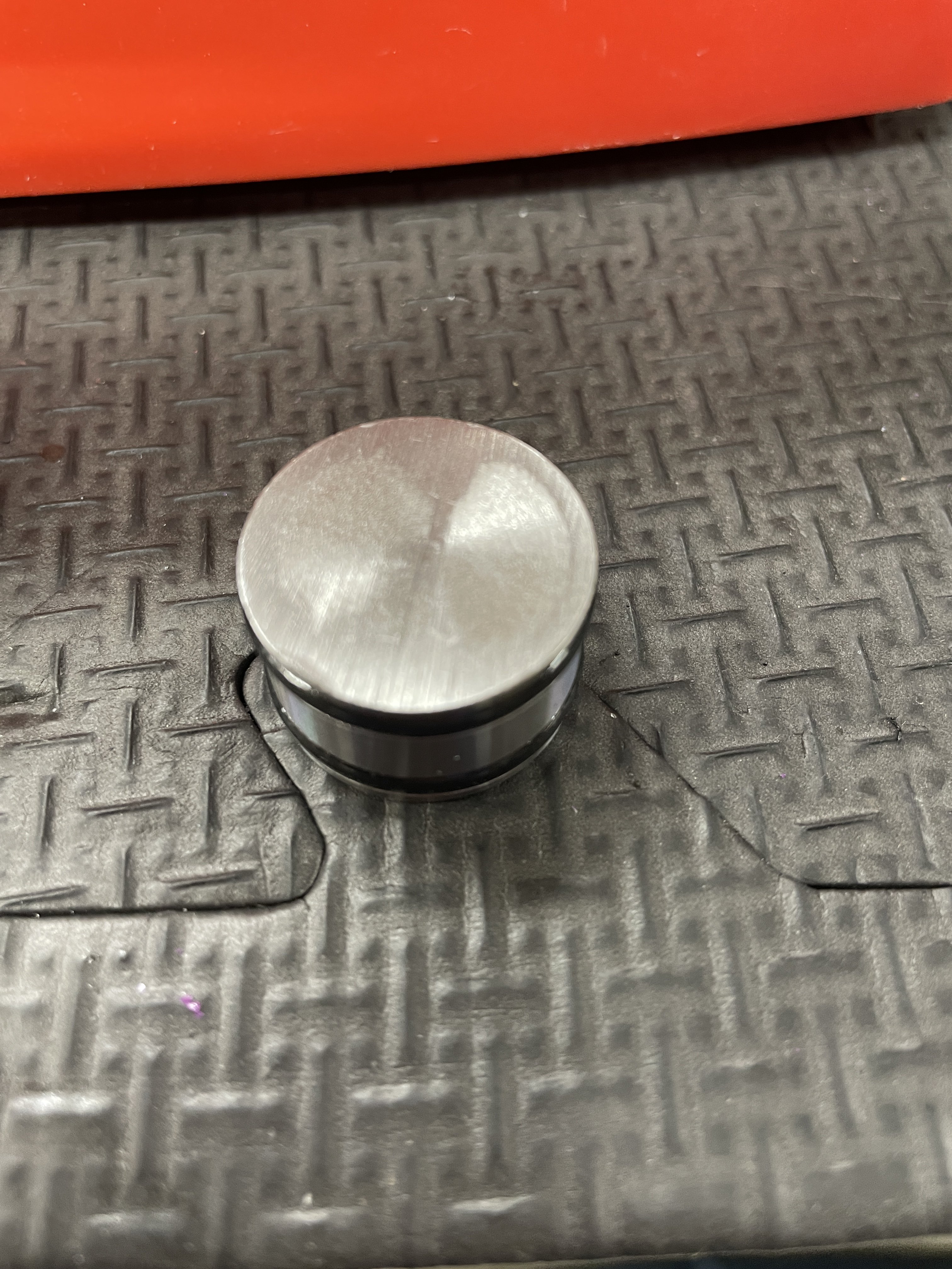

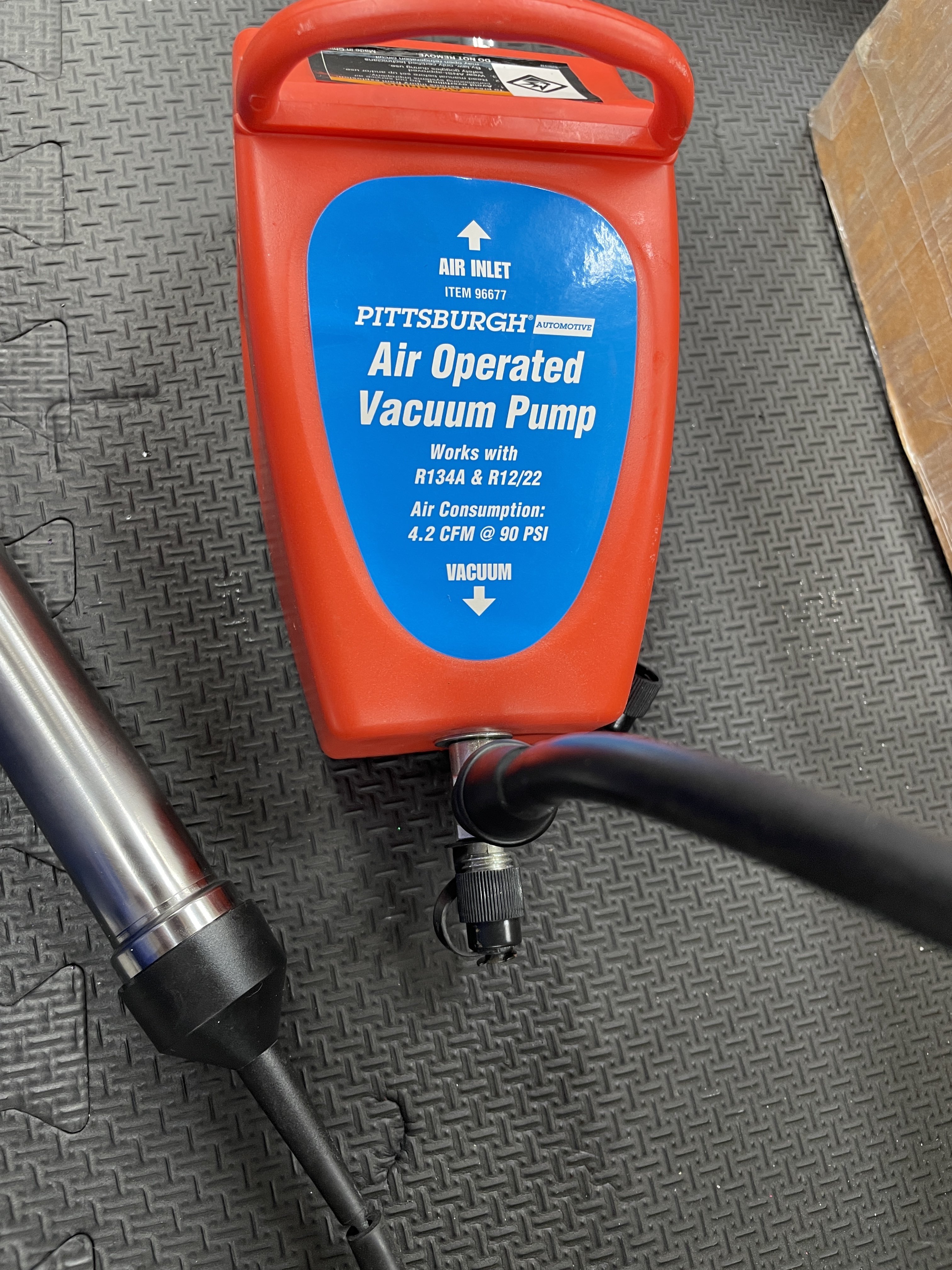

The inertia weight removed. This was not easy since this model does not have a hole in the center of the inertia piston which creates a vacuum. A vacuum pump and some redneck plumbing parts were fabricobbled together to create a vacuum strong enough to remove the piston.

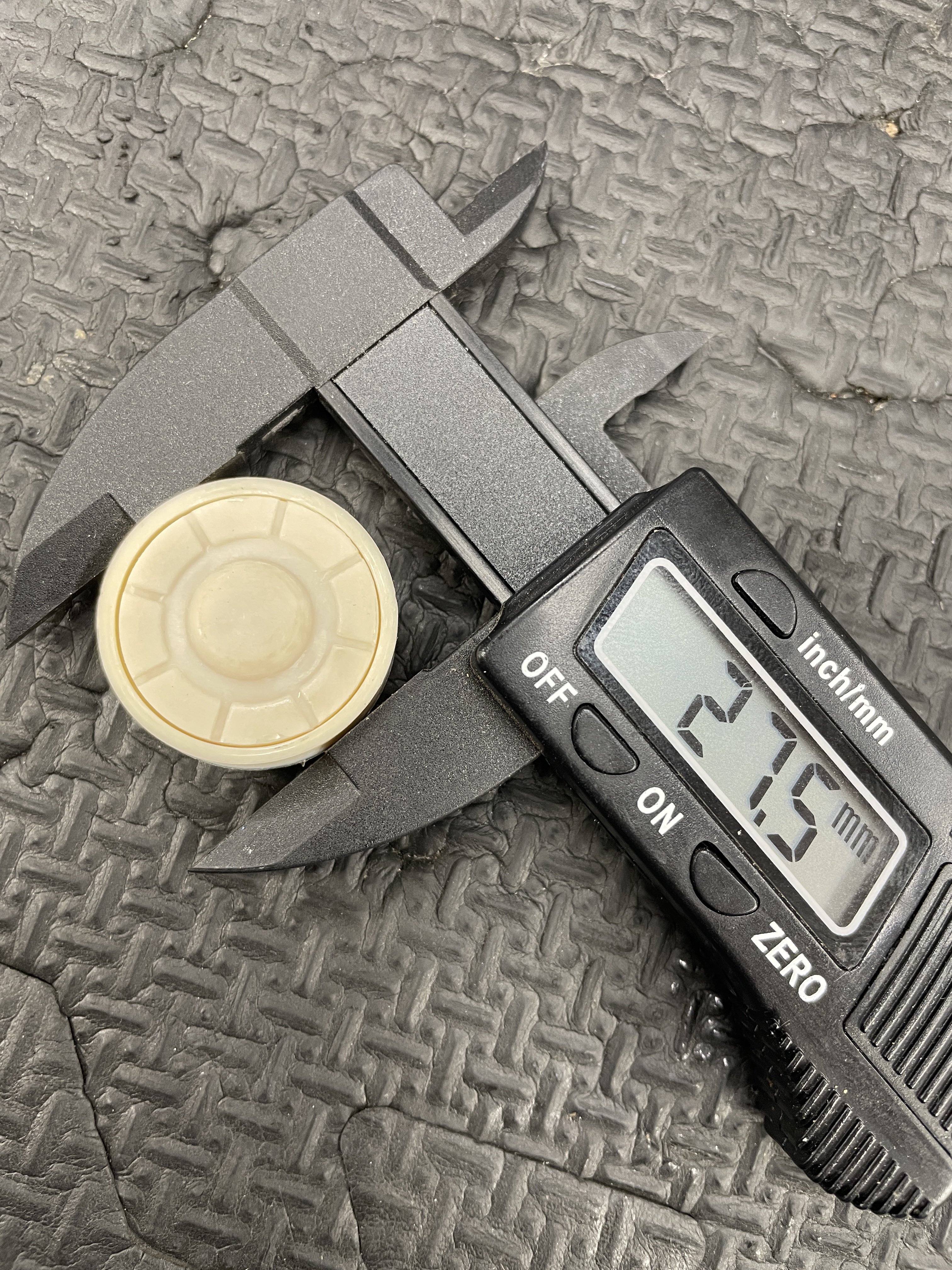

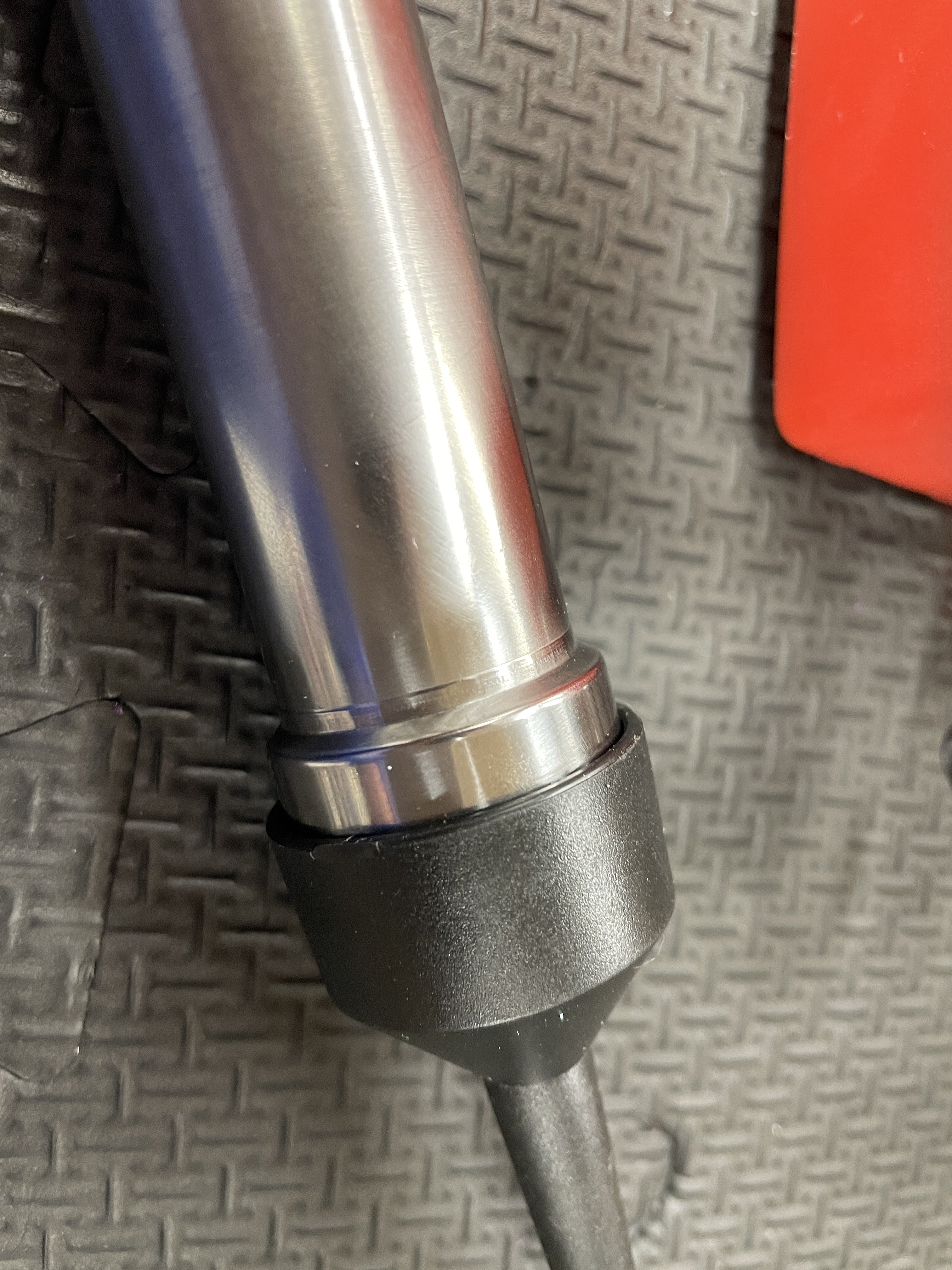

A new piston crown was installed and sized to fit just just right.

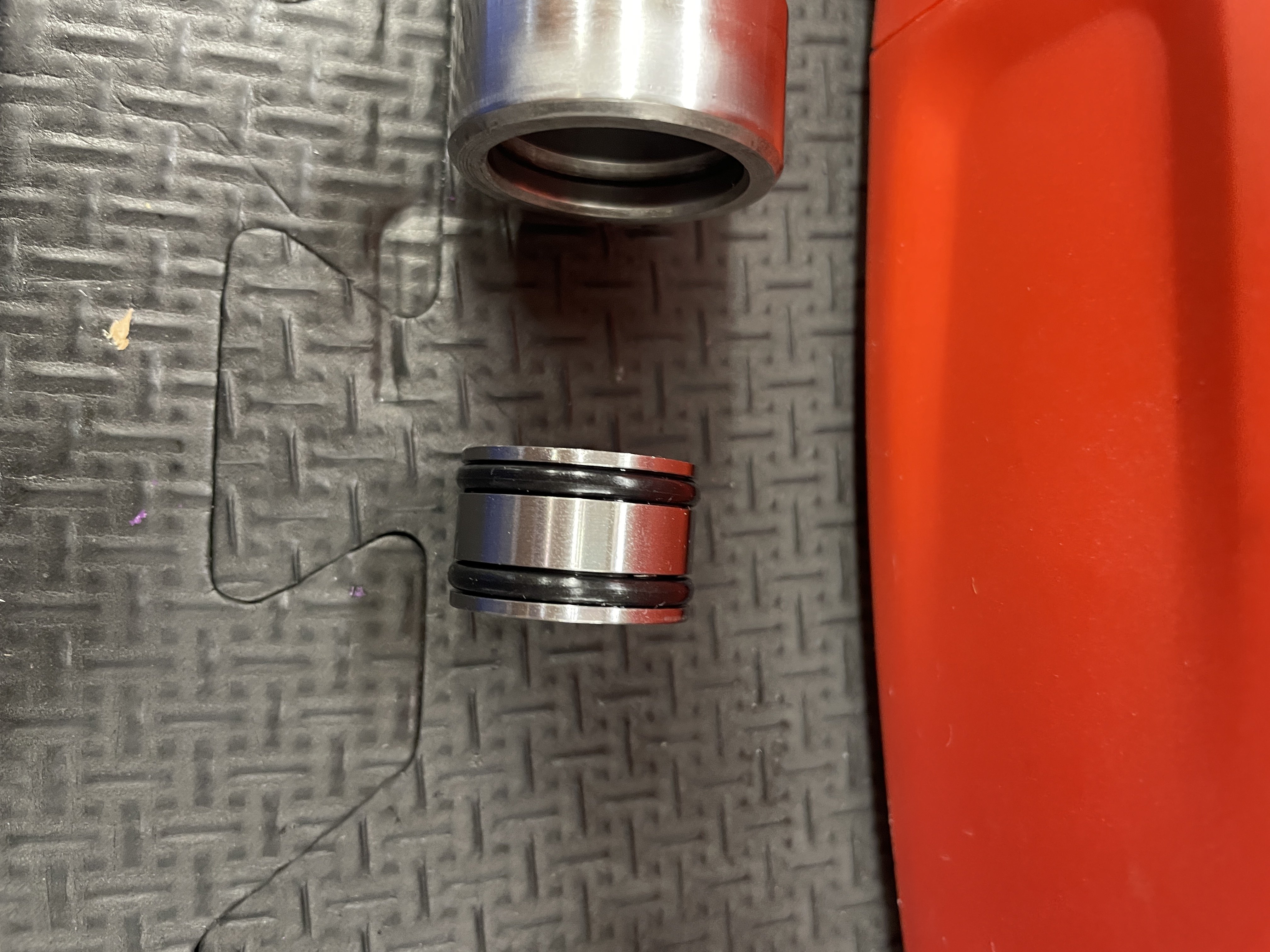

If you missed it, see part one here... https://www.airgunnation.com/threads/theoben-slr-reseal-part-1.1272941/ All new soft parts were installed. Appropriate lubricants for each application. Superlube silicone synthetic greasewith PTFE for o-rings contacting metal. Moly Disulfide for...
