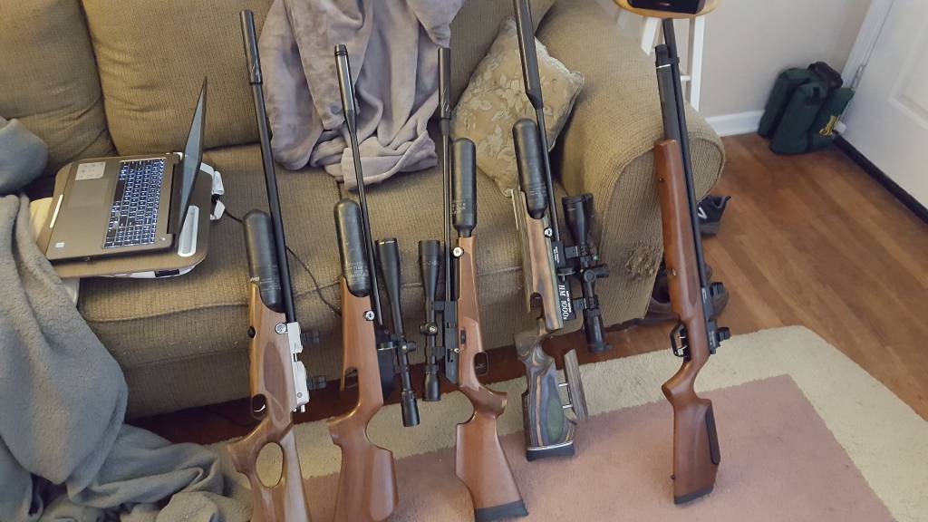

maybe buy another gun and keep your rapid like it is when you get it back , i did a v-block on mine a few years back , also added a silencer because mine didnt come with one , accually found one like most of them had from the factory !
also did my super 10 , had to cut the brace out of the way to avoid using the big brass block thing , more work but looks a little better and not as heavy, also cf tanks on both , both guns accurate and fun to shoot . my v block came from The UK. on the BSA , but i think the raw would have worked , anyway try it like it is , much easier to fill now !
