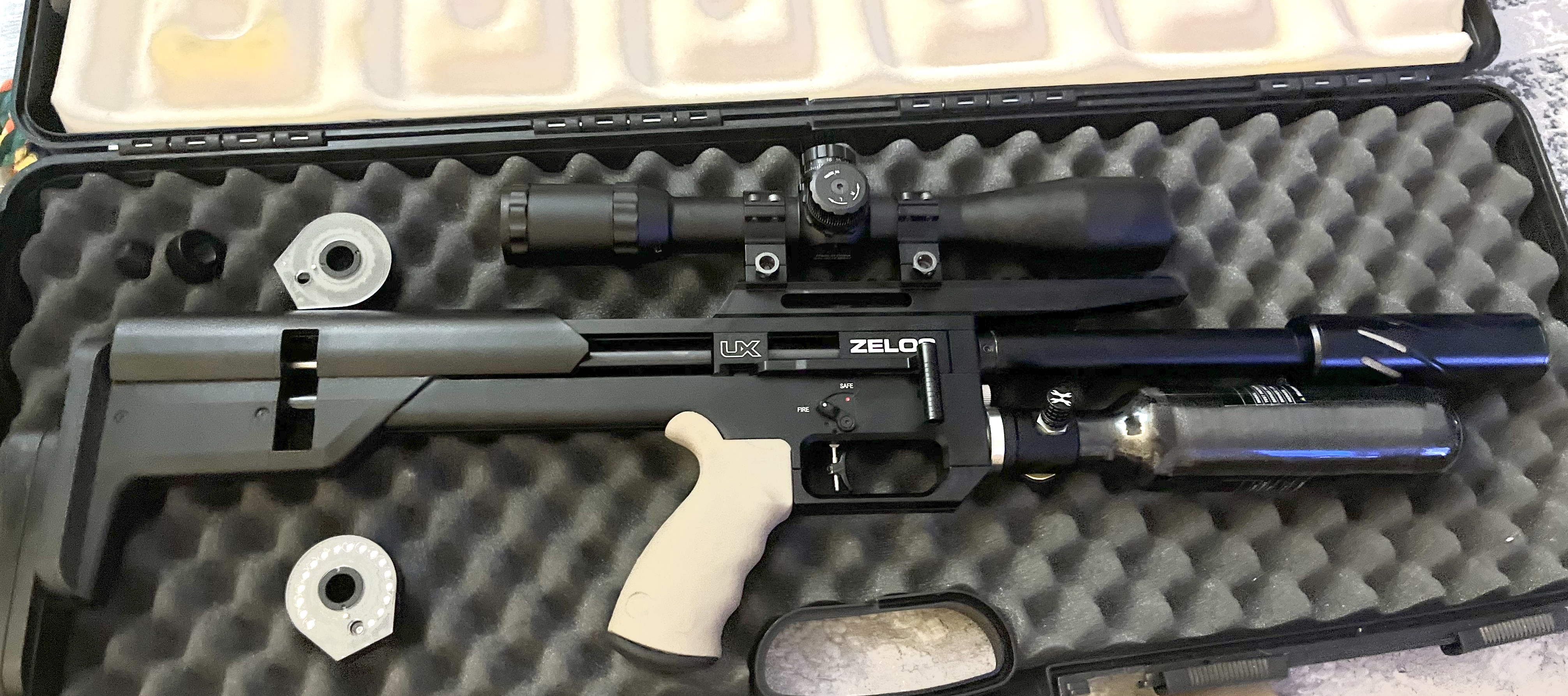

The New Zelos in .22 cal Arrived it's such an amazing rifle. I set the reg to 2,500 , and filled it up to 3,625 I used the 28 grain HP slugs from Hatsan there APOLO line , and got 20 regulated shots with the Chrony reading between 893.2 to 893.8.
The ZELOS is very small , and would not fit my shooting rest , so I had to shoulder the stock , and use the front part of the rest. I attached a new Spina 6 x 36 x 56 30 mm tube scope the center of the retical is a circle I really like it. The ZELOS really loves these 28 grain slugs they are very accurate. Sighting in the scope was fun , and the last 6 shots I made sharpie dots about twice the size of the slugs. I was very wobbly holding the rifle to shoulder , but got off a few good ones anyway. It was just 45 feet to target , but that is all the bigger my back yard is.😆OV.
