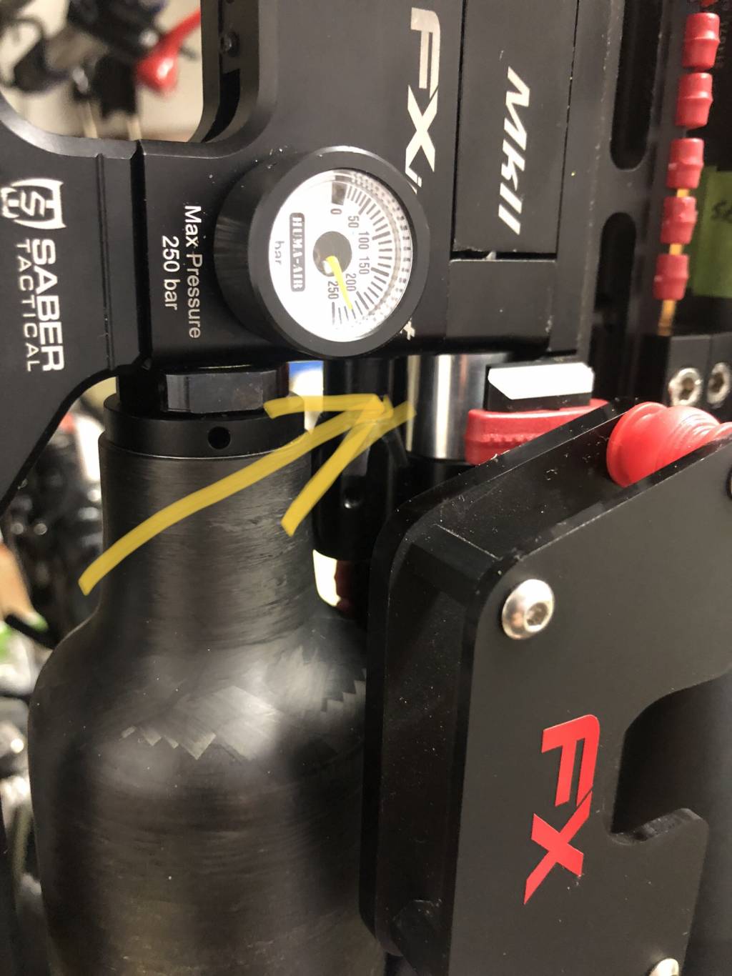

the tensioned barrel I got the idea from biohazard and instead of carbon fiber, I had parts custom made awhile back for the 700 and 600 barrels. Even designed them to allow the valve knob to move further out w/o running into the shroud. Here it is tucked away hidden by the impacts scope rail-
Undergoing testing currently. I think this, combined with the bottle to shroud clamps I always use, will give me the accuracy I seek
My point with all this is to show that there are other means and methods to achieve the same results, all depending on what you seek out of your impacts platform-
