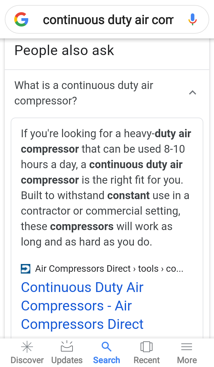

Anyhooo here's an answer to the main question-
