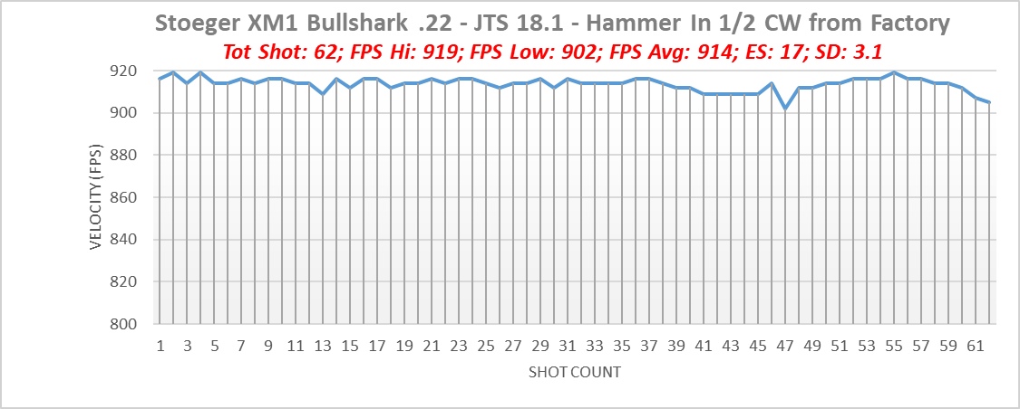

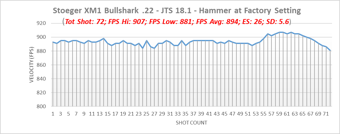

Below are two shot strings; The first is with original hammer setting , and second is with hammer clockwise 1/2 turn to increase fps. Take note of the very respectable ES and SD. The hammer maxes out at bout 935 fps, so I backed it off 1/2 turn.
Hammer Spring: Factory Setting;
BAR: 250-125
Hammer Spring: 1/2 turn clockwise from Factory Setting;
BAR: 250-150
