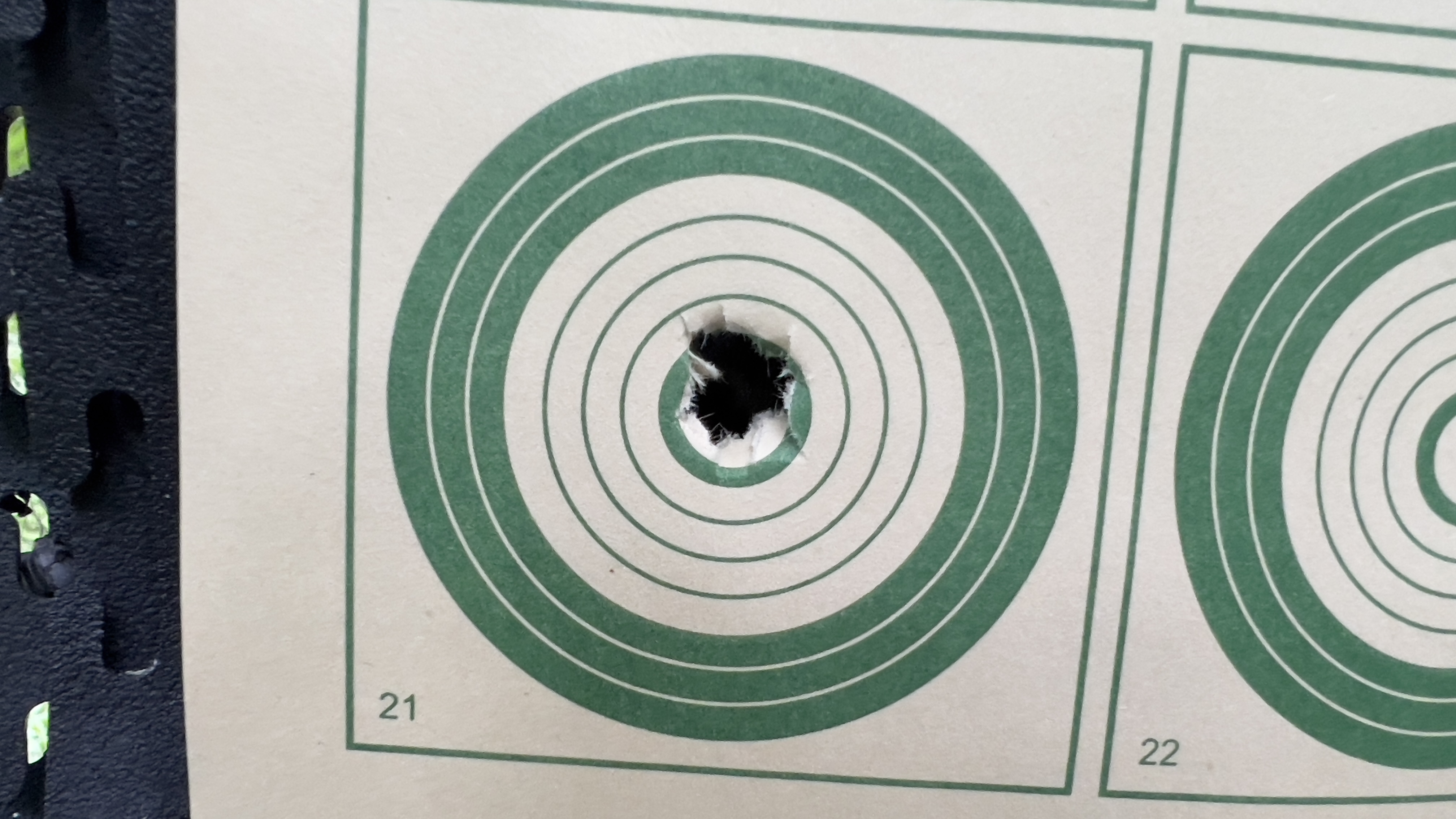

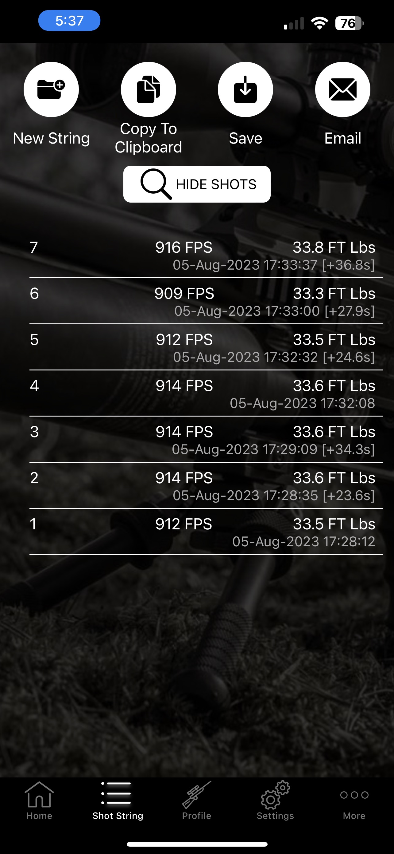

Thanks for all the info guys, newbe here. Got bullshark in .22 had air in it. cleaned barrel - patches never came out clean, just constant black ring around. Told myself lets go. Cocking stiff- drop of oil all ok. Air up 200 bar Great bullpup it does all the things you guys say except 2.5 to 3 inch groups at 55 yards? Since all the #'s are alike that only leaves the barrel. So, I cleaned again, still bad. A friend told me to scrub barrel get BROWN scrubbing pads from hardware there for metal he said. tied a small piece on a string pull thru and a drop of oil, scrubbed till my arms were sore cleaned, tested Now one ragged hole at 55yrds best shooter in the stable hard hitting for a .22 fps 970 16.gr AArms 33.5 fpe. Your milage may very. Thanks again.

Sorry I didn't mean to mislead anyone. I'm new to this form. I have been involved with pcp guns since the start. The barrel was removed from the gun o ring removed. My point was, to clean the barrel till you think it's clean, then clean it again. My first cleaning was not good enough. I don't know if this barrel is normal or if the one I got was super dirty. My friends advise was correct the "brown scrubby" was the answer and shrunk my groups to a single hole at 55 yrds.
