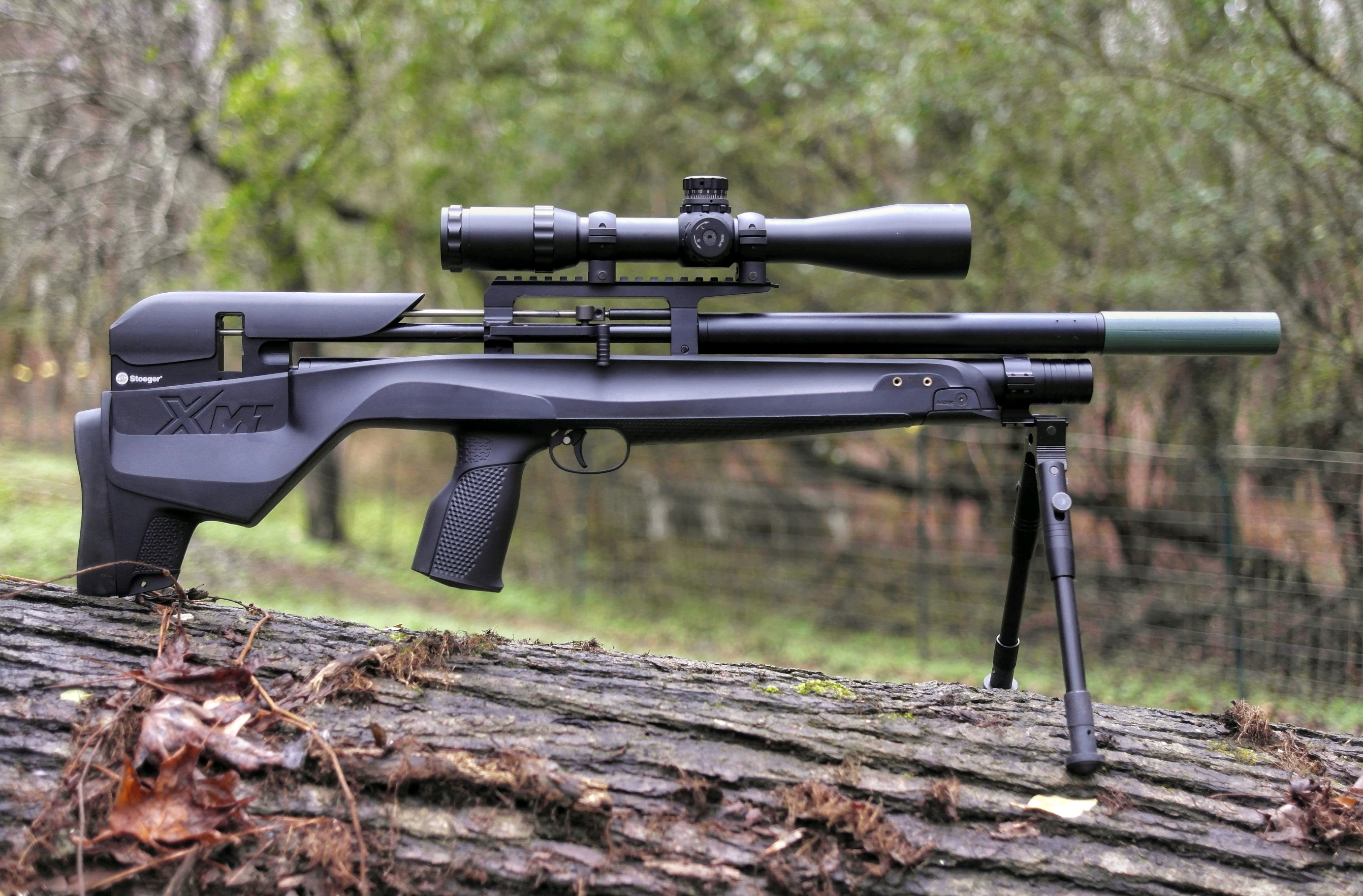

So far we know that the Stoeger Bullshark has a different stock, different baffles in the shroud (2 piece), and a different end cap on the shroud to take a moderator. The rest of the gun seems to be the same as a P35. I like my P35s but wouldn't mind having that Stoeger end cap. I have a Tanto laying in a drawer. My P35s are low to mid 80 decibels - quiet enough - but if I could buy those end caps I'd try the Tanto on them.

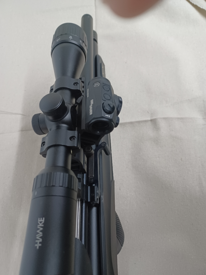

Just for fun I added my Romeo5 red dot to my Bullshark. I was able to rotate my mil dot scope 90 degrees so I could have my red dot on the right side of the gun . I have the red dot sighted for closer targets and it's fun using it. I am also going to try mounting the dot on top of scope with the scope ring I bought that has a picatinny rail on it to see how that setup works in comparison. This setup lets me have kind of the best of both worlds in being able to use either scope or red dot.

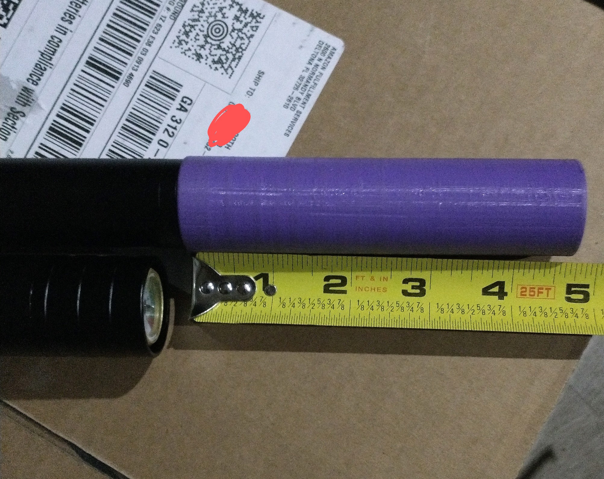

I got mine today. 2 turns on the hammer spring has me at 975 with 10.3 Knockouts and it loves them. I'm going to work on my trigger tomorrow and try the hair curler baffle mod too. I took all of the baffles out of mine and installed a 3d printed suppressor instead.
Ed, does your moderator attach to the fitting on the end of your shroud or go into the shroud? On my P35s I use moderators that go inside the shroud but I think there is less space for them in bullsharks. My 32fpe P35s are about 80 db and the 19 fpe 177 about 75 db with their in shroud moderators. But I ordered the adapter today from DonnyFL and will try the Tanto I bought for my Avenger on them when it arrives. I don't really need them to be quieter but I am curious what the combination will be like. The in shroud moderators I'm using are 120mm long. I have to slide the shroud forward almost 1.5 inches to insert them. But nice and quiet with no clipping is worth it, I think.
I am probably slow in figuring this out but the bull shark has a barrel that is 1.5 inches longer than the P35. 19.25 inches versus 17.7? inches (450mm). It also weighs a pound more - 6.2 versus 5.2 lbs. The barrel is probably an ounce or two of that but the stock would seem to be the main weight difference. Still a light and short gun. The barrel difference is made up by having 1.5 inches less room in the shroud for noise mitigation measures. Doesn't matter if you put an external moderator on it but I prefer to do the moderation in the shroud. If you do that, the bull shark ends up 1.5 inches longer than the P35.
