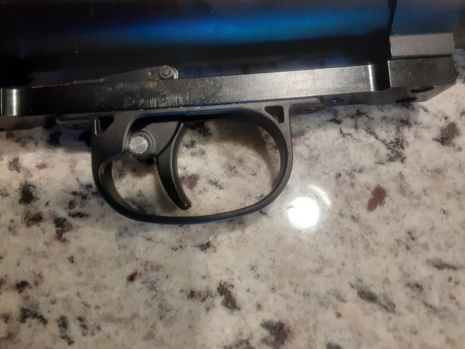

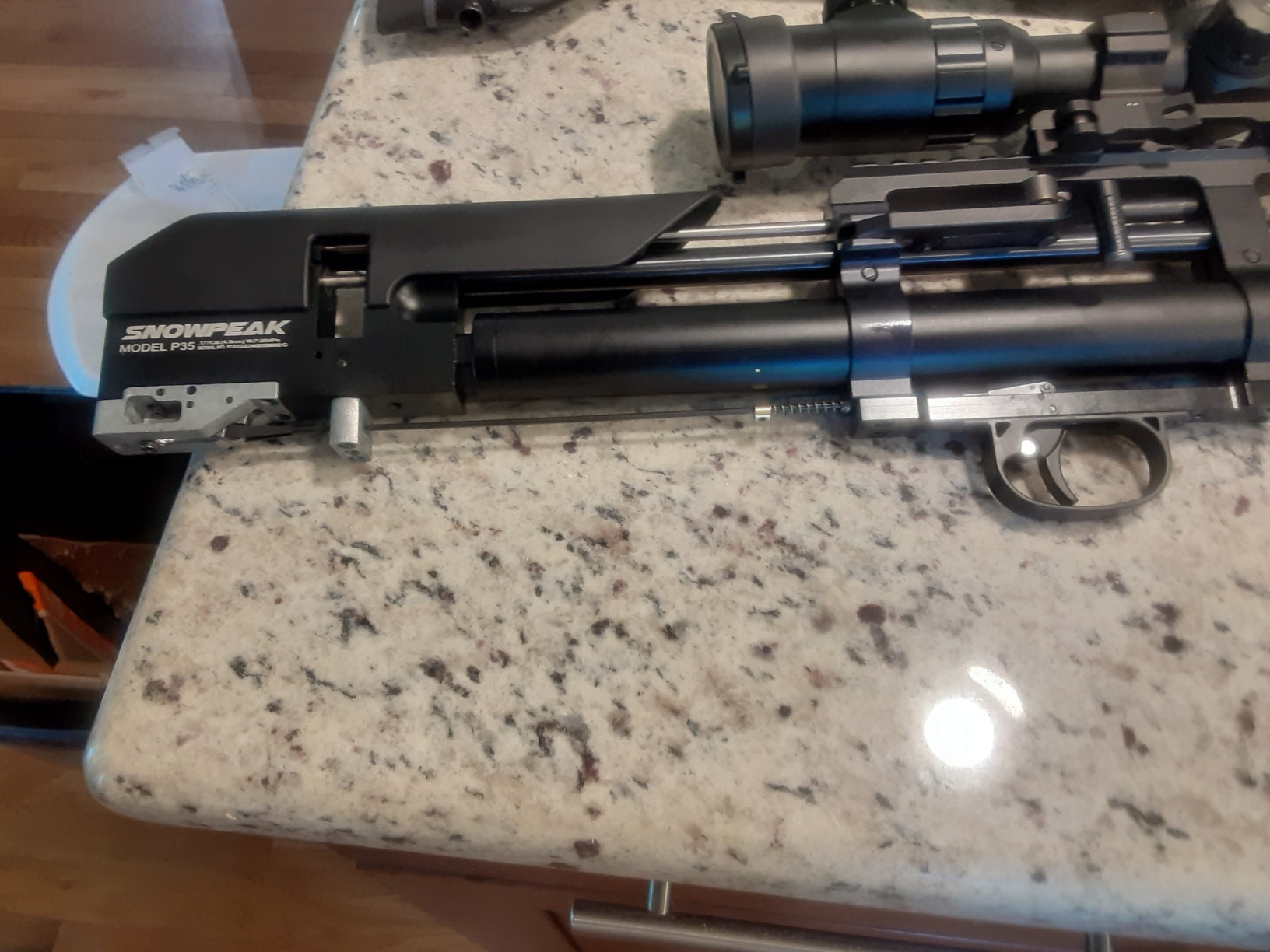

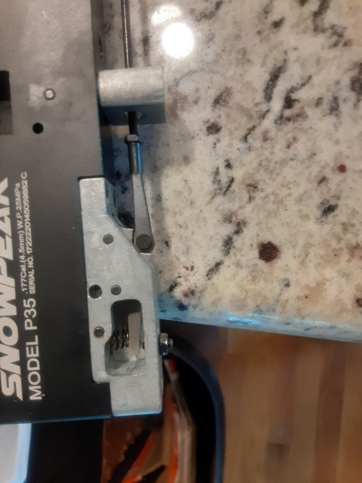

I was trying to improve my 30 yard challenge score with my P35-177 (no luck) and had a problem that might be useful to others. I shot a target and got 1 more X and 1 more point than my previous score - essentially no improvement. But the trigger didn't feel great so I took the action out of the stock to adjust it. I backed the sear engagement off about 1/4 turn and tried it and liked how it felt out of the stock. Then I put it in the stock and took it outside to try. It would not fire. So now I have a pellet in the barrel and no good way to get it out. I could have used a cleaning rod but what I did was take the action out of the stock (outside) and lift the sear lever with my pocket knife. That caused the gun to go off discharging the pellet safely (gun was pointed in a safe direction). Now I could take it inside and see what was going on. I messed with the sear engagement thinking I had gone too far but that was not it.
I found a pin where I had the action out of the stock on my kitchen island. It was the pin at the top of the trigger. I should have thought of that, it happened once on my P35-25. With it back in, I reset the sear engagement and proceeded to fire an even worse target. Oh well...
I will include three pictures. One is the whole trigger group. If you guys with Stoegers take your stock off please confirm that your parts look like this. I will also include a close up of the trigger where if you look close you can see the pin that came out right above the trigger. The last picture is of the sear adjustment and sear lever. The screw with the lock nut controls sear engagement. Turning it clockwise decreases engagement. You have to loosen the lock nut first. Be careful if you do this, you can cause your gun not to cock or you could cause an accidential discharge. In the picture of the whole trigger group you can see a spring that looks it could have come from a ball point pen. That is your first stage spring. At the end nearest the sear there is collar you can move to increase or decrease the first stage trigger force. It adds to the second stage. So just relaxing this spring will significantly reduce your trigger effort with none of the risks associated with messing with the sear engagement. I have my P35s set to under 1 lb pull and they are crisp, no discernable creep. It is safer to leave a little creep.
