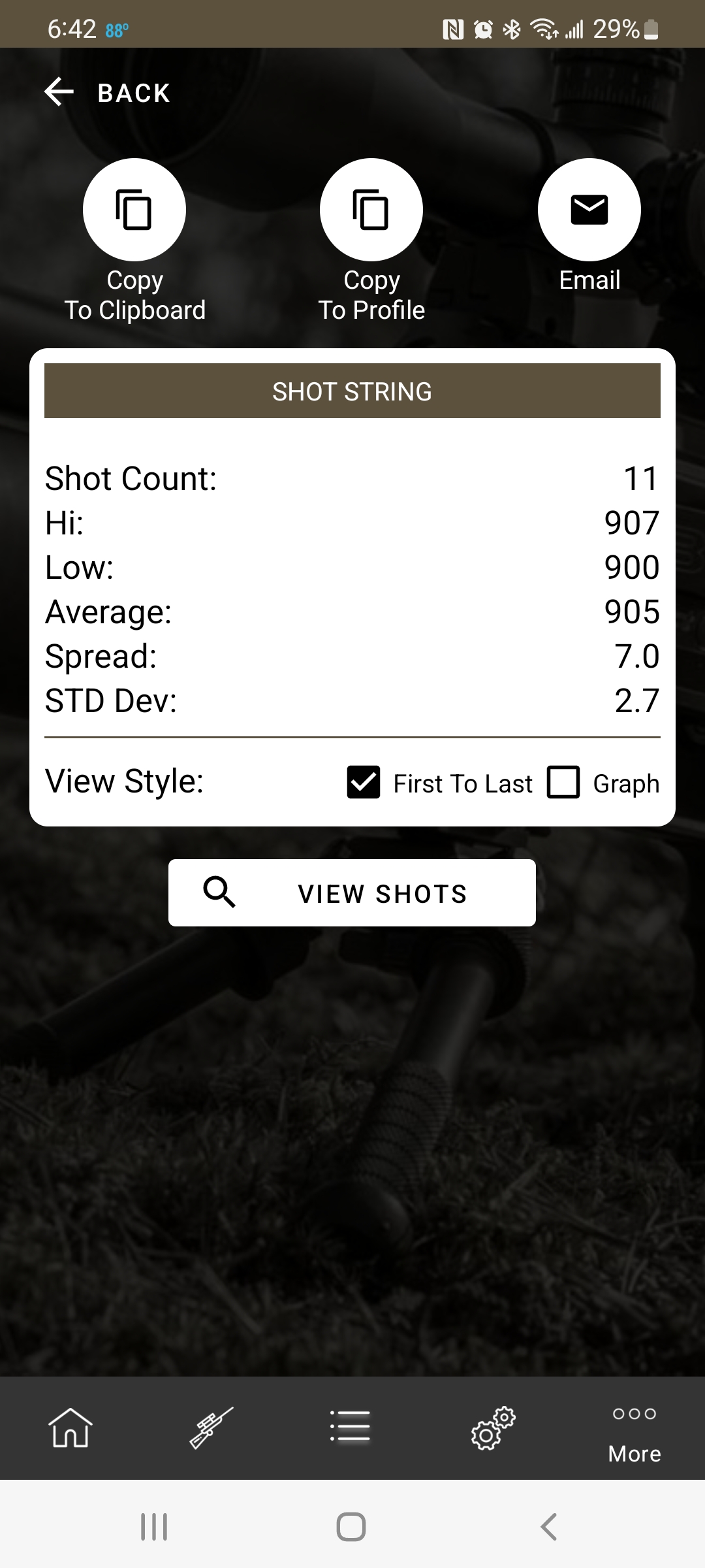

It is a rebadged P35 with extras and available on Amazon. I have a P35 and a friend has the Bullshark so I have had them side by side and shot both. The Stoeger shot great out of the box pushing FX 18 at an average of 905. My P35 was terrible to start with but after 2 sessions with JB bore cleaner and 2 DIY recrowns it shoots good now with the same Fx 18 pellets at 840 average.

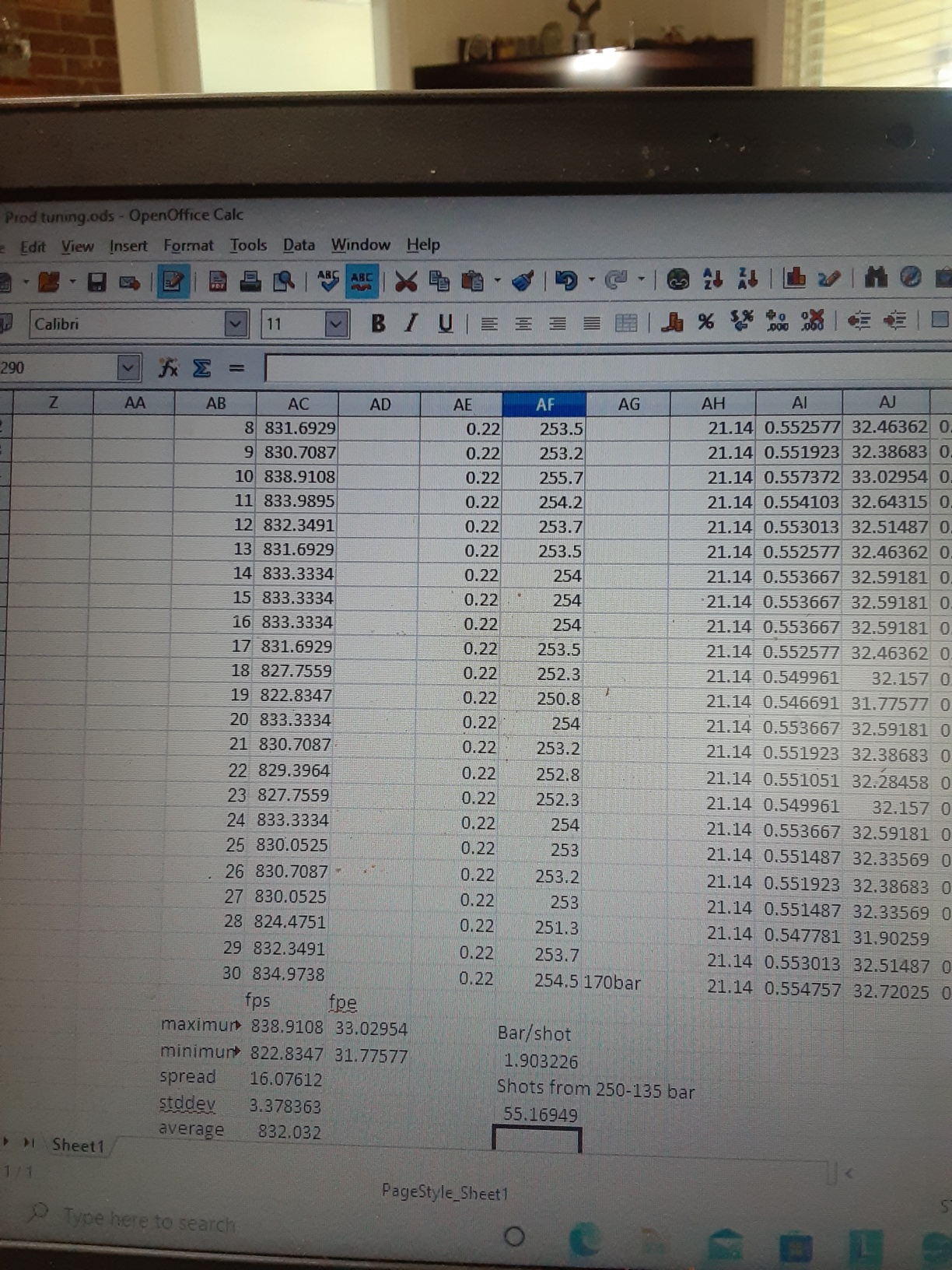

I thought some more about Crash611's input and while I want to believe it, I have short shot strings for my little P-rod that are about that consistent. I also felt bad that I had no decent length shot string for either of my newer P35s so I shot another 30 yard challenge target with my P35-22 and added a few shots to get it up to 30 shots. That is not a full shot string for it, I think it would do a little over 50. I'll include a picture of my laptop screen to give you an idea how the shots were varying. It is definitely not the bell curve of an unregulated gun like Deeder describes. The ES was 16.08 and the std deviation was 3.38. The lowest shot was shot 19 about in the middle of the string. For an unregulated, the early and late shots are the lowest.
Crash is probably right but I'd love to see some velocities at close to 250 bar, then something like 190 bar and then 135 or 140 bar. If the Stoeger is regulated, they will be fairly consistent (less than ~20 fps spread) and the high and low pressure shots will not be the lowest. If it is unregulated, the shots in the middle of the pressure range will be the highest and the shots at the high and low end will be the lowest. Deeders gun may have a quality issue but he describes a classic unregulated gun.

I'll see if I can get my friends gun again and do a full string he just wanted some base numbers. So I only ran the factory 9 shot mag with crossman CPHP 14.3 for a 972 avg xs-14 sd-4.3 next my P35 carm 11 shot mag FX 16 for a 944 avg xs-10 sd-3.6 then FX 18 11 shot in photo above for a 905 avg xs 7 and sd of 2.7. Just like my P35 it was more consistent with the 18 gr over the others.
