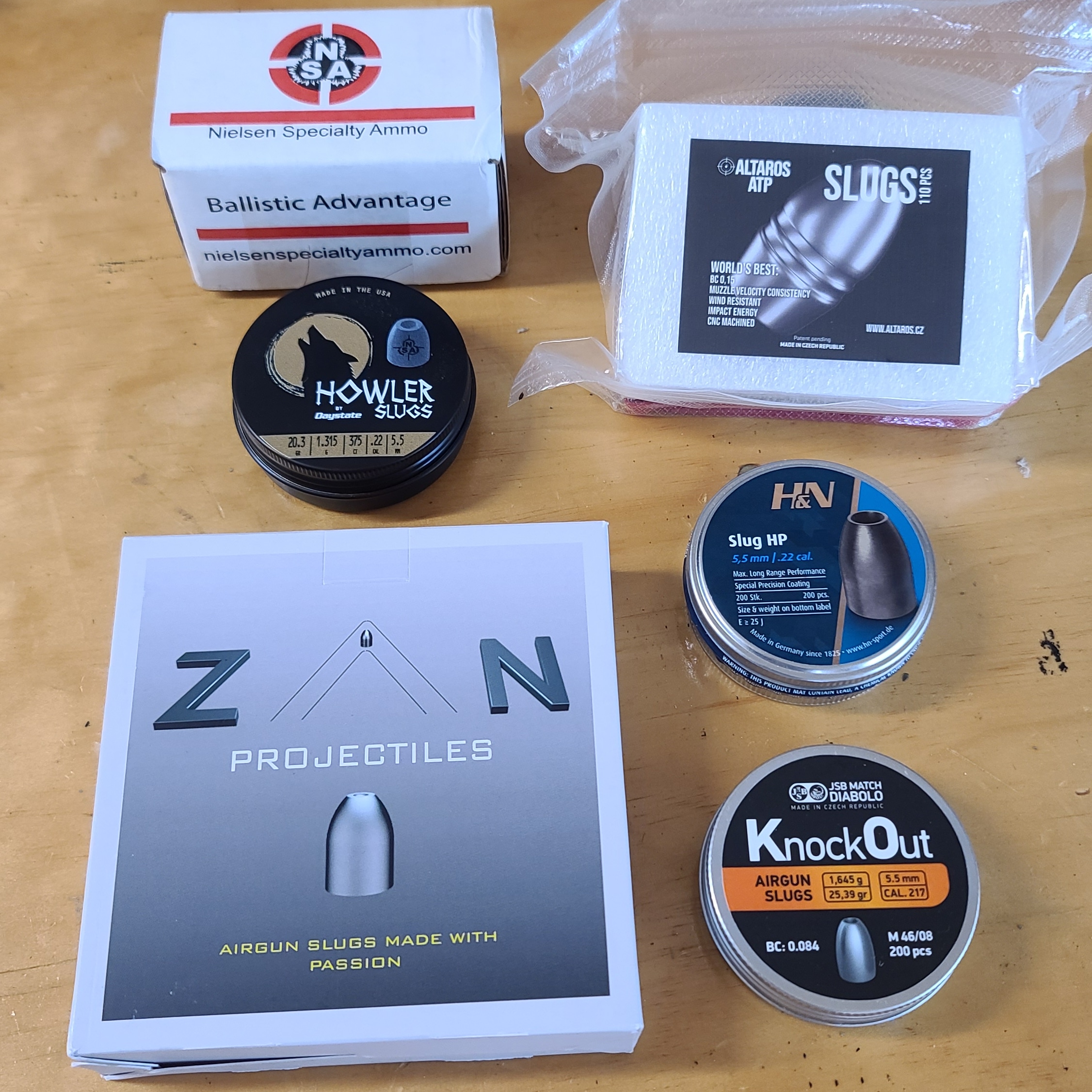

    Which slugs are you shooting out of which airgun with success?

    My Air Venturi Avenger 22cal has proven to really like three slugs in this order
    1. FX Hybrid - 22 grain
    2. H&N 0.217 - 21 grain
    3. JSB Knockout 0.216 - 25.39 grain
      [/LIST=1]
      I'm running these at about 850FPS. I'm getting about 1" groups at 75 yards consistently even in moderate wind.
      I think that it is interesting that the H&N 0.217 work well and the JSB 0.216 work well, but the JSB 0.217 are not as consistent as the same diameter slug in H&N. Proof positive that these barrels like what they like.
