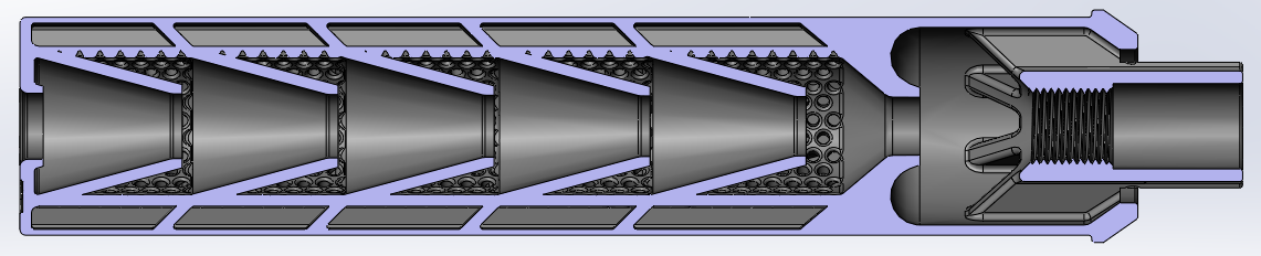

I am currently testing a printed mod from @subscriber which is wickedly quiet and very accurate.
weevil,

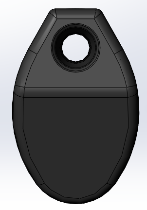

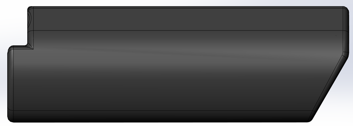

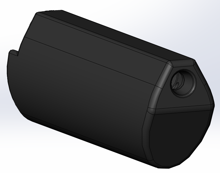

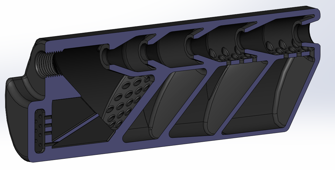

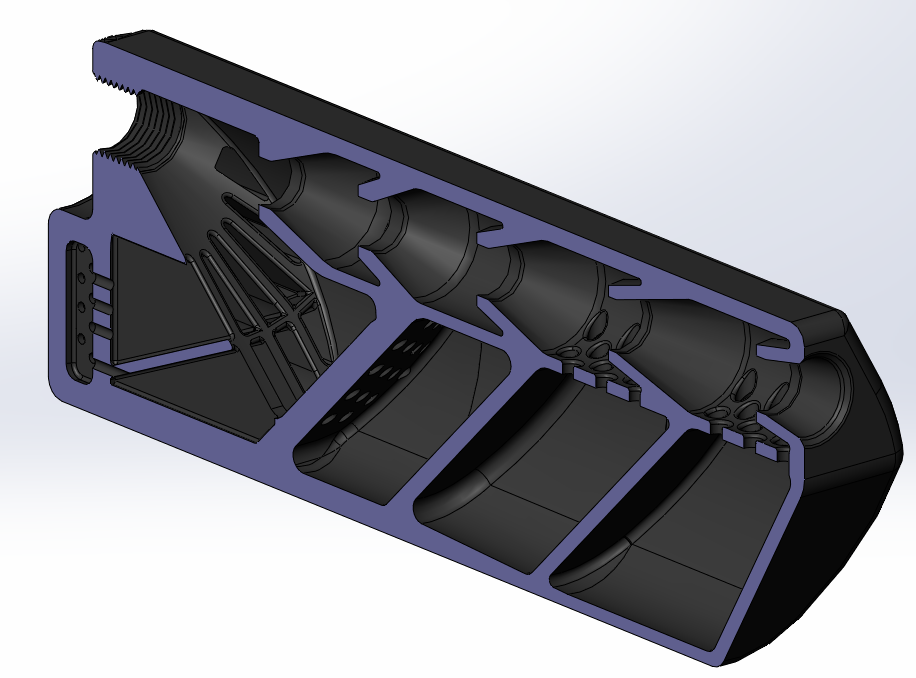

If I remember correctly, you are using the oval muffler with the slanted front end; as shown below? Firstly, for those unfamiliar with the design, the low flat top is to enable the use of the stock open sights on the Huben pistol.
I have attached the STL to this post, so anyone can print it for themselves, or for others. Just note that the part needs to be rotated so the threads are facing up, away from the platen. This orientation is so the internal structures will be self-supporting for printing.
The threads will need chasing with a 1/2-20 tap. Designed with more material to provide a stronger thread for full power use.
If you do not have a printer or a friend with a printer, I recommend you contact forum member @TorqueMaster, as he was part of the team that developed this muffler.

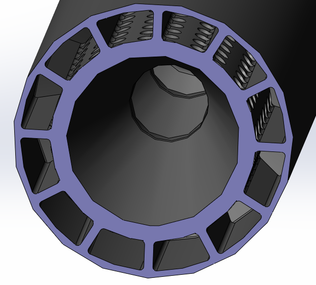

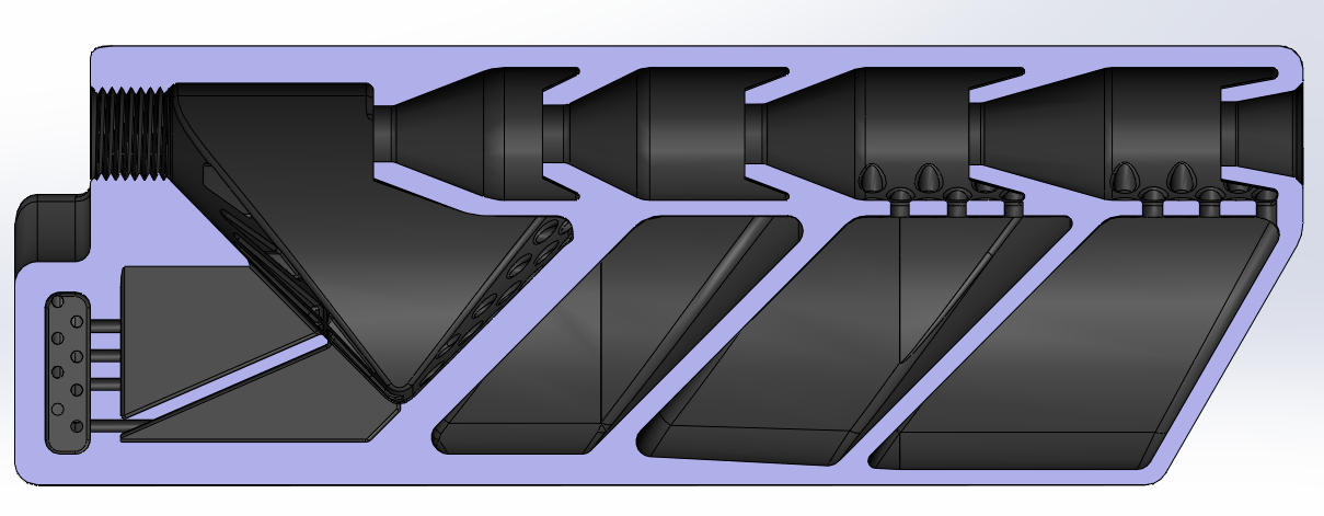

Looking at the cross-section images below you will notice that the wall thickness is quite heavy around the first expansion chamber; then steps down towards the front. This is done for strength where the bulk air pressure and initial air surge impact is the highest - as the projectile uncorks from the muzzle. Then, the bulk pressure drops with each expansion chamber stage towards the front, so the walls can be made thinner, to reduce overall weight of the muffler.
As I have no control over your printer, settings, material type or material quality, there is no warrantee or acceptance of liability expressed or implied. You are free to use the design on your Huben pistol, or not. Now, my Shorty Huben pistol muffler has uniformly thin walls and none have blown up from normal use.
So, the oval muffler shown below should be very robust, assuming it is printed from PETG at 100% infill, as intended; at appropriate settings for nozzle temperature, filament feed, traverse speed, and horizontal and vertical resolution. The use of a "print raft" for platen adhesion is highly recommended. If you need detail print setting recommendations, PM TorqueMaster.
