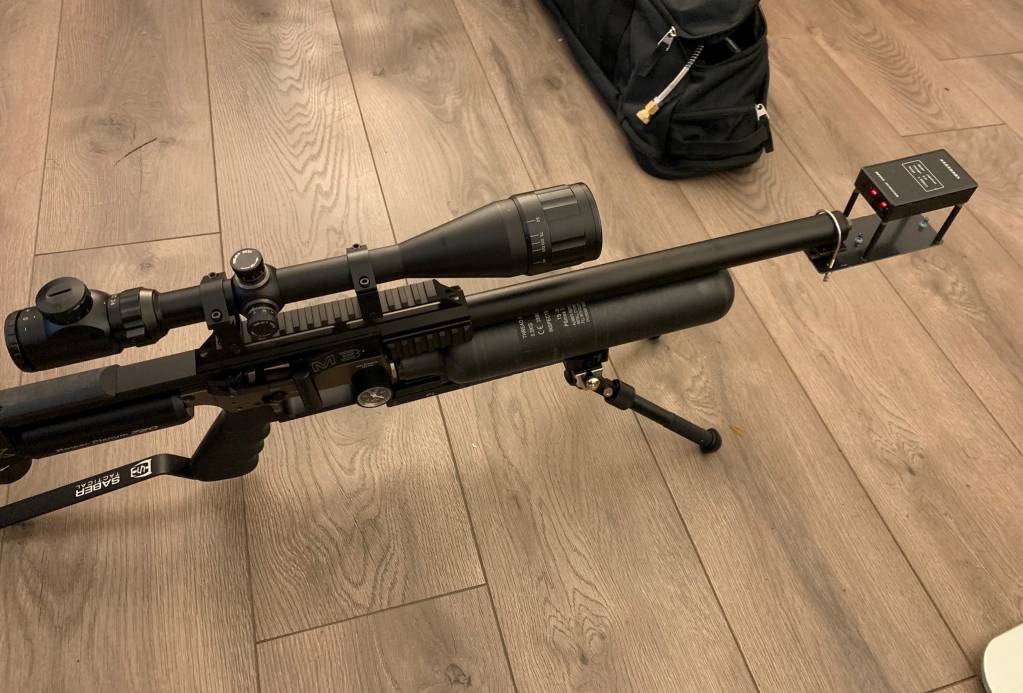

I have the Caldwell and FX chronographs (and a couple others). for me, the FX wins hands down. Built a mount that attaches to a pic rail out of half inch PVC I had laying around and a spare scope ring. Setup at the range is about 30 seconds and I don't irritate the range masters by taking time to setup a tripod in front of the bench. Transmits to my phone and I can email the results to my mail box. for me, it ticks all the boxes. It isn't cheap, but I like it.

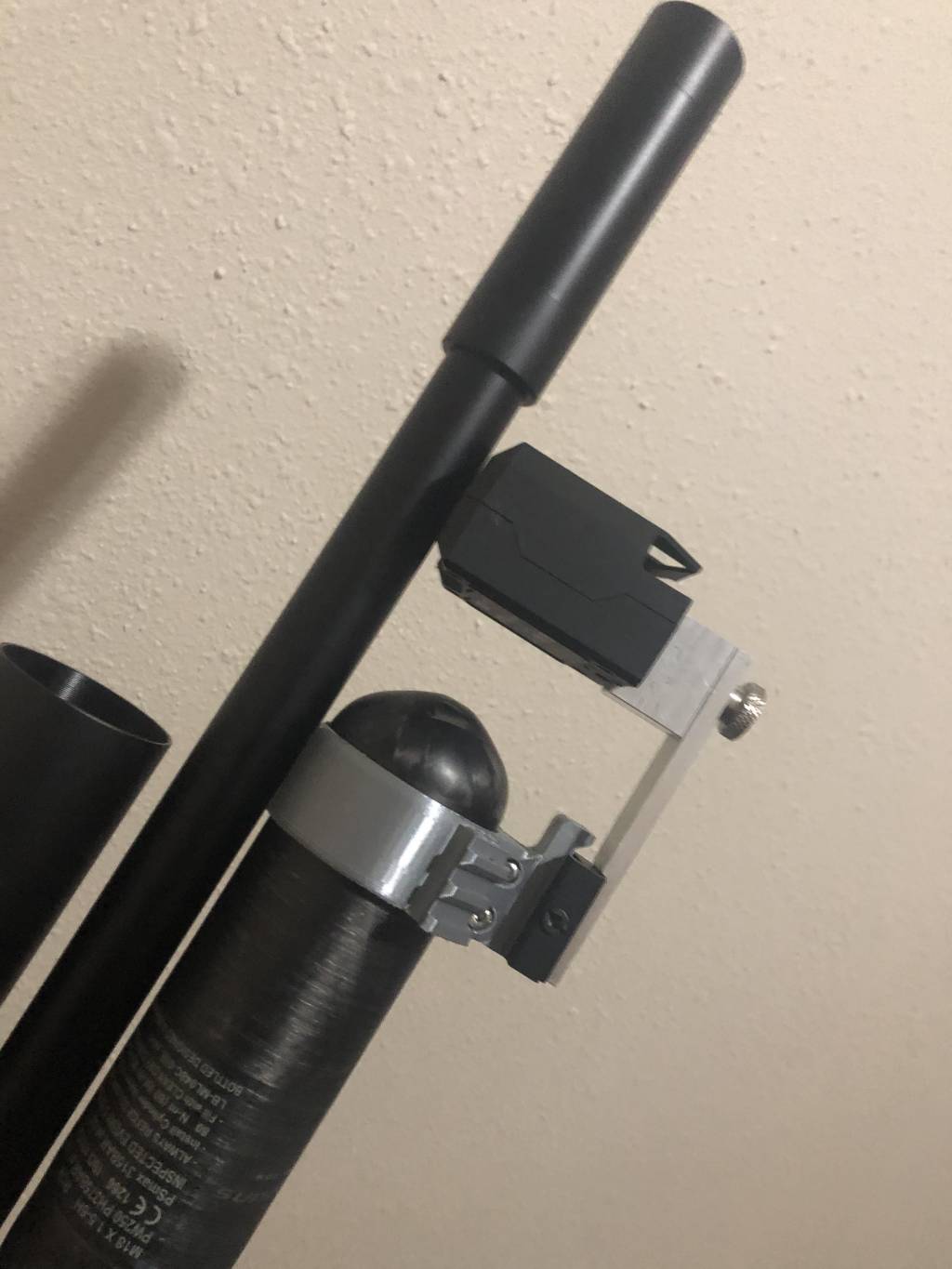

I was inspired by an Ernest video and made an adapter, like others, so I don’t have to hang it off the barrel. I can move around, shoot different targets, and never move the chrono and it gets every shot. Also don’t have to worry about shooting it!
