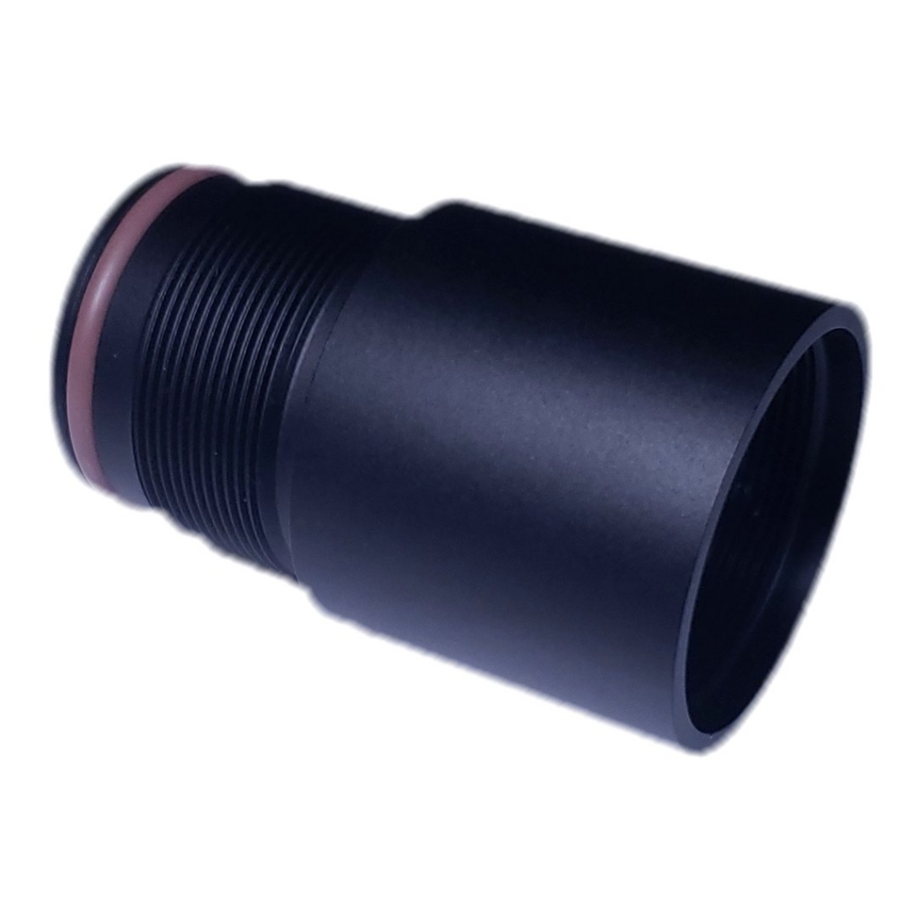

Hello AirgunNation Peoples,
News Flash!
Check this out?
https://910airguntuningandrepairsllc.com/collections/frontpage/products/fx-wildcat-fx-streamline-plenum-single-extension-pre-order-only
You’re the man Ernest!!

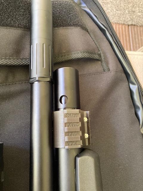

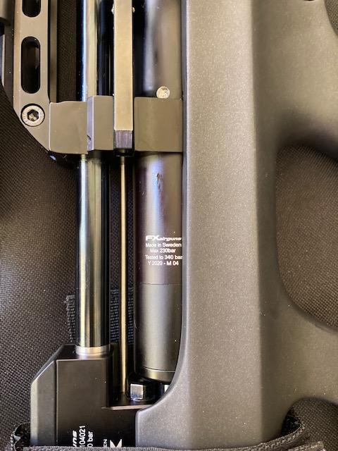

Installed on Wildcat MK3 compact.
nice fitting and as you can see I ended up having the tuning screw from the regulator accessible without having to take the stock off. Because this plenum is slightly longer than the DL plenum the hole is not covered anymore hence accessible without hassle.
an other advantage for me from having the airtube protrude more is that I can fit the piccatinny mount very nicely without any disturbance by the front ring/ fill port.
all in all it makes my WC a better gun for me. I obtained a approx. 40 fps increase in speed by installing the ER power plenum leaving reg pressure the same and tuning approx 4% below plateau in both before and after the PP install.
