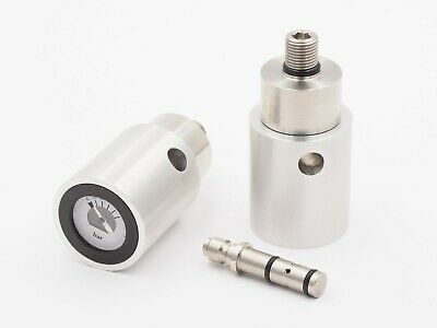

I got a quick fill adapter with gauge for my Steyr LG110 from RAT Works on Ebay, nice quality piece, matching air cylinder perfectly. The Problem is it start leaking at the gauge, I can only fill to 100 BAR and then starts leaking to empty, any idea if that can be fixed?

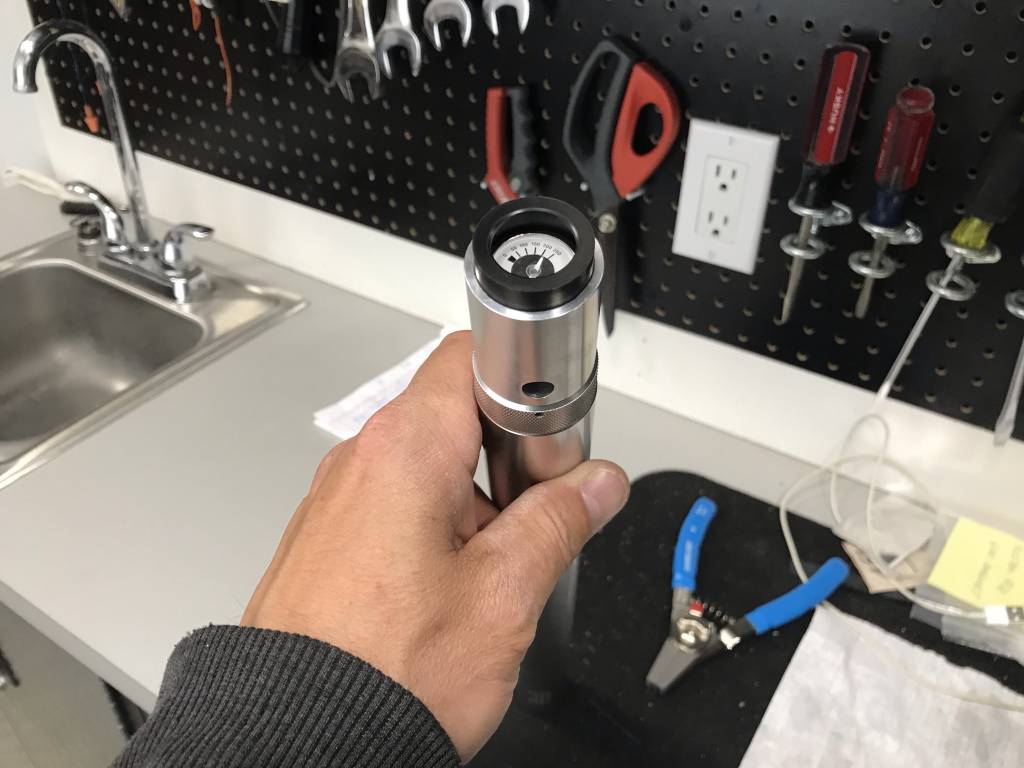

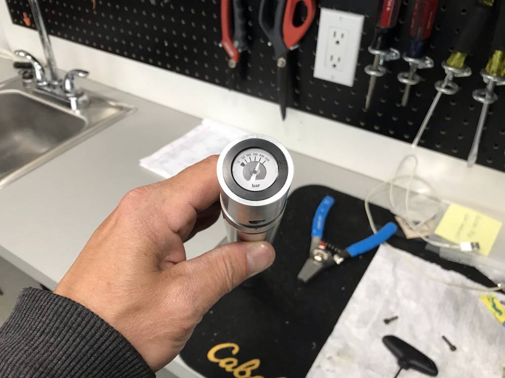

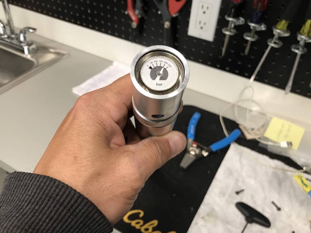

So I finally got the gauge out the other day, to do so you need to pull out black cover and use 22mm thin wall socket wrench. My issue was that gauge wasn’t tight enough ,1/8 turn counterclockwise then you see on the pictures, basically after pulling out black cover I unscrewed gauge by hand. Always bothered me that gauge wasn’t in line with fill port, now perfect in line.
