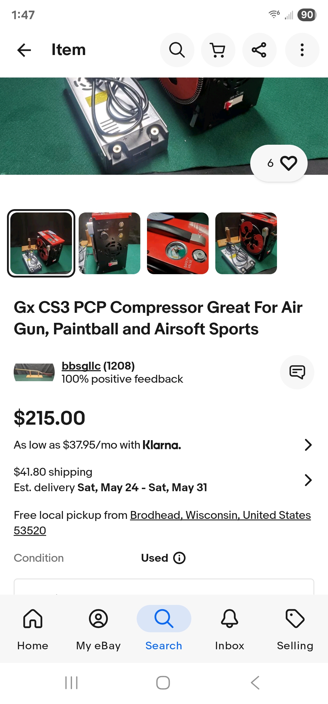

There is a compact Impact M3 at Bakersairguns.com for $1400. Leaves plenty of room to get a GX Cs3 off of ebay or amazon and buy $150 worth of ammo from Pyramid Air, get %11 off right now and over 150 is free shipping.

And for a starter compressor the GX CS3 is a good option, and is currently rebuildable which is nice. They have coupons on amazon from time to time and you can find them for just over $300 sometimes. I would also keep my eye out for a used AGT Uragan or Vulcan, FX Maverick Wildcat Impact DRS Panthera etc here in the classifieds.

If it were me and set on .30, i would buy the Maverick sniper setup, from the classys, this compressor off of ebay,(from a good seller) and then have 200 for ammo from pyramid air. Then you could trade the scope for another small caliber pcp or sell it to recoup a bit.
