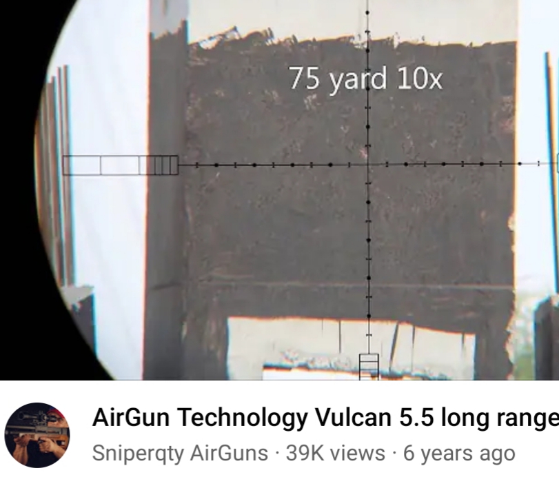

Oh and for the guy saying that the are many video of long range with the impact and no much else...way before all those sponsored clowns .. this was the long range dada pellets only with crickets n Vulcans and now uragans..he has a vid shooting clays at 150y with a .177 ..10.34 g pellets..
