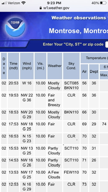

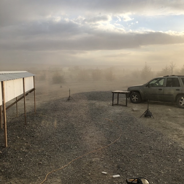

Wind was awful today...but braved the dust storm to test for a short time. It was actually difficult to maintain my eye relief because the wind was moving my head...lol. I shot this 25 shot group at 50y with my 22 cal 40gr slugs.
This barrel was put on the gun in the wind, so I never got a windage zero. Not sure how much it was blowing. I just clicked over near a bull and started shooting. My range faces south and the wind was mostly from the nw 4:30 direction.

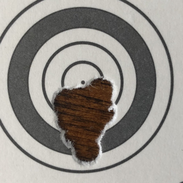

Looks like 24 made it under the spring seat that is .490”. That’s ok in my book given the base wind of 15 with gusts over 20. I’ll call it 1/2 MOA in rough conditions. For some reason the group pics are rotated 90 degrees counterclockwise. Was not able to get them to post correct. Sorry

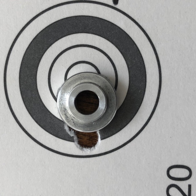

Lets do a little math for the folks watching at home.
1 Moa at 100 yards is 1.047”.
For 1 Moa at 50 yards you multiply 1.047 x .50 = .5235”
1/2 Moa at 50 would be .5235 x .50 = .2618”
Since the accepted way to measure groups is center to center....we need to add the bullet (hole) diameter to that to get the outside to outside diameter that is covered by the spring seat.
.2618” + .224” = .4858” outside to outside.
Since the spring seat that is easily covering 24 of the 25 shots is .490”....this means that the center to center dimension of the bullets under the spring seat are 1/2 Moa.
A more accurate way of doing this is to use the measured size of the actual hole made in the paper. My slugs cut a nice .210 hole.
.2618” + .210” = .4718”.
If it would please everyone....I could machine a disc .4718” and place it over the 24 of 25 holes so that I could show that the 24 is 1/2 Moa...but I think I’ll just say something like....I’ll call this 1/2 Moa in rough conditions. 😀
