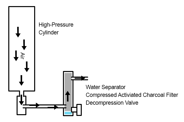

My main concern with the Umarex is how it handles moisture removal. Which I don't think it does at all but they aren't giving out any information on that subject. We'll see.
ReadyAir vertical water separator.
(not drawn to scale)
As mentioned above by an Airgun Nation faithful, you can always add an in-line filter for added moisture protection if you prefer.
