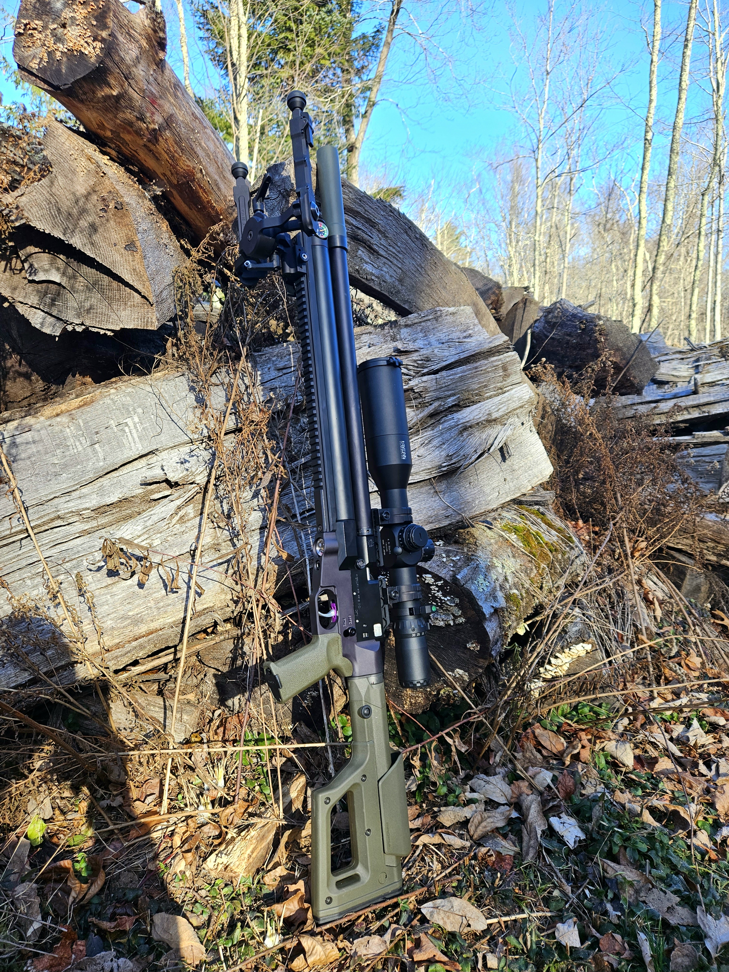

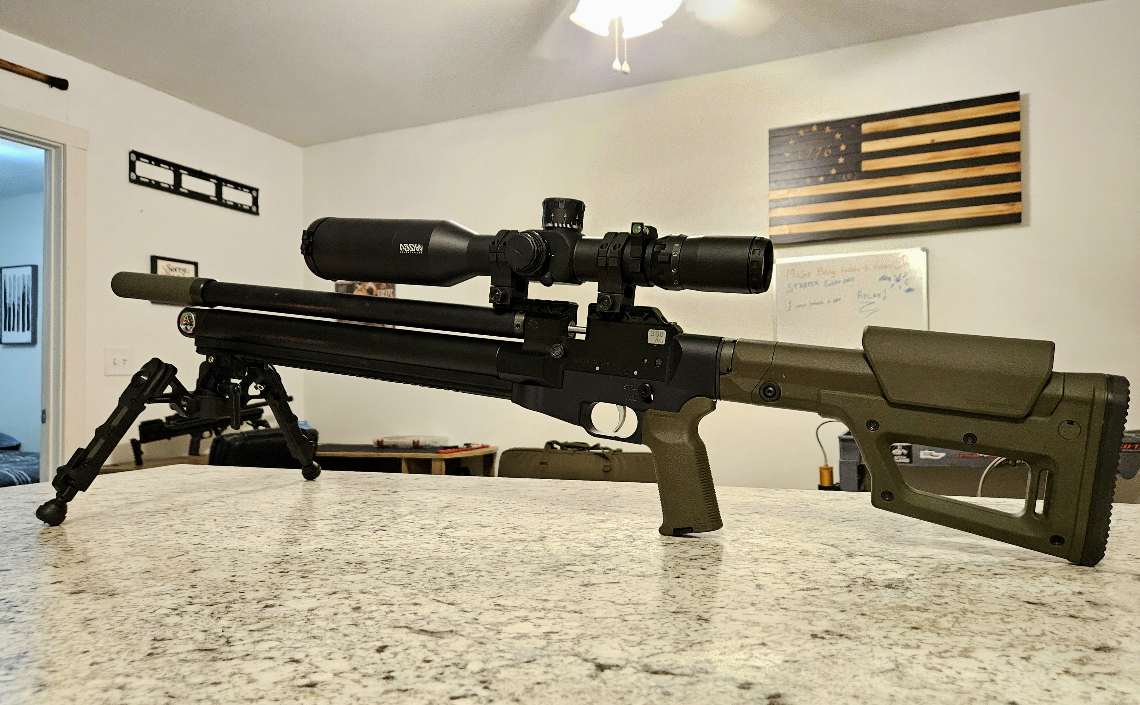

American Air Arms The new Evol HPS. How lucky am I to get to test such a thing?

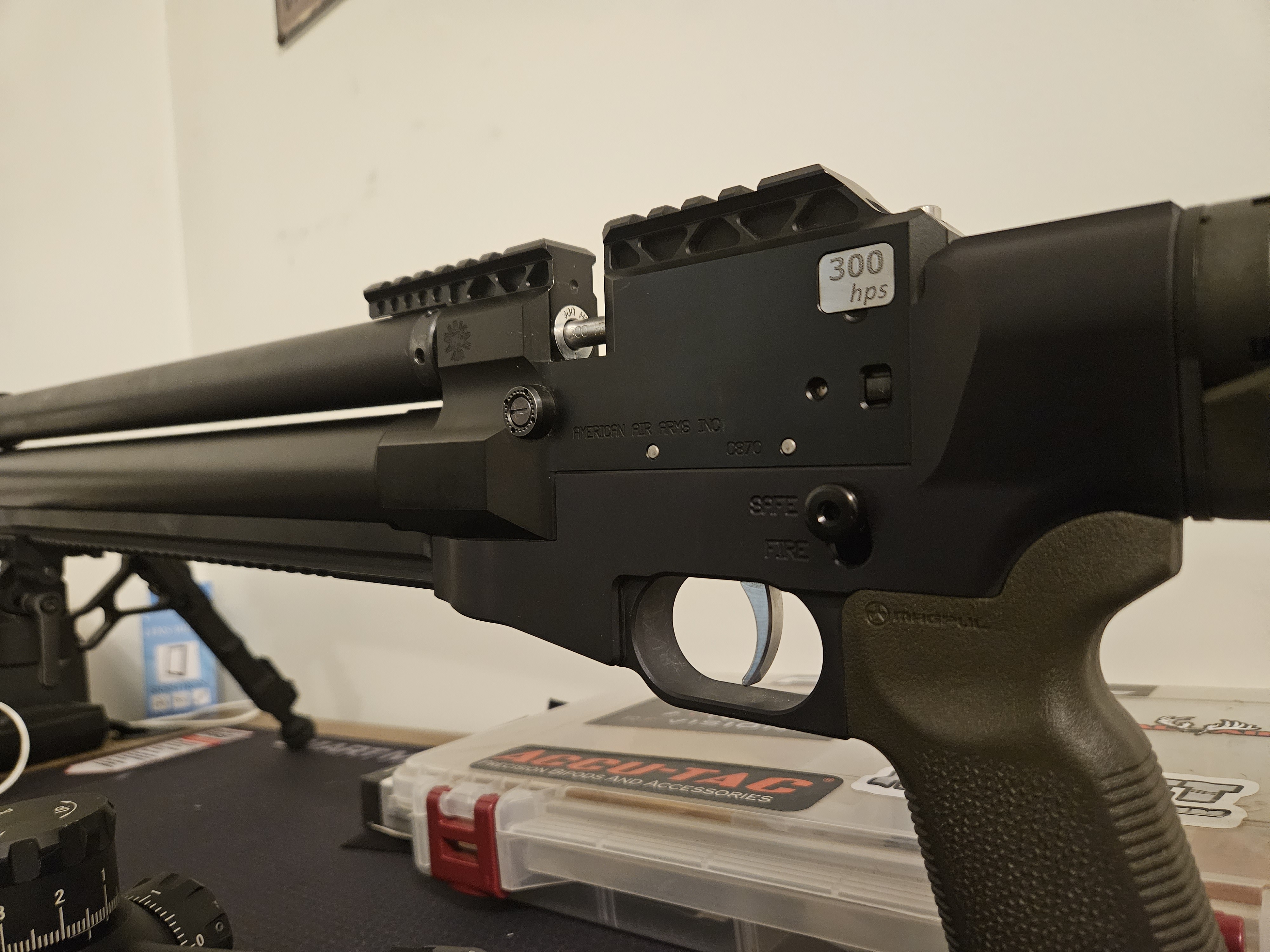

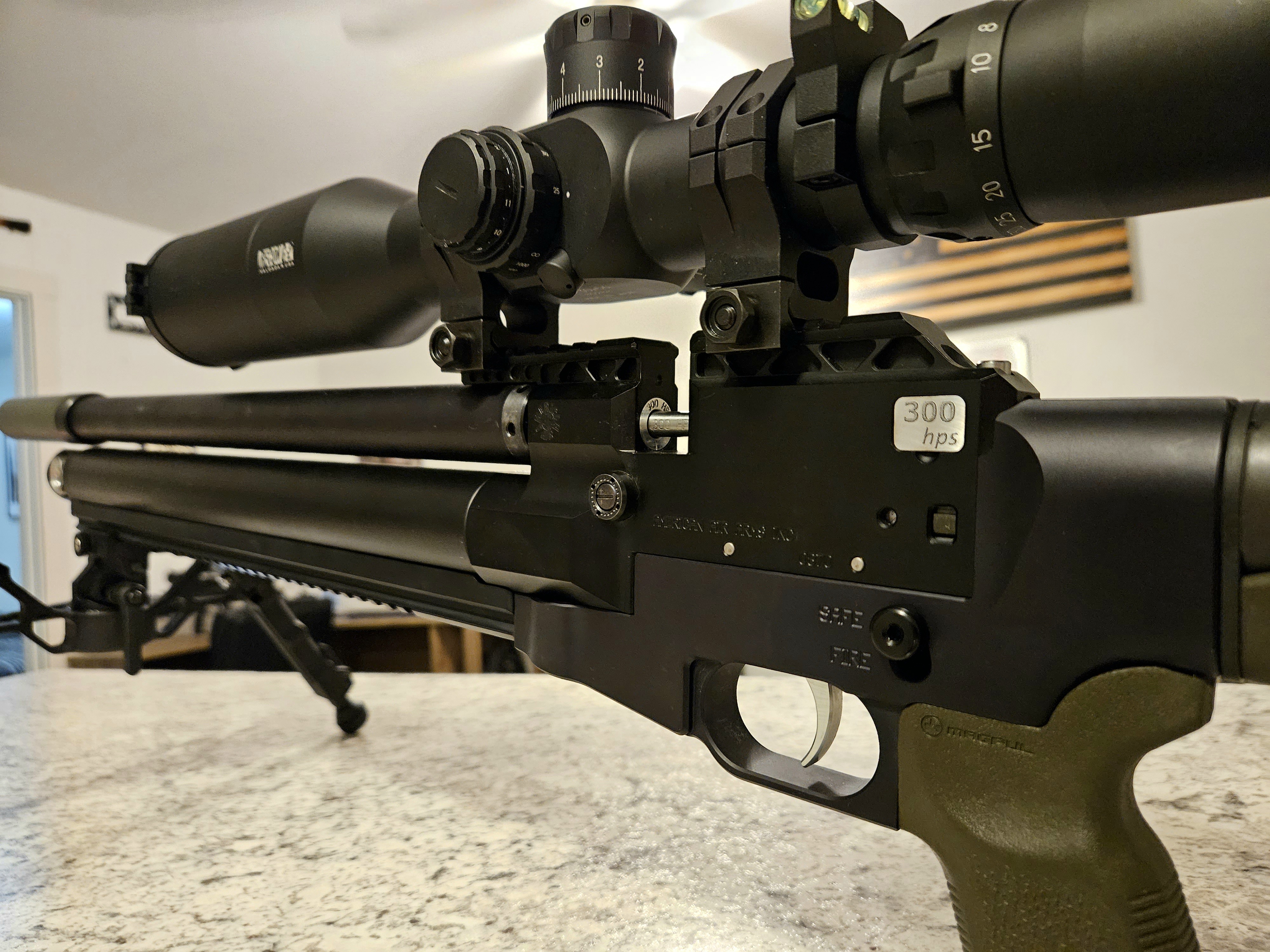

I am lucky enough to be able to test the new Evol HPS. I am also willing to answer all questions I can. This one is setup with a pellet barrel making over 100 fpe shooting zan 56gr.
The new hps is a very cool new offering from American Air Arms.
Some off the cuff things I can say about features are

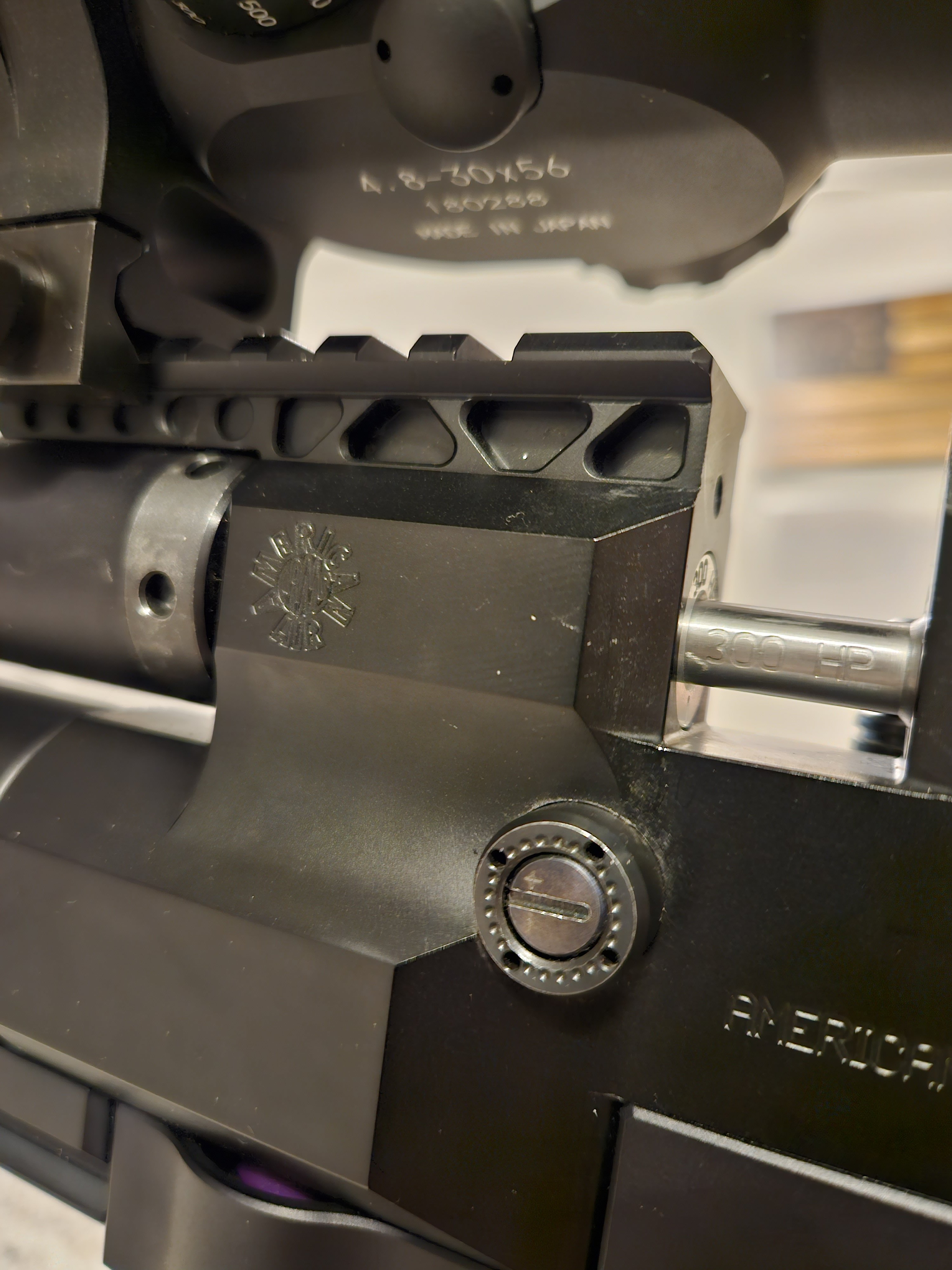

-Full external adjustability from reg, to dwell, to hammer spring.
-Slayer gen 3 balance valve
-Improve HST system, smooth as butter and extremely light while maintaining that robust feel A A A is known for.
-42cc Power plenum (on this particular model)

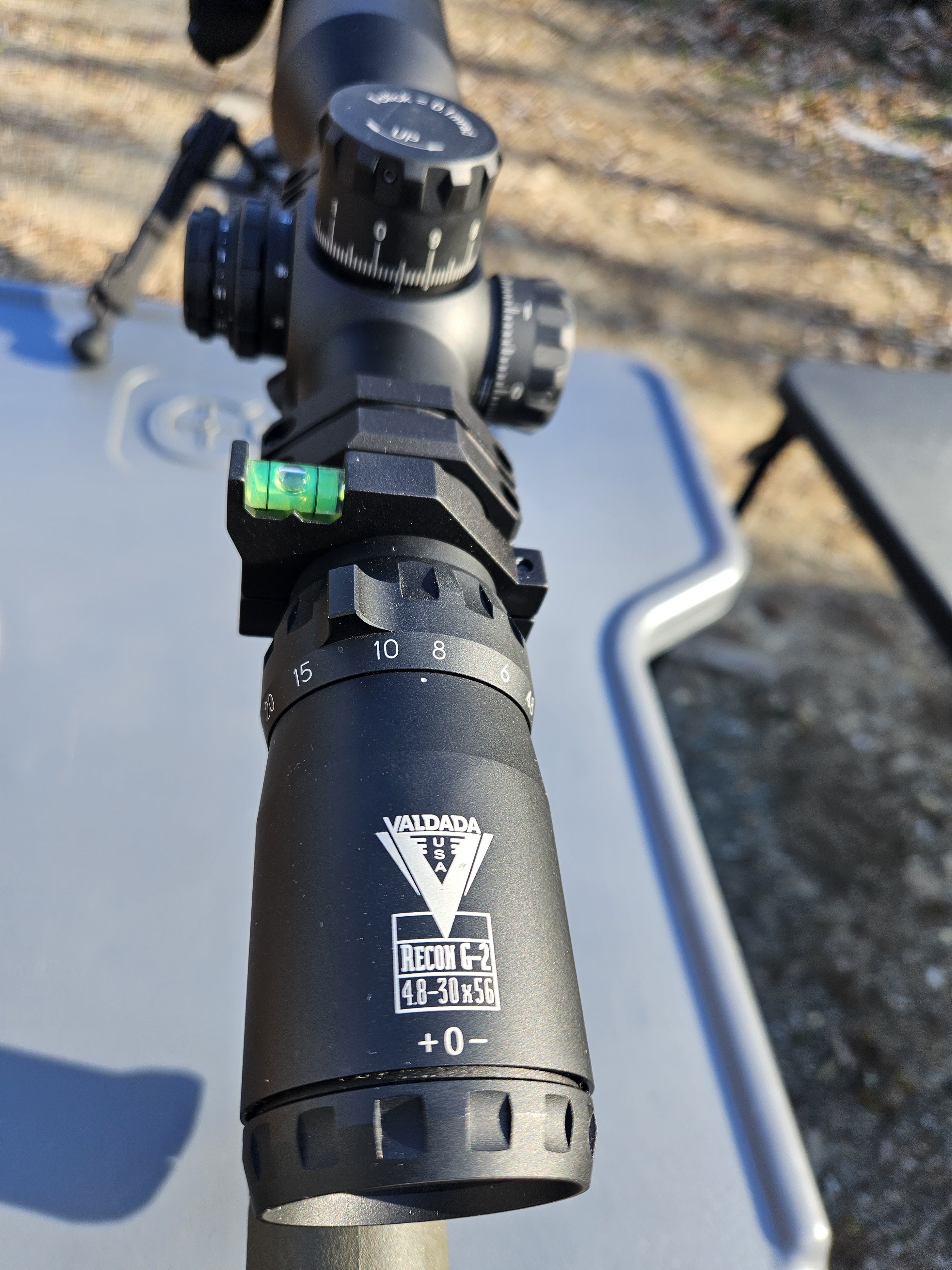

I topped this rifle with my Valdada Gen 2 Recon w/ 40mm tube and needless to say it's a beast atop this rifle but it STILL SHOULDERS EXTREMELY WELL.
I will be taking this rifle out later on today for initial thoughts as I only have 1 box of zans on hand but have 10 more on the way.
I also plan to bring this rifle way down in power with other ammo and test accuracy. The new setup is far more efficient than previous models I've been told and I plan to test that out.
Anyways , 🍻, hope you all had a good Thanksgiving.

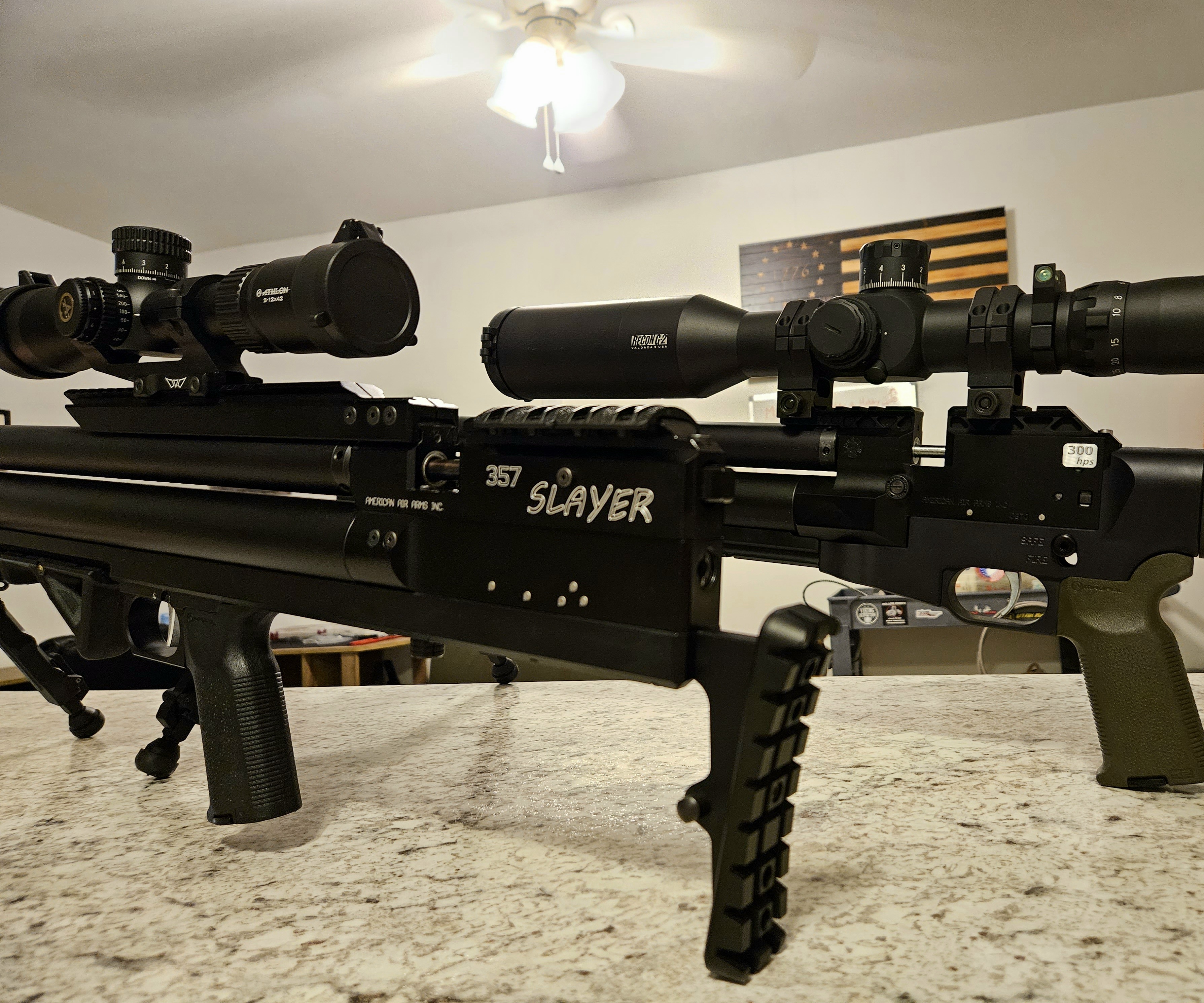

Also, of course I had to toss its bigger bore brother in a pic 😉
Looks great. I understand the HST and reg external adjust, but what is dwell? I understand it on electronic guns, not sure how that’s adjusted on a mechanical gun? Thanks.
From what I understand from speaking with Tom is that his balanced valve differs from many on the market. His is air assisted from behind the poppet, instead of controlling how fast it shuts , the dwell adjustment controls how long it stays open on Toms design.

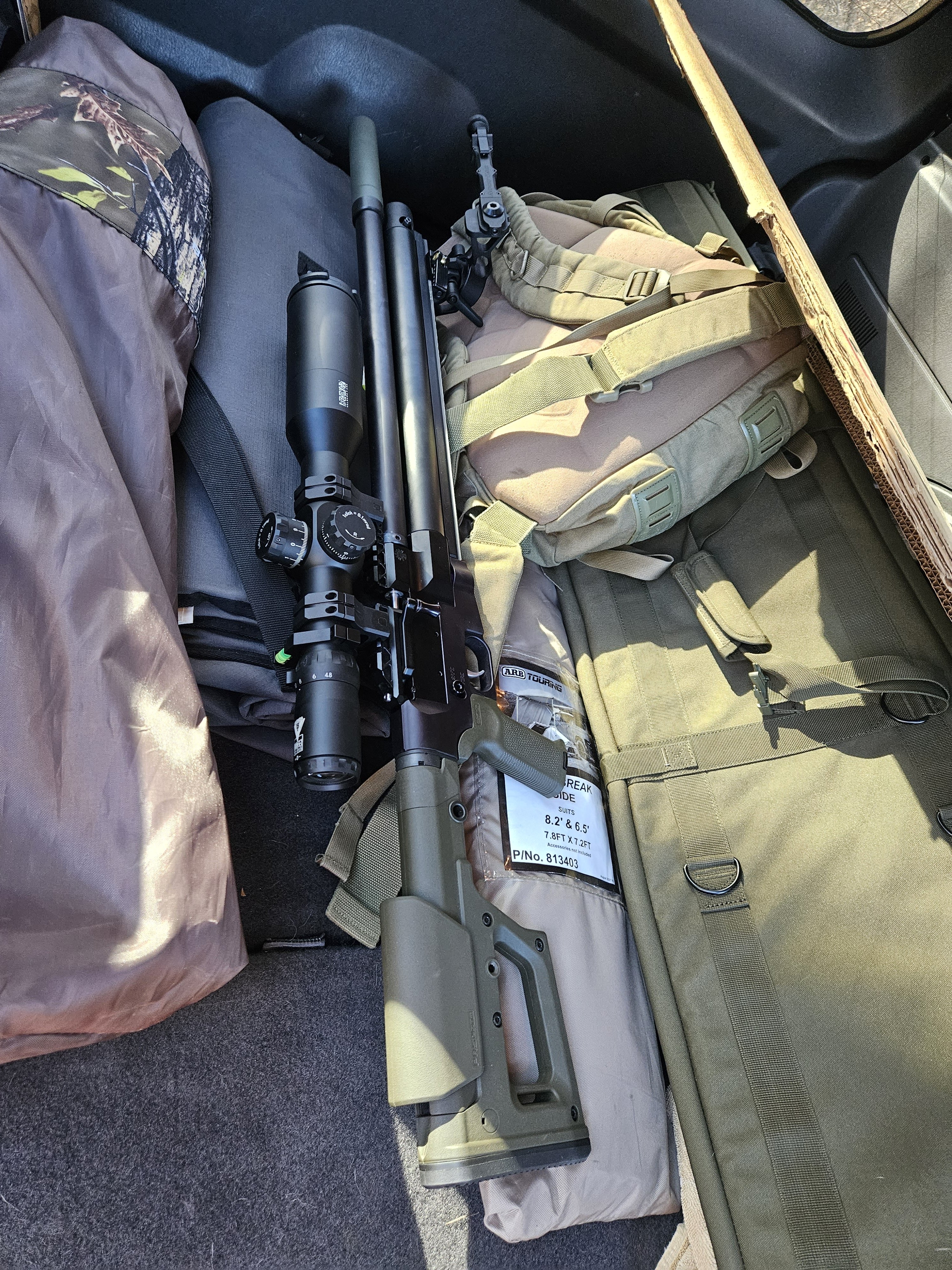

Tom had this rifle tuned before I got it. He sent it field used. So barrel needed to be cleaned, I needed to zero it, etc.
So I put it in my jeep and let the rifle acclimate to the 23* we had today.

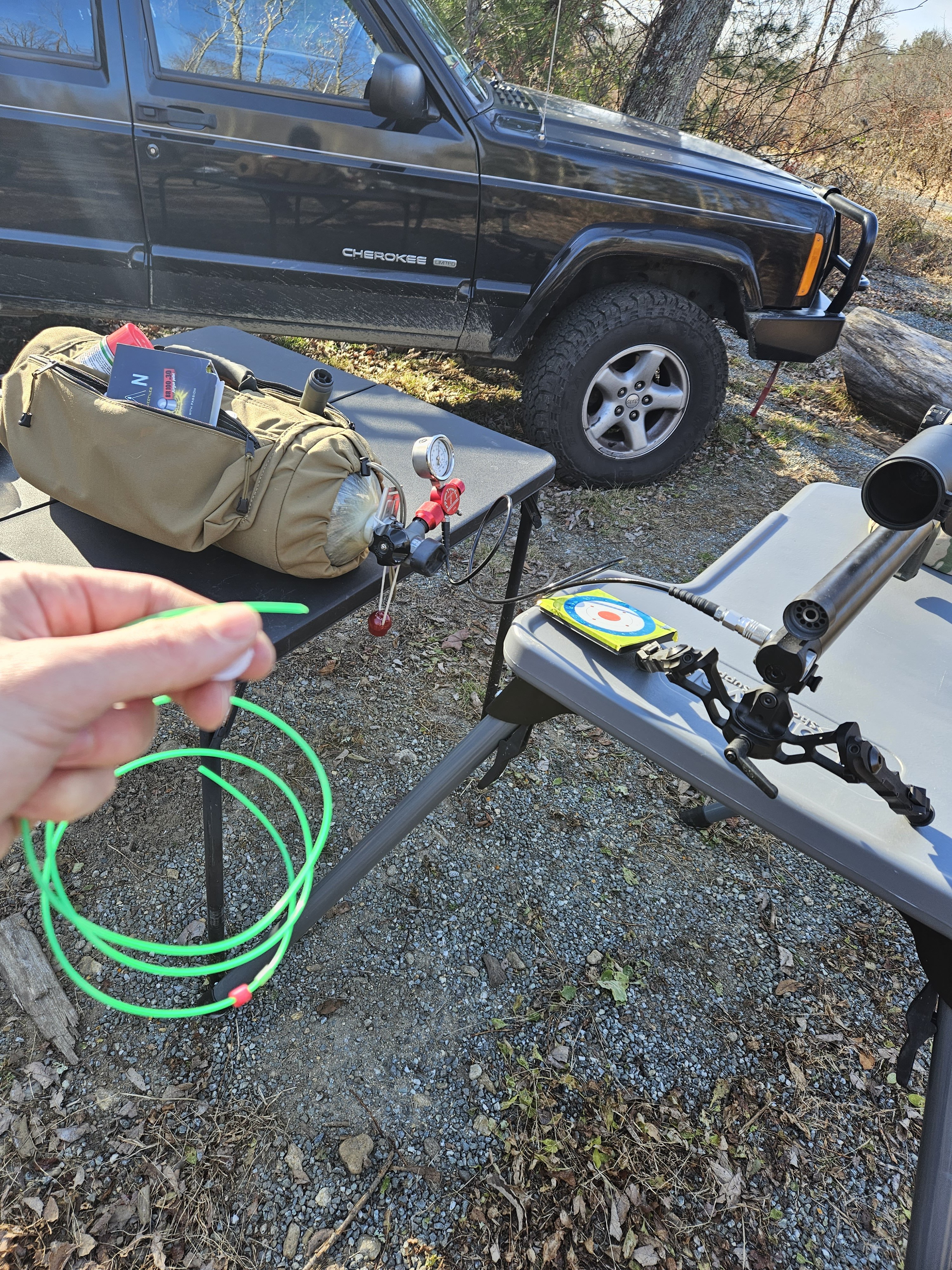

I packed the rest of my stuff up and headed down to the range. Once there I took a few glamor shots and set up my shooting area.
Once I had everything setup I hooked my bottle up and let it slowly fill to 4000 psi, new fill pressure on the hps models is 4500psi but my tank didn't have that much in it.

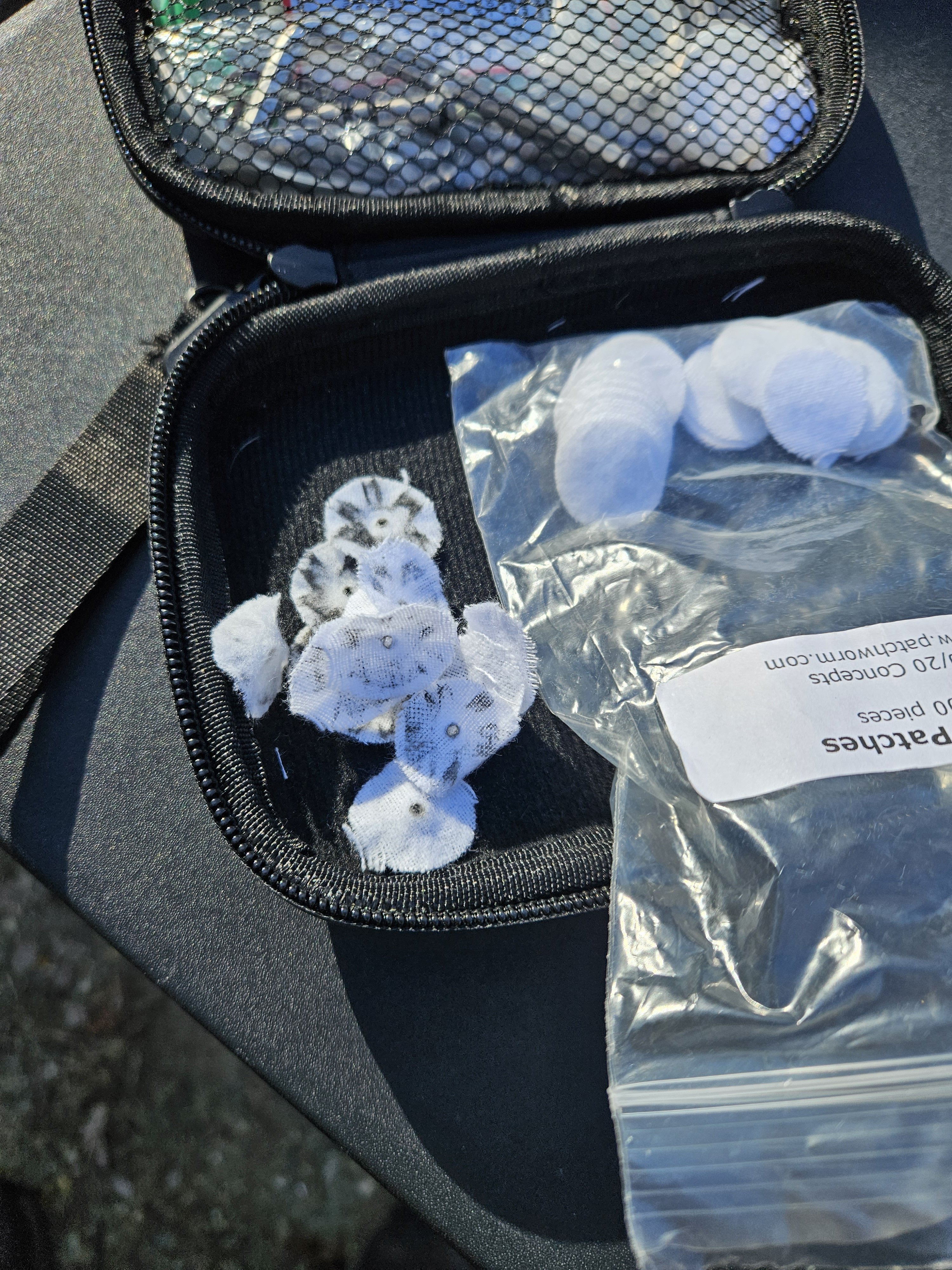

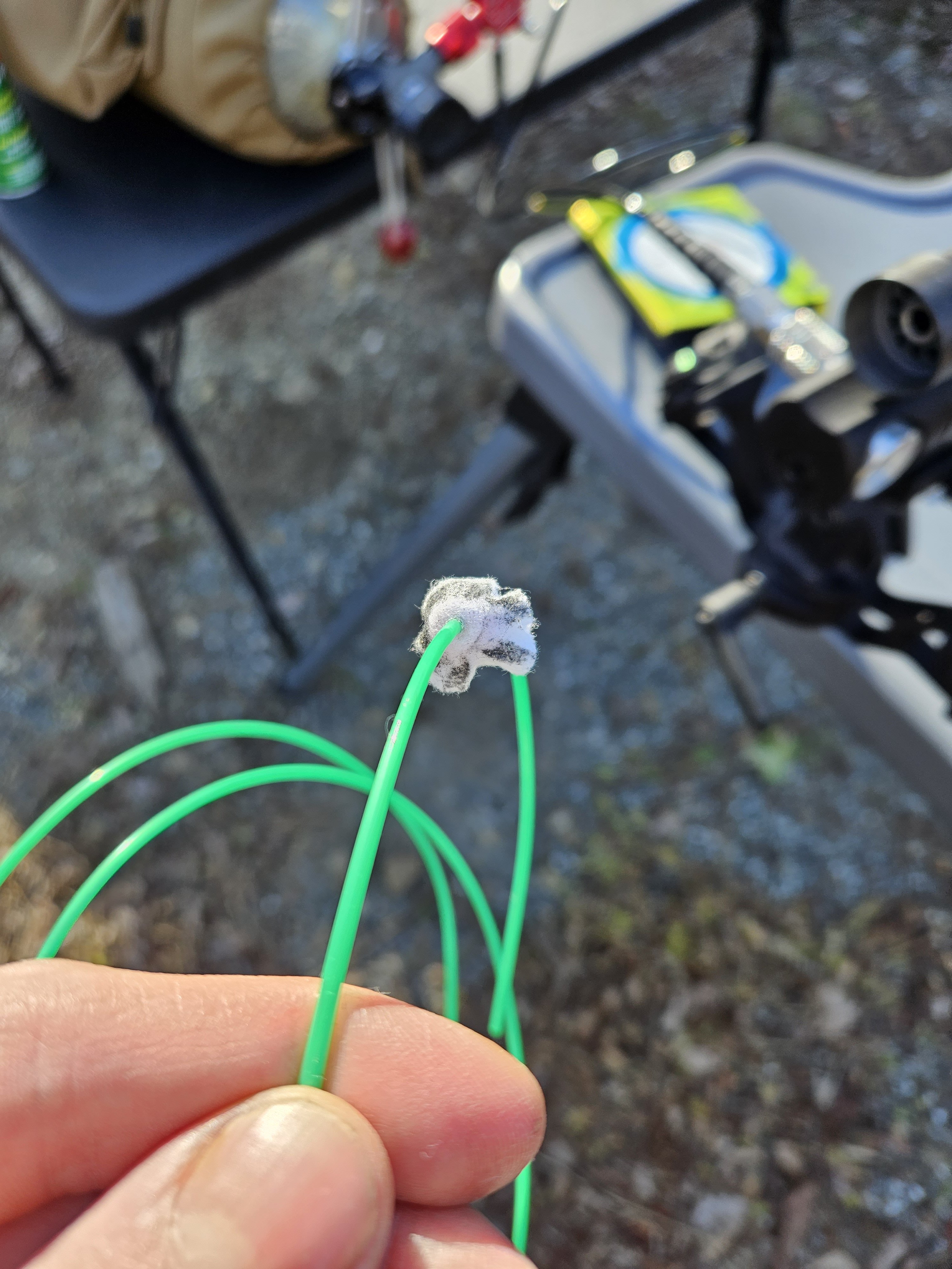

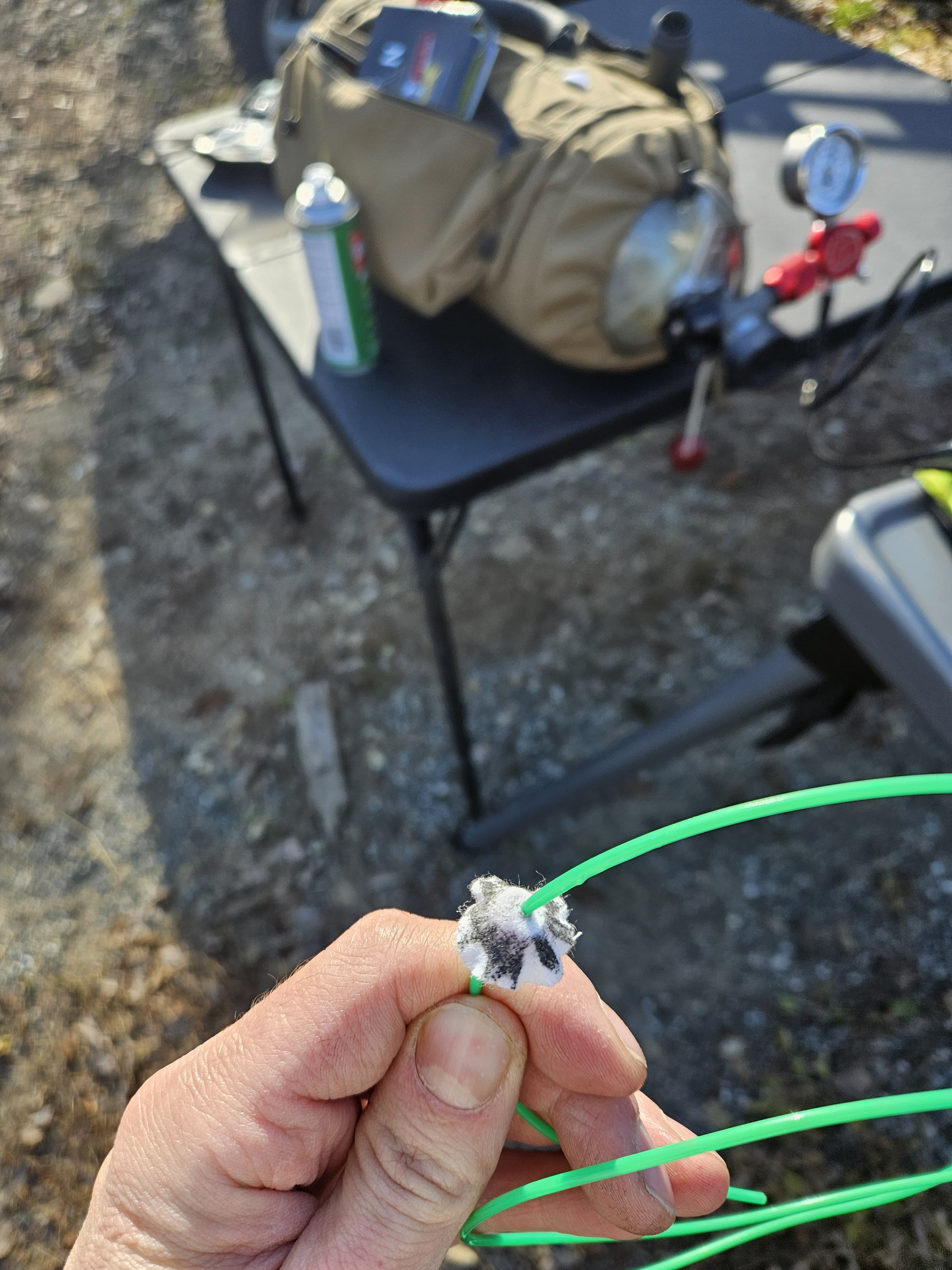

While I waited for it to fill I decided to clean the barrel, it was filthy, pics show all.
I immediately sat down at 100, and zerod.

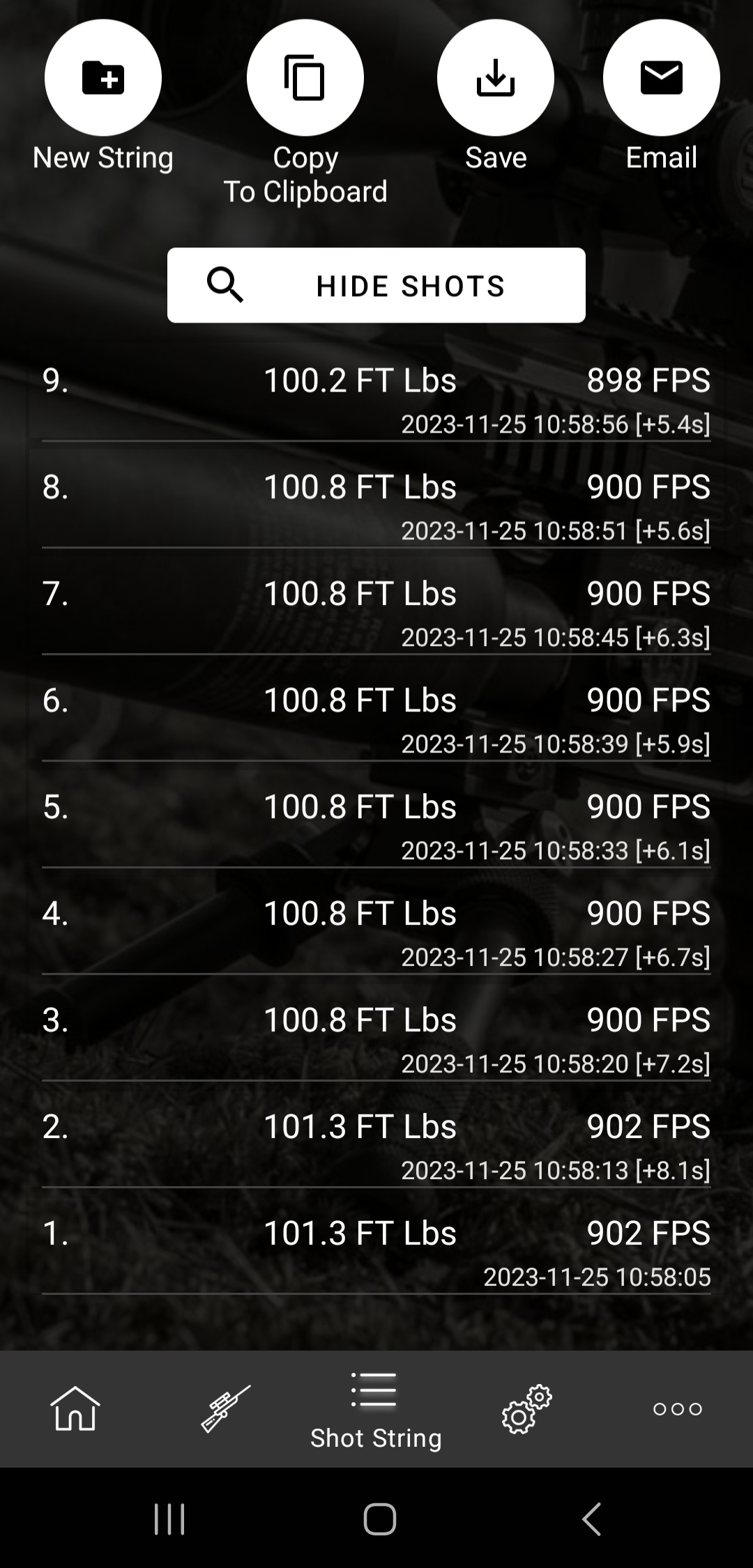

Then I hooked up the chronograph and ran a string with the zan 56gr
Consistent is understatement. The rifle has a bit of bite and bark at this power level but nothing obnoxious. I am not going to post groups however. I don't know if I had an old batch of bad zans or what but I have never had luck with them.

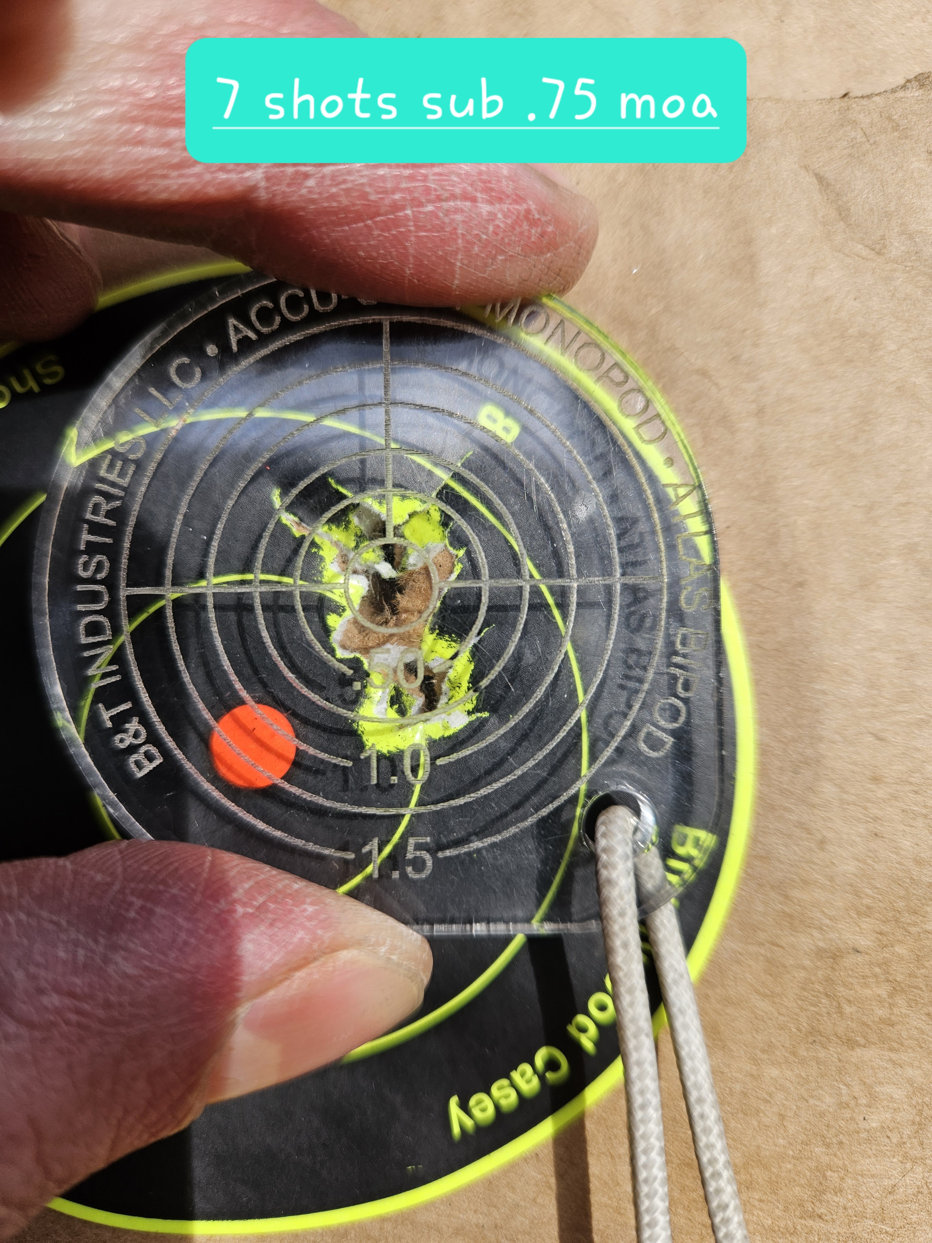

So I brought it to its minimum setting and got to tuning.

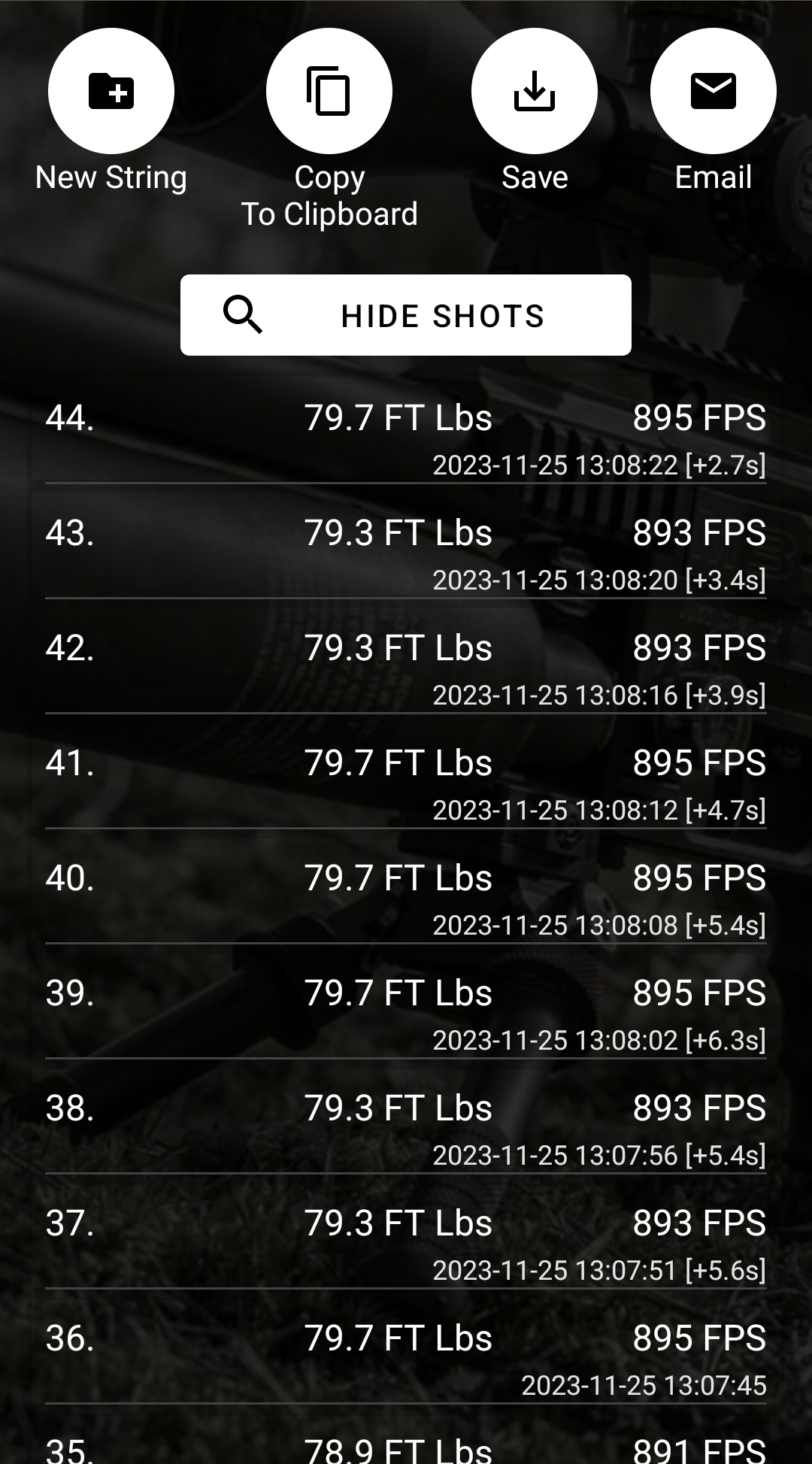

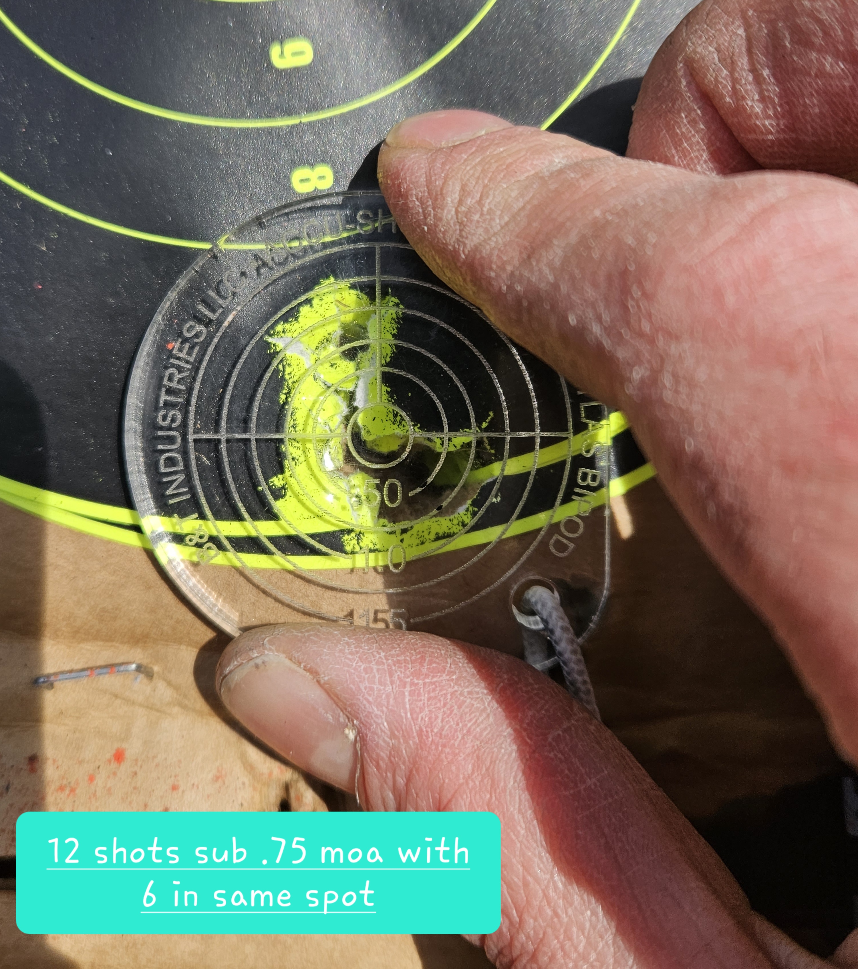

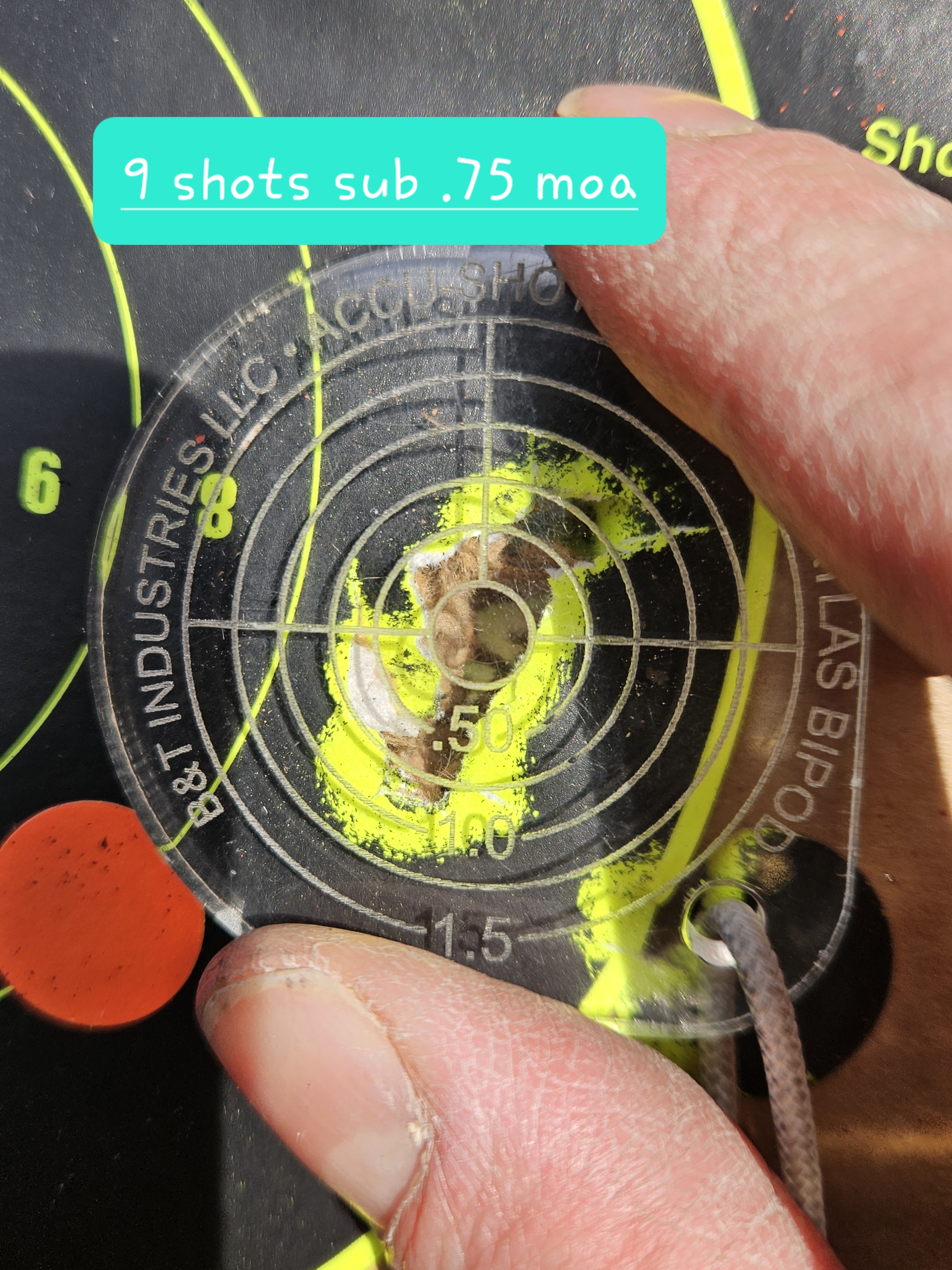

I ended up with this tune on the trusty UNDERRATED (at least I think so lately) 44.75 .
As you can see , my fingers were quite cold, purple/red and a bit numb at this point. So these were the best groups I could pull off.
The quick tuning on this rifle is awesome. It doesn't feel gimmicky, nothing feels cheap, everything still feels robust even the tuning components.
The other big improvement is the new HST system the effort needed to cock the rifle is far less.
Again, consistency is understatement. Especially in these Temps. The rifle was too cold to hold with a closed grasp for extended periods of time. I left it outside even when I refilled my air tank.

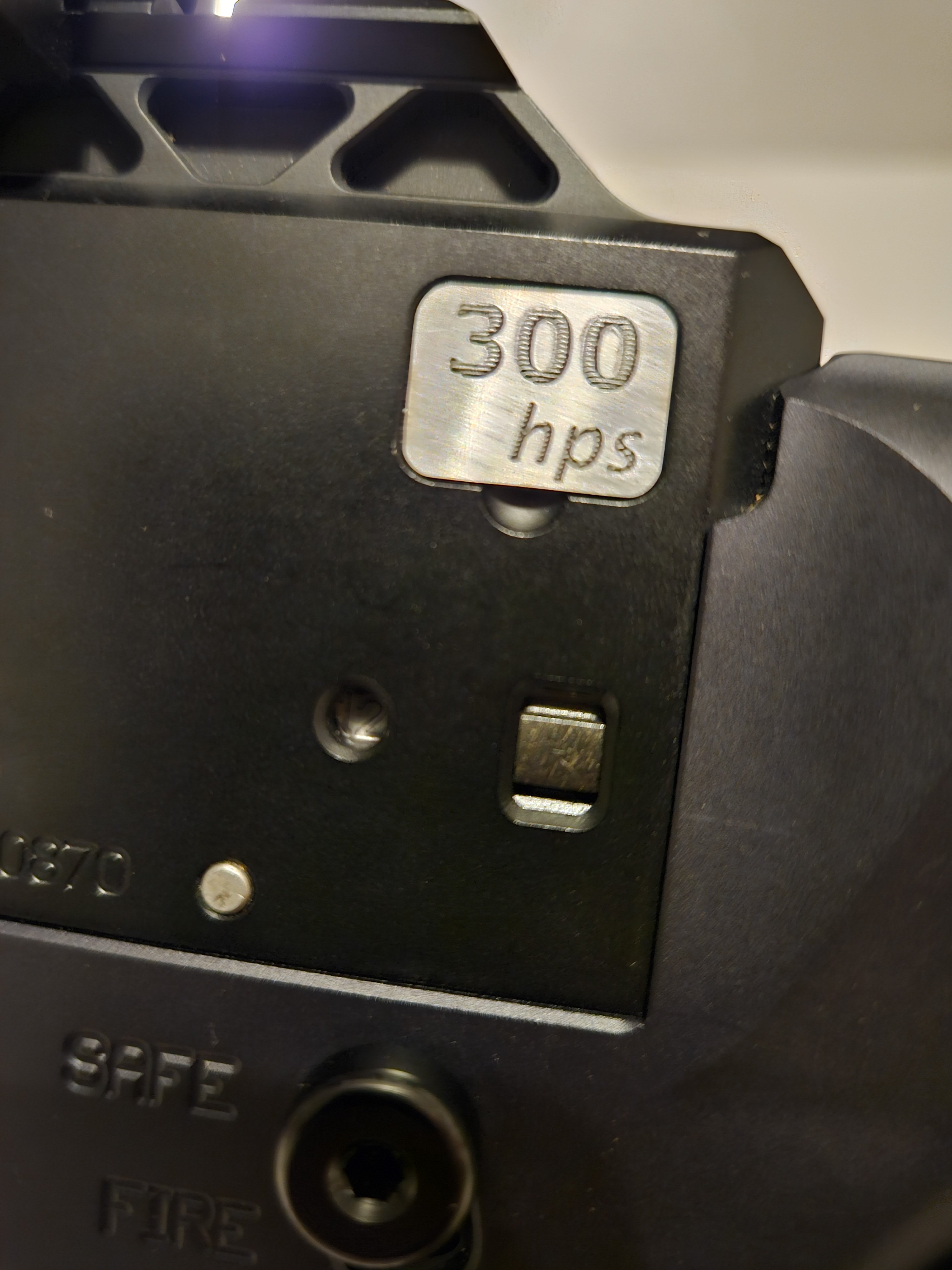

Is the word EVOL being dropped in favor of 300? If so, I personally like that move. When will these rifles be available at AOA?
They are going to be called the Evol HPS with a number designation for caliber.
Also not sure on time frame but sometime soon.
