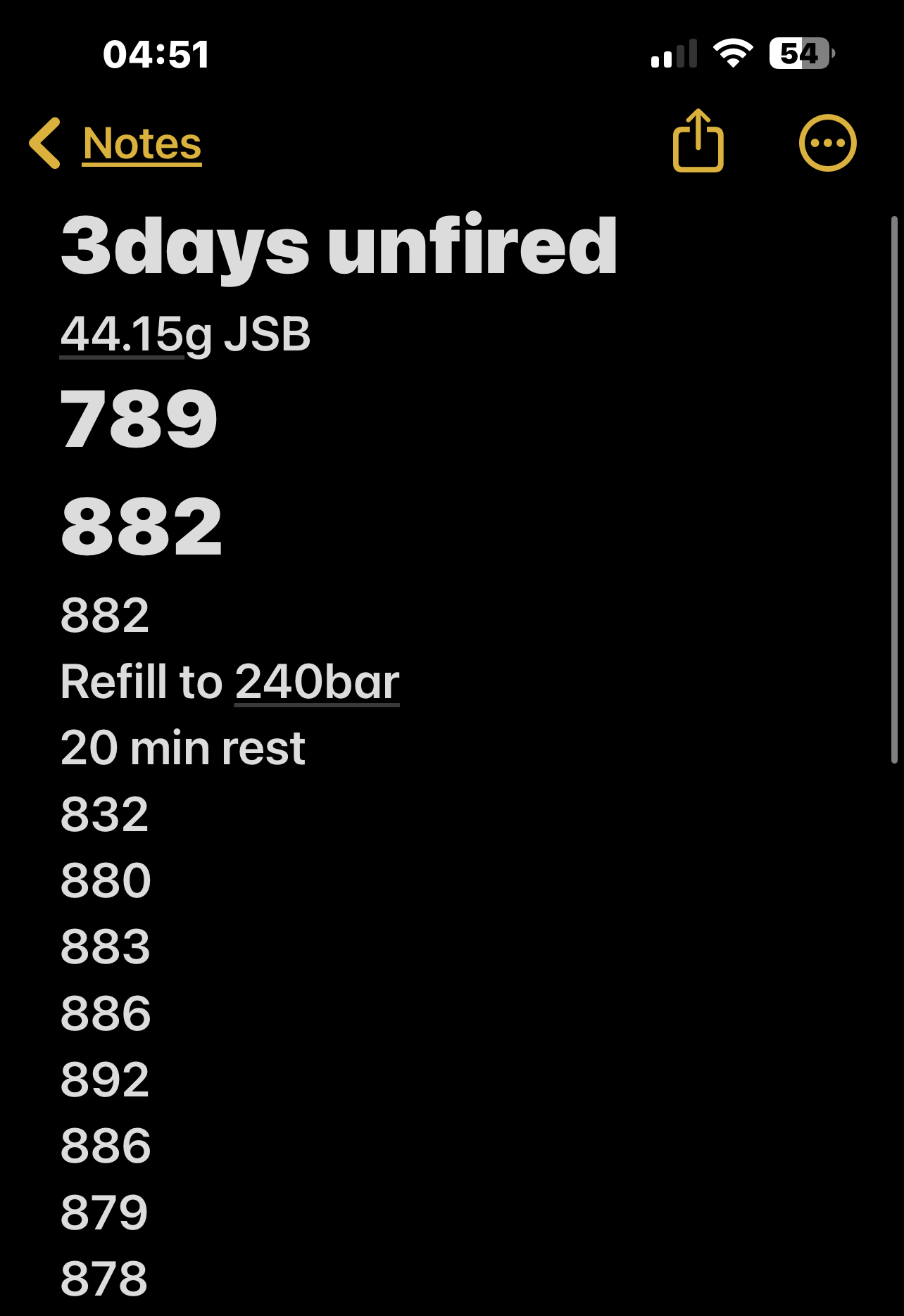

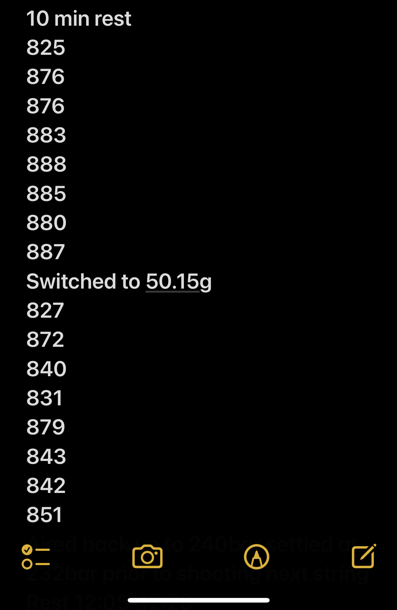

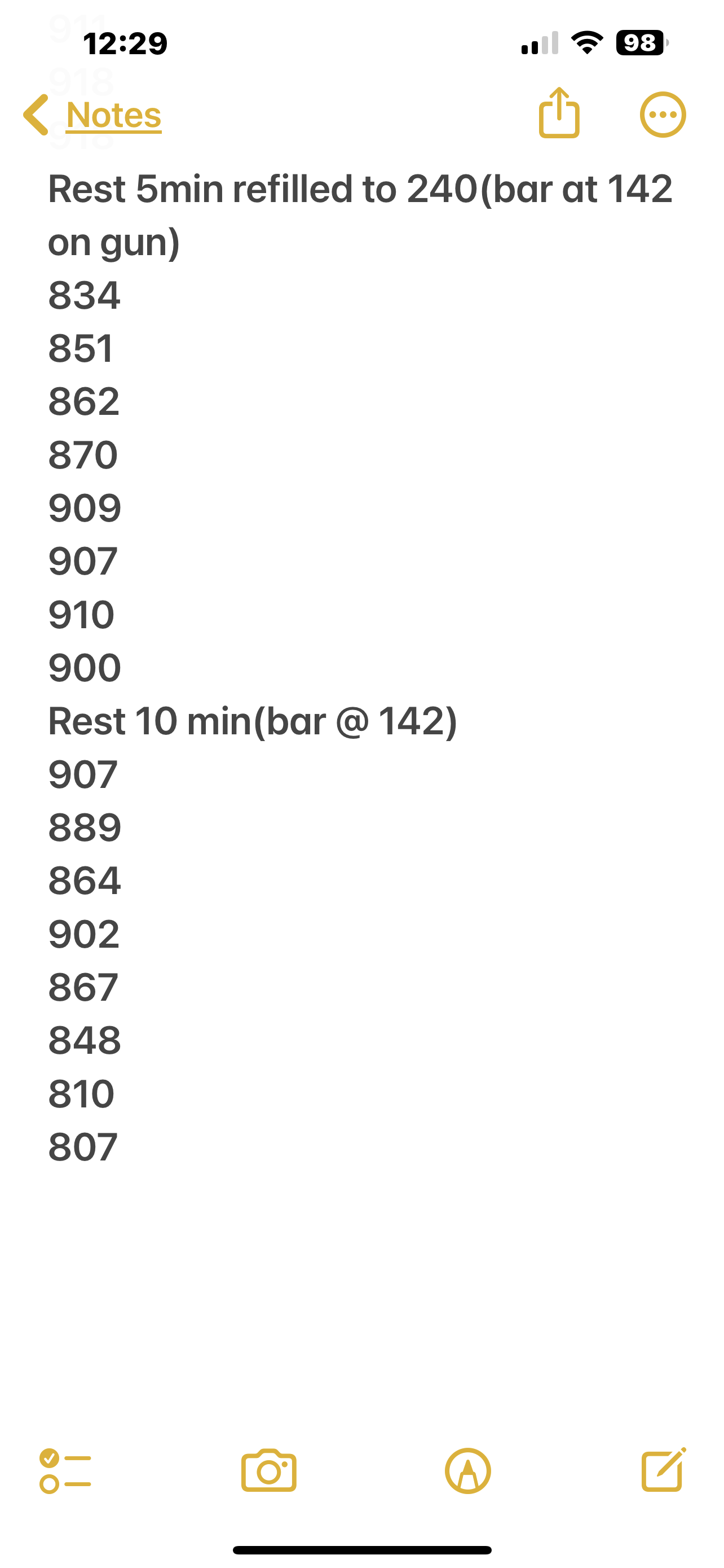

Okay Centercut I set the reg up at 142, moved to factory setting adjusted the FPS. This is with the 50.1g JSB. Here is a photo. Do these numbers look right? Thanks for all the help guys

Just throwing everything out there. Are you just relying on the onboard Chrono or testing it on another as well? Reason I ask is because I have several chrono's, including a LabRadar. My FX chrono will read about as sporadically as what you are showing, then I will run shots on my LabRadar or Pro Chrono and it will read what I expect.
Just curious if maybe its a chronograph issue? But 100fps drop.... wow.
Reactions: cavedweller
Yes, multi chronograph’s and it shows up on paper as well. Took the gun up to AOA today and they confirmed my results with their stuff as well. They did replace the reg with a new one while I was there and still got the same results. So I commend AOA for returning my money and taking the gun back.

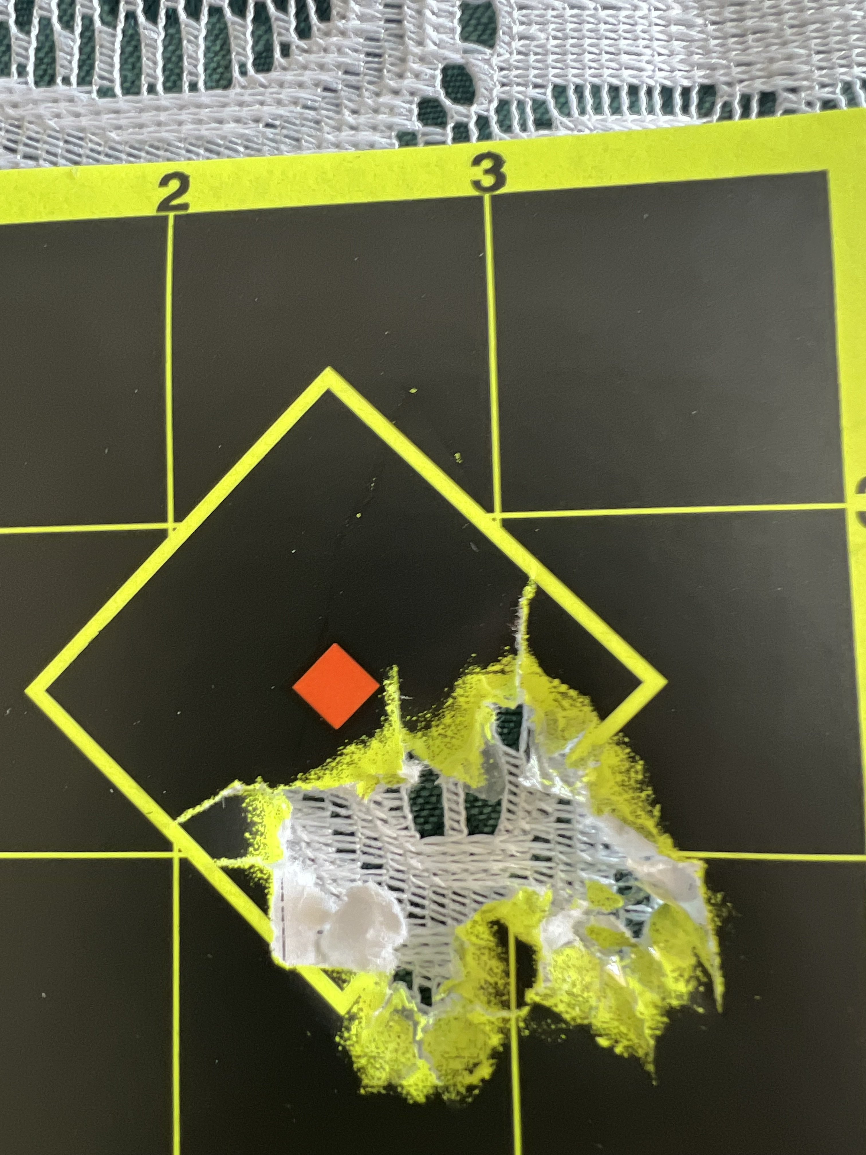

Just didn’t work for my type of shooting.
Groups were acceptable. I did no tuning on it
Here is 7 shots @ 100 yrds with the 44g JSB after throwing the cold barrel shot off in the dirt
And I’m no bench rest shooter
