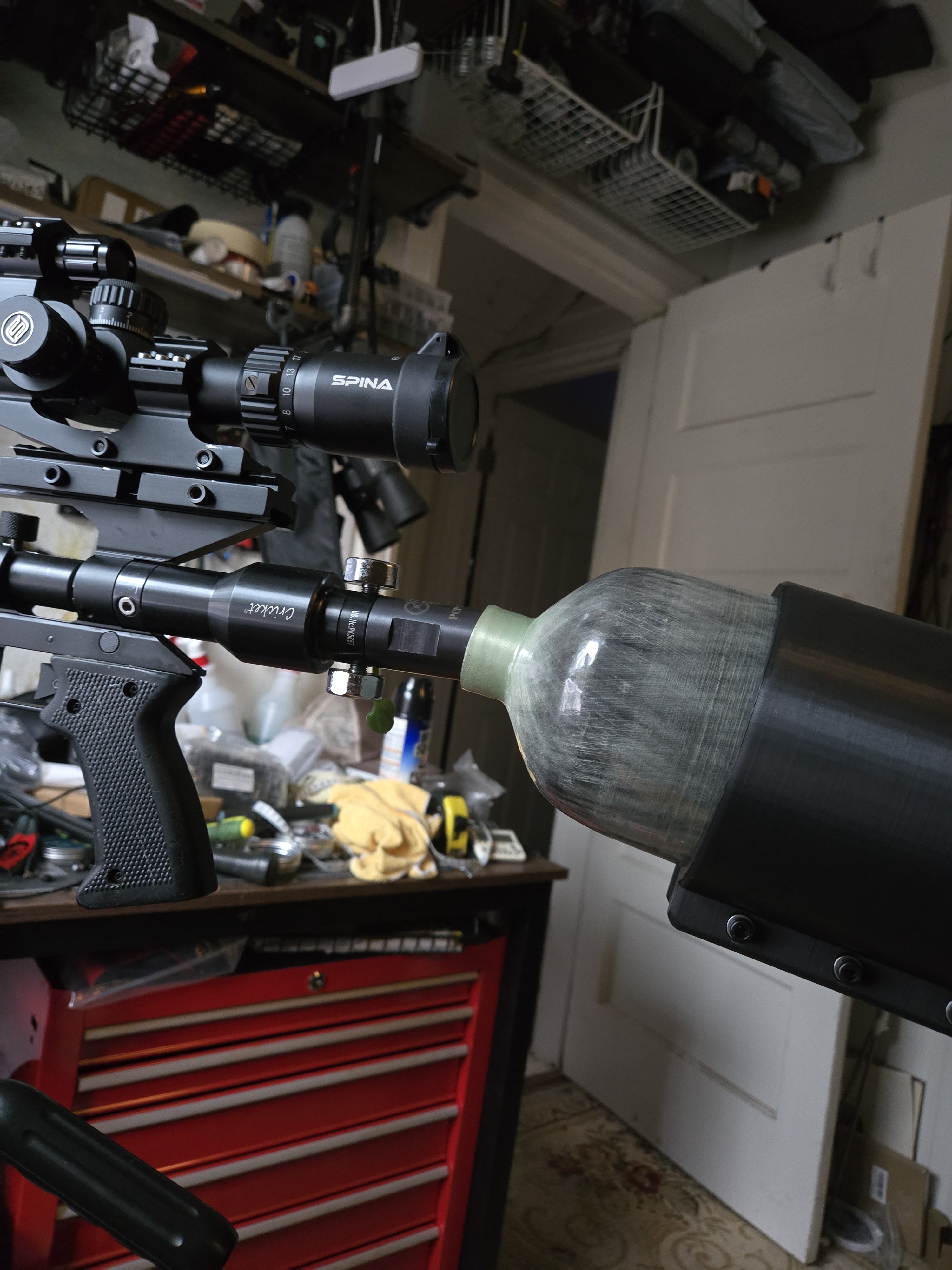

N/A The most shots per fill....
Or 500+ from a .22 AirForce Talon firing H&N Baracuda Match 21.14gr
Shan Bao 20CM 3000psi tube
Regulator 1/2 Huben Power Cricket
Huben Power U adapter
Trajectron angled adapter
Acecare 1.1L bottle.
Pfft, you want shot count?
A little modification and 400+ shots from a AirForce Condor .25 firing JSB Heavy King mk2 33.95gr.
Huben Power Cricket Max-ATH regulator
Acecare 1.1L fat bottle
jb3dpd.com custom butt.

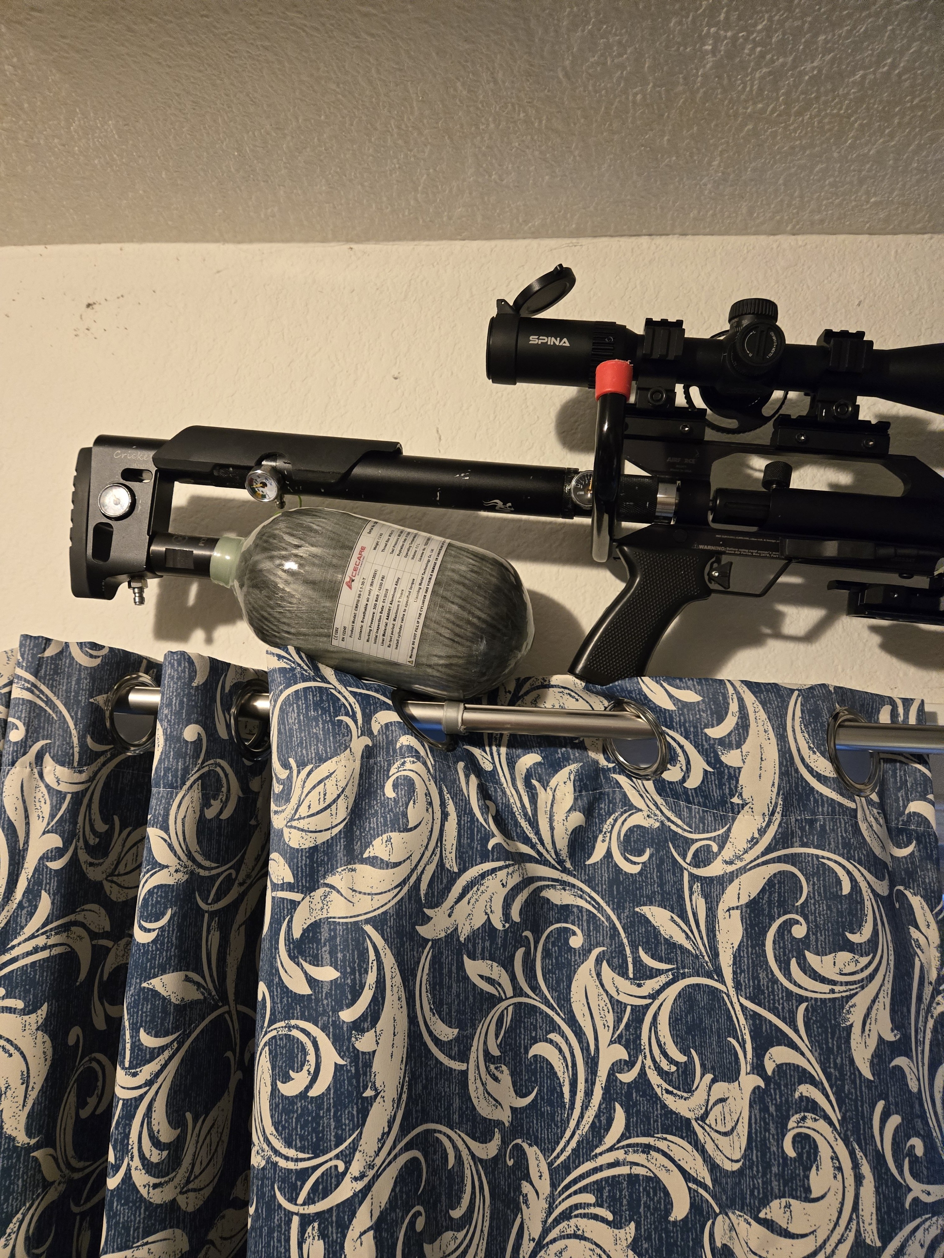

Ha that's a lot of shots per fill.
That might give me a cricked neck though and I mean that seriously because it does that often when I have it cocked anywhere but straight on for a while. My son has his couch perpendicular to his TV and I have to sit weirdly angled so my neck doesn't get tweaked.
That might give me cricked neck though and I mean that seriously because it does that often when I have it cocked anywhere but straight on for a while. My son has his couch perpendicular to his TV and I have to sit weirdly angled so my neck doesn't get tweaked.
I rarely shoot more than 40-50 rounds. It started out just getting the gun regulated. The first iteration was the Dream Universal with the 25cc plenum and a noticeable improvement, reducing the regulated pressue down. Then the Max-ATH with the 50cc plenum and further reduction.
Then, because I'm an engineer, how far can we take this? 120cc plenum, heavy hammer, high flow valve, longer barrels, bigger bottles and FrankenGun is born.
