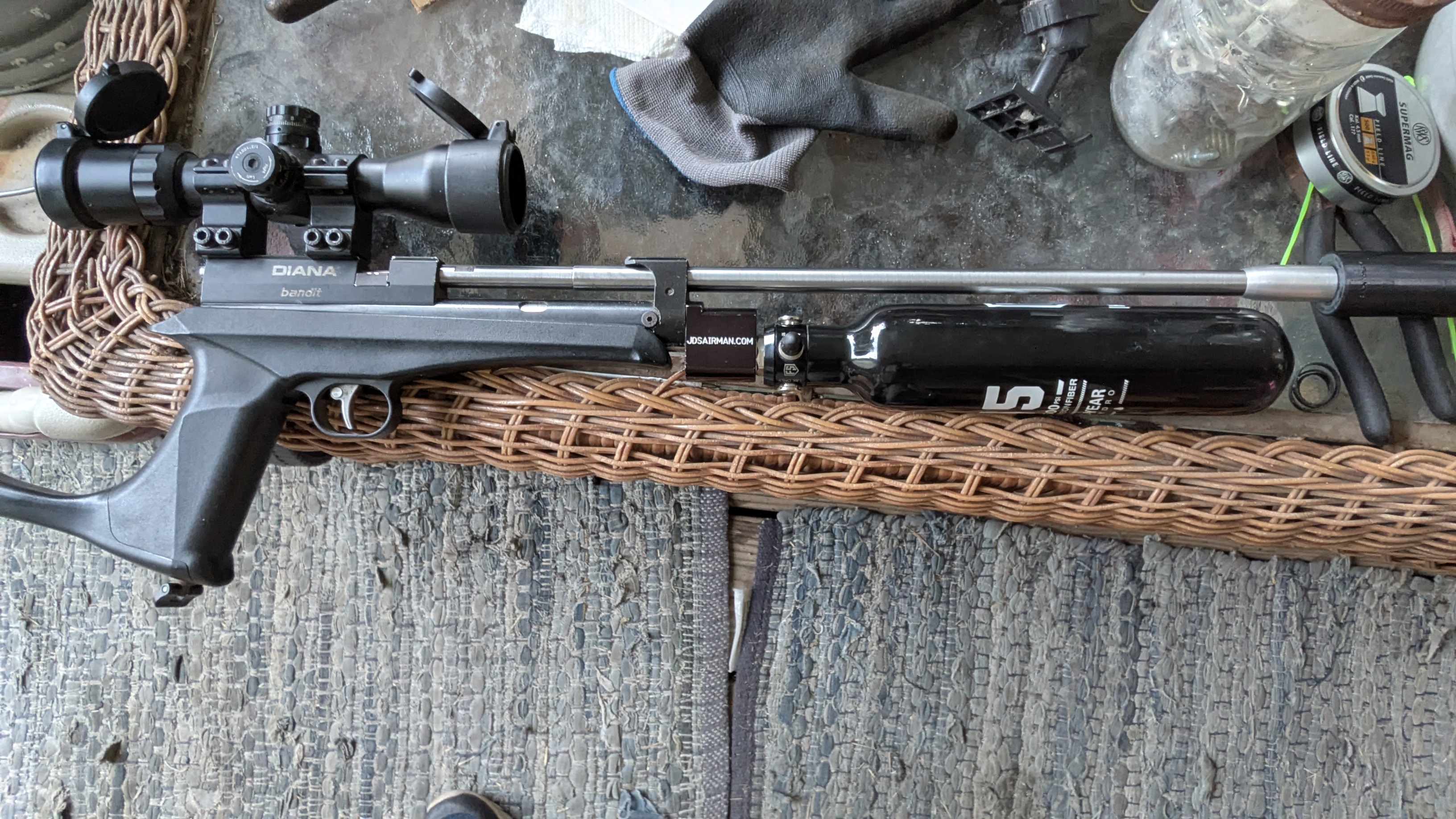

My Diana chaser tube with 15cc 4500psi bottle. Not to bad I'd say lol.

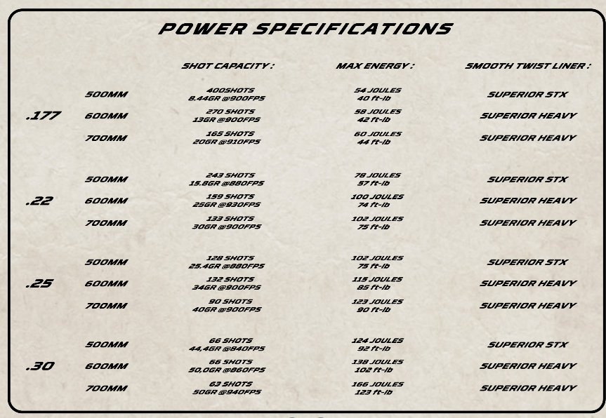

The Crown you mentioned has a Smooth twist X so uses the liner system.
250cc , 15 cubic inch I think you meant.
