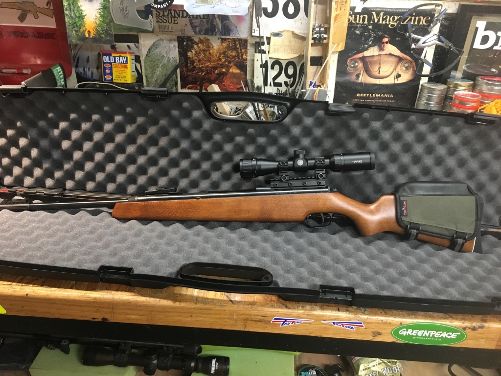

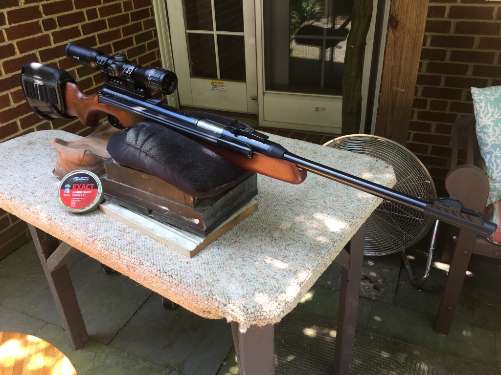

My Diana 48 is breaking in quite nicely. I’m getting 1 ragged hole at 25 yrds in my back yard.
