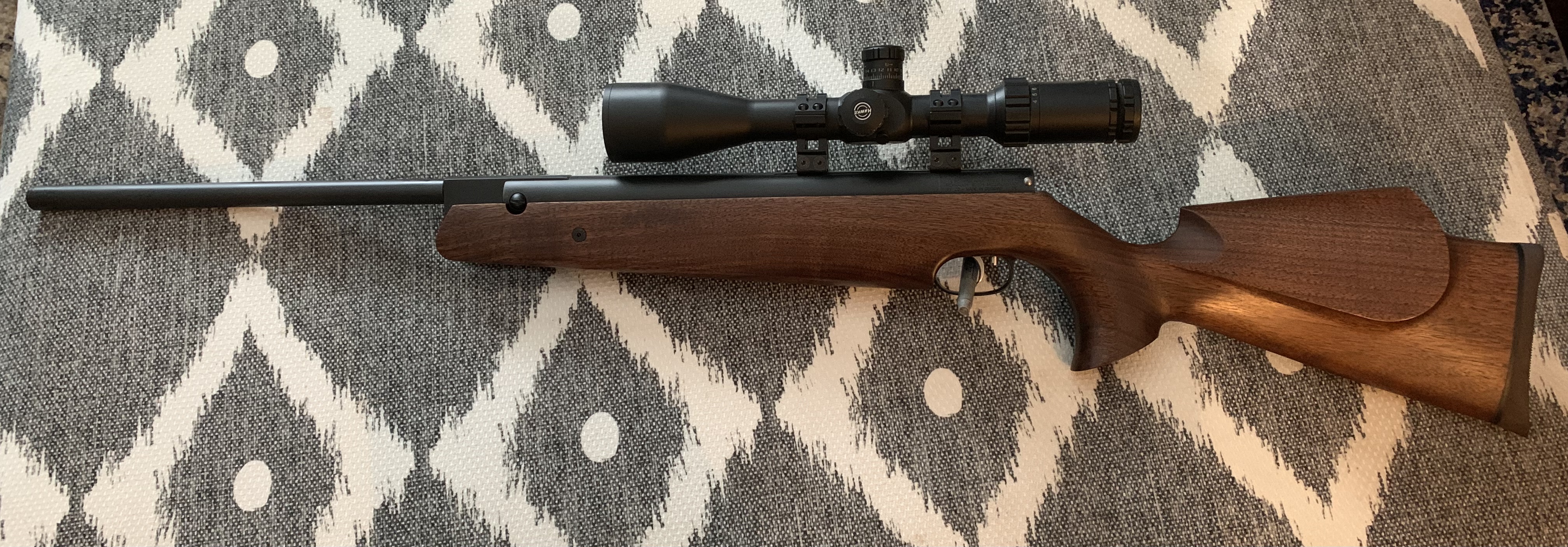

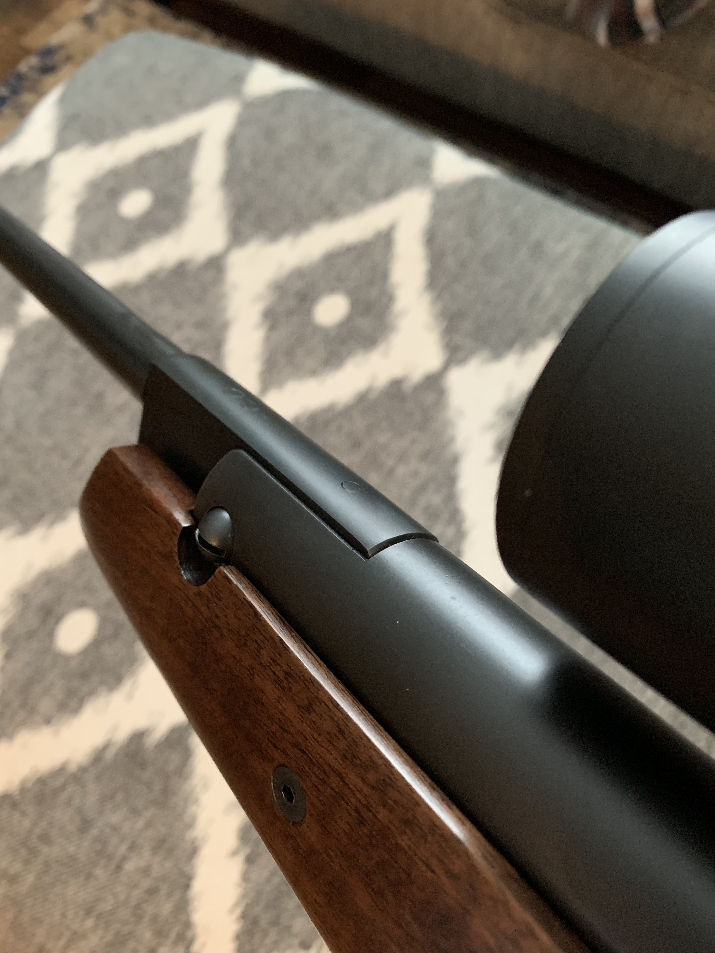

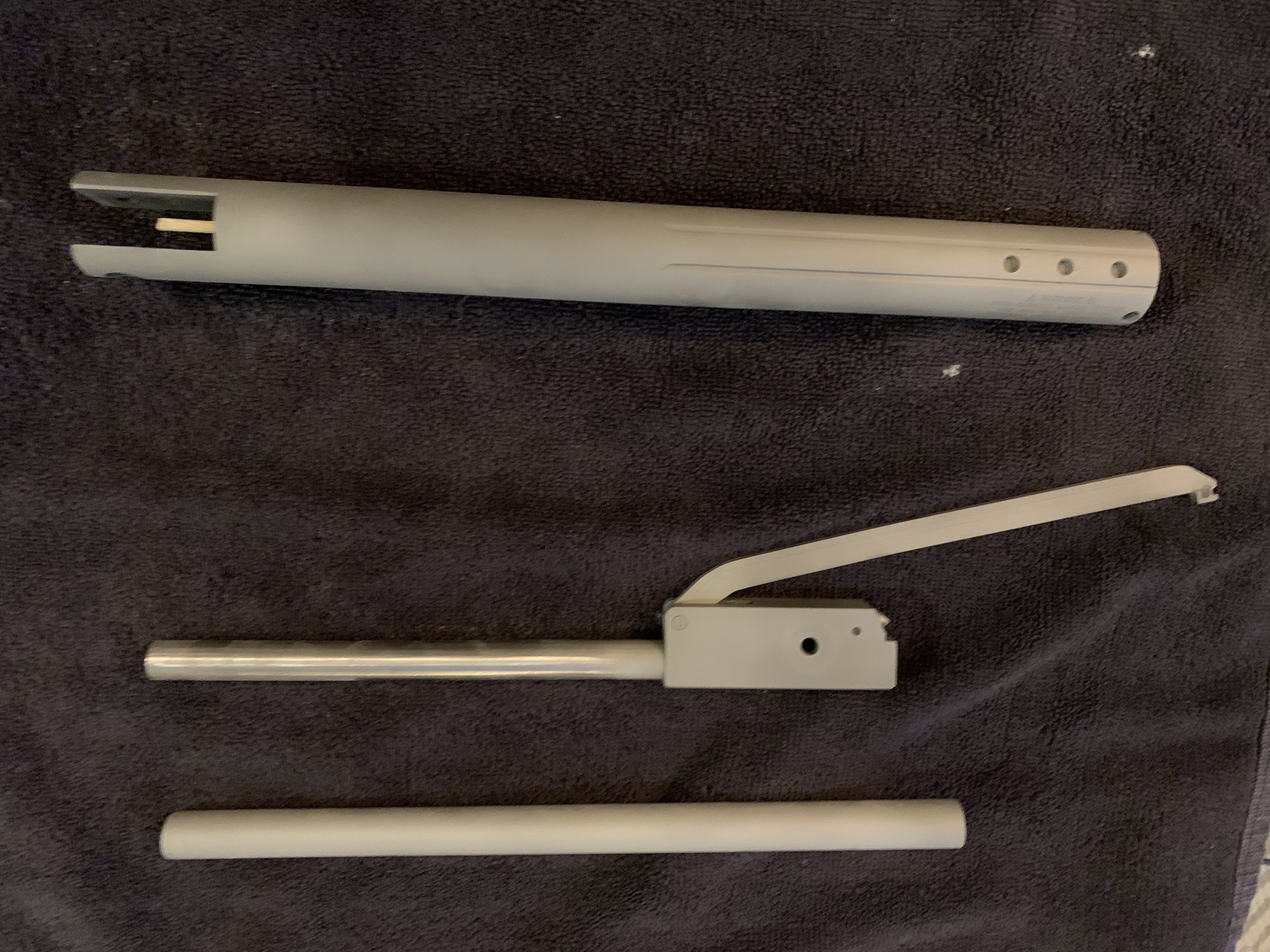

Ok, I’ve finished the HW 80 hunter I built (I’ll checker it after a month of drying) . I wanted to keep it stock strokes to try to see what it’s about..
( I’m working on a stroked version as I feel 5 mm more and it might be the best gun there is at it’s power, and stroke to cylinder ratio..more when that is further tested) It is a gun that’s built as good as it gets. When HW changed them front welded brackets witlh a spring loaded machined one that holds the arm tight at battery cocked. Along with the new cocking shoe. There IS NO AIR RIFLE that is as well built . Now it can benefit from some work as I have done. The factory seals are always parachute to support the guaranteed idiocy of the average shooter .
Remember, they are selling to mom and pop for jr. too. Not this type of airgunner.
This Mongoose has been reshapped in the breech block to match the chamber and sight screw holes filled with screws. I’ve welded them ,but you end up with heat transfer lines. I don’t mind the hairline screw lines . The best are the K breech blocks with none. The barrel was shortened to 11 inches. It has been recrowned and mildly choked with a full length shroud and … well it’s not empty in there.

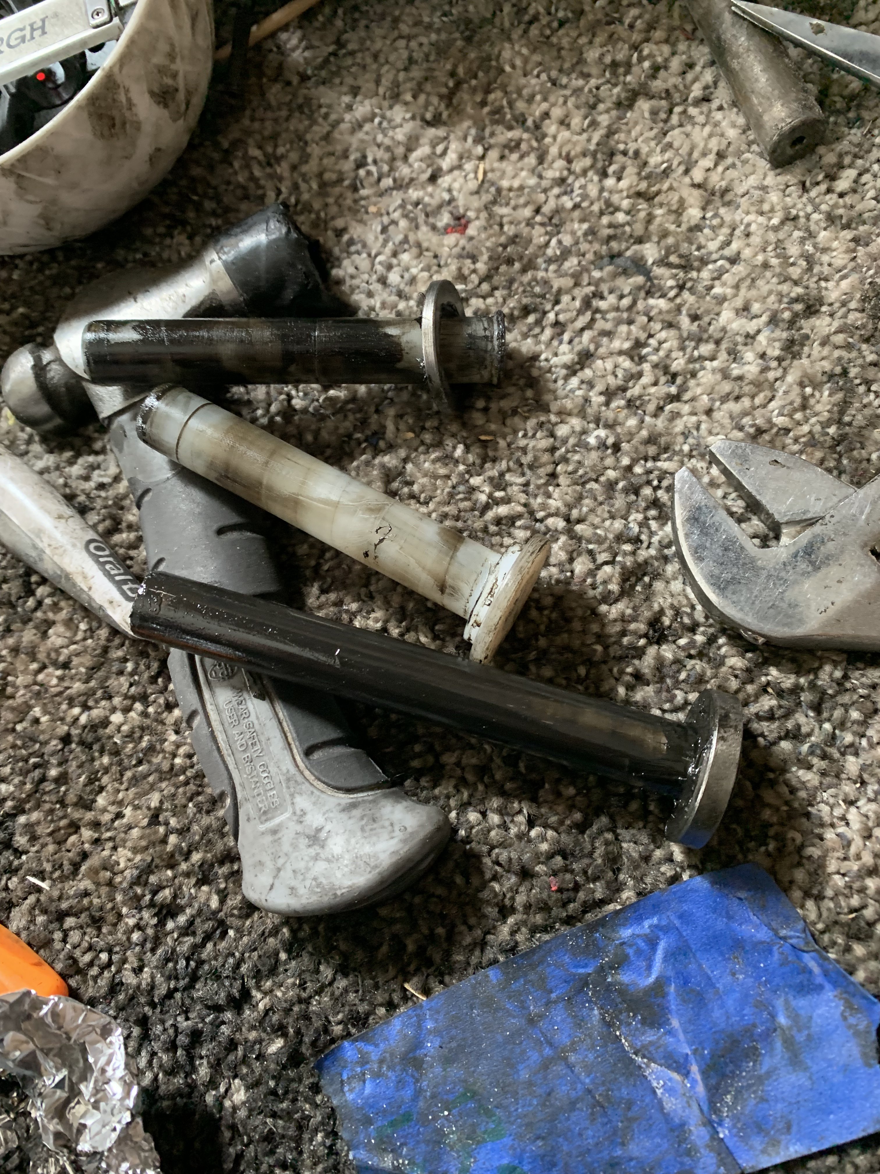

I did do a slight bit of port shaping. Along with a new piston seal I made. (most Hw are tad smaller than 30 mm, 29.89.actually)
The spring is a smaller wire. .135… WHAT YOU SAY.. All them kit makers use .142 to .148 wire In their kits… It is easy to get a stout wire short stacked and tight wound to give a snappy cycle .. At THE COST OF YOUR ARM . Sadly the HW80 has a odd breech block to cocking arm ratio. It’s just out of what I refer to “the golden ratio” [I’ll post on that later, something I’ve found with the best guns for ease of cocking to power ratio. To breech block to arm ratio, THATS WHERE THE EXTRA 5 mm stroke will come into play]
The piston was carbonitrated,At the rear.. buttons are one way to center the piston . You need to indicate it and center the rod and re pin it with slip fit guide and it can’t move. The spring and guide are my own Designs.

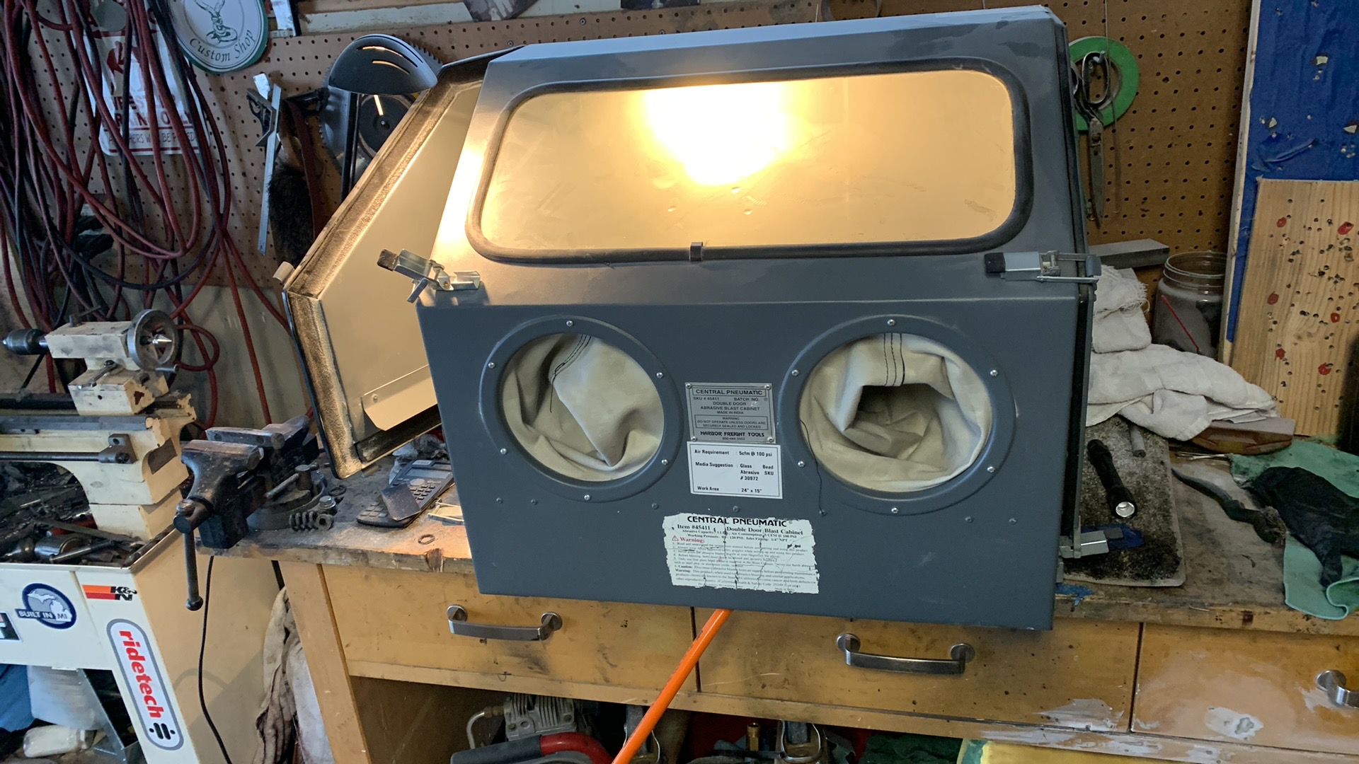

The action and barrel have been bead blasted and reblued to a satin finish. It is a hunting weapon

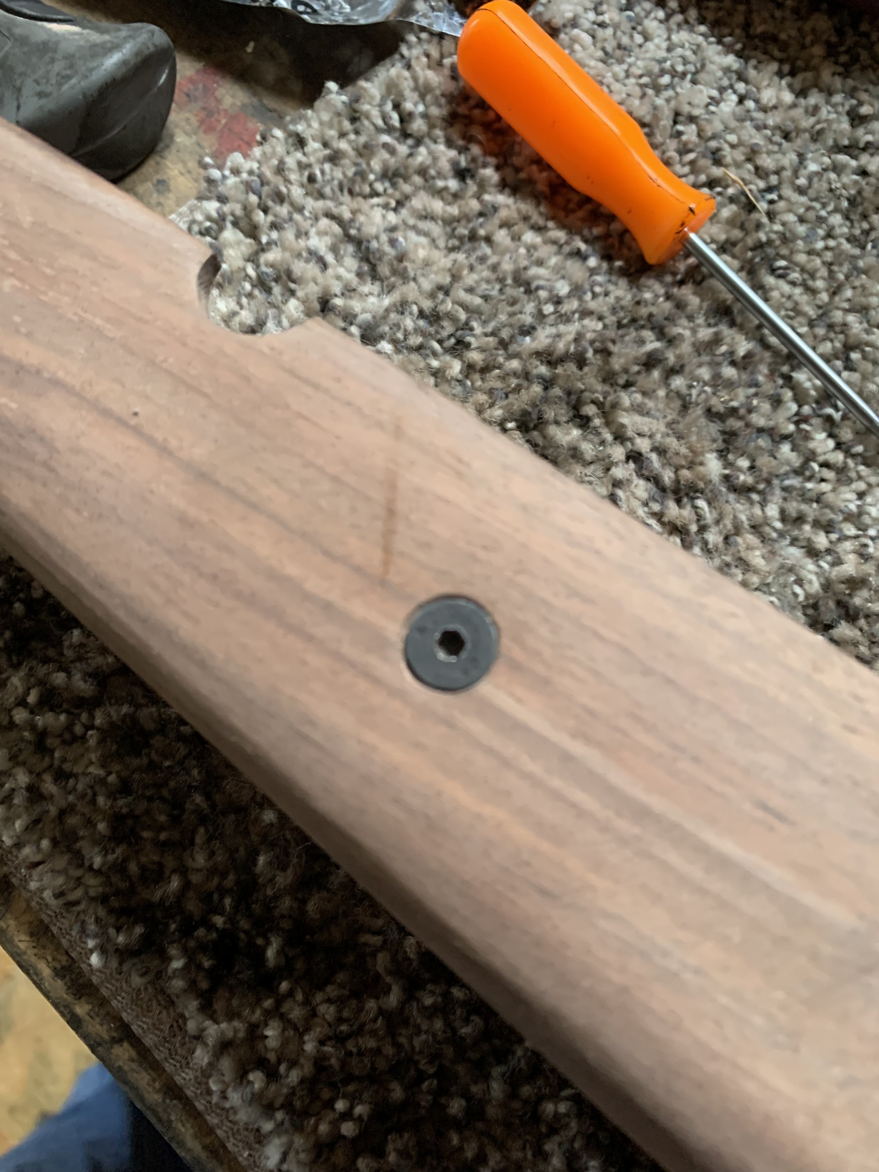

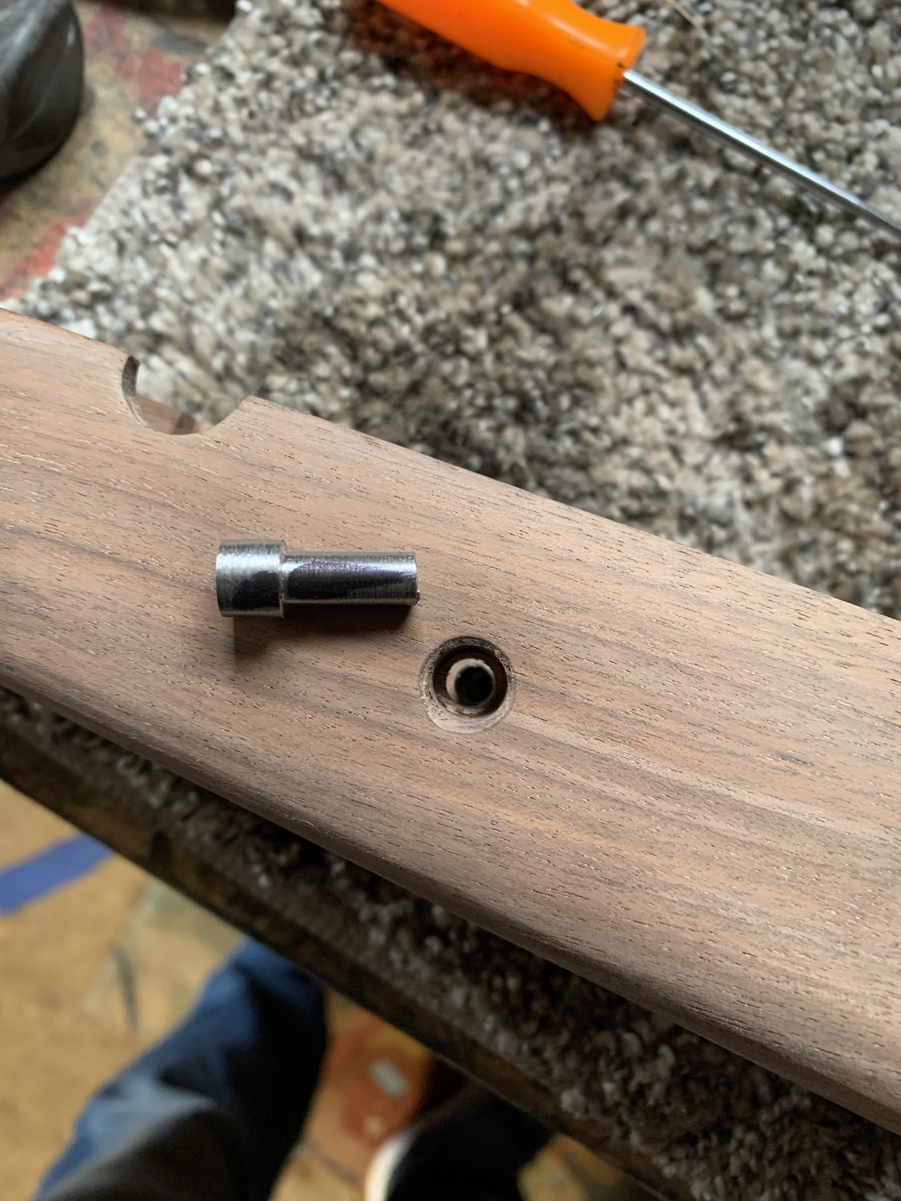

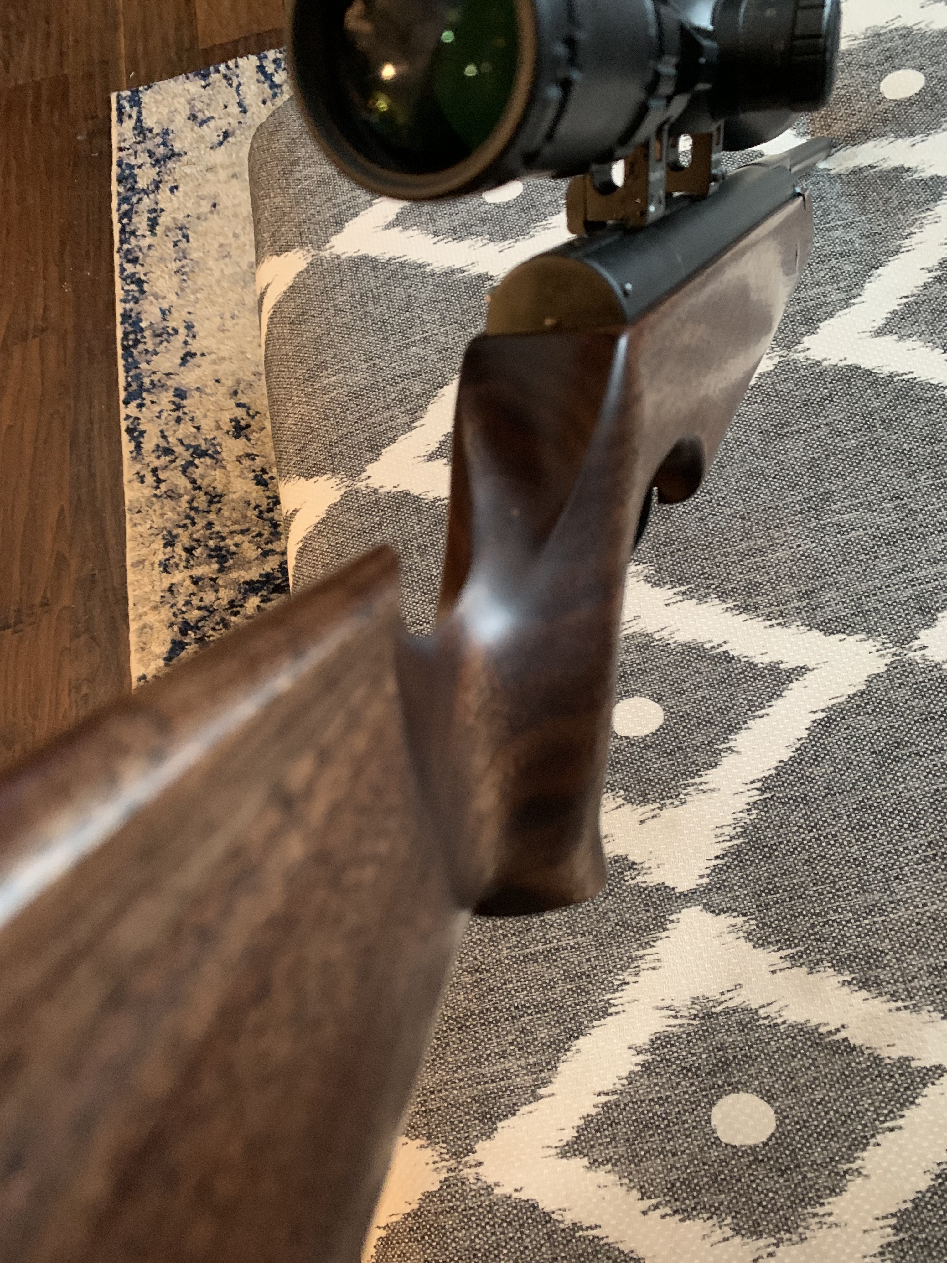

The stock, yes ,I saved that for last.. it is a Venom inspired design from a local tree that was cut 25 years ago.. Its not my fanciest wood but sentimental , Yes.. it is a functional hunter stock. Albeit the front screws look like every Tx ,they are not. They are pillared with metal sleeves just under the wood to let the screws go flush while the metal braces against the machined brackets. (You could never get away with that ,with the welded brackets , they all stripped and you were re tapping and using cups in the stock) I prefer less outside,especially flush, to see the wood not brass rings or stainless steel
It’s shooting 14.66 ftt at 780 fps just a hair under 20 ft lbs with very little recoil. YOU WILL ALWAYS HAVE SOME,in a spring gun as it’s physics.. You can’t beat it. With the lighter spring cocking isn’t arm breaking like big wire. Trigger is ,well ,Rekord. 1 lb .

View attachment 429278View attachment 429282View attachment 429280View attachment 429279View attachment 429277View attachment 429281
View attachment 429283View attachment 429309View attachment 429310
Personally i prefer the no checkering , I ordered an UK stock with no checkering for my HW97 / 77 , Love it that way , handle's wonderfully
It’s a dedicated “ right “handed palm swell, thumb plate fitted FT type of grip. Your not loosing grip.. Its the Jerry Fisher in me. “A gun is not completed until you checker it” JF
as long as you do not use that awful stippling crap . What a way to cheapen /ruin good wood . or even average beech stock .

the seals I make. They are a clone of the Venom power pulse seals. This isn’t ” The” seal as that one is for a Tommy 27 mm mm tube but it’s EXACTLY the same design In 30 mm tubes. It’s not my design ,it was and is Venoms.. but in my testing and tuning there is no better. Your mileage may vary. There are more than one way to skin a cat. Vortek makes a similar VAC seal too..

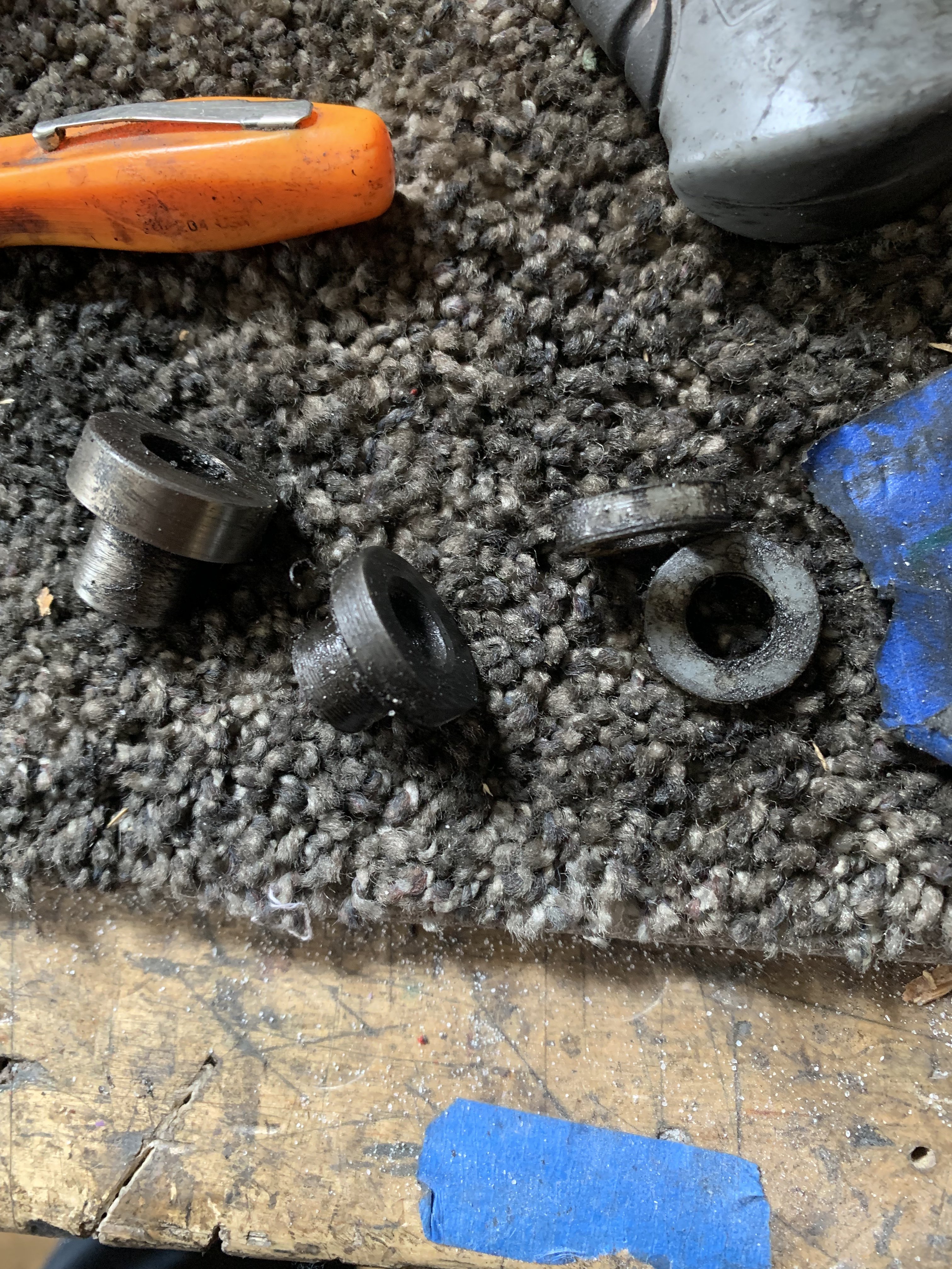

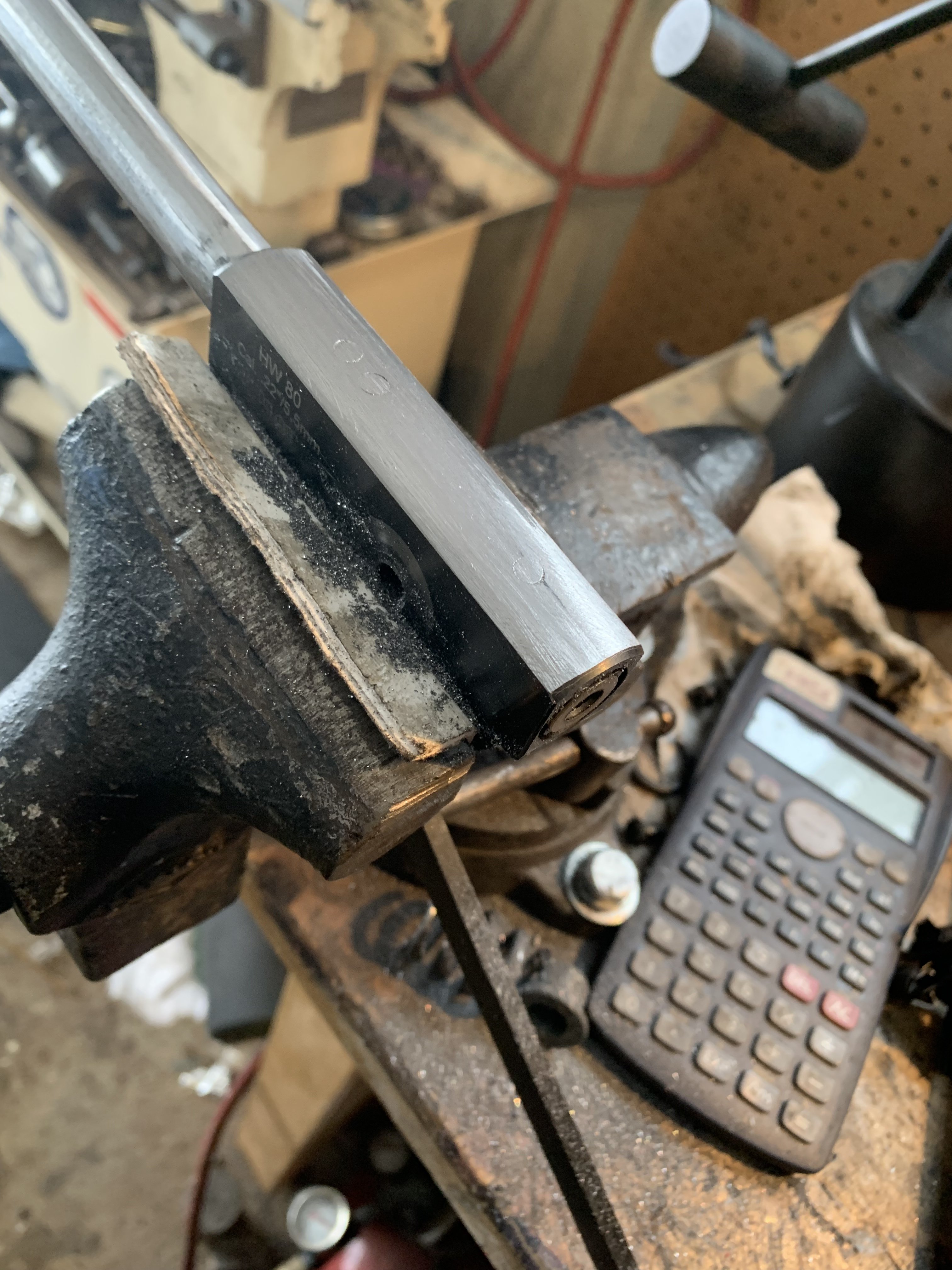

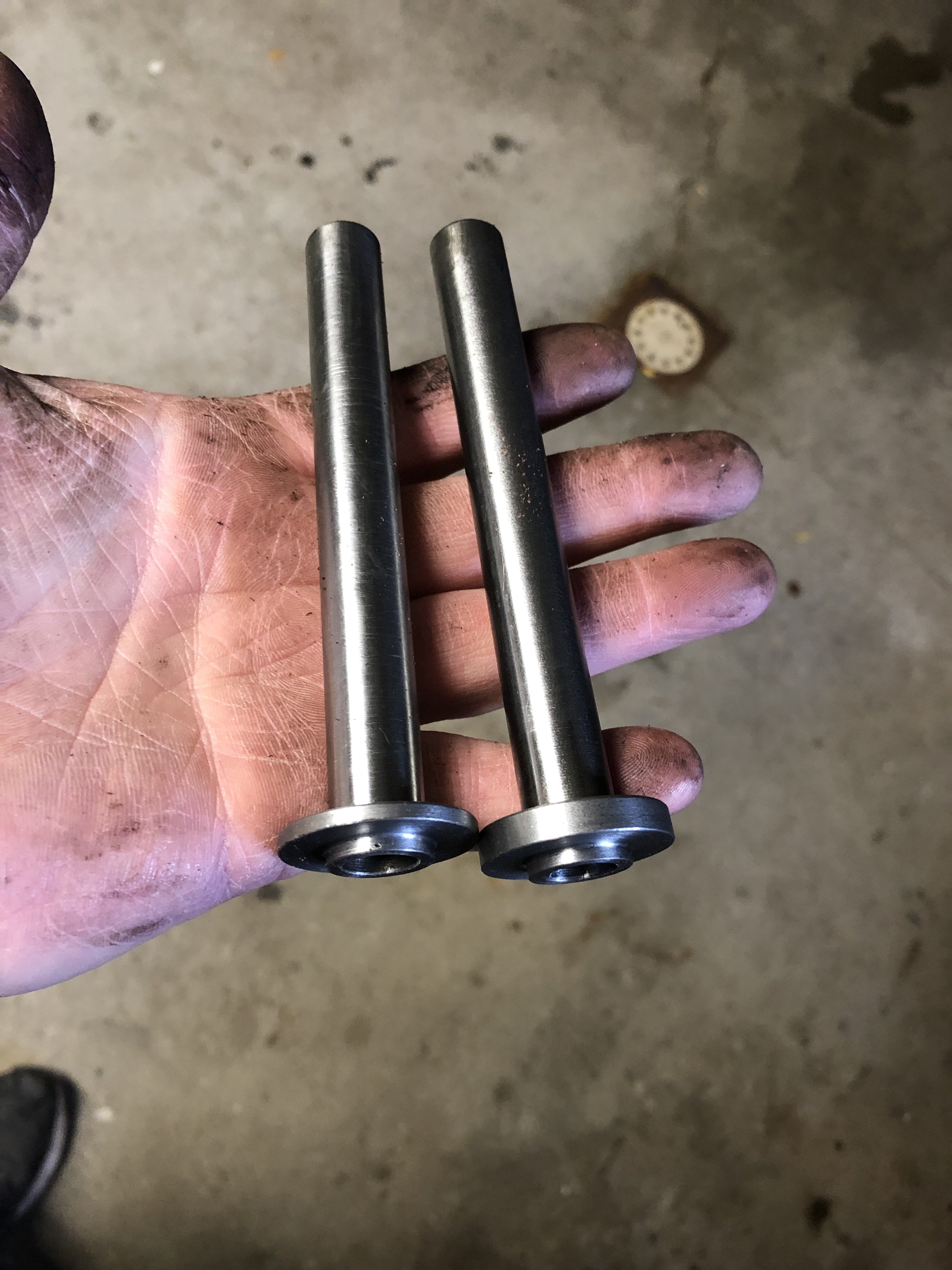

Here are the two style of simple guides I use for center stem designs. Depending on spring OD. STEEL, 4140 , or Nylon6/6 infused with Molly ..Bronze is like buying Gold ,but works well too.. These Nylon guides are Natural and it comes in black too
I prefer to use a rear centering Bushing as it takes the load off the critical base area by dead centering the guide
When the spring allows it I lean towards Nylon as long as I’m not .062 or less wall thickness in the stem. Steel is predictable in any climate but has a distinct feel. They can’t be as tightly fit to the spring. A proper fitting guid in any synthetic should screw into the spring.. Steel is a magnet feel pushing it in.. To tight it will honk.

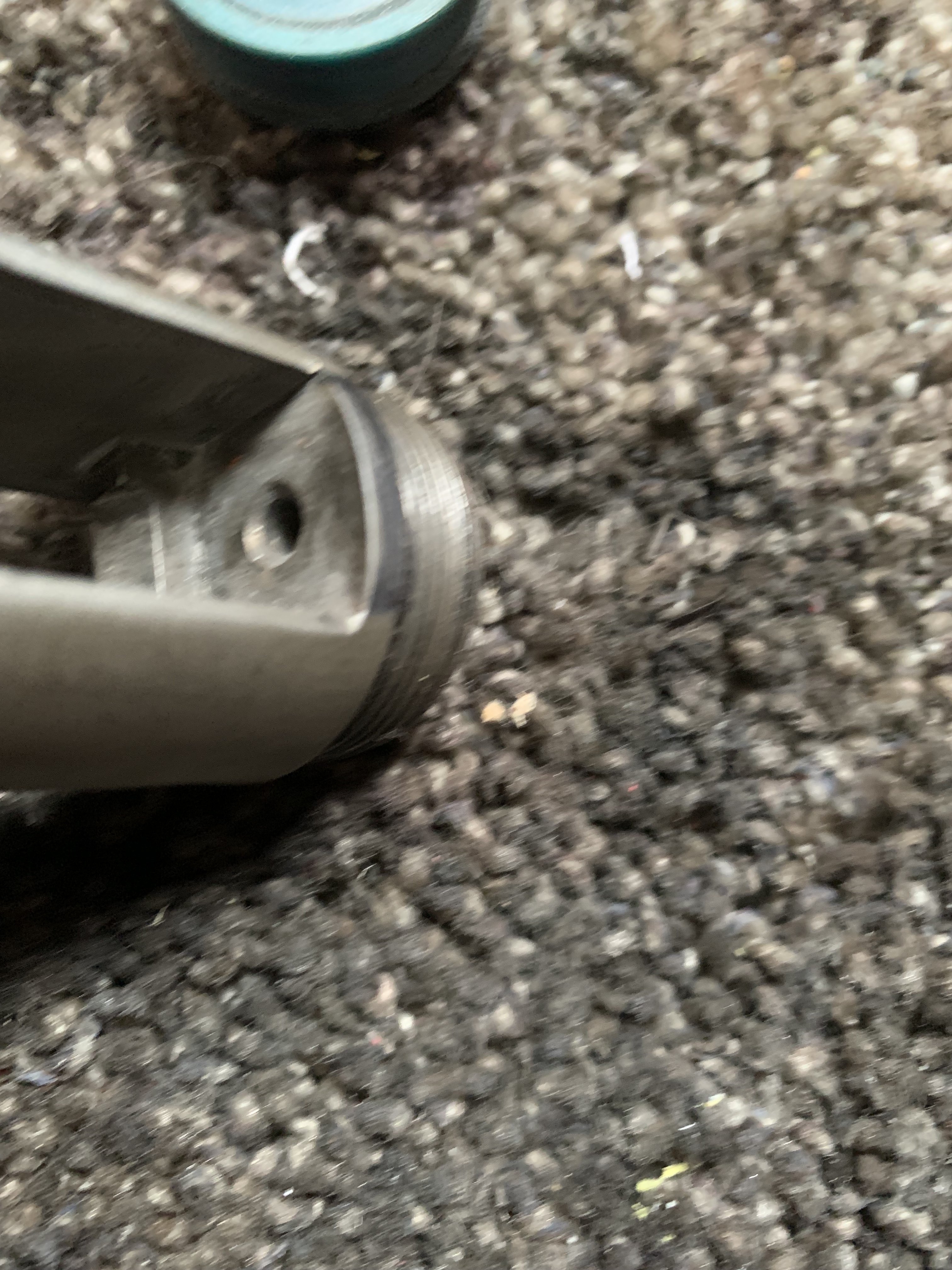

Doing the rear end plug does make you have to bore the rear block so it’s a bit more than some can do. That being said if you button the piston or ring , or even make sure it’s dead centered ,it you can get away with a flat 29.9 rear ring. Now ,I firmly use a stepped Delrin ring for strength to with a hardened shim washer for the spring to rest on the Nylon6/6

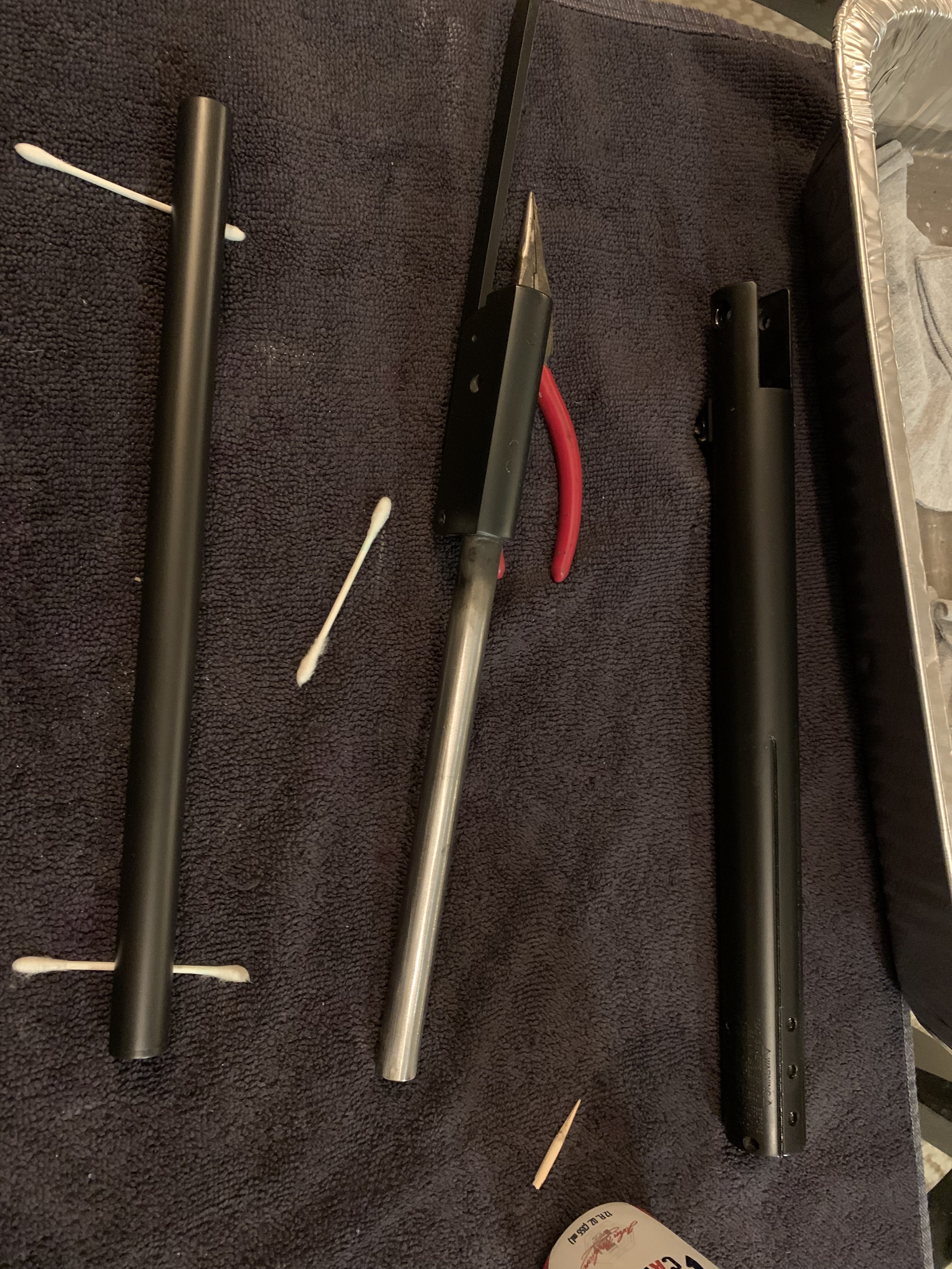

I took a picture of a typical steel washer guide ,TOP ONE in the pic of the three , with a flange to grab the delrin guide. I DO NOT USE THEM OR RECOMMEND THEM.
It’s not if , it’s when the spring will pull it through .. Your mileage may vary..
Top hats are spring centering devices inside the piston .. and sometimes you use steel to add weight to tame the cycle
nylon spacers are used too..
View attachment 429467View attachment 429466View attachment 429481
nylon spacers are used too.. View attachment 429480
