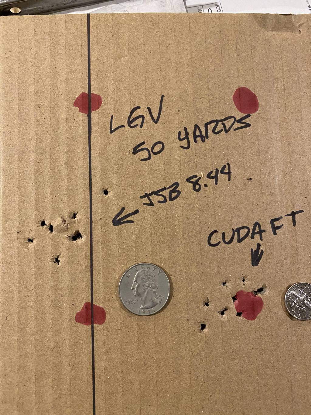

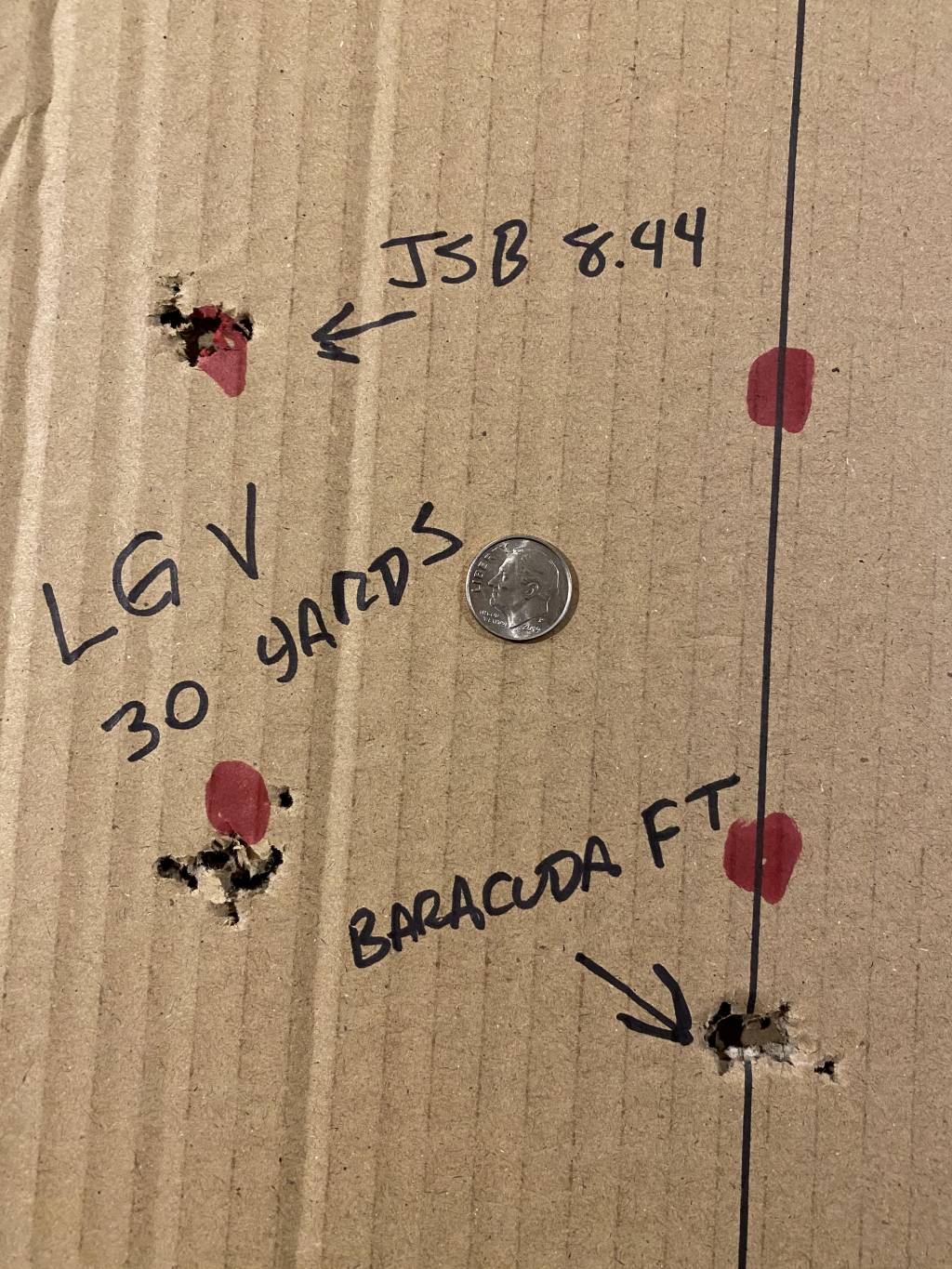

Well she definitely has potential. First shots over the chrony caught me by surprise. JSB 8.44 doing 975fps for 17.7fpe. Loud and jumpy is the only way to describe it. Opened her up right away and unlike the grease packed LGU this was dry as a bone. Took off 2 1/2 coils of the stock spring, quick polish of key parts and a proper lube of moly and black tar. Got it down to 845fps and 13.3fpe and a really quick snap of a shot cycle. Wasn’t very pellet picky but shot great with the 8.44’s and barracuda FT’s.

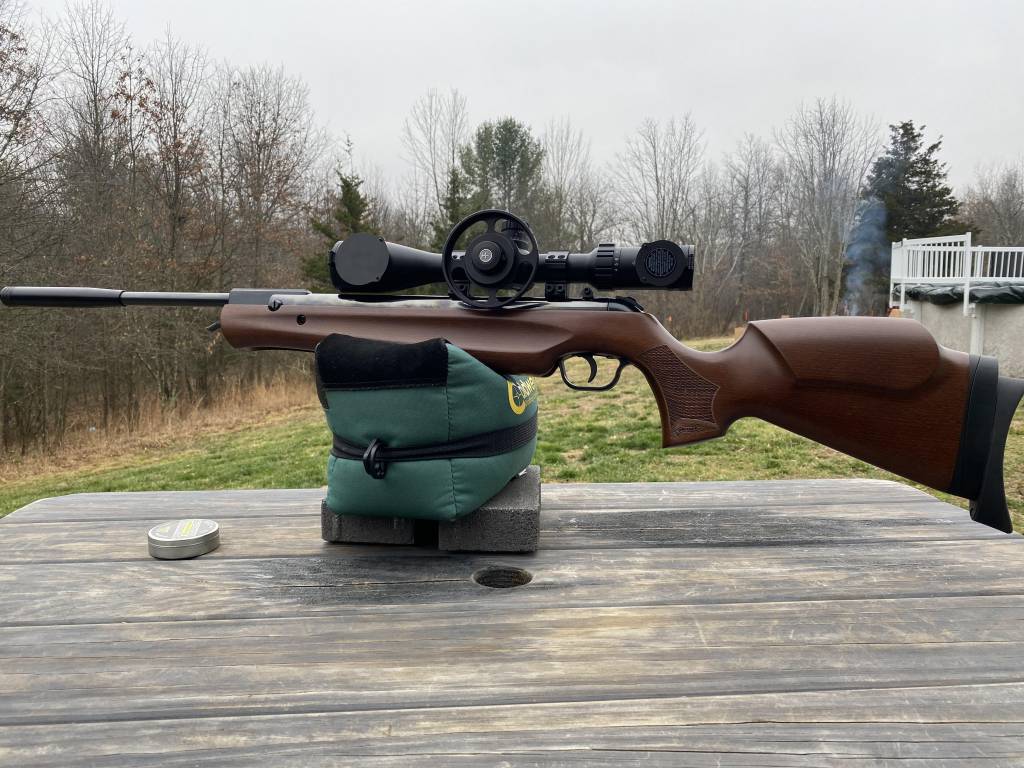

I got the Master Pro. She is definitely a sweet shooter
