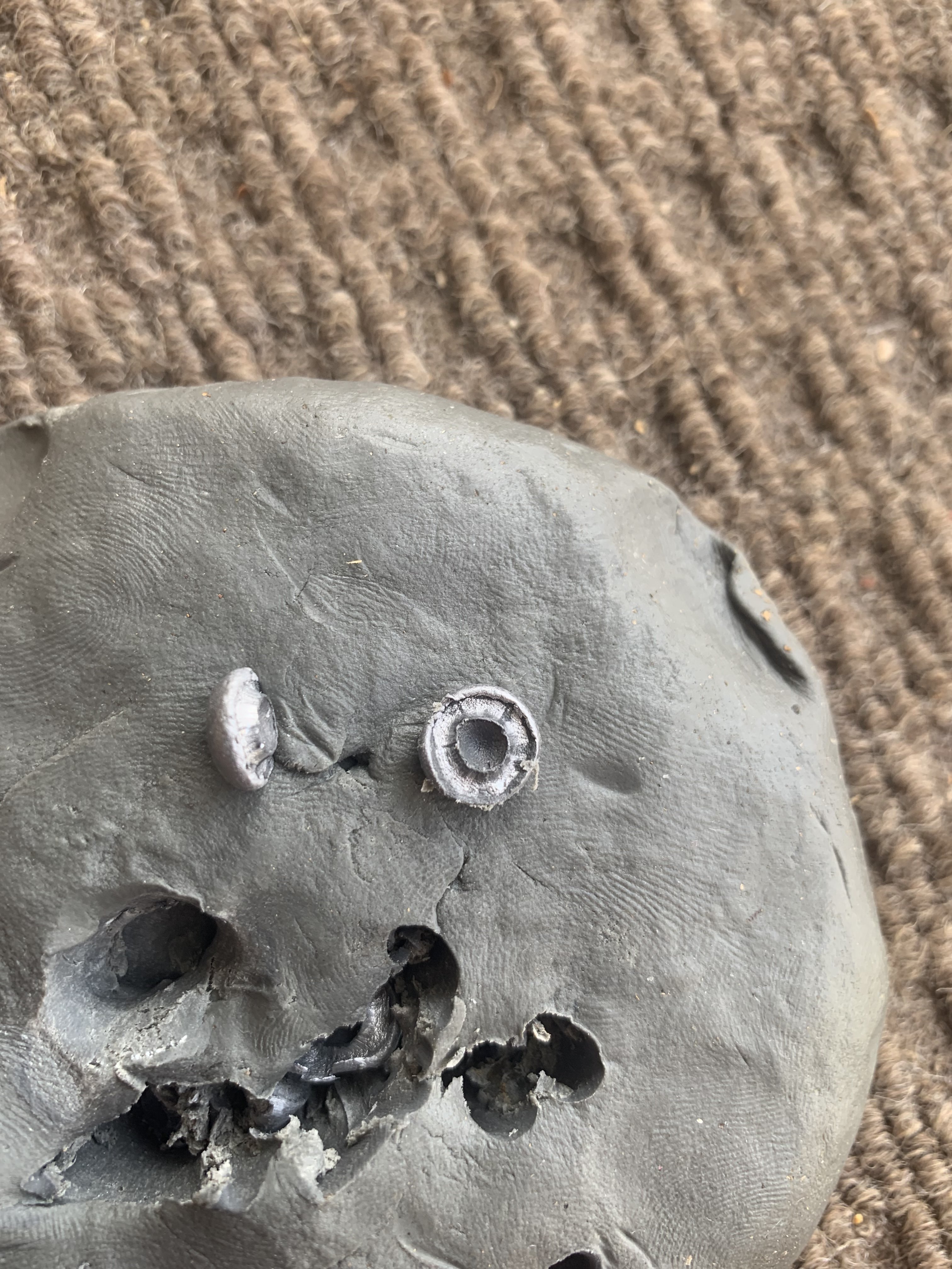

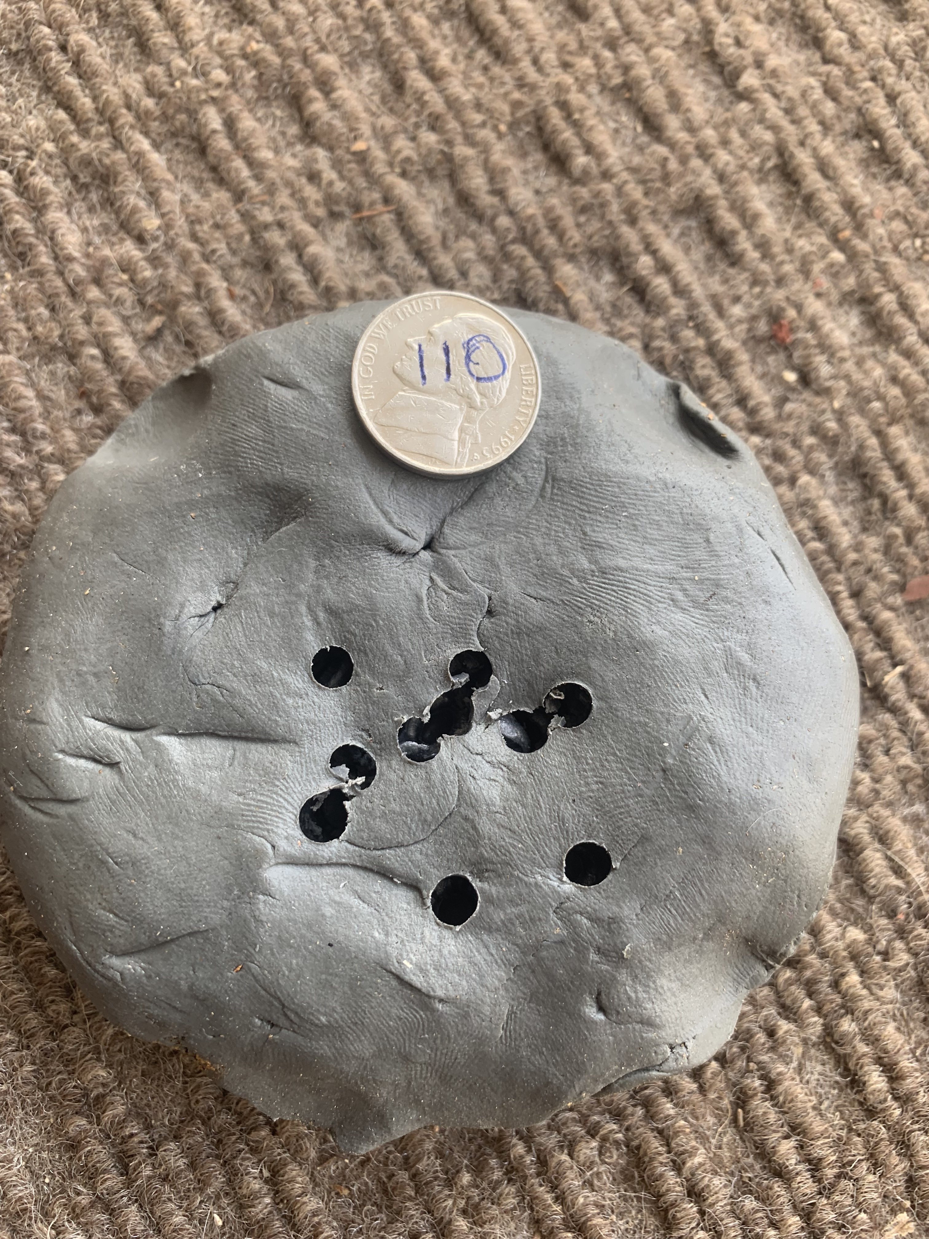

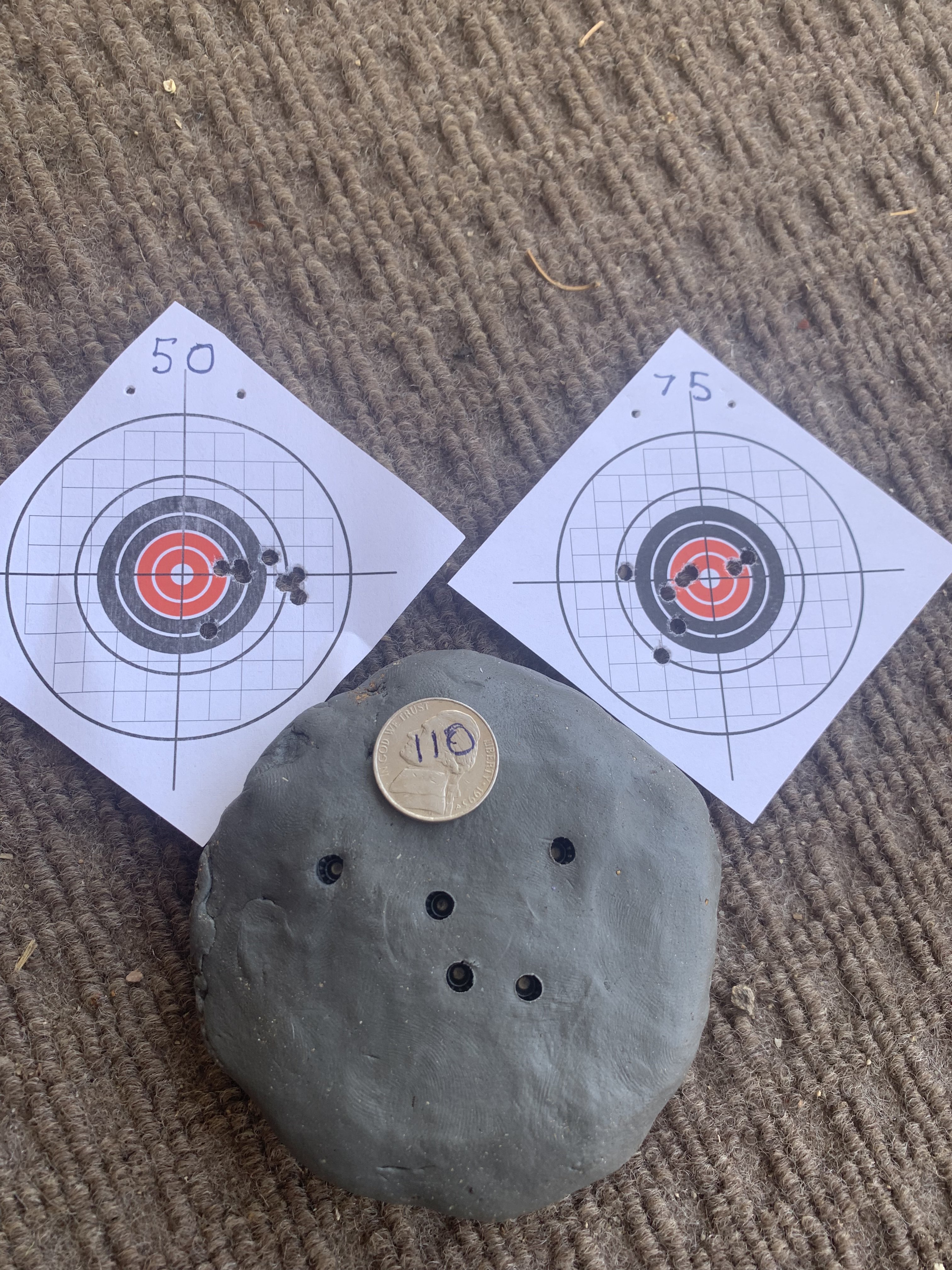

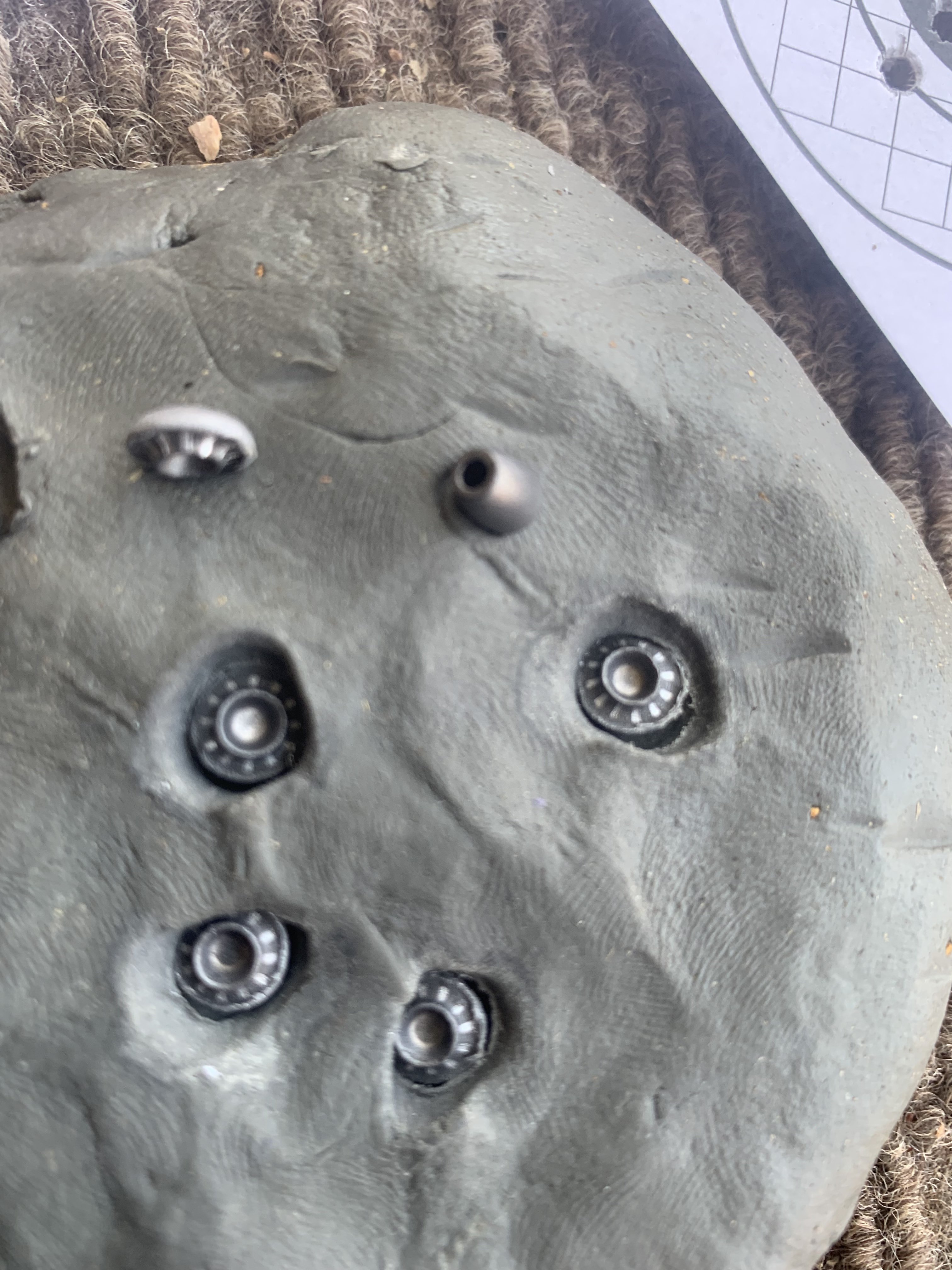

Here’s a pics of groups at 50, 75 and 110 yards. I clicked to correct sighting after the 50 yard group and there was no more than 4mph wind. The 110 yard group involved a duct seal target stuck to a tree. This enables inspection of the slugs, which you can see in the second pic, all fly true to 110 yards and have full expansion. In that pic, one is removed to show the side profile, along with an Intact slug… Remarkably, the 110 yard group is only 1.75 inches. I’m no Ted Bier and I’d be pretty happy with that from my M3. FWIW, around 1mil drop from a 50y zero at 4800ft elevation.

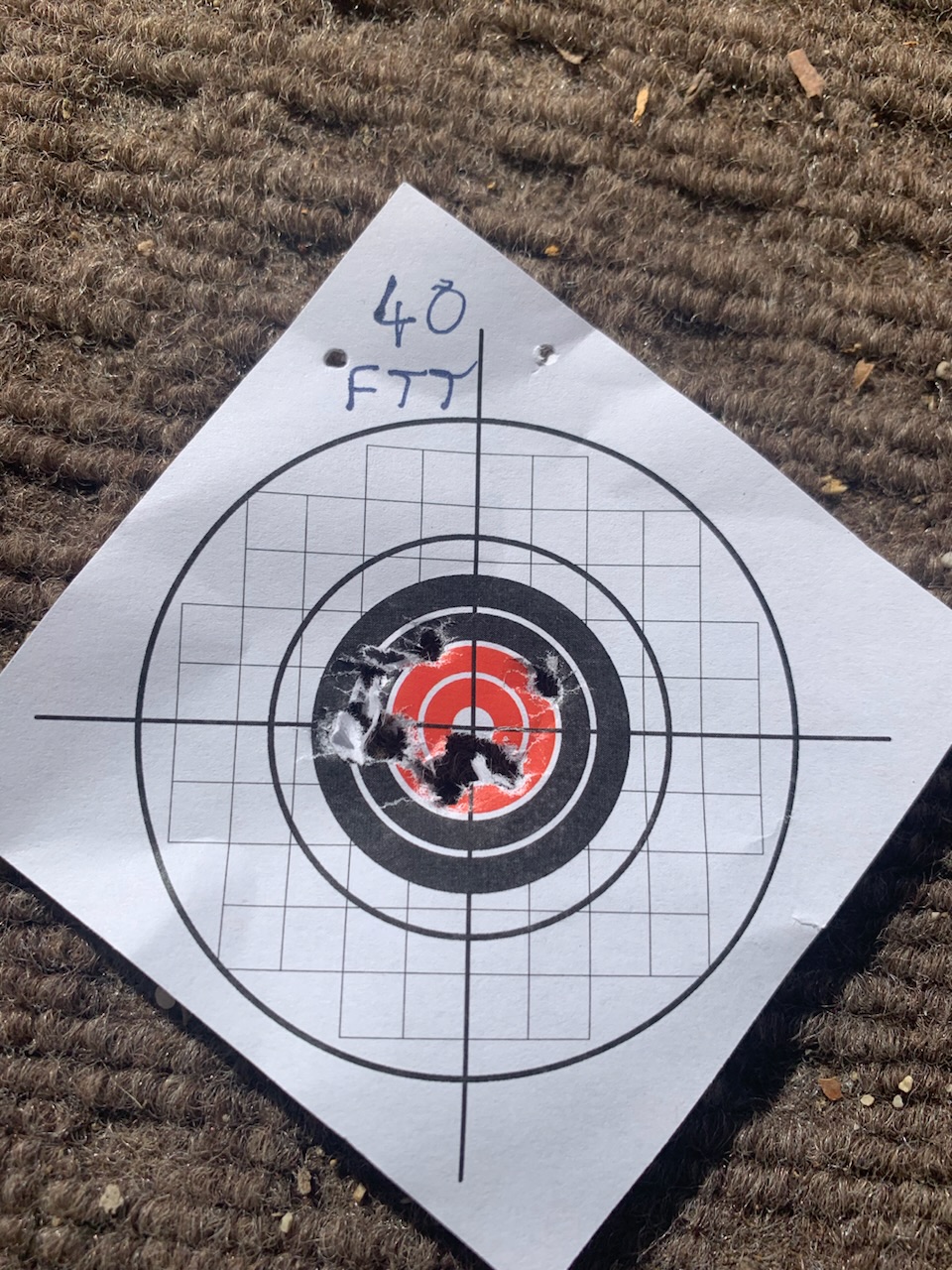

Such a beautiful day for plinking. 5 clicks less hammer tension on the slug tune (so suboptimal at around 80% of max power), I shot the 8.4g H&N field target trophy pellets, based on the mention of field target in beerthief’s post. Plus, I find them to be super accurate in the LC! This is 40 yards with just enough wind to have an effect. Now that was mouse fart quiet. 875fps or 15fpe.

Such a beautiful day for plinking. 5 clicks less hammer tension on the slug tune (so suboptimal at around 80% of max power), I shot the 8.4g H&N field target trophy pellets, based on the mention of field target in beerthief’s post. Plus, I find them to be super accurate in the LC! This is 40 yards with just enough wind to have an effect. Now that was mouse fart quiet. 875fps or 15fpe.View attachment 341525
