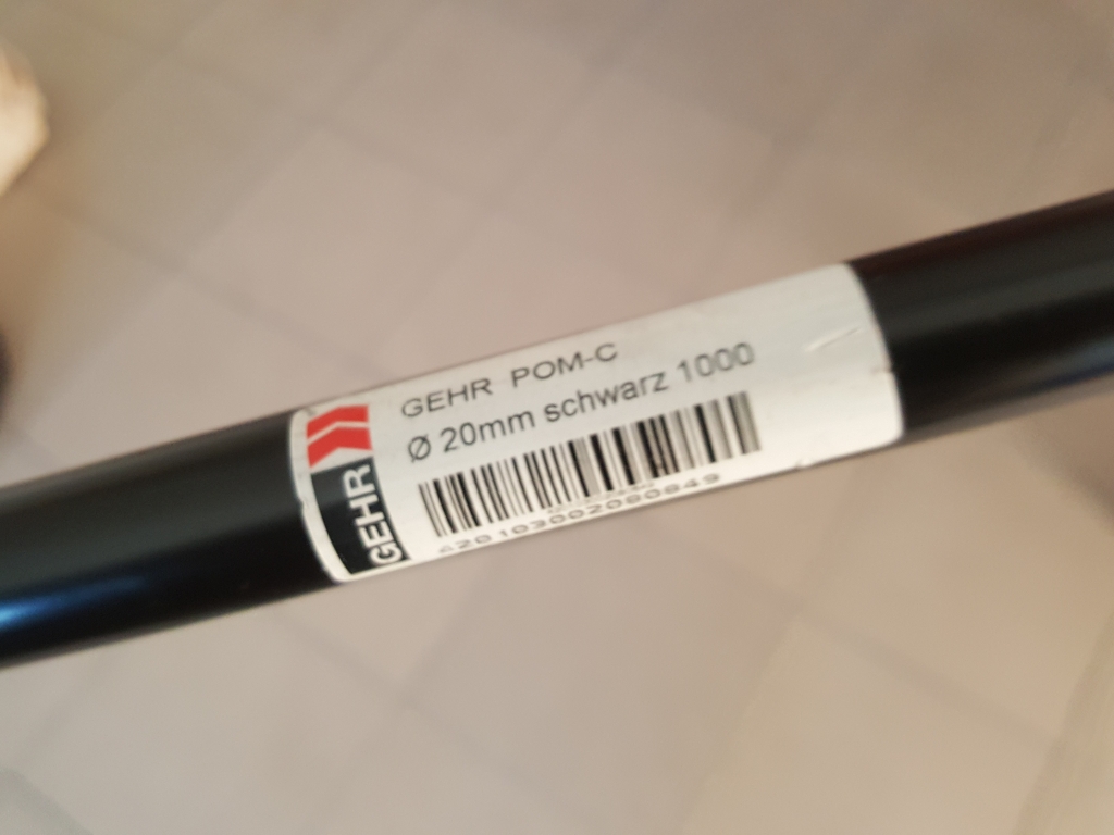

I use this type of plastic, after 5000 it is like new with no change.
