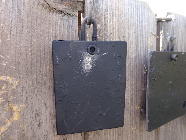

I have no chrono, never had. Trust me on this.....I am getting really good performance in the accuracy dept. I got lucky that it loves the stash of pellets I already own. No need for me to experiment with any others. Remember, I never shoot from any kind of rest ever. Strictly off hand shooting. I have been shooting NRA rifle metallic silhouette for 35 years. I am ranked a Master shooter in .22 rimfire and AAA in high power. The airguns provide me with plenty of low cost practice almost daily. Of the first tin of 500 shots maybe 150 are now at rest inside of a chunk of 4 x 6 lumber. The rest have been sent to that 75 yd. plate or moving little rocks around across the street in the PD ghost town.
That being said, check out this "wallet group" I fired offhand late yesterday with the 80. 2.5" x 3.5" x .250 steel plate at 25 yds. Three shots of HN 5.54 FTT
