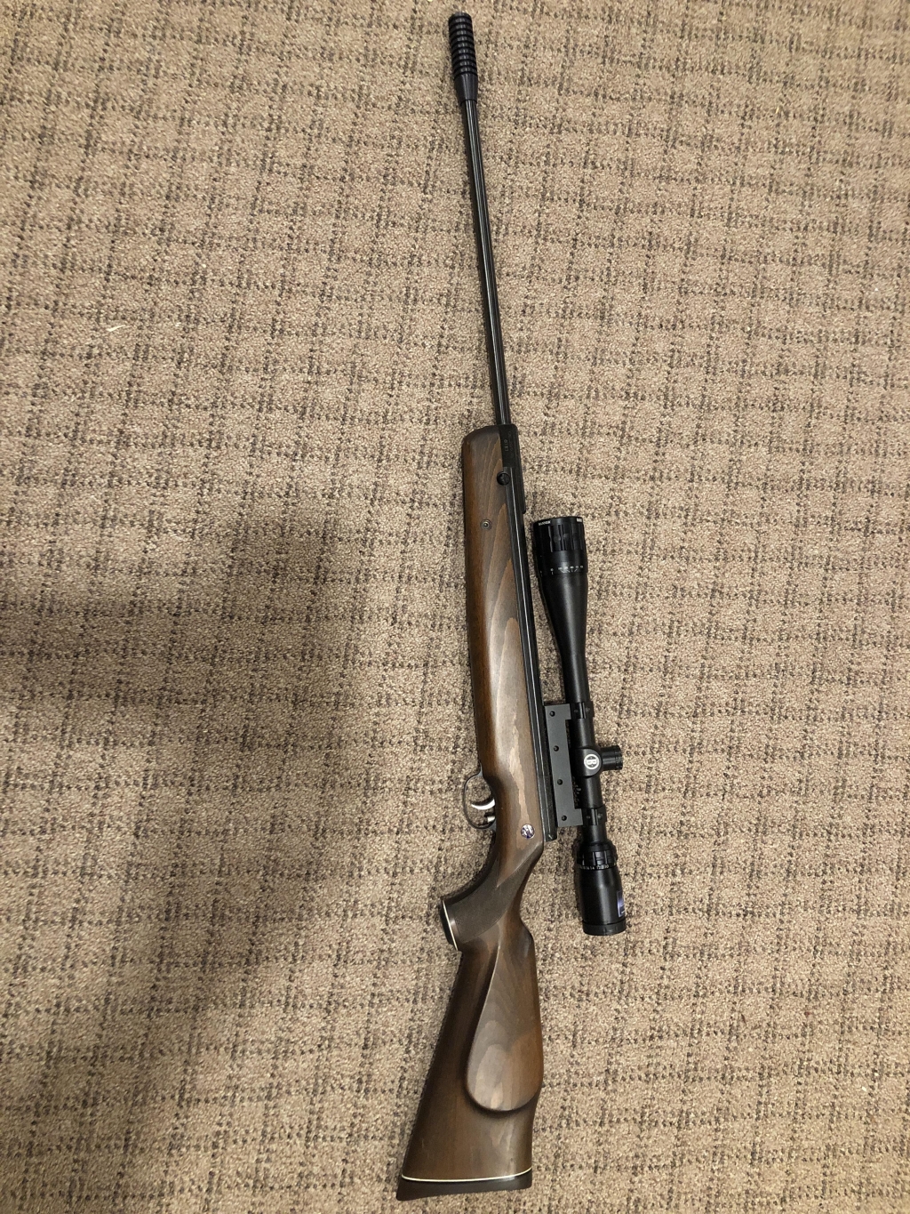

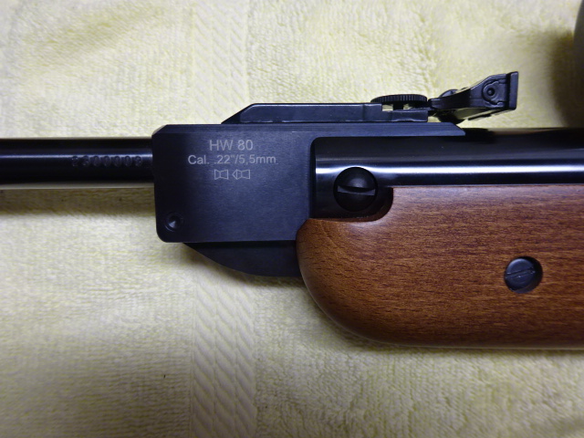

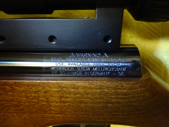

I just might have the newest .22 one in the states. I have almost one tin through it now. I can't put the dang thing down!

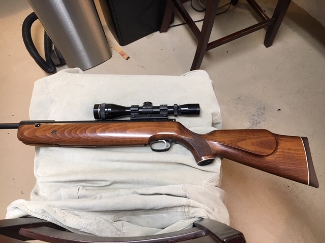

Here is an older beeman factory tuned R1 in 20 caliber. I would be quite confident with this out to 70 yards on a sitting bunny, if I knew my distance. Out to 50 yards it would be all over, one shot right in the boiler room. This is truly a super magnum Springer. You can’t get this much power without it being heavy, and the heaviness helps dampen the recoil from the power. I have another of these in 17, it is an absolute laser. And one other in 25. I am confident I could sit down On just about any day with any of the three and put five shots underneath a quarter at 50 yards from a rest. It is a big heavy, yes I’m going to say it, manly super magnum. If I were going out to hunt bunnies or squirrels for an afternoon, I would grab it in a second. The trigger is wonderful If I were going for a 5 mile hike, I would leave it at home. Still an awesome super springer. I would definitely buy a used old timer, and look for one that was tuned.
Mike
1582954266_19147246695e59f71aba1ae9.71913780_62BC5FA1-C4A3-41EF-9E7E-1BCBFE2B62AA.jpeg
I have R1's in .177, .20 and .22 and they all shoot great with OEM parts. Have some fun...learn to shoot one well and find the best pellet and you'll be rewarded with a great gun for life. Mine all shoot 1/3 and sometimes 1/4 inch c.t.c. 5 shot groups at 25 yards if I do my part and also don't pick a screwball pellet out of the tin. They're not the most pleasant gun to shoot but they do what they were designed to do very well . My .22 is probably my most consistently accurate R1 and my first choice when a pesky ground squirrel burrows under my buddy's foundation. I will target shoot with them but prefer my sub-12 fpe HW97 for that. A great match for squirrels and rabbits and enough power for body shots at 50 yds.

GoldenStateAIRGUNner, it is not really a musical sounding twang. More like a short cycle bzzztt sound with accompanied felt vibration. You guys know what I mean. After cleaning the rifle I had all four screws tightened properly, no locktite applied. All four loosened up in the first 100 shots and my offhand groups opened up. Enough of that nonsense. I have been down the blue and red locktite road on the 34's with limited success. All four screws got my "special process" JB weld epoxy under the cap treatment and remain tight. Back to nickle size or less off hand 35 yard groups. Never put it on the bench for scope sight in or accuracy testing, probably will not. No need, it loves the HN 5.54 FTT's. Glad for that as I have 40 tins in the house!
(Shhhhh....I sneaked a well hidden little aluminum plate out to 75 yards on the newly acquired town property.) Was hitting it pretty regular offhand yesterday. That 80 gets pellets out there quicker than the 34's do. By how much fps? That Vortex 4-12x is a perfect match on the 80.
I will finish up the first tin today and get into the second one. If still buzzing after it's gone I will get the Vortek spring with the supplied grease and Vortek seal installed. And up from there if needed with the suggestions from the 80 users in my other thread.

Correct me if I'm wrong but I don't think the HW rifles use those star lock washers ?

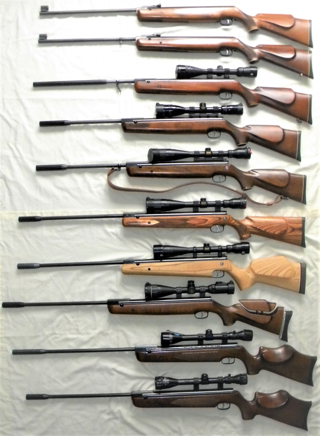

I'm a big fan of the R1 and definitely prefer it's stock to the 80's with the exposed breech block but essentially they are the same. They have stood the test of time and although having been drastically surpassed and pale in the "Super Magnum" class they are or can be made superb. Tune kits are available up and down the power spectrum but these were never designed for the 12fpe reahlm and many have commented how poorly they perform at that power level. The firing cycle is just too slow and adversely affects accuracy in many cases. I have lube tuned and or added Macarri & Vortek kits with nice results. I prefer .22 cal as .177 often needs a pretty heavy pellet to tame the velocity and get good accuracy but of course every barrel is different. I simply do not like the .20 in any rifle although I have a few .20 R1's because they have come with rare stock variants. There are many variations out there from all 4 popular calibers to carbine and rifle length, higher power Laser versions and about as many stock variations as I have seen in an air rifle although some are quite rare and quite hard to get hold of.
1583020572_3768771375e5afa1cadd453.22532034_381 Beeman R1 collection- left side .177, LS .22, ...JPG
OK...I will correct you. Yes, they do have star washers and flat washers, too. Even the under side of the screw cap is ratcheted to match and engage the star. They still vibrated loose until I "fixed" it. They remain tight after 400 shots and will not loosen until I am ready to loosen them with heat transfer.
