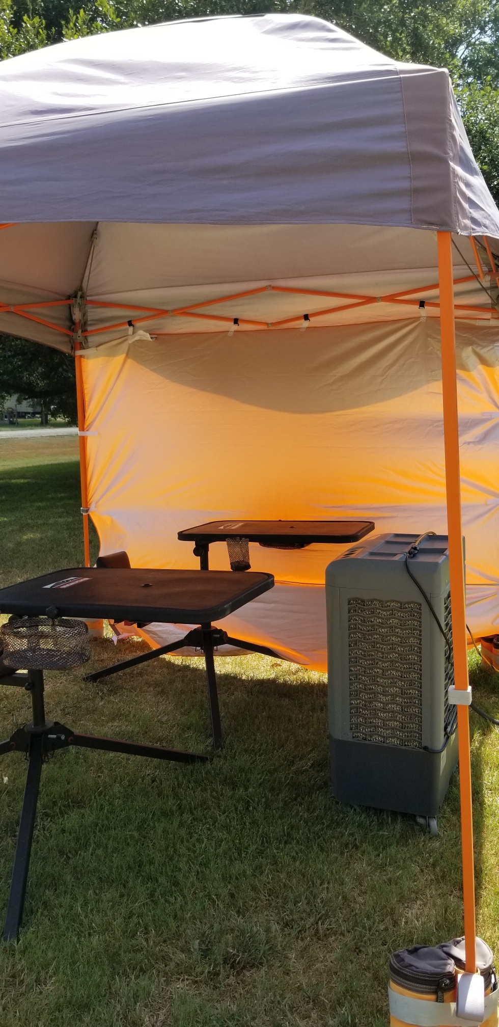

Yep. I won’t take them out in the AM because humidity Is so high even the wood sweats. If I do I take the action out and wipe down. Less humidity in the heat of the day. Actually getting ready to go sit under my EZ Up with my swamp cooler running and shoot a little. All you can do.
This is how we survive it.

Wow! That top shelf!
I’ve had that particular EZ Up for almost 7 years. Close to 25 years of using EZ Up tents, I highly recommend the Dome. Not much more than a Gamo rifle LOL. The benches I got last year at a ridonkulously low price, right place right time on Midway. Less than a Gamo. They don’t put the swamp coolers on sale generally, just have to bite the bullet. They make outdoors bearable in the heat.
