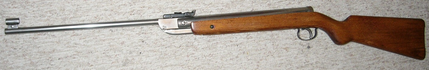

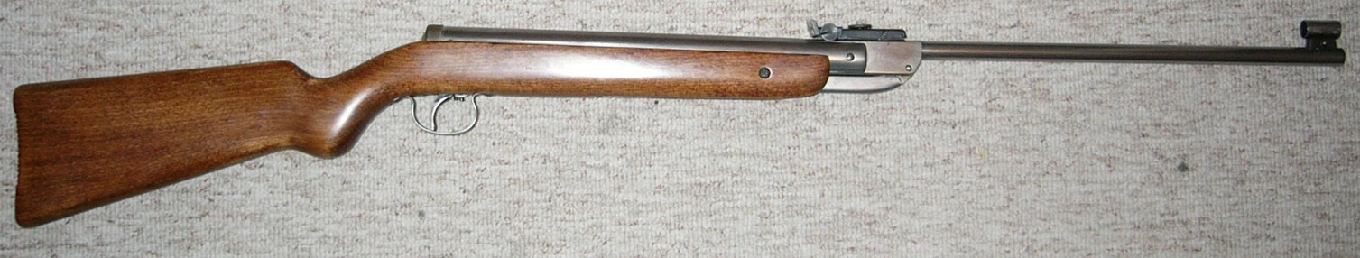

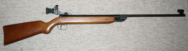

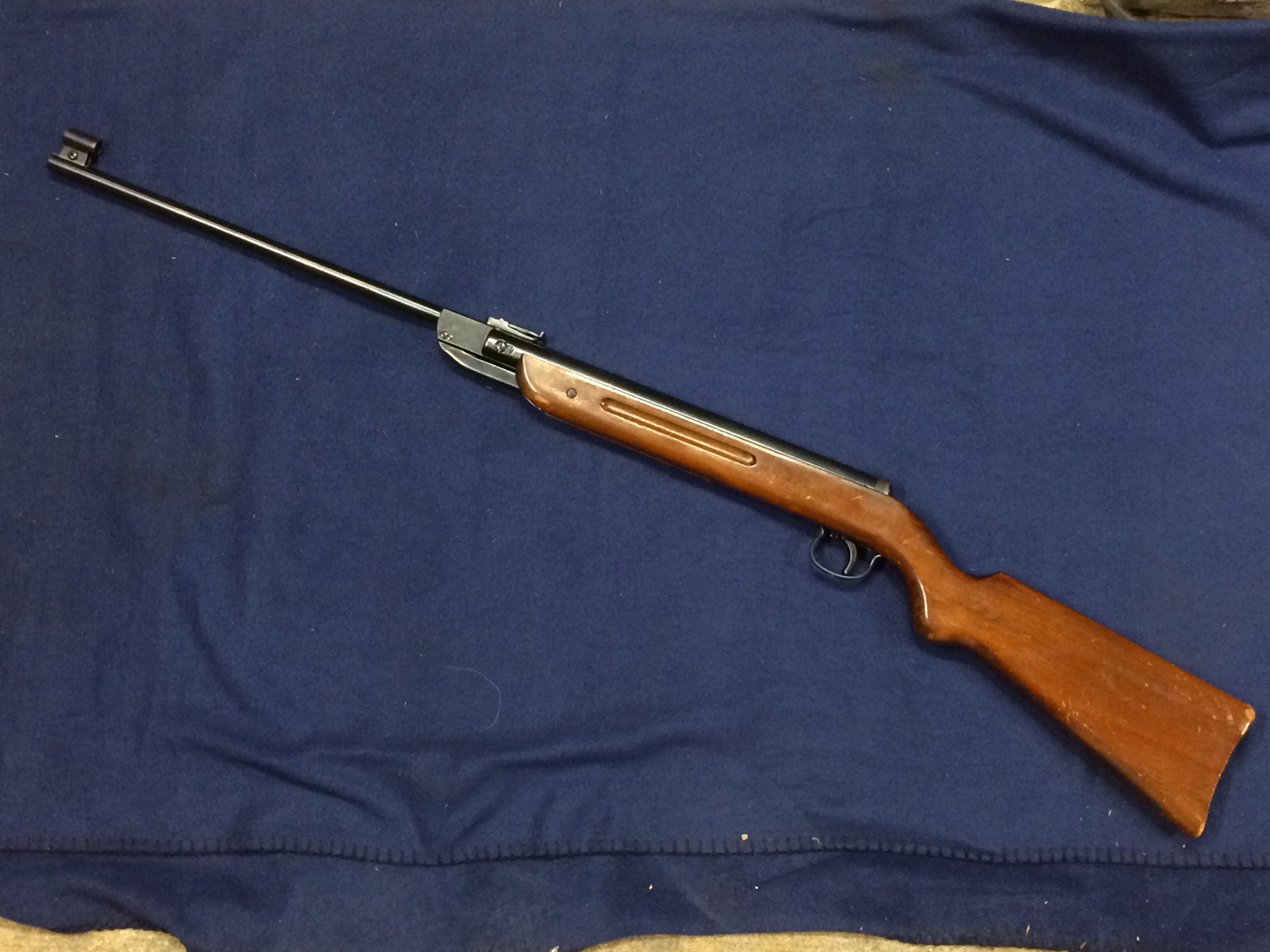

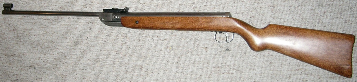

General View:

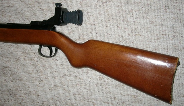

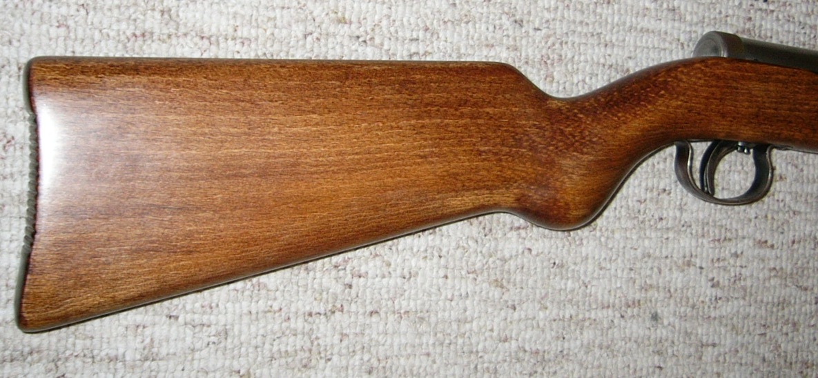

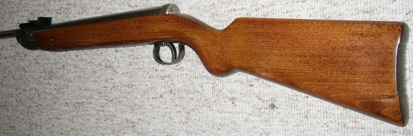

The “pistolet” is rounded, something that was more or less common in older weapons. The stock is made of beech wood, very simple –but comfortable- and it is finished with tinted lacquer (or is it tinted varnish?). The metal is blued and its quality is excellent. Of course, after several decades it wears down and some patina appears, and some rust too.

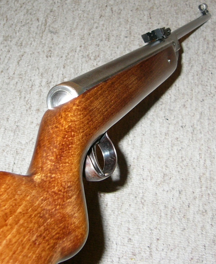

Seen from above, the stock is super skinny. Here you can also see the rail of the telescopic sight (not all versions have it):

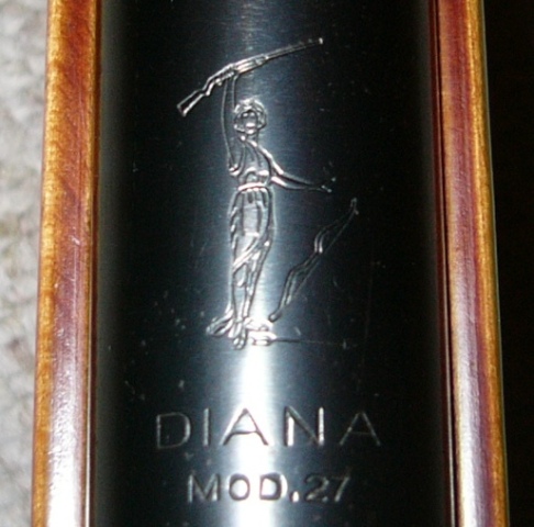

The inscriptions are “embossed”, as was more common before. Here the beautiful logo of Diana, the goddess, who throws her bow to take a pellet rifle!!!

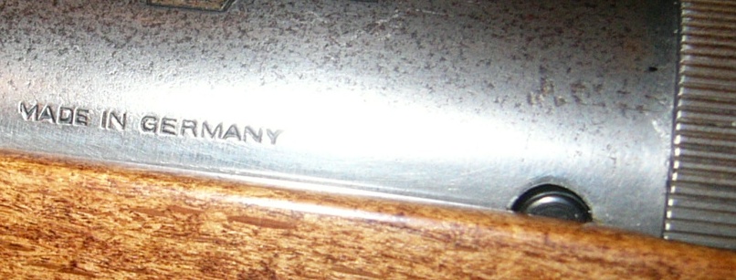

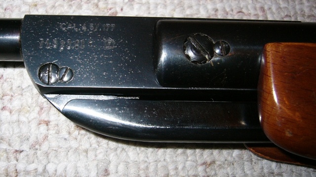

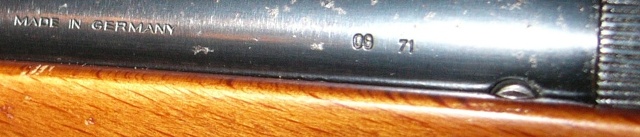

From a certain moment (mid or late 60s?), Diana's began to bring an inscription on the side indicating the date of manufacture. This is from June 1971 (06 71):

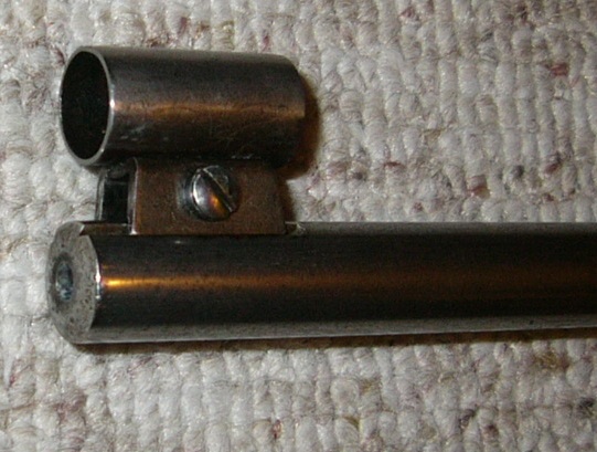

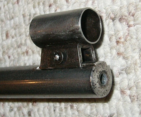

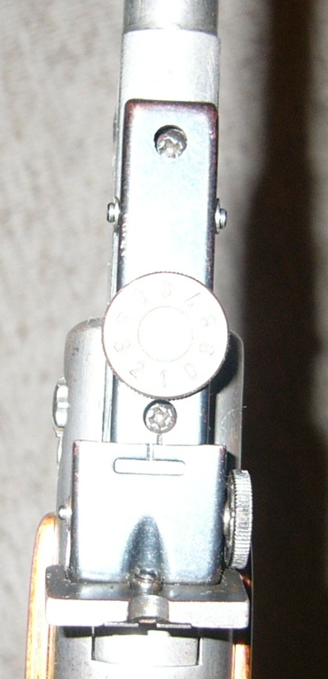

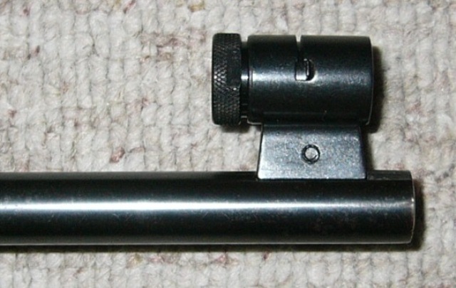

The open sights are of good quality. This is generally true of all Diana's, ancient and modern AFAIK. Here in any case you can't see the original sights, because I replaced them with others. At the back I put a diopter (a cheap Chinese diopter, but works well), while for the front sight I put one with an option of interchangeable inserts. It's from Diana too, but from another model:

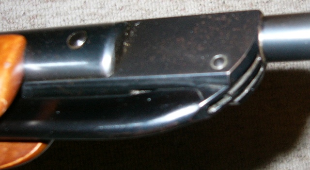

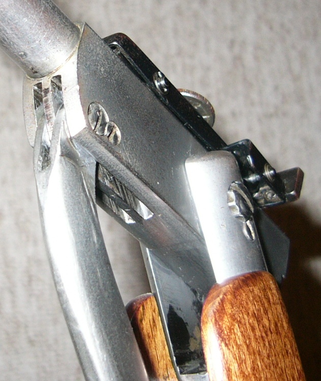

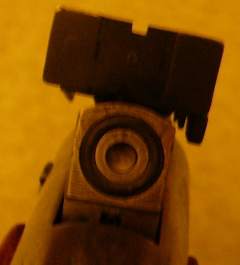

The breech block area is completely rounded, elegant. Most modern spring rifles usually try to hide this area, because it's square and crude. The Diana 27 uses a block design that is round and pretty. See also the quality on the screws (each screw that serves as an axis, has its own fixing screw):

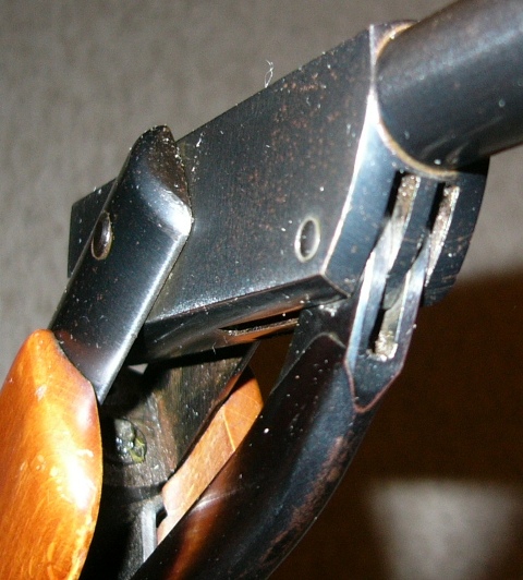

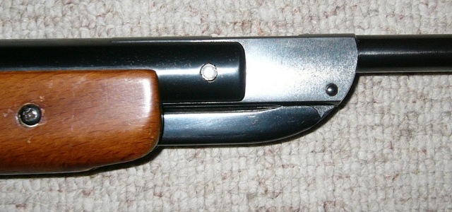

Here is how the lever is attached to the barrel block (again, pure quality). It doesn’t rattle, and no need for a “custom part” to achieve this!

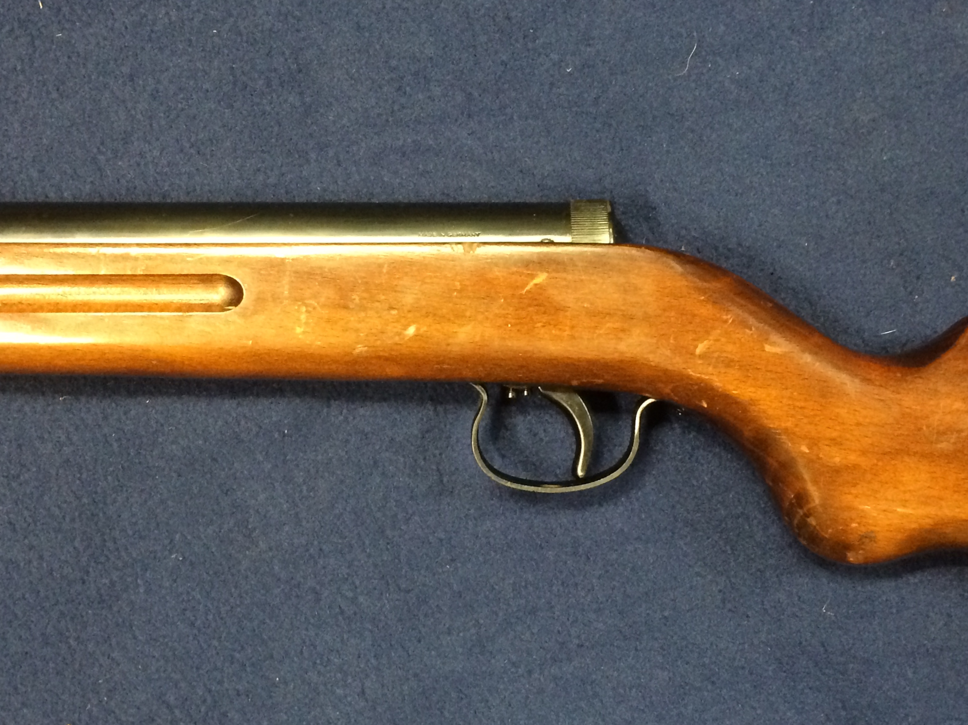

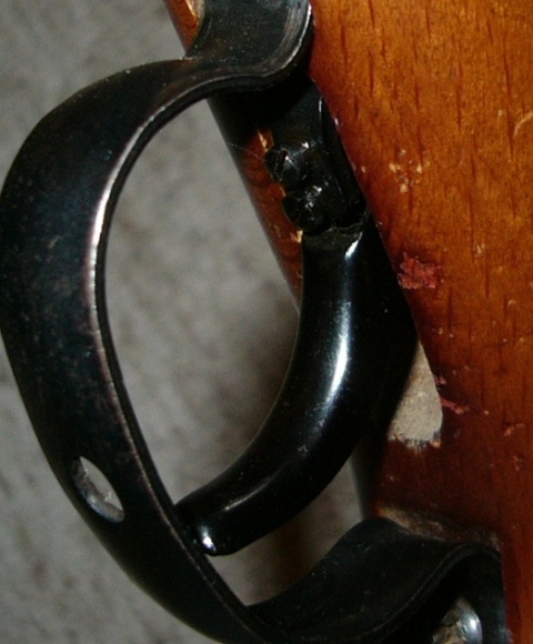

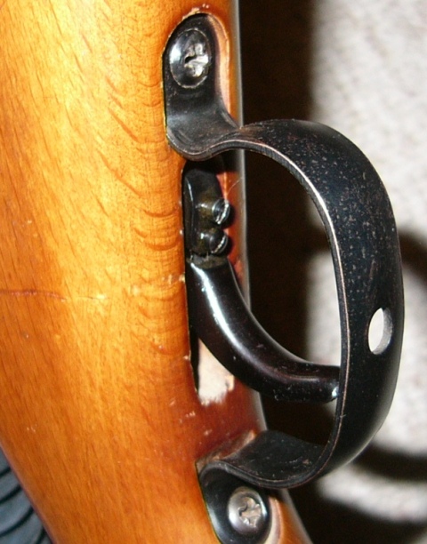

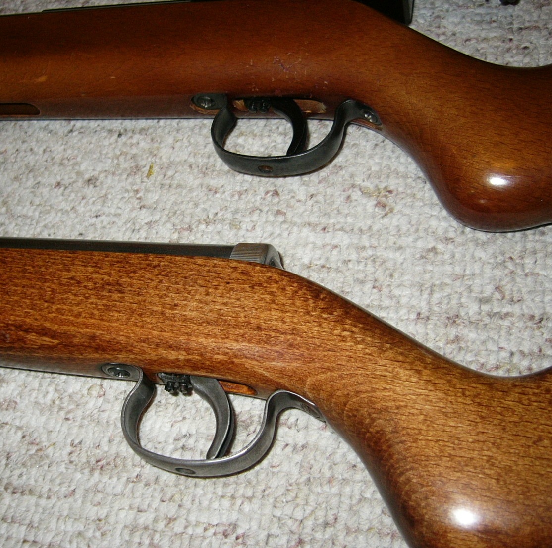

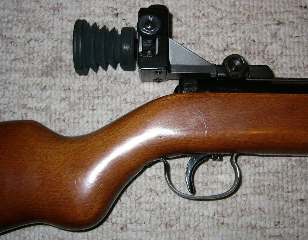

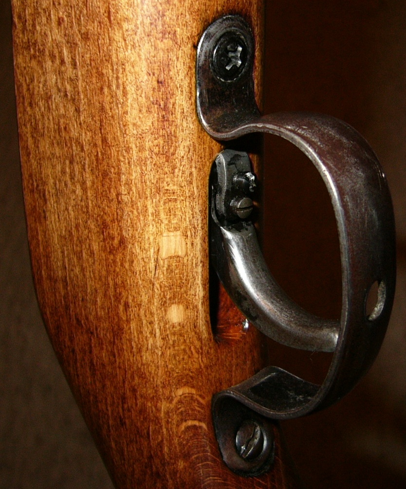

The trigger is what they call “the 3 ball trigger”. A particular design of Diana, dating from a time when triggers were not very good (the HW Rekord did not exist) and Diana came up with this design that was innovative in its time. It consists of two cylinders (one inside the other), the piston rod goes through the innermost cylinder and is “caught” in place by 3 little balls, which will not allow it to move, until the outer cylinder moves, releasing the balls – which is caused by the pull of the trigger. This way, the higher brute force of the spring/piston is supported by the 3 balls, and the trigger itself only has to deal against the outer cylinder, which is a much lower force. This design was used even in modern rifles of Diana (example: models 48-52-54 with the called “T01”), but then it was changed to something different (T05?) which, I guess, was motivated again to reduce costs. The trigger of the 3 balls I think is very good, it feels good on my 27:
Screw “A” adjusts the limit point between the first and the second time of the trigger, and with the screw “B” the screw “A” is fixed so that it does not move. Again, quality from a time when they were not yet thinking about saving costs. If they made it today, it would only have 1 screw!
Note: There is here in the forum an excellent thread about the 3 ball trigger.

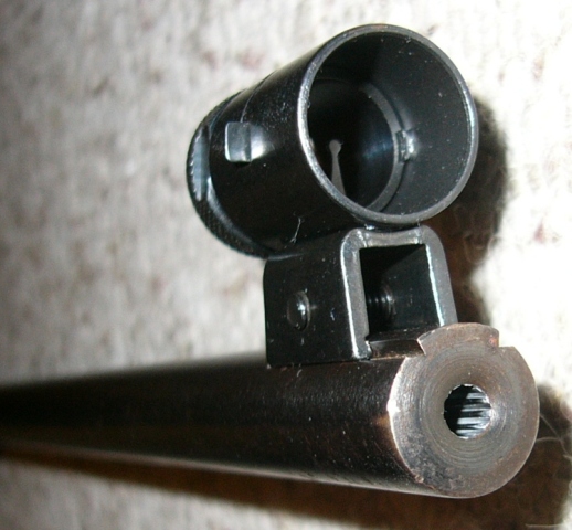

The grooves on the barrel are deep. Also, the barrel has a choke (or semi-choke?). Some say that in the process of machining (or pressing) the front sight mounting rails on a barrel, it automatically created a semi-choke. True or not? Anyways, the choke can be perfectly felt when you clean the barrel:

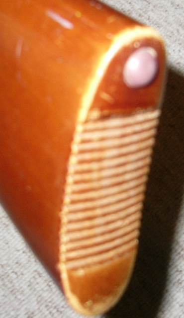

In the butt of the stock there is a little red rubber button. Someone once told me that this is here so that the rifle doesn't slip when stored (when stored standing up):

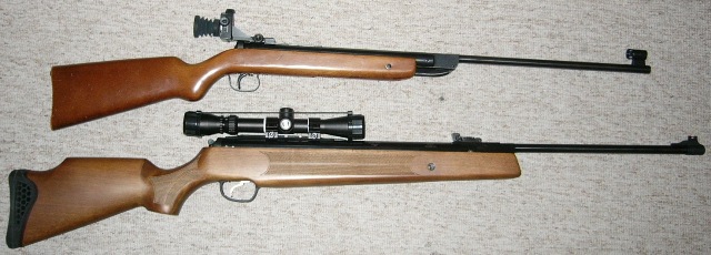

Here is the Diana 27 next to the Hatsan 135 (a Turkish magnum gun), for comparison. It is not so much shorter, but much lighter, more stylized and less bulky:
When I cock the Diana 27 and think about the 8 fpe it generates, I can only conclude that the Hatsan 135 should give 80 fpe!!!

Very nice write up. I'm normally a Weihrauch guy, but a friend sent me an old leather sealed D27 to fix. It was crunchy when I got it due to a bent guide and spring. After it was fixed, it was a darling little rifle. I would have given anything to have that gun as teenger. Simple, light to cock and accurate. It was like a slightly bigger HW30 that felt lighter in hand.

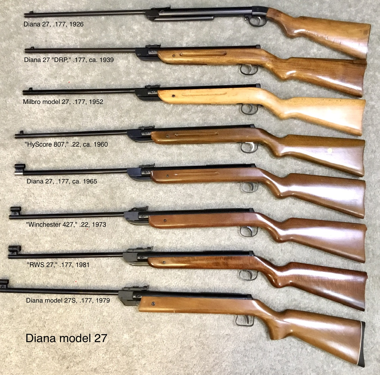

Here's a pic and a couple old threads you might get a kick out of (one secret to finding a 27, is to search under its many other brand names: Diana 27, Geco 27, Gecado 27, Winchester 427, Hy-Score 807, RWS 27, Original 27, Beeman 100, and more...!
This great old article by Ladd Fanta, posted on Paul Watts's site, turned me on to the 27 in particular, and older lower-powered springers in general.
A pic, and some old threads you might get a kick out of (one secret to finding one, is to search under its many other brand names: Diana, Winchester, Geco, Gecado, Winchester, Hy-Score, RWS, Original, Beeman, and more...!

That older model of MDriskill with the small wood stock (1926) is a total beauty. I have looked at that pictures many times (not here for the first time), always with some “healthy envy”. LOL.

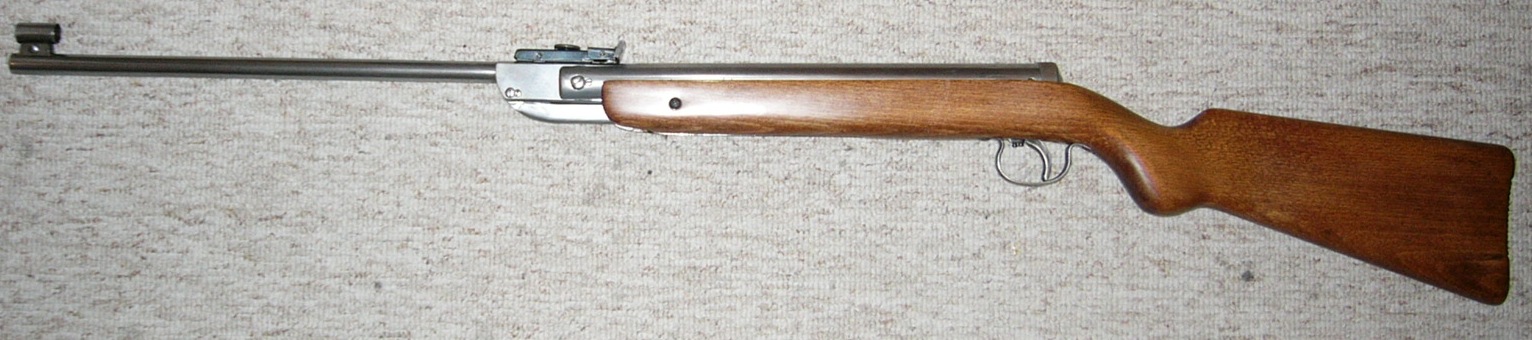

I will post pictures of my Gecado 27.
Reactions: bf1956

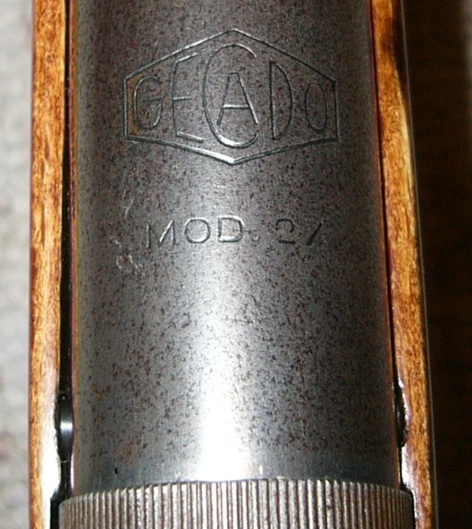

As has been said, “Gecado” was a brand or trade name with which Diana rifles were exported to many countries. They used –I think they still use- several other brands: RWS, Hy-Score, Original, Geco, even Crosman. Here in Chile the “Gecado” was predominant, so few “Diana’s” with the Hunting Godess logo are seen.

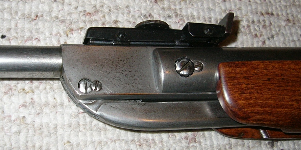

When I bought my Gecado 27 it was in poor condition. Almost no bluing left, it was “painted” with a black paint. Under the paint you could see that someone had crudely sanded with low grit sandpaper, metal was scratched and rusty. The trigger was loose and missing a screw. The open sights were loose too. The stock was poor condition, many scratches and no original finish left. Etc. Power was low about 5 fpe, but accuracy was fine. Also, this gun has a smoothbore, not a rifled bore, GULP.
I repaired it. I polished the metal parts, removing all bluing, rust, and paint. Sanded it down and mirror polished it, as much as I could, then waxed it. I sanded and re-finished the stock with gun-oil. Changed the loose parts of the trigger etc. Also took the rear open sight apart, cleaned and with a few adjustments it was firm again. IIRC, TW Chambers from UK and Schneider from Germany had many original parts available back then, and were helpful for my project. I also redid the powerplant...
I was happy with the result.
So, I think: If you ever have a very poor / very beaten 27... it is highly probable that you can convert it into a priced possession.
Pictures of Gecado 27 after the repair:
Accuracy with open sights is good. Up to 10 yards it almost stacks pellets. This intrigues me a bit, because it’s a smoothbore gun... For me this proves that a smoothbore is not deprived of good accuracy at close ranges. Beyond 10 yards it becomes a bit inaccurate compared to the Diana 27, but I couldn't tell it's because of the barrel, or because of the open sights (the Diana 27 has a diopter). In any case, at 25 yards it groups like 2 - 2.5 inches CTC. Good enough for my plinking pleasure. Note: At 25 yds all pellets arrive perfectly “straight” on paper.

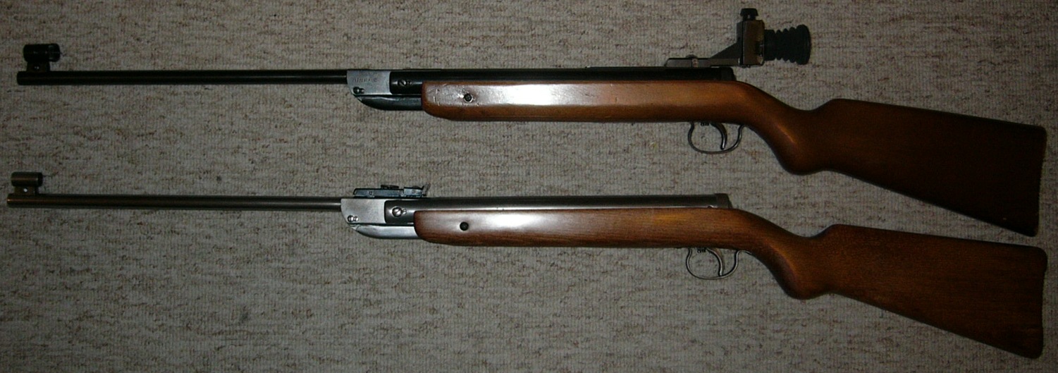

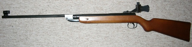

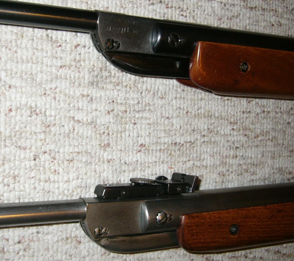

Some photos of the Gecado 27 together with the Diana 27 for comparison:
Differences between both:
- The Gecado does not bear an inscription of its date of manufacture. I presume it is from the 60s approx.
- Open sights are different. Diana used several different designs (at least 2) of open sights, all of good quality. I think they even alternated them over time.
- The Gecado does not have the little red button on the stock, like the one on the Diana 27.
- The Gecado does not have a rail for a telescopic sight.
- This difference can only be seen when actions are out of the stocks: The way in which the action fits into the stock is different in both rifles. That is, both guns have a different “inletting”. This is important if one ever wants to buy a replacement stock, one should double check that the stock will fit / or at least be ready for some wood-working.
