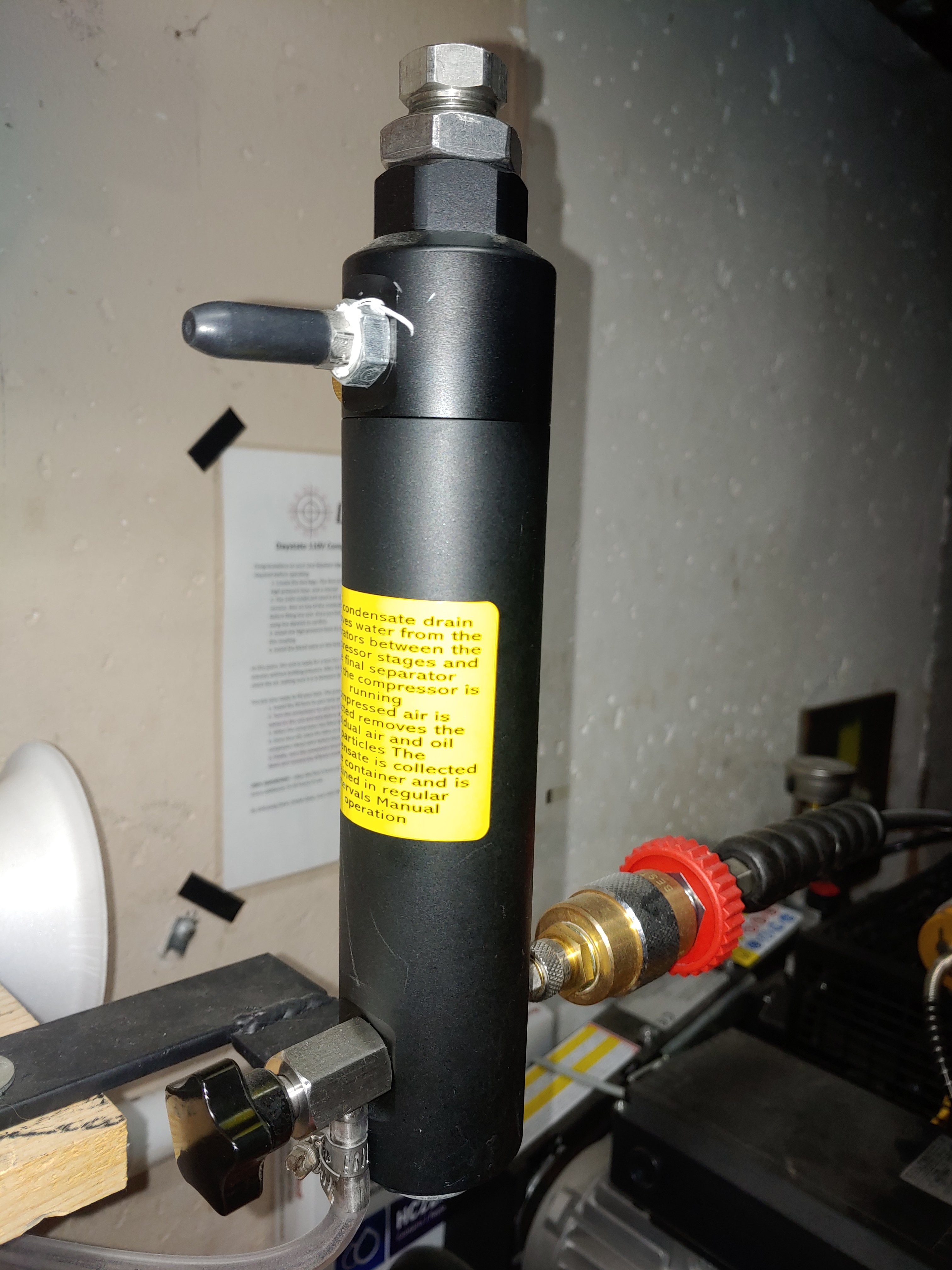

The compressor hose and it's 90 degree connector is moved from the tower and threaded into the output side of the gold filter using teflon tape. The existing 300 DIN on the fill hose can still be used as is if you prefer. It can be unthreaded from the compressor's fill hose and replaced with a Grainger adapter, part #6W433. Then you can attach it to a female threaded foster quick connect, or female threaded male foster if you prefer. I used two 90 degree 1/8 npt threaded male to female elbows at the output of the water separator tower and at the input side of the gold filter. I threaded a male foster check valve into the input side of the gold filter. I connected a 2' high pressure fill hose that terminates in 1/8 npt male threads between the tower and the gold filter. One side is threaded into the street elbow on the water tower. The other end of the hose has a female quick connect which connects to a male foster check valve threaded into the 90 degree npt elbow on the underside of the gold filter.

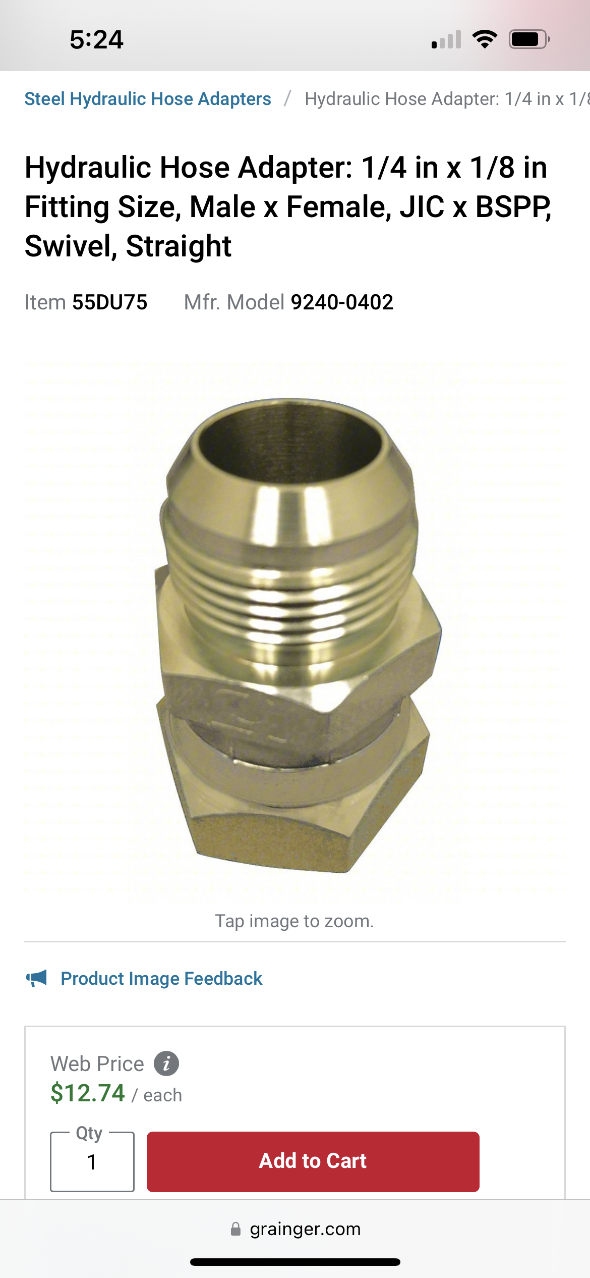

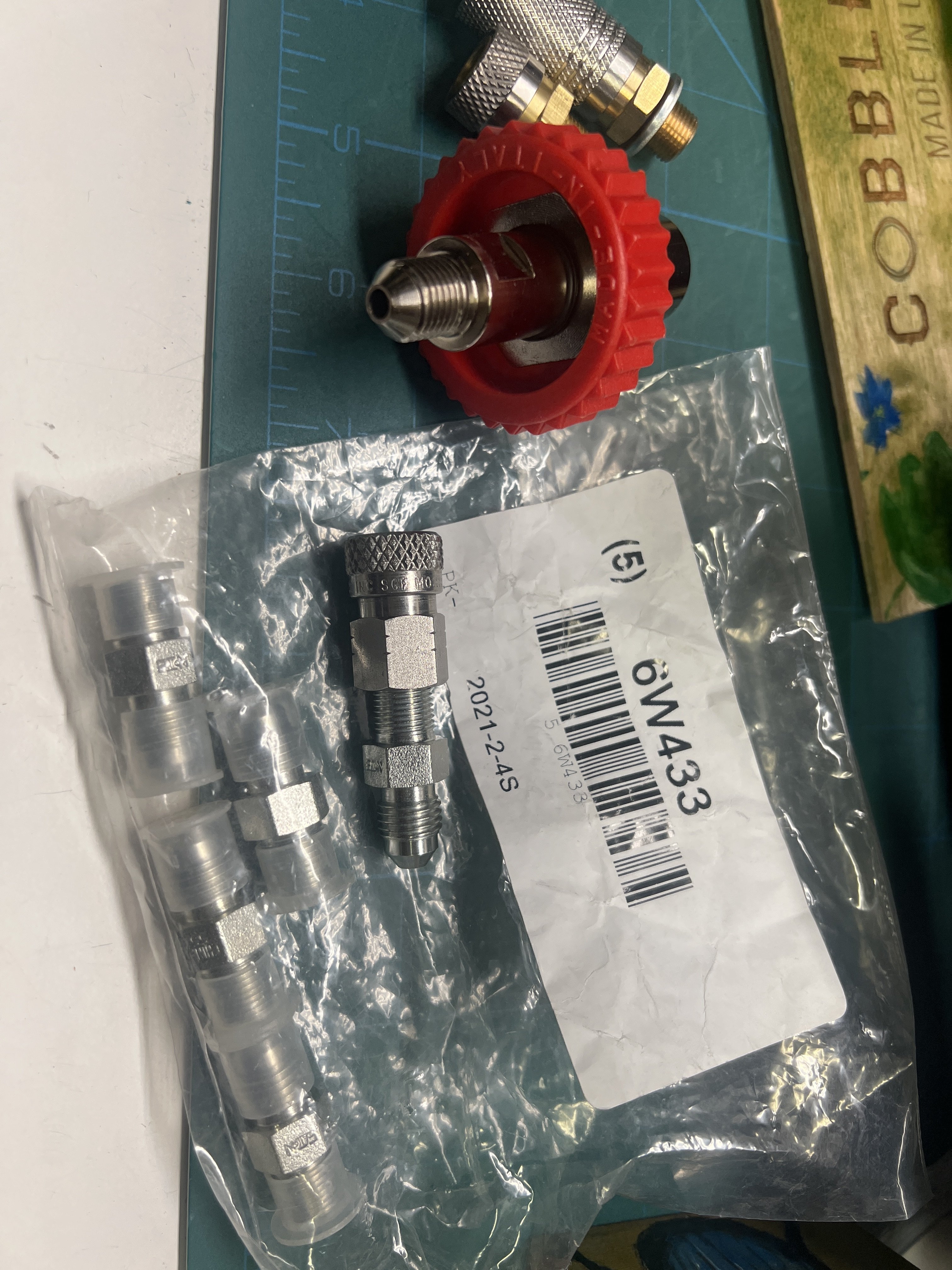

The grainger part that link was provided has nptf threads and not bspp that quick connect foster fittings use, so it won’t work without another adapter.
I basically wasted $20 including shipping and have 5 of them . They only screw in one thread into female threads of foster fitting.

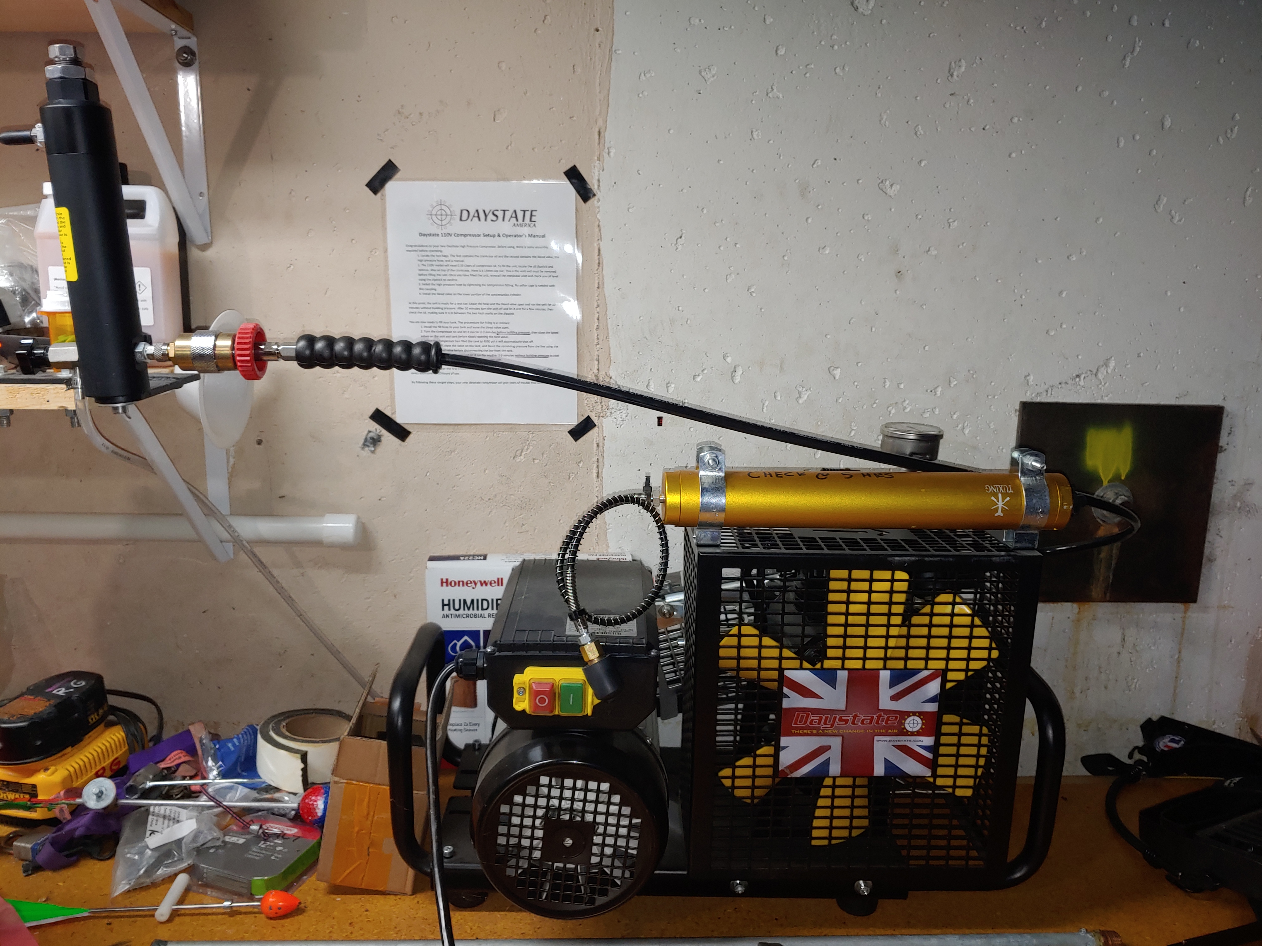

I bought my LC110 from AOA. Close to 100 ours on it and so far so good. I let it run a few minutes before filling my tank and run it a few minutes after filling the tank with bleed valve open on separator, just like the manual says. I bought a gold tux filter, you can see how I mounted mine. My idea was to keep the filter higher than the outlet of the separator on the compressor so any moisture in the hose will drain back to the separator. I then purchased a filter from Joe Brocotto that filters under pressure, unlike the cheap Chinese gold filter and also mounted it higher than the discharge side of the separator on the compressor.There is a difference between the two, after reading the info. I bought Joe's. Why skimp with a 40.00 Gold filter when your putting air into your high dollar air rifles, and ANY moisture is a big NO NO, that was my thinking.
Romy, My post included photos and identified each part that connected to the adapter. There are six different connection types of quick connects. There are NPT, BSPP, and M*10 threaded quick connects in both male and female configuration. Instead of getting a JIC to BSPP swivel adapter, just buy a very commonly available NPT female thread quick connect. The instructions were correct and illustrated. Understand what you're buying instead of being critical of the post for your mistake.
It’s my mistake for not being patient and not verifying the thread on my quick connects.
I have several, males and females that I got from different places , where some were given to me. All have bspp threads so I assumed it was a common kind.
I already placed another order with grainger for that swivel but will be returning it all and getting a different fitting.
I have a female quick connect on my tank side , this should work then?
That
No, that won't work either. What I have in my post is an NPT female threaded quick connect, not an NPT female threaded male Foster.
This is the part you need. I use this link to illustrate but you can buy them at lots of places online. https://www.ebay.com/itm/4040582373...i0mLZG1B3qv784K13szr9Bu7/g==|tkp:BFBM4MWz9adh

I bought my LC110 from AOA. Close to 100 ours on it and so far so good. I let it run a few minutes before filling my tank and run it a few minutes after filling the tank with bleed valve open on separator, just like the manual says. I bought a gold tux filter, you can see how I mounted mine. My idea was to keep the filter higher than the outlet of the separator on the compressor so any moisture in the hose will drain back to the separator. I then purchased a filter from Joe Brocotto that filters under pressure, unlike the cheap Chinese gold filter and also mounted it higher than the discharge side of the separator on the compressor.There is a difference between the two, after reading the info. I bought Joe's. Why skimp with a 40.00 Gold filter when your putting air into your high dollar air rifles, and ANY moisture is a big NO NO, that was my thinking.View attachment 315513
Richieg,
If that gold filter that’s mounted horizontally on your compressor has a molecular sieve filter init you need to mount it vertically. Molecular sieve filters can drip corrosive moisture and eat away at the aluminum. Air flow direction is, air in the bottom, processed air out the top. And be sure to have a drain in the bottom and drain any moisture or bleed pressure after each use.
Richieg,
Thanks for the info. My gold filter is no longer used. That's how I had it mounted when I was using it.
