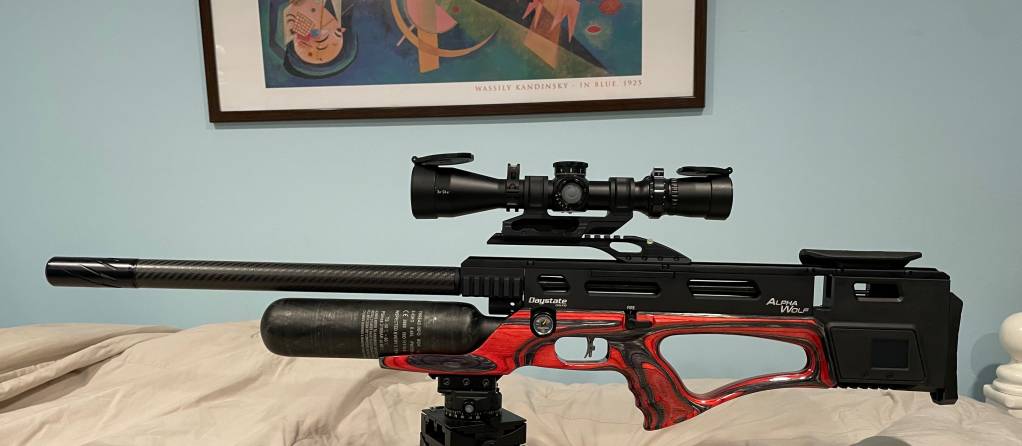

Congrats! Let's see it.
Beautiful, I'm sure you'll be very happy.
