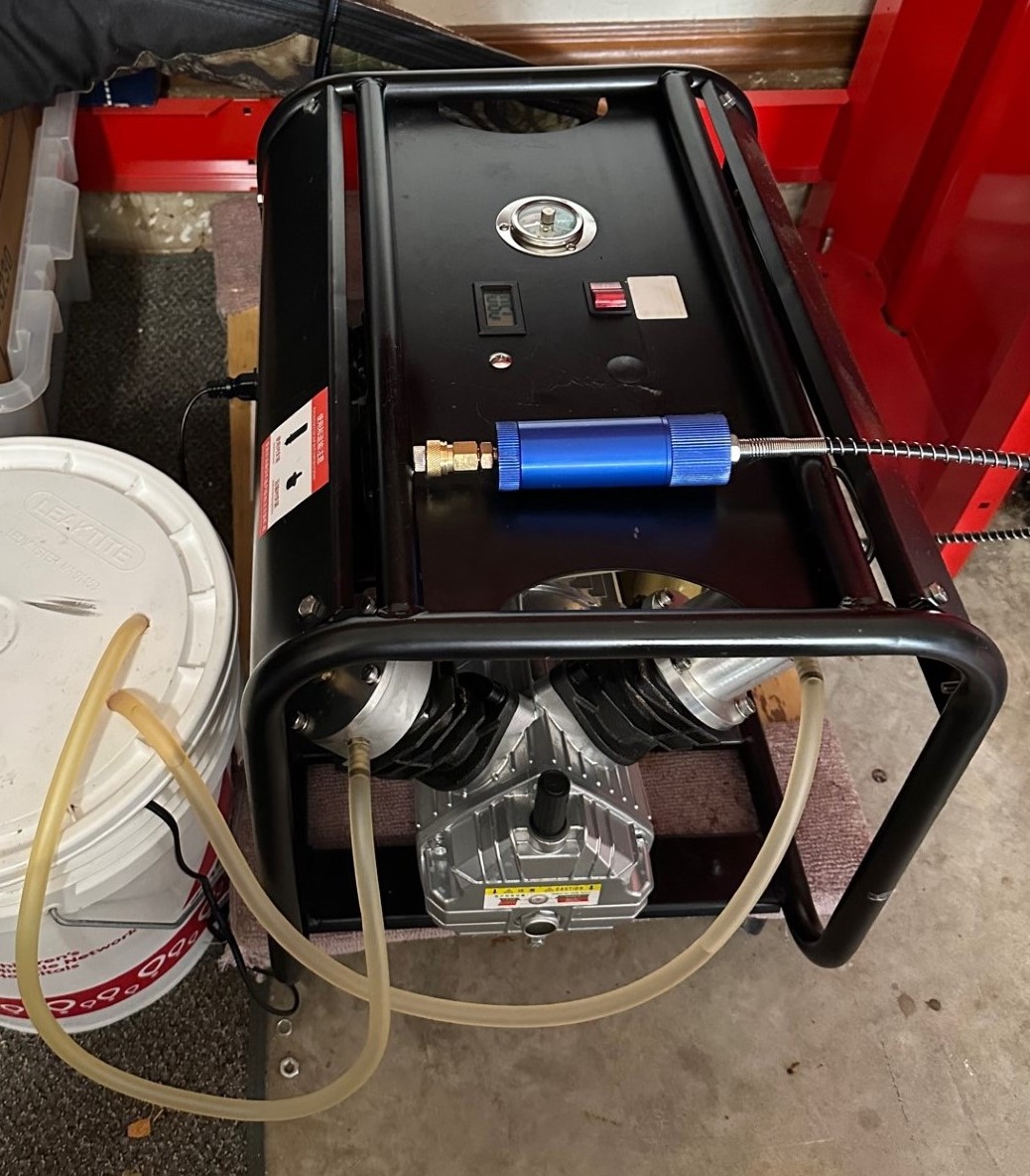

I have used a Yong Heng I bought for I think 230 bucks 2 years ago. I’ve had to replace the pressure guage in the last few months and the fill hose attached to it. Other than that it has been oil. I’m not a power user, I average topping off a great white 1-2 times a month.

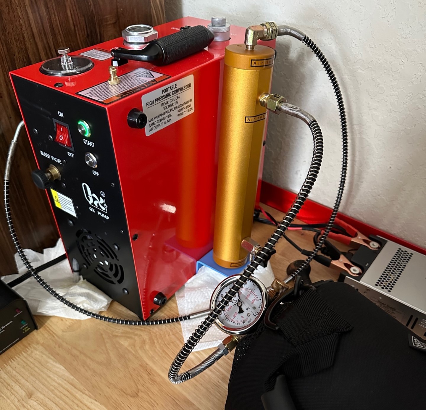

I recently purchased a GX4 do reduce the footprint of my filling. The YH and bucket will go into storage.
I started with a big and heavy Tuxing which overheats quickly and has now sprung a pressure leak in one of the tube fittings coming from the intake cylinder. I tried to fix it myself, but I am unable to loosen the collar. I will need to take it to a compressor mechanic. In the meanwhile, I decided just to buy a GX CS4, because I wanted to see how such a small and compact compressor would work. It is a smashing hit. No over temping. Small footprint. Plenty fast filling. Wish I had bought one like it first.
I’ve had great luck with my GX CS4 as well. It’s small and quiet and seems to do a great job of trapping moisture. It does take a long time to fill a big tank though. Filling a 1 hour SCBA tank from empty is pretty much an all day process. I’d drain the moisture and give it a chance to cool down every 1/2 hour or so and over a 7 hour period it would manage to fill them. I’ve filled 4 like that now and it still works fine.
My Tuxing 032 has been fine, except for the electronics going out the first day, zero over heating with the radiator.

If you decide to get a compressor, highly recommend the GX-CS4. Seems to be the best-performing sub-$1000 compressor alive today. But to get a solid performer, you can expect to pay $4-5k for something like an Alkin, Coltri, or Carrette II.
