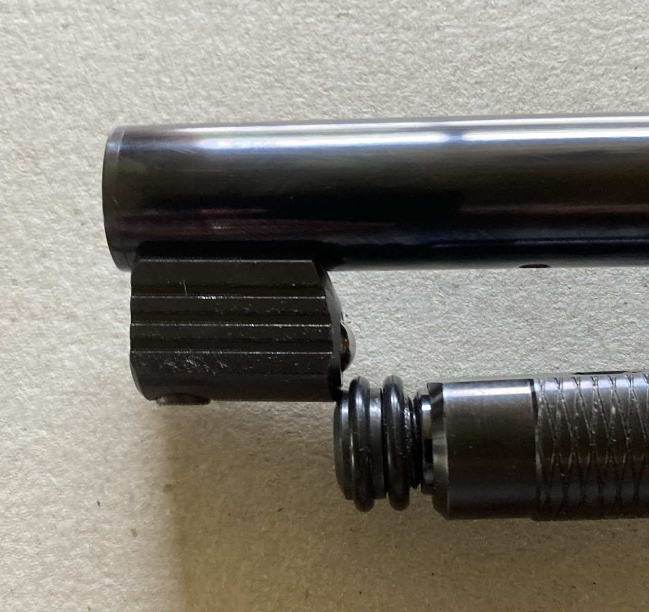

At the range today with the new TX (The trigger first stage is nasty) and after about 40 shots the cocking arm was very difficult to dis-engage. Then, after cocking it was very difficult to lock up under the barrel.
I came home and sent a message to the current WFTF Springer champion and asked for help.

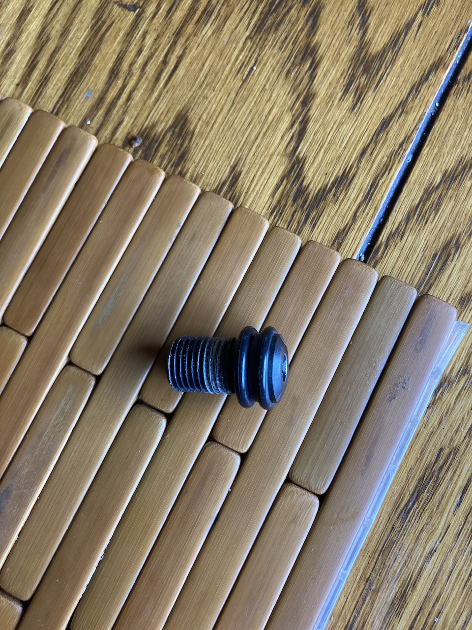

It said the gizmo at the end of the cocking arm was becoming un-screwed..
I didn’t know it screwed it.
I checked it and made some photos after a bit of blue LOC-TITE:
