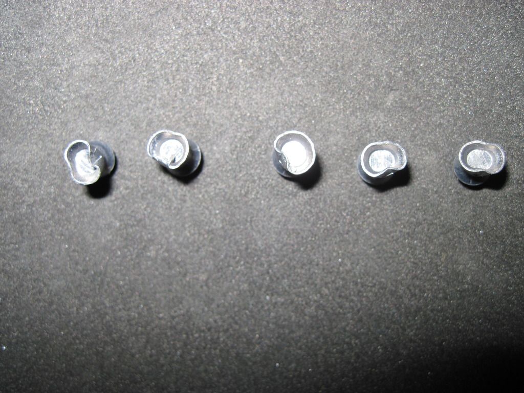

I took 5 pellets and crushed their skirts with a pair of pliers so they looked like this

I'm wondering if your probe is re-shaping the skirts. It would be interesting to see a bent pellet that was loaded and then backed out or, just a peek inside from the back. I think the distance is important because they could be spiraling due to the damage and that might not show up at such a short range.

so here are the pellets
