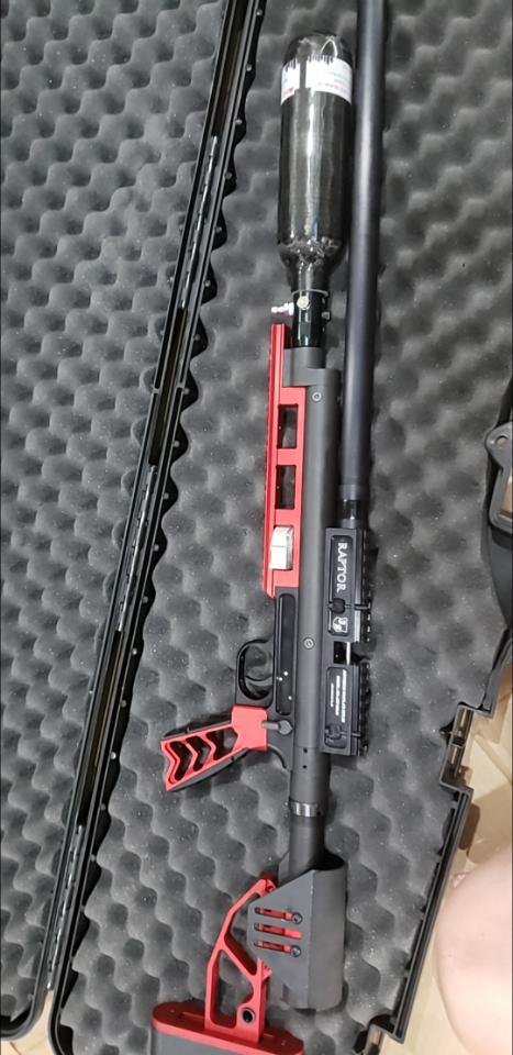

The begining of the .177 Raptor
Before I get started with the gun, I want to say being able to call JSAR and talk with Travis speaks volumes about their customer service! Anyway, on with the gun.
The gun handles very nice. The weight is balanced right about the middle of the fore grip so shooting offhand is very comfortable. A pretty nice feature is that if you want the balance point to shift rearward, it looks like you could add weights inside the buffer tube and have the balance wherever you want; and thats only the beginning of the adjustability of the gun. The cheek riser, LOP, and trigger are solid and all adjustable!
Speaking of the trigger, it came set around 1 pound (as measured with my finely tuned trigger finger) with a nice first stage travel. The first stage comes up against a solid stop and with a little more pressure, it breaks clean.
The cocking lever is super smooth. The spring pressure is really light, so much so that there was a couple times while shooting that I could tell if I had actually pulled the lever all the way back. There must be some Voodoo magic going on with this valve

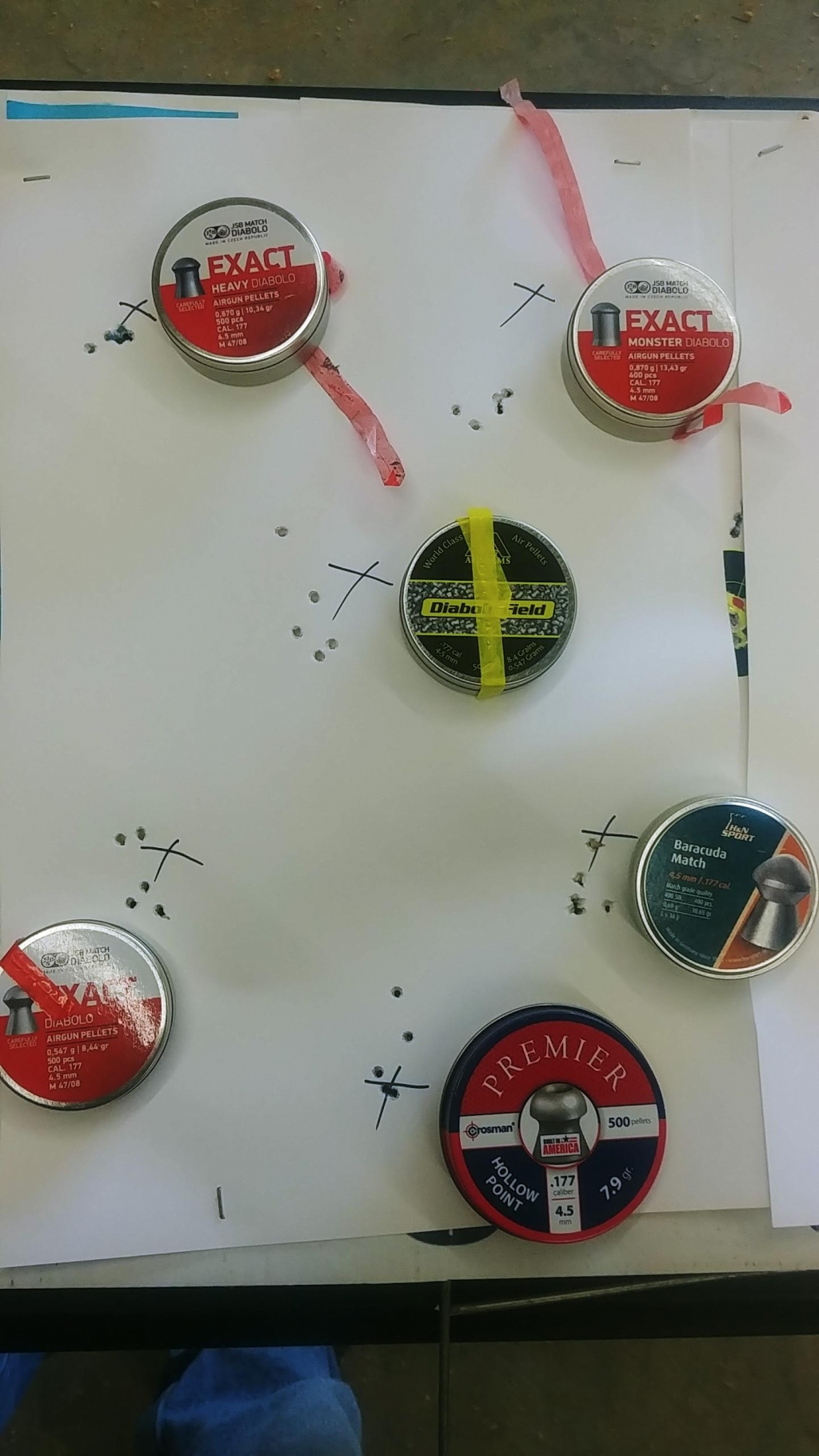

I have had a couple questions about accuracy with different pellets. The weather has not been very cooperative but I did have a small window right after daylight where the winds were not too bad. I grabbed all of the .177 cal pellets I could find and set up a target at 50 yards.

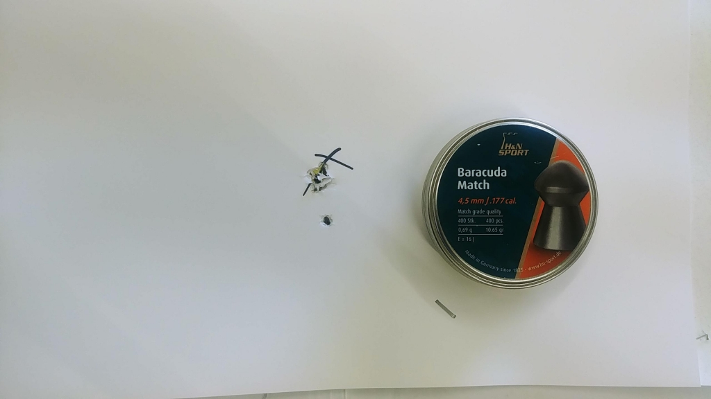

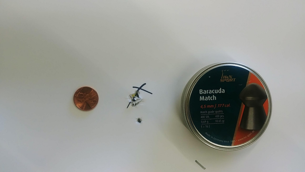

The first pic is of all the pellets I tried. The second pic is of another group shot with the H&N barracuda match. I felt that they should have done a little better.

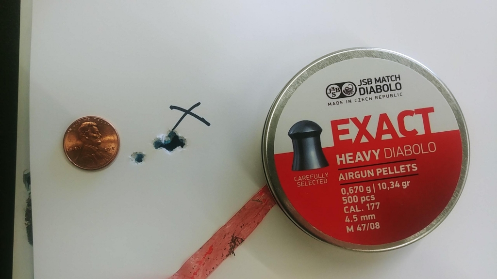

Also, there are a couple for size reference with a penny.
All of the groups are 5 shots and the winds varied 1-3mph.
