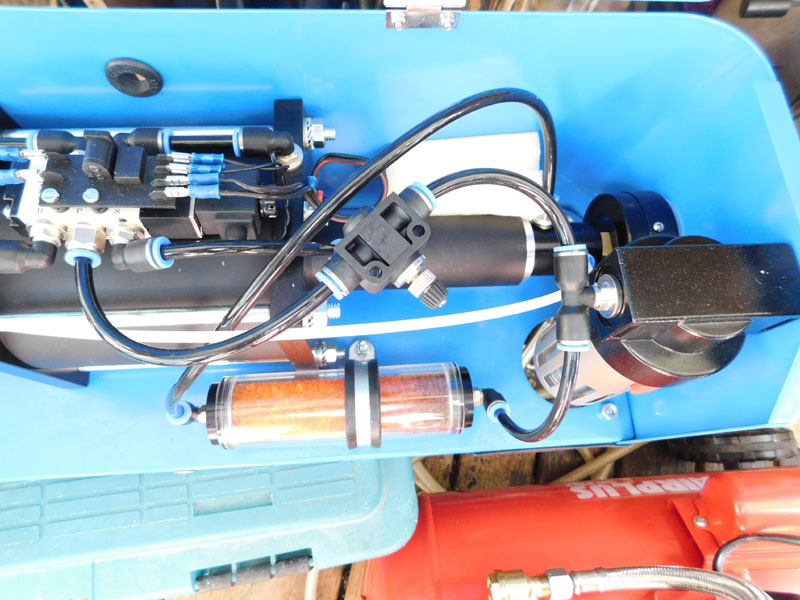

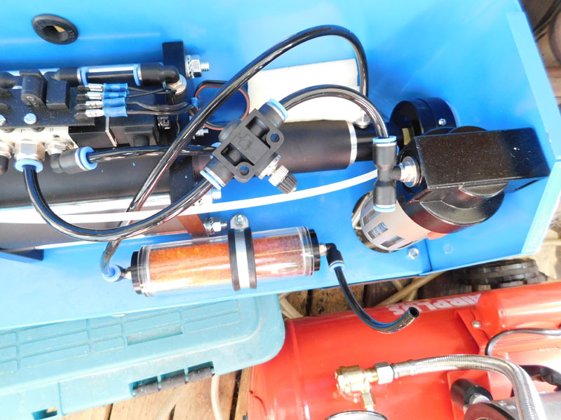

Now hooking up Nitrogen to the booster can be done in two ways:
1) Low pressure Nitrogen supplied by a normal shop regulator (mine goes from 0-40bar~0-600psi) set at max. 10bar~145psi and fed through the desiccant filter into the LP side. That will then feed the HP side and the booster acts as normal. All you have to do is uncouple the hose going from the T-splitter to the desiccant filter and supply Nitrogen there. The booster will function as normal supplied with shop compressor air (and power).
2) A supply of Nitrogen regulated to @80bar~1150psi fed directly into the HP side. This needs a little set of hoses and couplings supplied by Altaros for @ $40. Please see attached video for proper replumbing:

Booster with plumbing as normal fed from a shop compressor
Booster split so shop compressor drives it and Nitrogen is fed to the bottom hose for boosting
