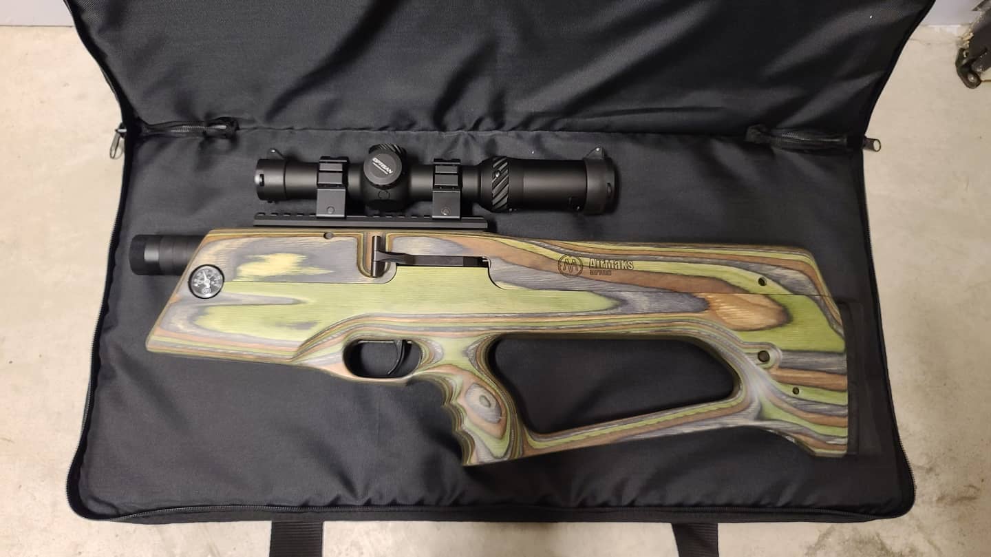

I'm loving this little airgun! The AirMaks Caiman came to me from Utah Airguns but it's made in the Czech Republic.
It is ultra compact, quiet (thanks to Donny), accurate, and has uniquely pleasing ergonomics. I really like how the entire action is wrapped in wood.

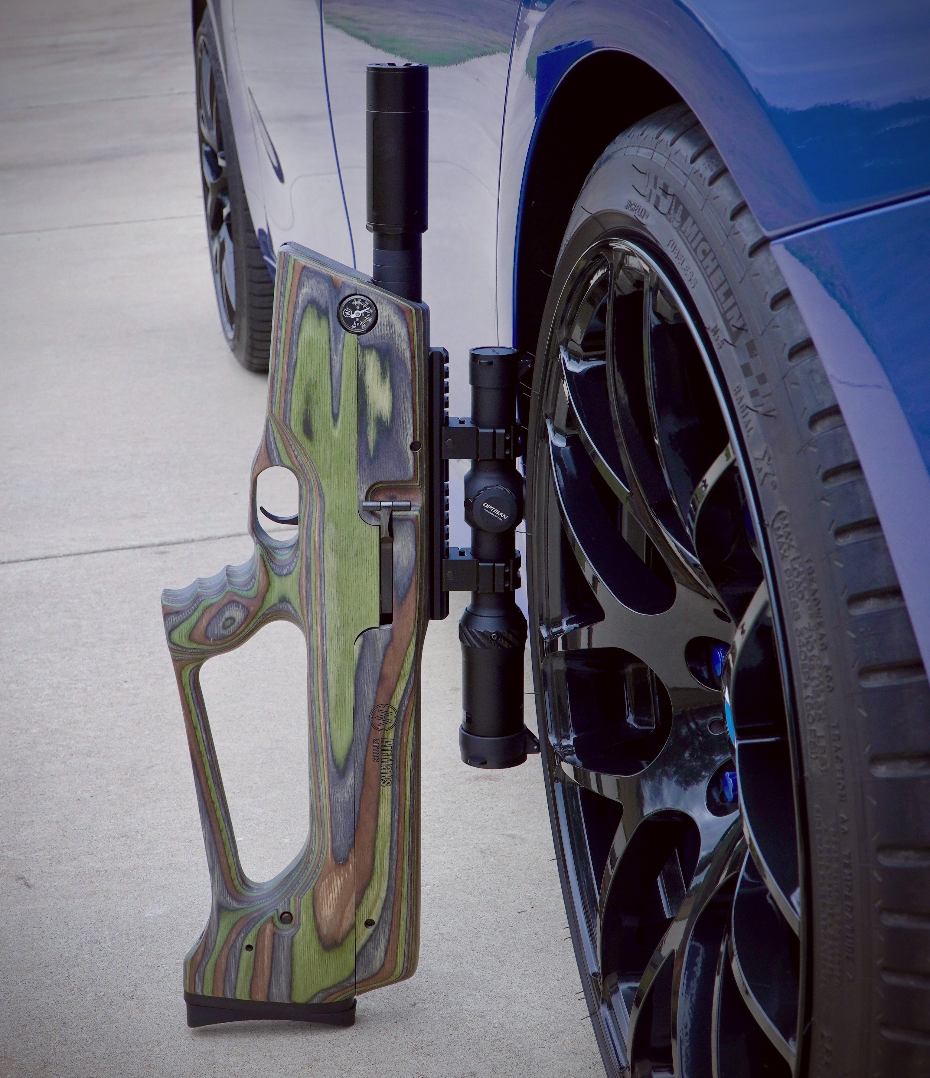

I've been shooting one also, and I like more and more as I get to spend time with it. Surprisingly good ergonomics, slim and tough with everything protected inside the stock, which also dampens the sound of the hammer and valve. Extremely accurate CZ barrel, always hold zero, and surprisingly efficient - getting a pretty darn good amount of shoots for a small air cylinder. It is, I think, the absolute perfect truck gun.

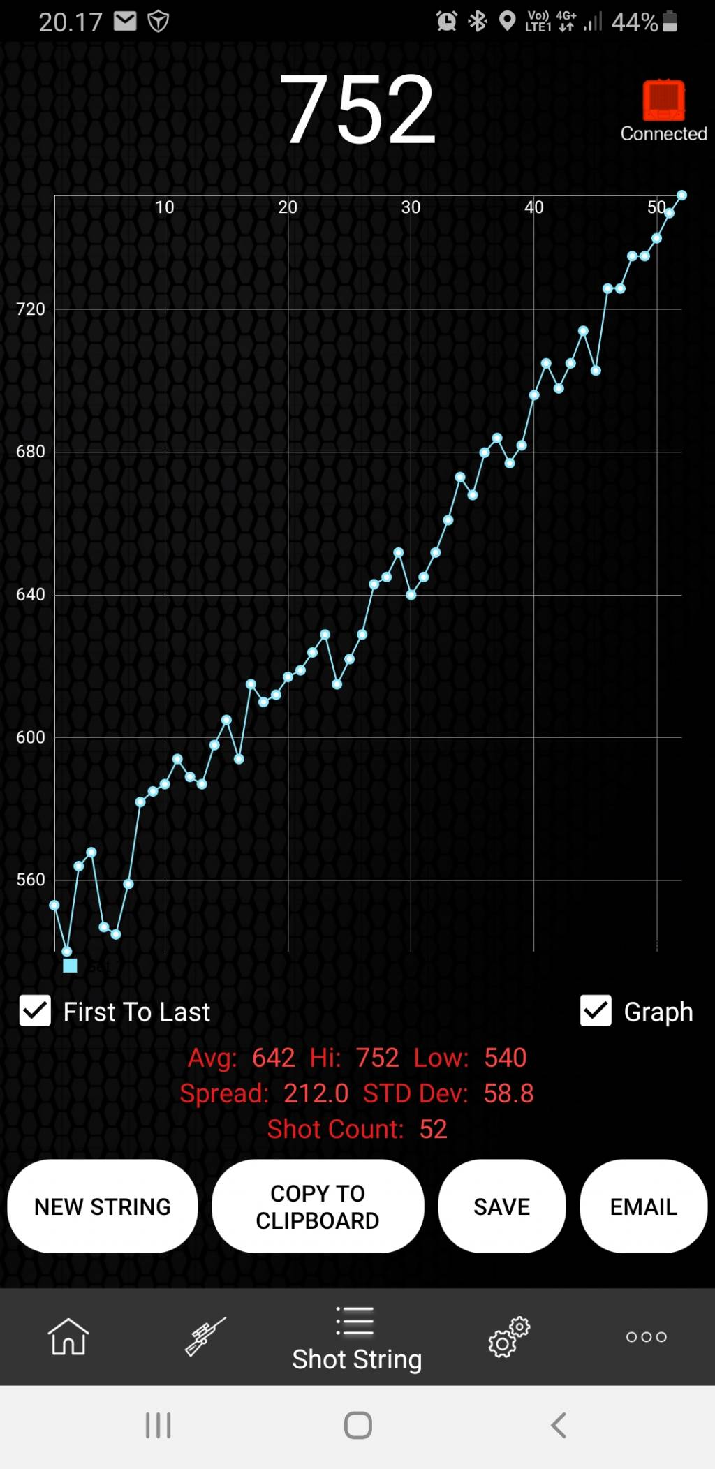

I've just got one in 177 in FAC not sub12
i would like to shoot at about 700fps in my backyard dont need more speed for that.
But my problom is that it keeps going up in speed if I start whit 10.65 gr baracuda at 600fps when I'm done whit 4 magazine im about 724fps an it is still going up.
Tried making small turns on the hammer adjuster but it still keeps going up..
What the hell to do??
