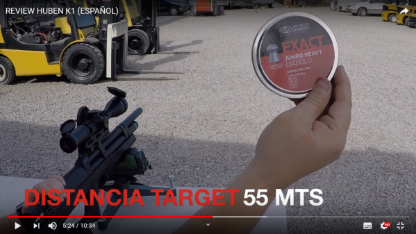

However, I`m still shooting better groups with the Huma regulated SPA M10 with the same JSB 18,13 grainers with the same (approx.) 930 fps speed. My Huben is one of the newest Generation (V3 !!!!).
The Huben begans to shoots like a shotgun after I cleaned the barrel the first time. There was a lot of dirt inside … But why it was shooting better groups with (original) dirt barrel ????????
Same effect with my FX Impact. After cleaning the first time, the groups went bad.
And I also think the distance in this Video is max. 45 meters.

This is the answer for those who are skeptical about its accuracy.
OK. Now I understand. I didn't know that there was any skepticism about it. I'd like to see more reviews of the K1, particularly the .25 caliber version that recently came out. I am really impressed with the Huben K1 and I'd like to have one. I just need to learn more about this gun first.
