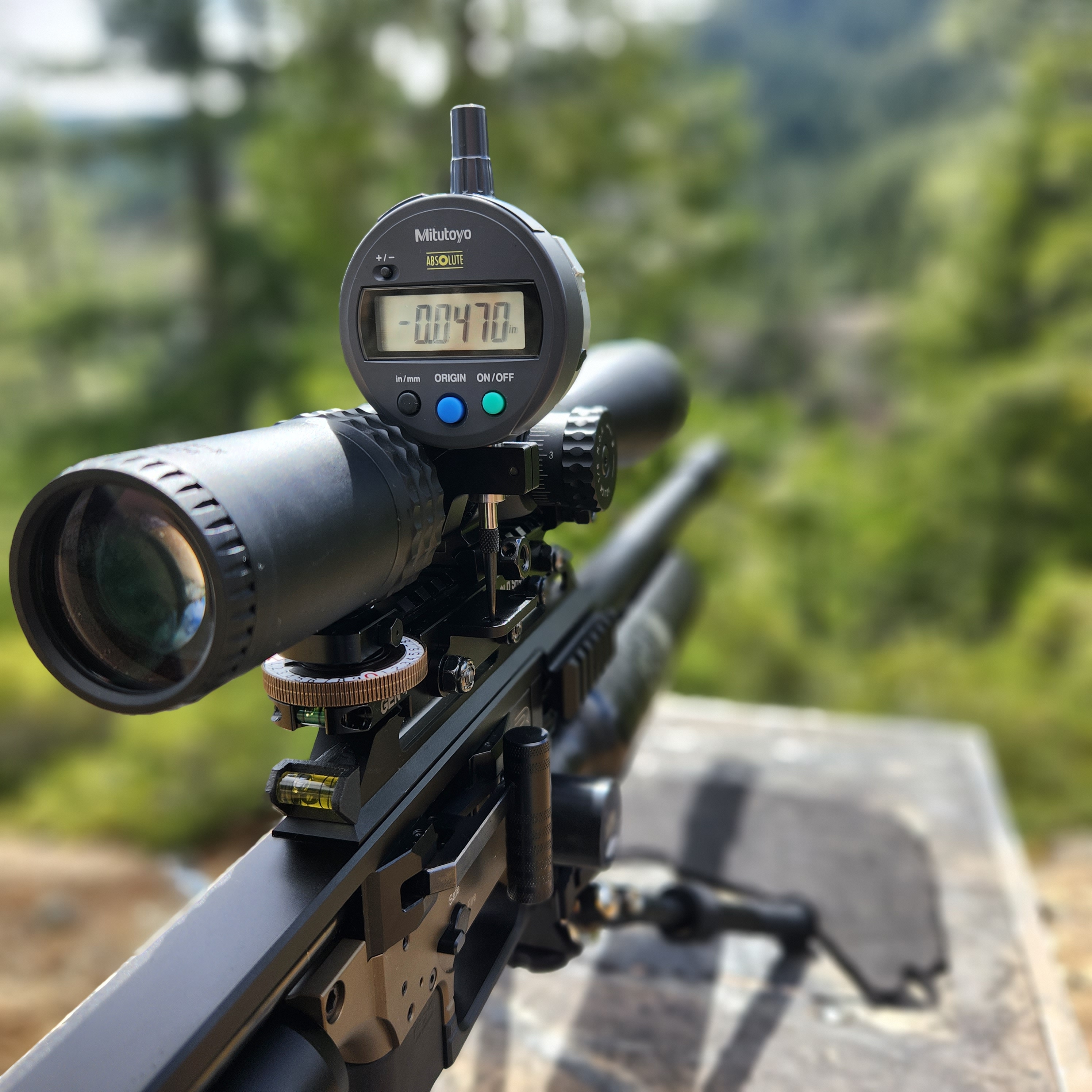

I'd like to introduce a new sighting system to cover all of your Extreme Long Range Shooting needs.
The Absolute MOA Digital Readout Kit.
This kit allows you to convert your adjustable Coldshot or Ravin Jack Plate bases in to a precision MOA digital readout shooting system.
The Absolute MOA system will keep a precise, easy to read measurement throughout the entire range of adjustability (up to 300 MOA with the Coldshot and 250 MOA with the Ravin) and eliminates the need to count and keep track of clicks or revolutions of turrets. No more masking tape or turret stickers and eliminates the need for magnifiers to read them.
The Absolute MOA Digital Readout Kit converts .001" into 1 MOA. So depending on what digital drop guage/dial indicator you use, you'll be able to adjust to a tenth of an MOA or less with repeatable precision.
Another big advantage to this system is you'll be able to turn nearly any scope into an Extreme Long Range performer. The current models are for 30mm scopes with 1" reducers available.

I've been using this system for a few years now and it's been a true game changer in the over all shooting experience.
Having the ability to range, dial, and shoot from close range to extreme ranges, and everything in between, so fast and accurately, is just an unbelievable feeling.
If you go back and watch my ELR videos on my threads from the past, I've been shooting small objects and sub MOA groups from 300-400+ yards. All shot with a relatively light weight slug (28grn .22) that has about an average BC for airguns.
A huge part of my ELR success comes from it being so easy for me to practice and tune my airguns at such long ranges.
With the next generation of "high BC" slugs, this new system is almost a must if want to use them to their maximum potential.

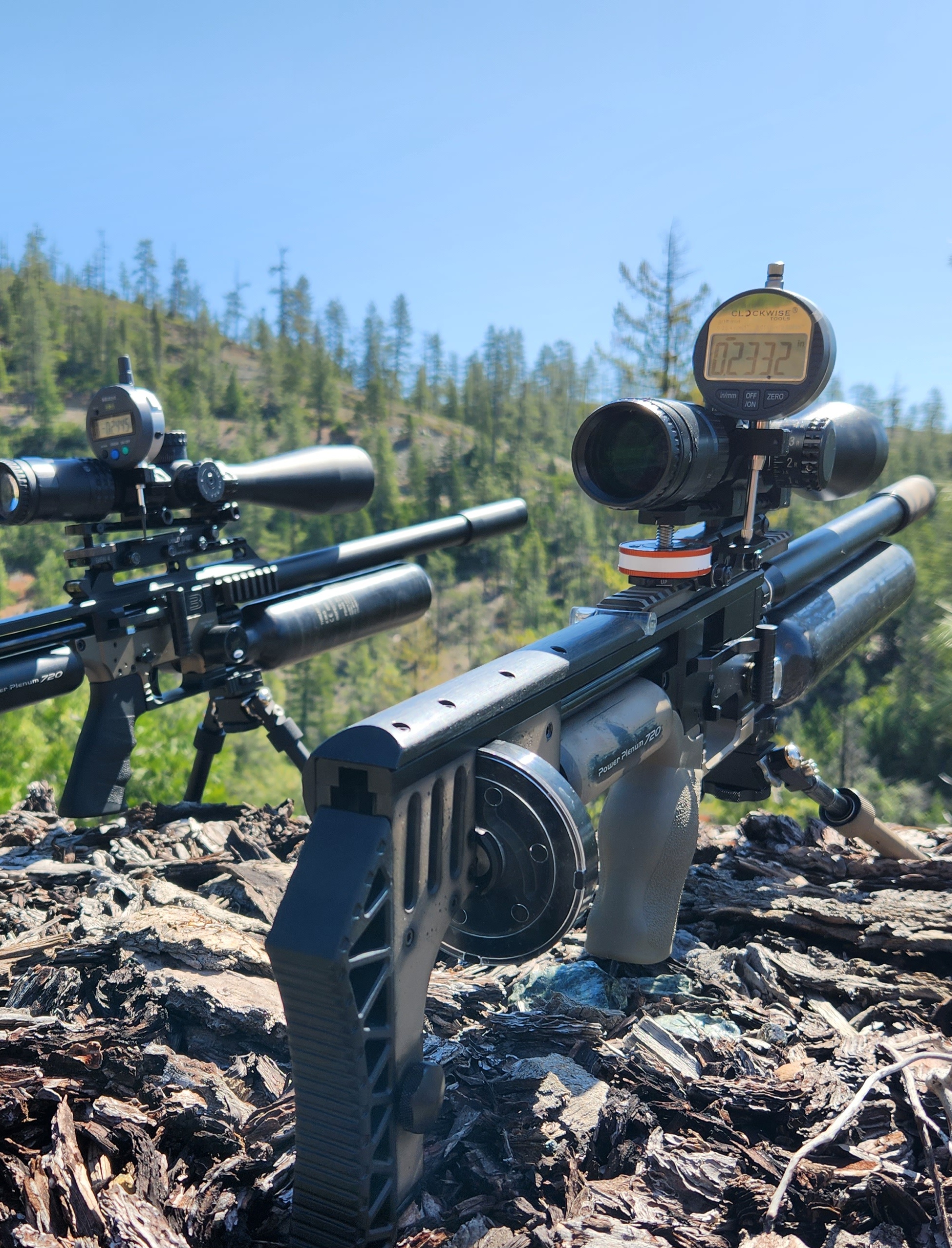

I've sat with him many times shooting Ground Squirrels at 100 - 220 yards, and farther out too.
He can range a yardage, adjust and shoot crazy fast. And consistently hit the Squirrel!
Then change to a different yardage and hit another one. Fast and consistently accurate.
This system works so well I got all the components to put it on my long range gun.
I just need to anodize the parts to my gun colors and mount it.

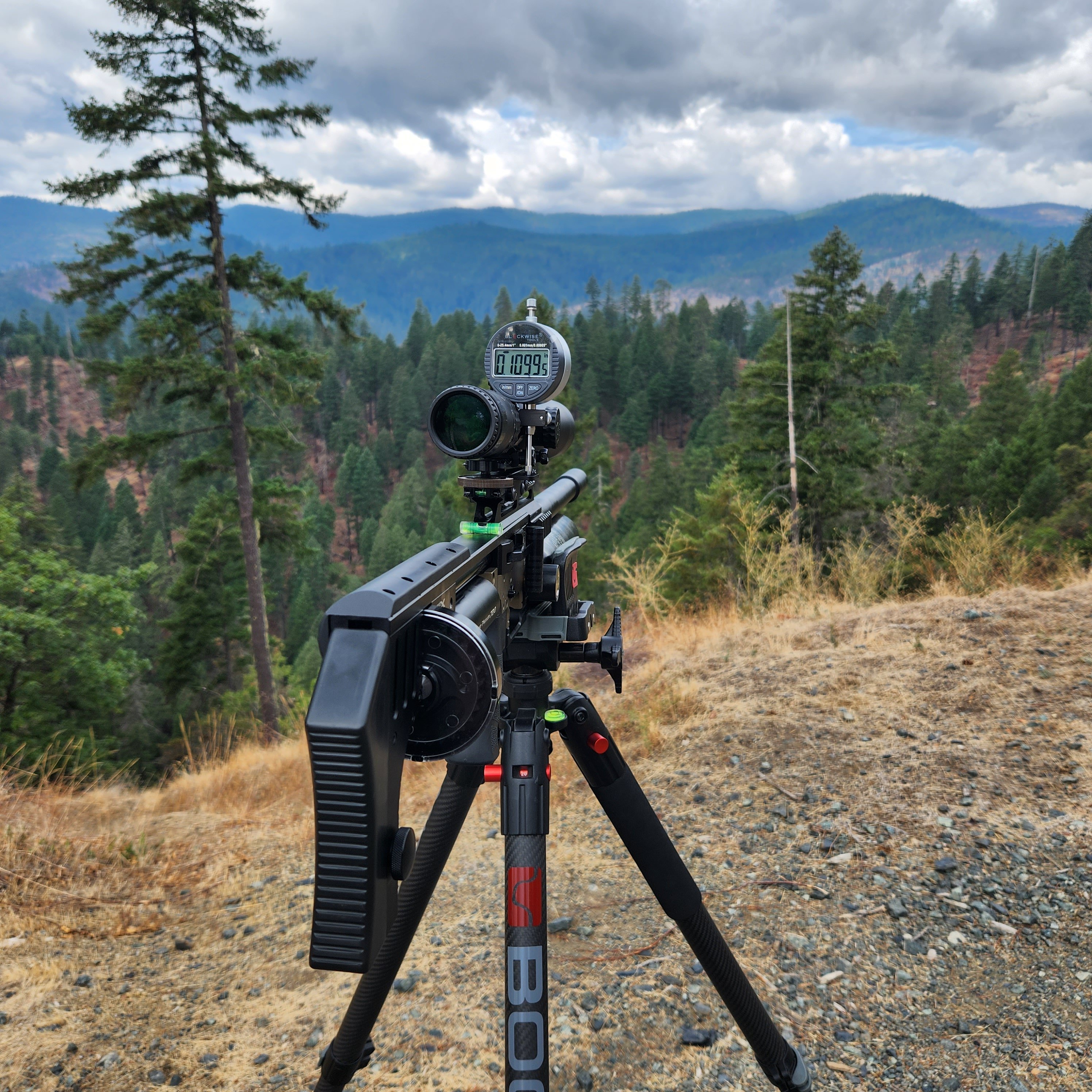

Shooting ground squirrels, or other targets of opportunity, at random yardages is where this system really shines. As Long_Shot mentioned, the ability to range, dial, and connect so quik and accurately is simply amazing.
I've mentioned before that I would hands down take an adjustable base with even a mid-tier scope and the Absolute MOA system over ANY high end scope at any price. Until you see it in person or use it first hand, you just don't know what you're missing.
Like the ability to stop at random locations, range across canyons to the next ridge over and pick away at small rocks or pine cones. At just over 445 yards, I enter the info into Strelok, dial to the exact MOA and start sending!

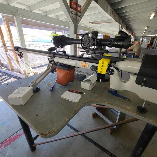

Without knowing about your great idea and for the past few weeks, I have using diy readout kit on my Texan. Yes, I get the strange looks from my fellow airgun shooters at my club range when they see my digital read out mounted on my scope and have to explain the concept.
I haven't worked out all the bugs, and did not know exactly how to convert the readings to MOA. But with your explanation on how your kit works, it makes perfect sense now. I 3d print all my mounting hardware and will now try to mount my readout to something similar to your setup.
