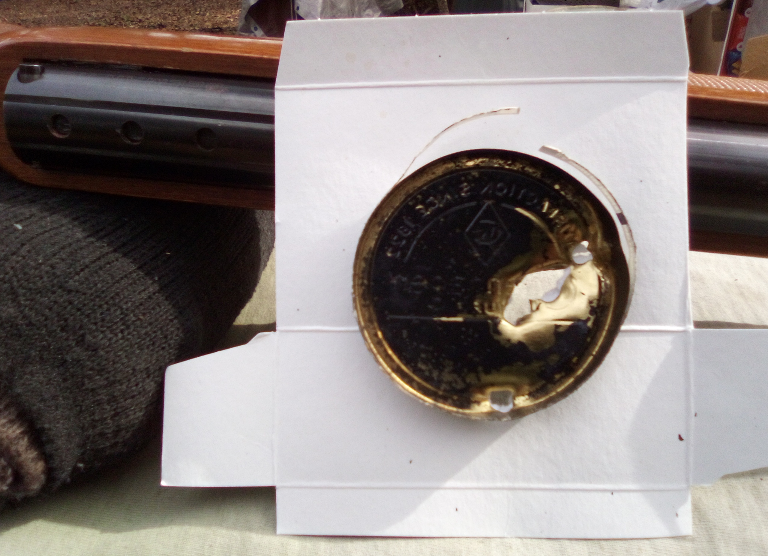

Another quick 5 @ 50y ,irons, cp-hp a few min ago. I could say consistent?
Awesome for irons, you must still have eagle eyes..lol. I got into the airguns later and had to learn to shoot a scope with glasses, but I can hold my own now.
