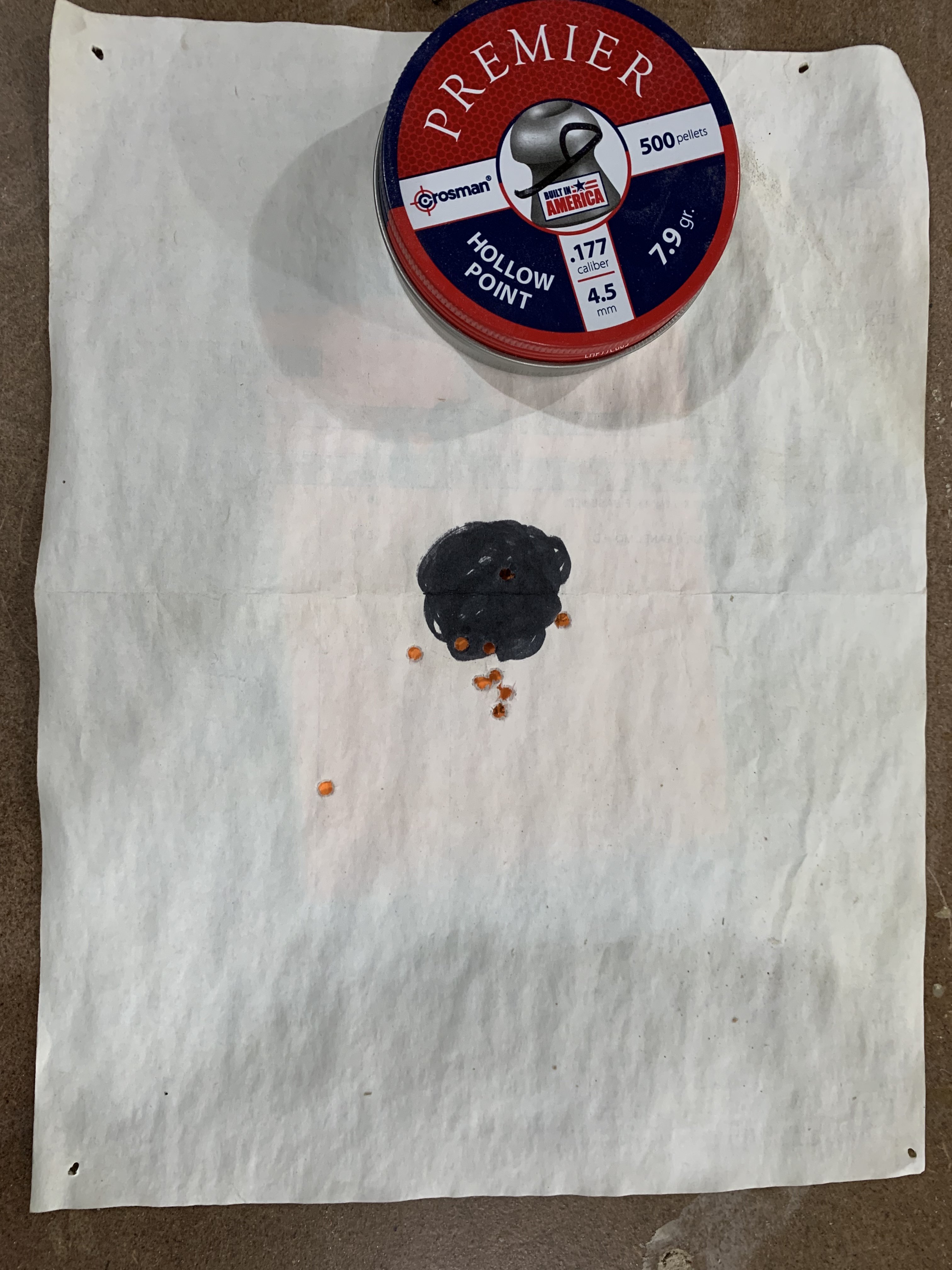

I have been super frustrated with my new HW 95 .177 cal. I tried all the usual pellets that shoot best in my other HW rifles, No luck. I could not get it to shoot acceptable. After about 1000 high-quality soft lead pellets, I decided what if I got to lose. I cleaned all the soft lead residue out of the bore and tried crossman premier 7.9’s That’s more like it. This is 10 shots at 50 yards with Iron sights. Aside from that one flyer that’s about as good as I have done.
Exactly why I always recommended that people try the old boxed Premiers when they were available.
Out of all the many .177 HWs I've owned, not a single one shot anything better than the Premiers.

I have been super frustrated with my new HW 95 .177 cal. I tried all the usual pellets that shoot best in my other HW rifles, No luck. I could not get it to shoot acceptable. After about 1000 high-quality soft lead pellets, I decided what if I got to lose. I cleaned all the soft lead residue out of the bore and tried crossman premier 7.9’s That’s more like it. This is 10 shots at 50 yards with Iron sights. Aside from that one flyer that’s about as good as I have done.View attachment 301268
Iron sights! Your eyes are better than mine, that’s some fine shooting!
