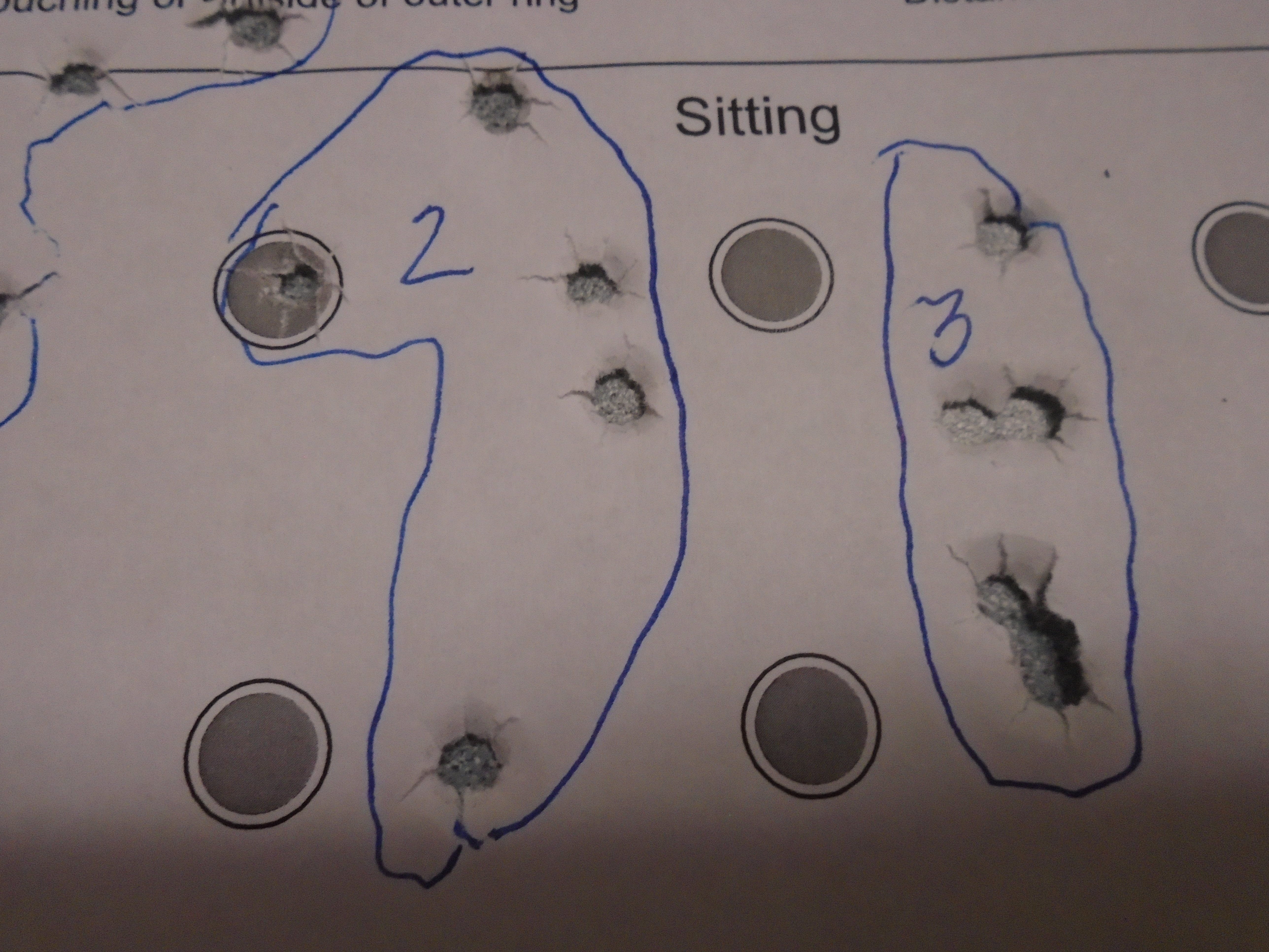

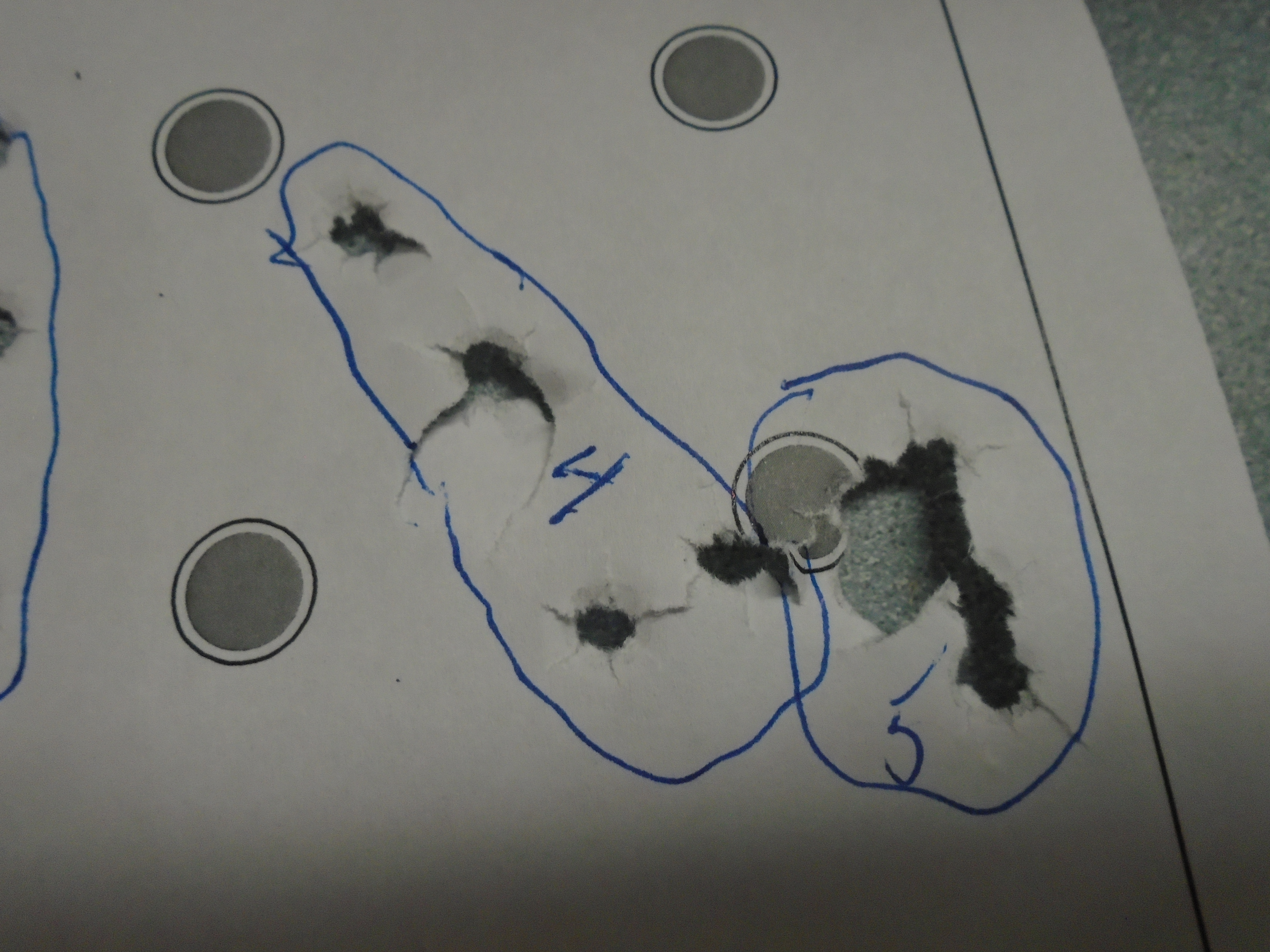

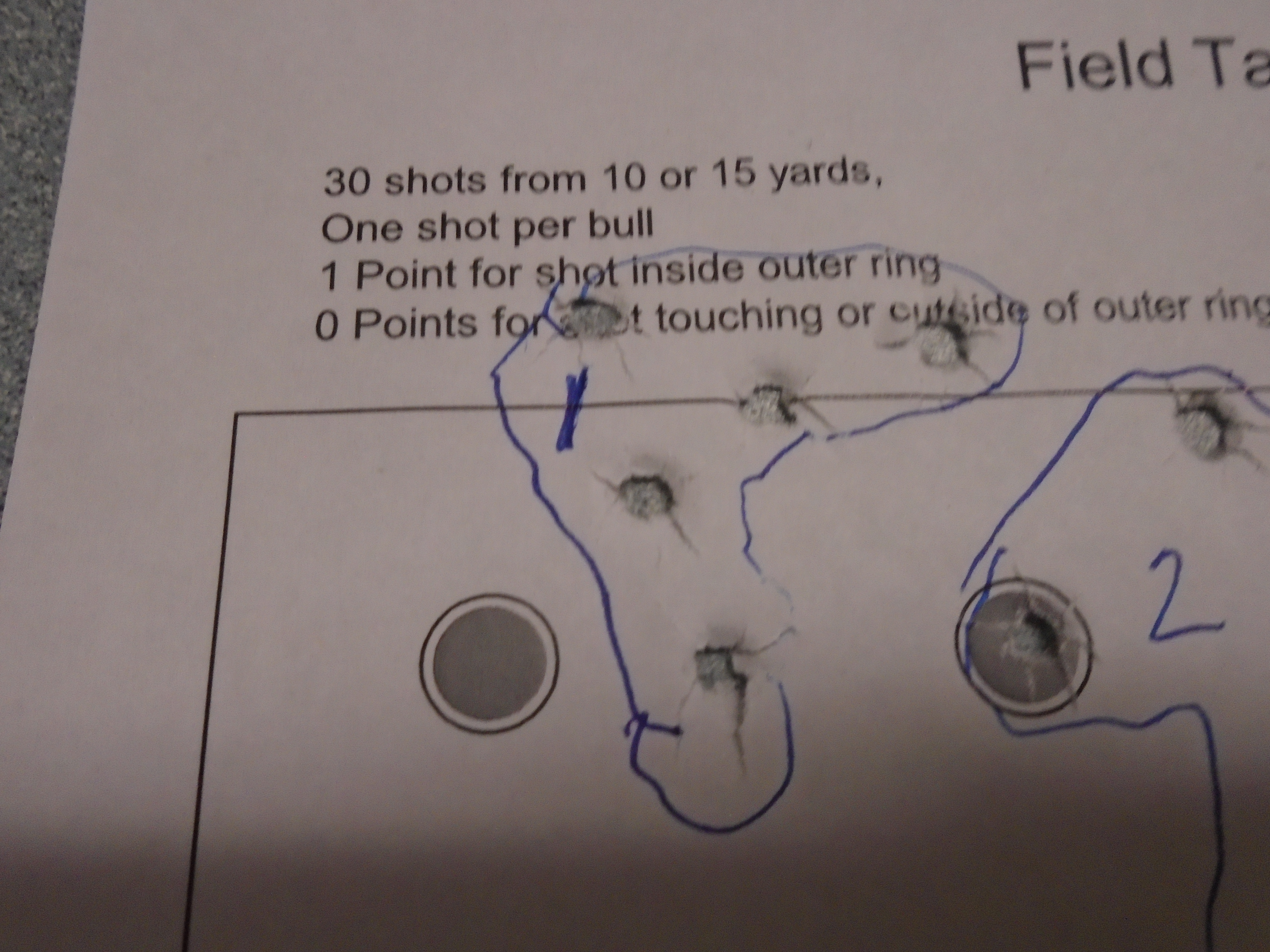

So I started to dial in my Brocock Bantam in 0.25 cal. I noticed when doing a shot string prior to installing the Regulator that the grouping seemed to tighten up while shooting from 200 down to 110 Bar. So I filled it back up to 150 Bar, and shot at targets in 5 shot groups and using the LabRadar recorded the speed and wrote down the pressure on the gauge.
150 Bar - JSB Exact Kings 25.39 Grain, 50 yard target (laser Ranged) Scope was not adjusted during test. Caldwell Sled used to hold rifle. Clearly Group 5 is the tightest at 110 Bar

The groups really never were as tight as Group 5 in the photos, but the speeds were the same. Not sure I should move the regulator up and down some and see where it settles in.
That looks about right .to me as far as the regulator is concerned. There's probably a little bit of error in the actual marking of the regulator and the other gauges in the system. That would account for the velocity being a little bit lower than you would expect that 110 giving your first five shots at 110. I think you need to shoot it in and tweak the other parts of the system at this point I group number five looks like a good group depending on what distance you were shooting at.

Another suggestion is to try shooting from bags or if you must use the sled be sure you maintain the exact same hold on the gun/sled each time and to maintain good follow-through after trigger pull. I think the sled can introduce a little “spring” and cause the barrel to move slightly vertically during shooting. I find I shoot more accurately with bags at both ends or a front rest and a rear bag.
Where is your HST relative to maximum velocity at this reg setting? Generally, 95-97% is where you want it, so that should suggest whether or not a reg adjustment is appropriate. Of course, what the target tells you is always most important, but usually good accuracy and balance are close together.
OldSpook, It only has maybe a tin through it, I've polished the barrel, and put in the regulator. I may drain the tank and put a scrunch of a twist on the reg.
It seemed after shooting another 100 pellets the reg. started to settle in and the shots became closer in speed.
The target was 50 yards, laser ranged to verify.
Shooting without my glasses and making sure everything was in focus was the bigger issue.
I don't like the sled my arms and cheek are all over the place, I'm sure that didn't help. I have a Bi-Pod, I'll get a rear bag.
